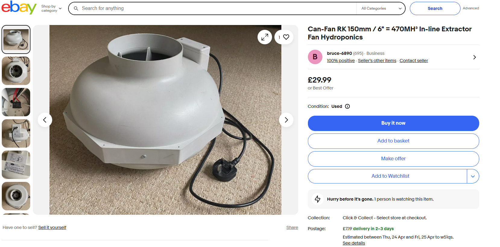

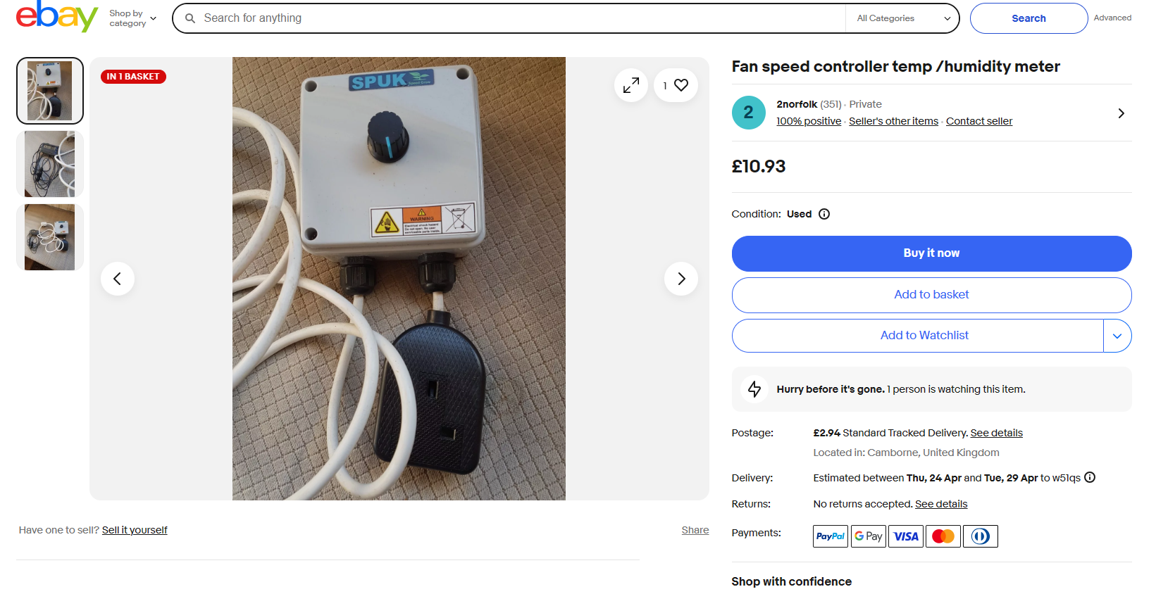

It doesn't have to be expensive, extract from each wet room and then depending on house layout one or two locations to have supply too. Then the rest of the ventilation is via transfer through different areas, as the air finds it way back to extract points.
My MVHR came from ebay
Just what I was going to say. No need to make it expensive. Just rig this up to your wet rooms.
All those stoners growing weed in their lofts had to come in for something useful in the end.
