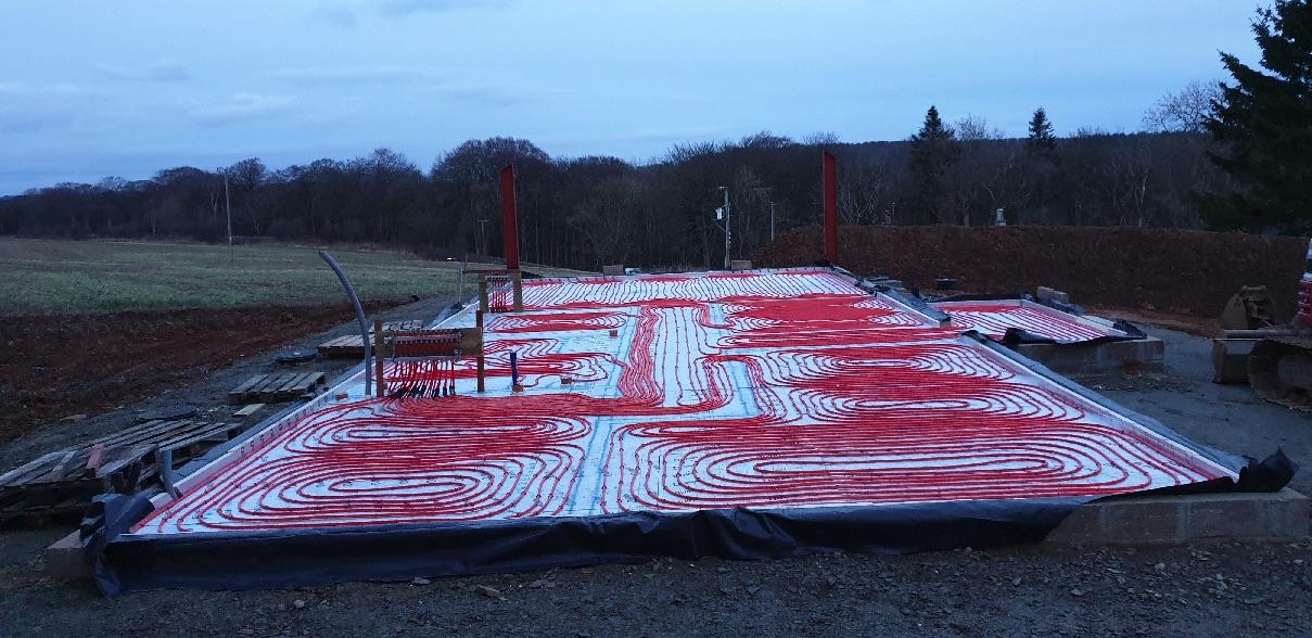

russ_fae_fyvie Posted February 20, 2019 Share Posted February 20, 2019 (edited) Well guys its been a while but today we poured the 100mm slab after fitting the Insulation and UFH Pipes, kit is due on site on 12th March so its all systems go now ! It was a bit dark on site tonight so I couldn't get a photo but there are now loads of others on the website, don't get too bored !! www.stationbrae.uk Edited February 20, 2019 by russ_fae_fyvie 2 Link to comment Share on other sites More sharing options...

TerryE Posted February 21, 2019 Share Posted February 21, 2019 If you use pure electric then you will only ever get a CoP of 1. Have a wet UFH laid very much as above in @russ_fae_fyvie's picture (see my blog). At the moment we heat this electrically using a Willis heater in the heating loop and I have posted separately on this. This is a cheap and very flexible arrangement. I plan to add an ASHP in the summer, as the paybacks justify this cost if I do the installation myself ~£2K vs ~£6K (and just as I did the rest of the plumbing). Link to comment Share on other sites More sharing options...
