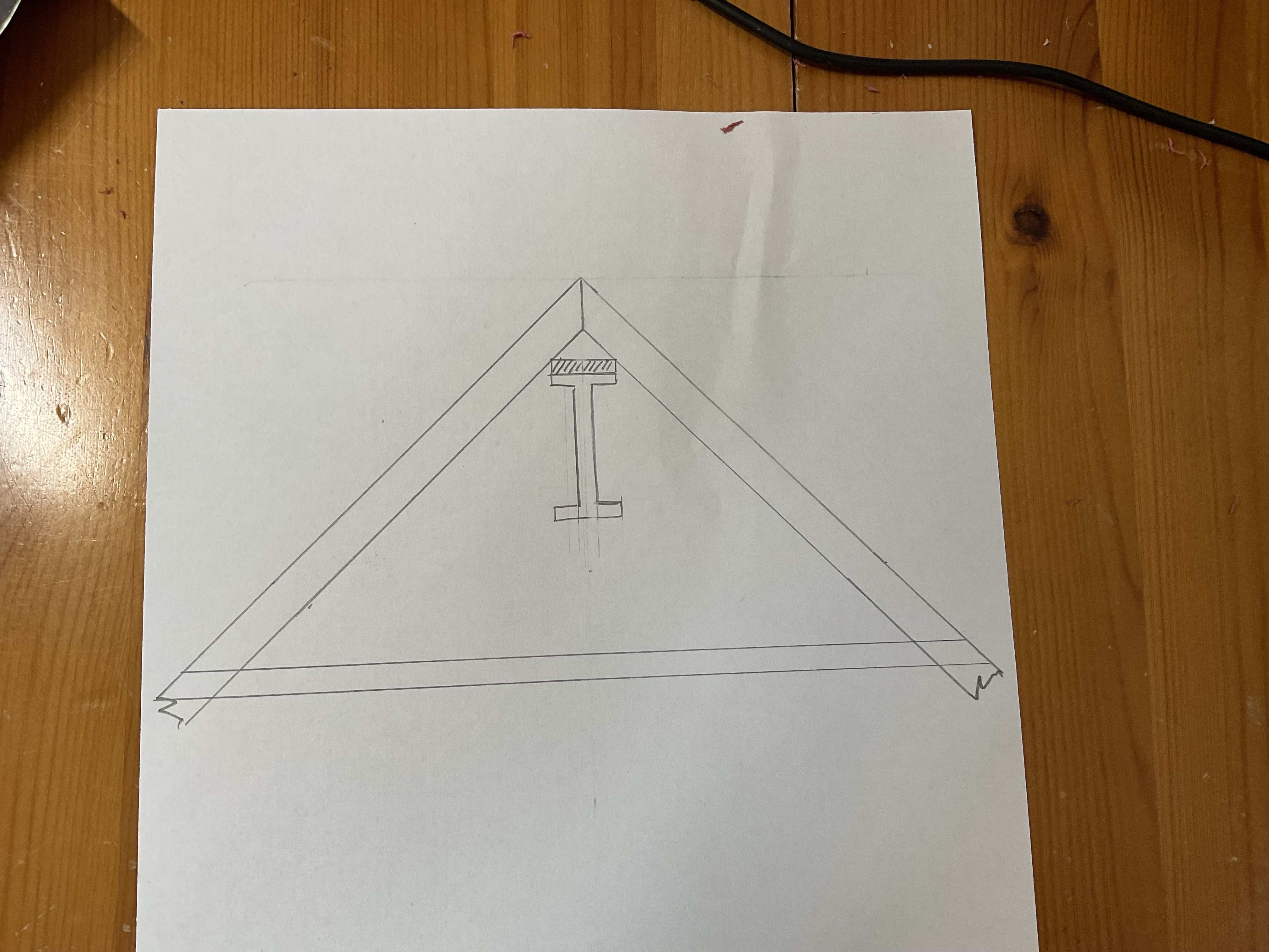

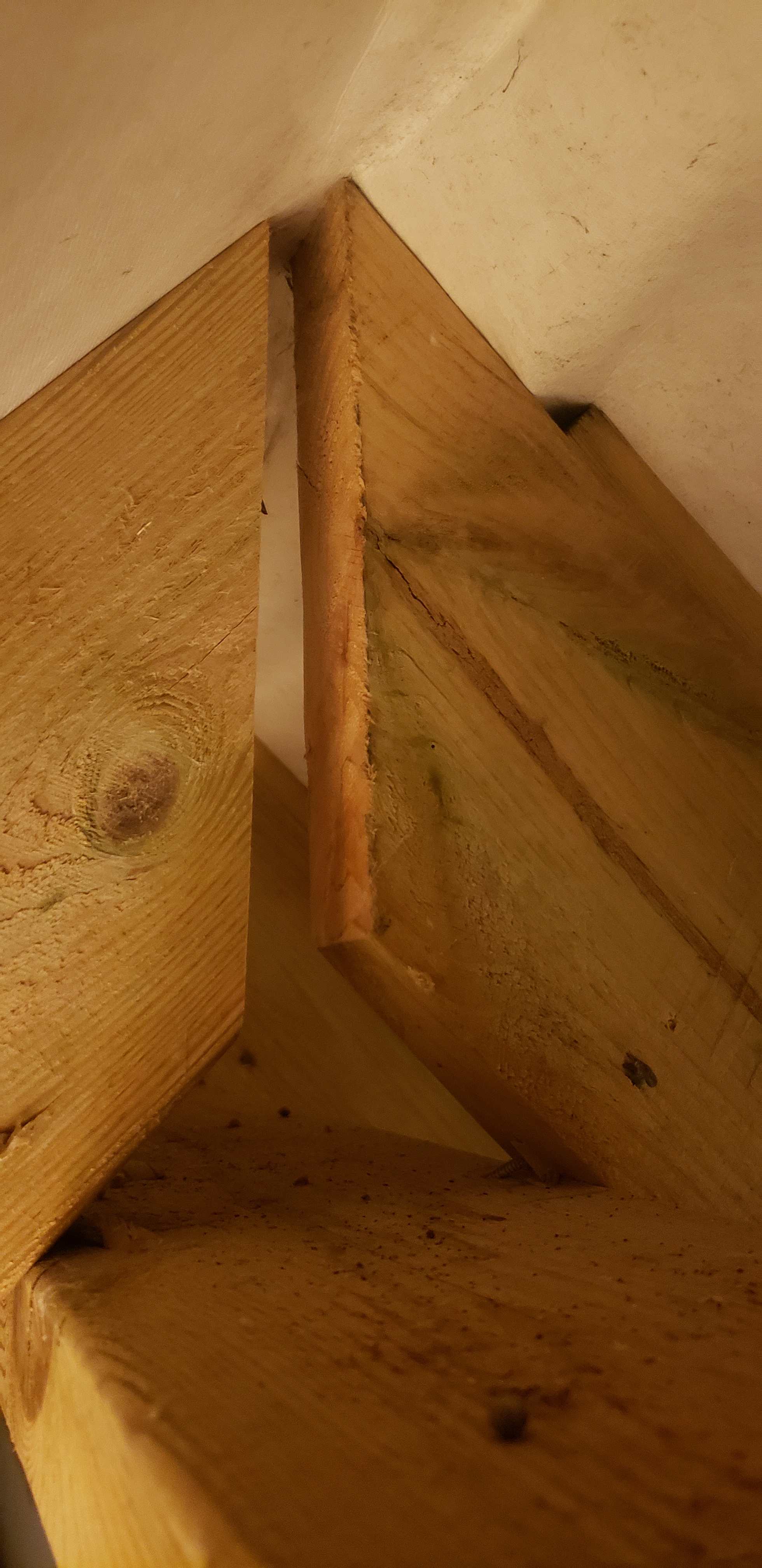

Further investigation has revealed this is the standard of construction I'm left to deal with!! That's the rafters siting on the ridge beam Having done a bit more research, I came across this suggested solution from an engineering forum: bearing on top of steel ridge beam -
Just realised I posted this in the wrong section so re-posting here... I wonder whether anyone could offer any thoughts on this connection detail please? The extension we have has a steel ridge beam to allow a vaulted ceiling. The rafters have been skewed to a 2" timber with what look like your standard nail gun framing nails. The timber has been bolted to the steel i-beam. Make-up is as shown in the picture below. The rafters haven't been birds-mouthed onto the timber but are just as shown. (The horizontal timber shown is a ceiling joist so doesn't extend from wall plate to wall plate and is about a 1.4m down from the ridge. Floor to ceiling is 2.5m) Any thoughts as I'm slightly concerned about the roof loading and restraint onto the steel.

Thanks all. Alas I fear that's exactly what might be happening š”. -

Thanks Tommo, I wouldn't guess it but unfortunately it's already built (before we bought the property)! -
Thanks both, that helps!
