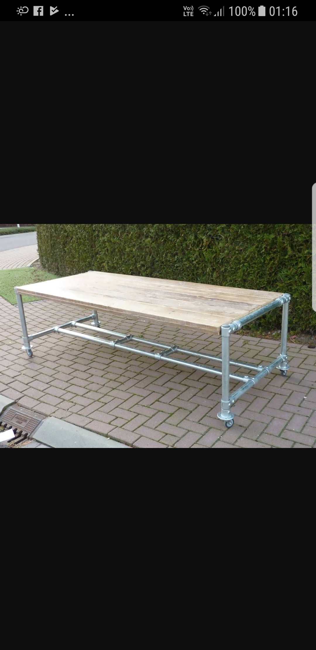

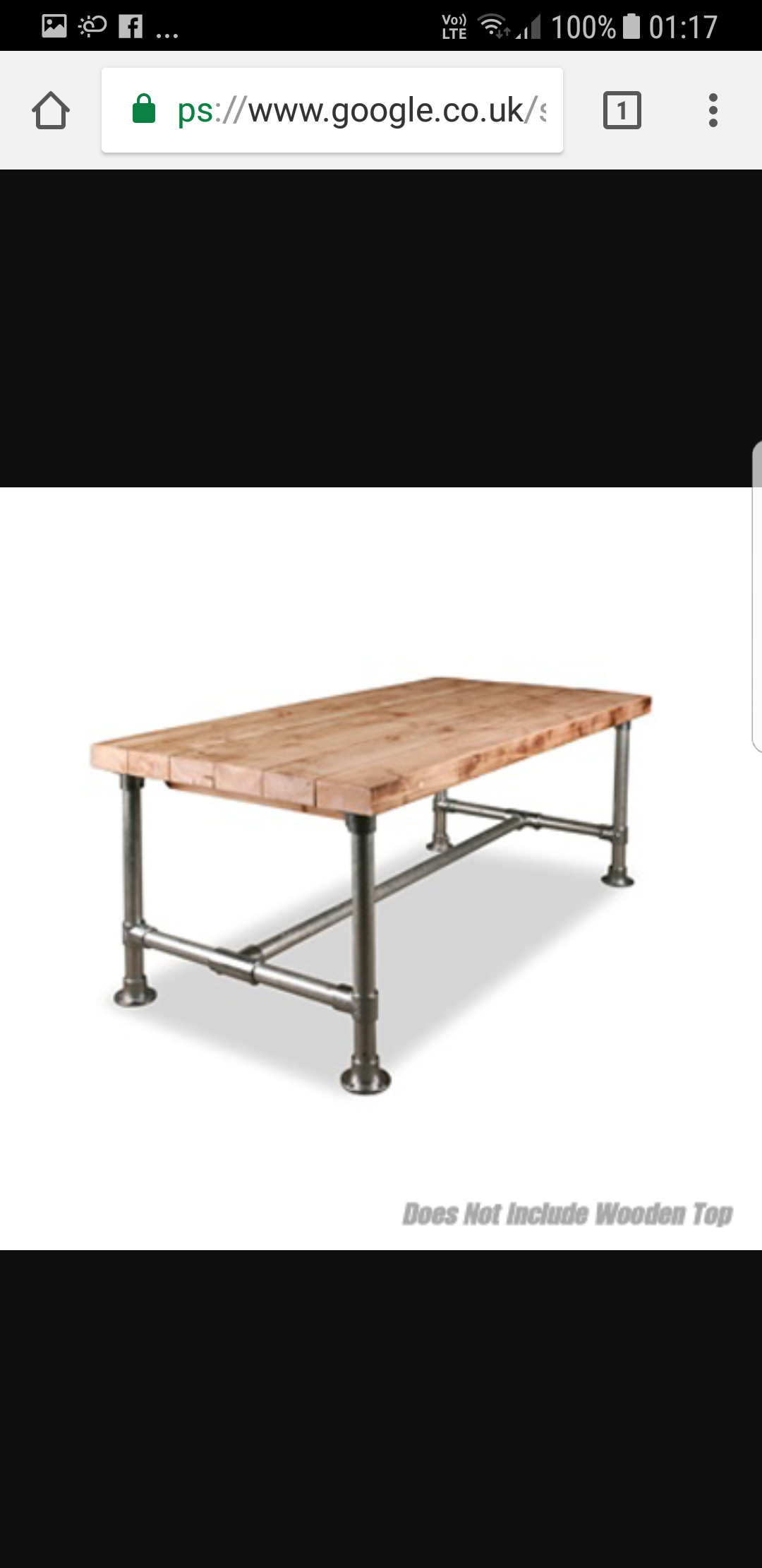

Alexphd1 Posted November 3, 2017 Posted November 3, 2017 Overkill but a bit of imagination it could work very well! Key klamp tube+ fittings (or equivalent) and scaffold boards. I also plan to make shelves in garage with same material.

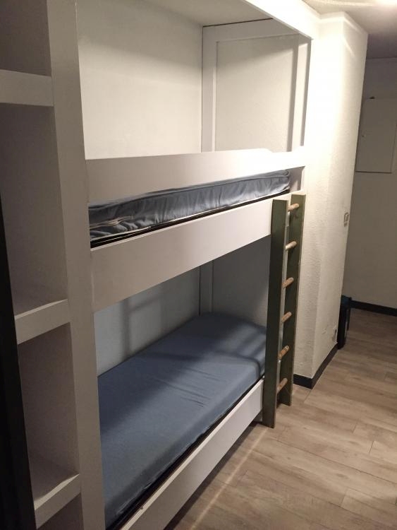

willbish Posted November 3, 2017 Posted November 3, 2017 I found the Simpson Strongtie workbench kit great. So quick, simple and guaranteed strong joints. Used another kit recently for a set of fitted adult friendly bunk beds in a ski lodge. 1

SteamyTea Posted November 3, 2017 Posted November 3, 2017 Who is the poor soul that has to sleep in the middle one, Twiggy?
