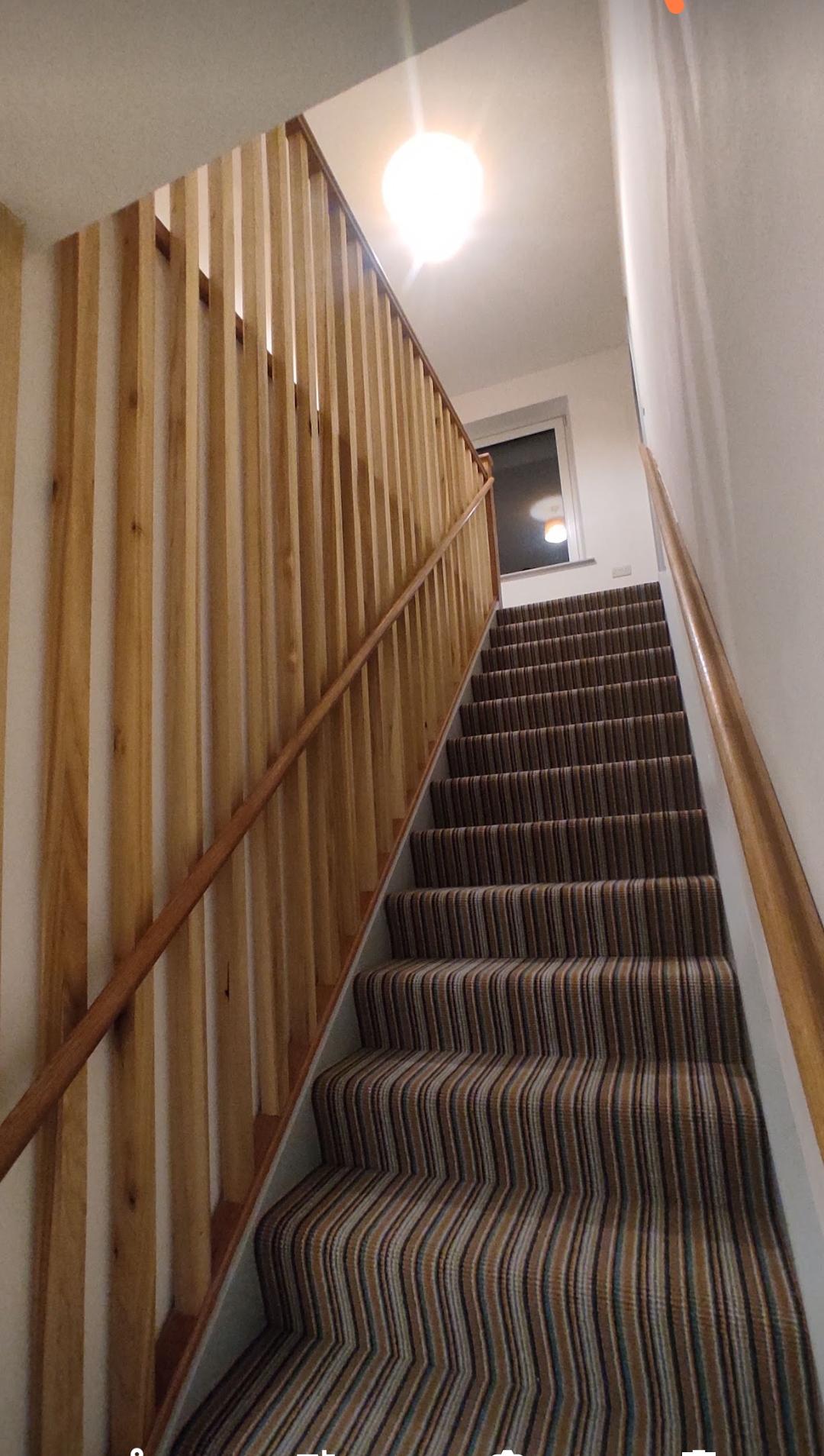

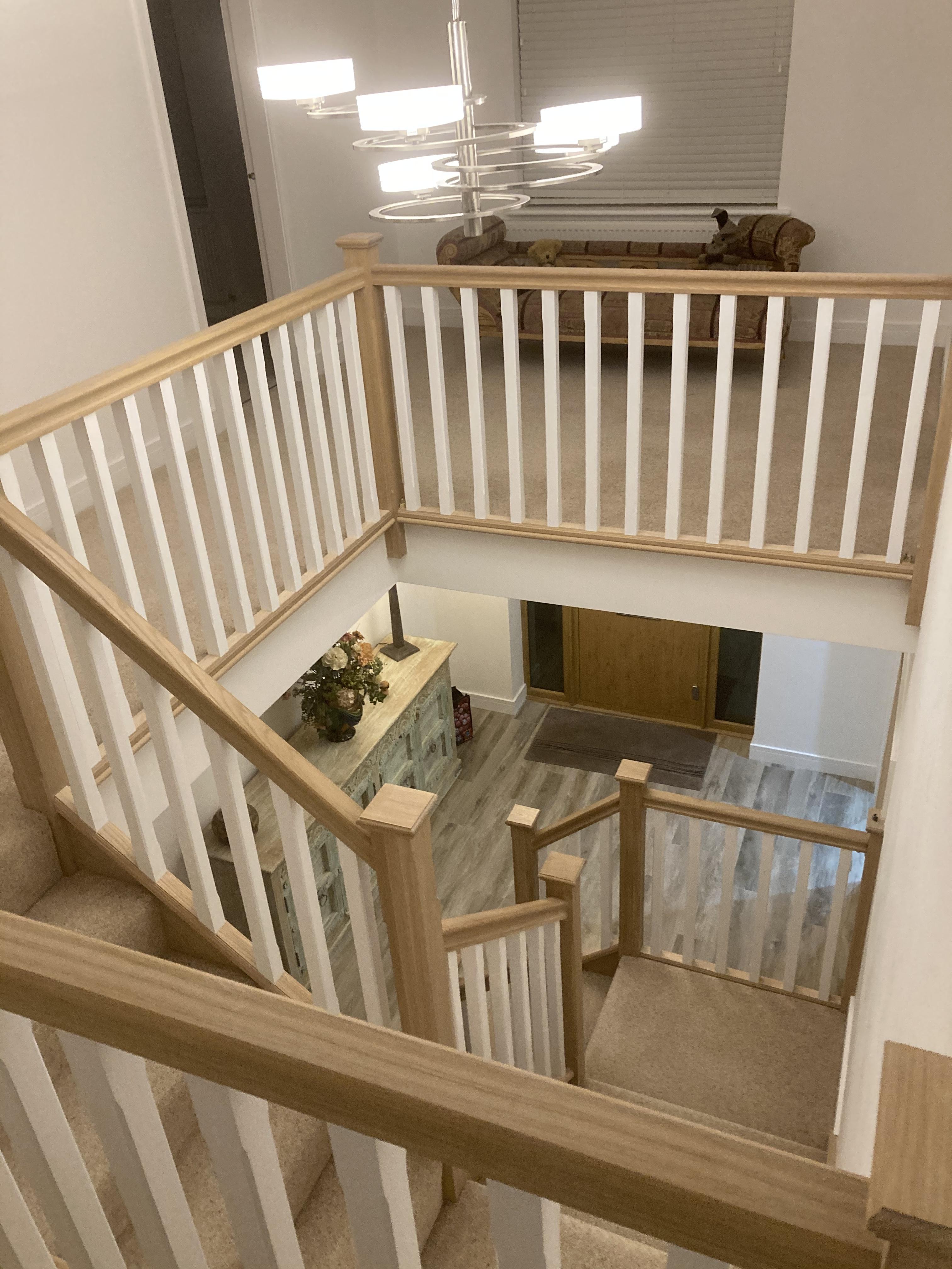

Iceverge Posted March 25 Share Posted March 25 Pit ours in before spray painting. Bit of a PITA masking it. Pine and painted and carpeted. Oak handrails and popular spindles. Pleased with the carpet. Would do the same again. Oak is fine. Maybe a lighter wood would be nicer. 1 Link to comment Share on other sites More sharing options...

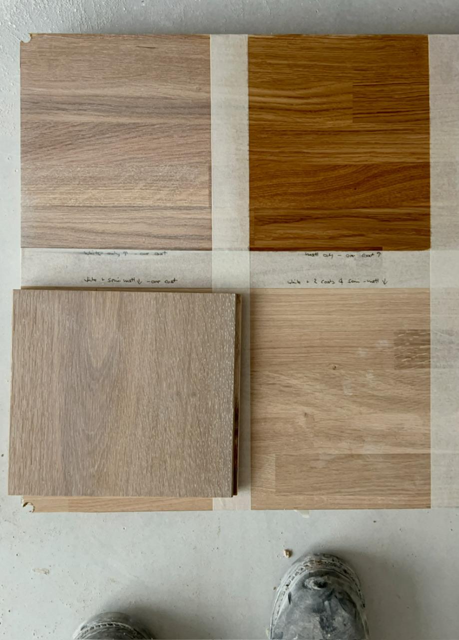

Kelvin Posted March 25 Share Posted March 25 1 hour ago, Bramco said: Ours went in pretty late and like @Kelvin it's oak and it was protected by cladding with hardboard and plastic sheeting. We used a light (whiteish) Osmo oil on ours - no carpets - everyone to their own.. Simon Can you share a picture ig your whiteish osmo coating. I have both that and clear and can’t make my mind up what to use. The floor upstairs is oak and whiteish so either had to match or be very different. 1 Link to comment Share on other sites More sharing options...
Bramco Posted March 25 Share Posted March 25 13 minutes ago, Kelvin said: Can you share a picture ig your whiteish osmo coating. Hi Kelvin, take a look on our architects web site, lots of photos -> https://lhc.net/projects/ashcroft-creating-a-low-energy-family-home/. If you need a close up I can sort one out. Our 1st floor is also light oak (Brooks - Balmoral Rustic Oak). So the stairs and the 1st floor flooring were both treated with the Osmo oil. The Osmo oil label just says '3040 White'. We're not keen on oak when it goes orange, hence the use of Osmo white oil. We bought some samples from Osmo and tested them out on a sample of the wood that would be used for the stairs before deciding which one to use. Simon 1 Link to comment Share on other sites More sharing options...

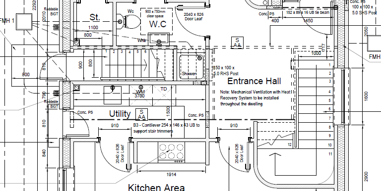

CalvinHobbes Posted March 25 Author Share Posted March 25 Thanks, right so we have some time then! Thanks for the advice. Unfortunately we need non standard height Set 1 is Ground Floor - First Floor: 15 No. Risers at 199.4mm 14 No. Goings at 220mm Total Rise = 2991mm Pitch = 42 degrees Set 2 is Staircase to comply with Technical Booklet H (2012). Stair to have clear width of 800mm and be fitted with handrail at a height of 900mm above pitch line above stair. See General Notes. Ground Floor - First Floor: 15 No. Risers at 199.4mm 14 No. Goings at 250mm Total Rise = 2991mm Pitch = 39 degrees I know its a bit odd but frankly it gives our grown up kids a separate area and access Link to comment Share on other sites More sharing options...

Kelvin Posted March 25 Share Posted March 25 2 hours ago, Bramco said: Hi Kelvin, take a look on our architects web site, lots of photos -> https://lhc.net/projects/ashcroft-creating-a-low-energy-family-home/. If you need a close up I can sort one out. Our 1st floor is also light oak (Brooks - Balmoral Rustic Oak). So the stairs and the 1st floor flooring were both treated with the Osmo oil. The Osmo oil label just says '3040 White'. We're not keen on oak when it goes orange, hence the use of Osmo white oil. We bought some samples from Osmo and tested them out on a sample of the wood that would be used for the stairs before deciding which one to use. Simon That’s a lovely house. i’m not keen on the orange either. I’ve done a trial to match the floor. It’s close. Top left is painted using the Osmo white. Bottom left is the floor. Top right is Osmo clear and bottom right is untreated. Link to comment Share on other sites More sharing options...
Bramco Posted March 25 Share Posted March 25 1 minute ago, Kelvin said: That’s a lovely house Thanks - the architect is our son - we think he's done us proud! 2 minutes ago, Kelvin said: Top left is painted using the Osmo white. That's about what ours looks like - I think there were 3 coats on the stairs, not sure about the floor though. Simon Link to comment Share on other sites More sharing options...

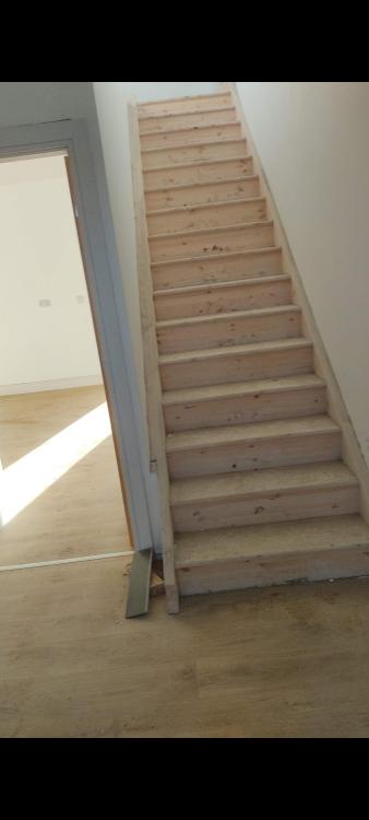

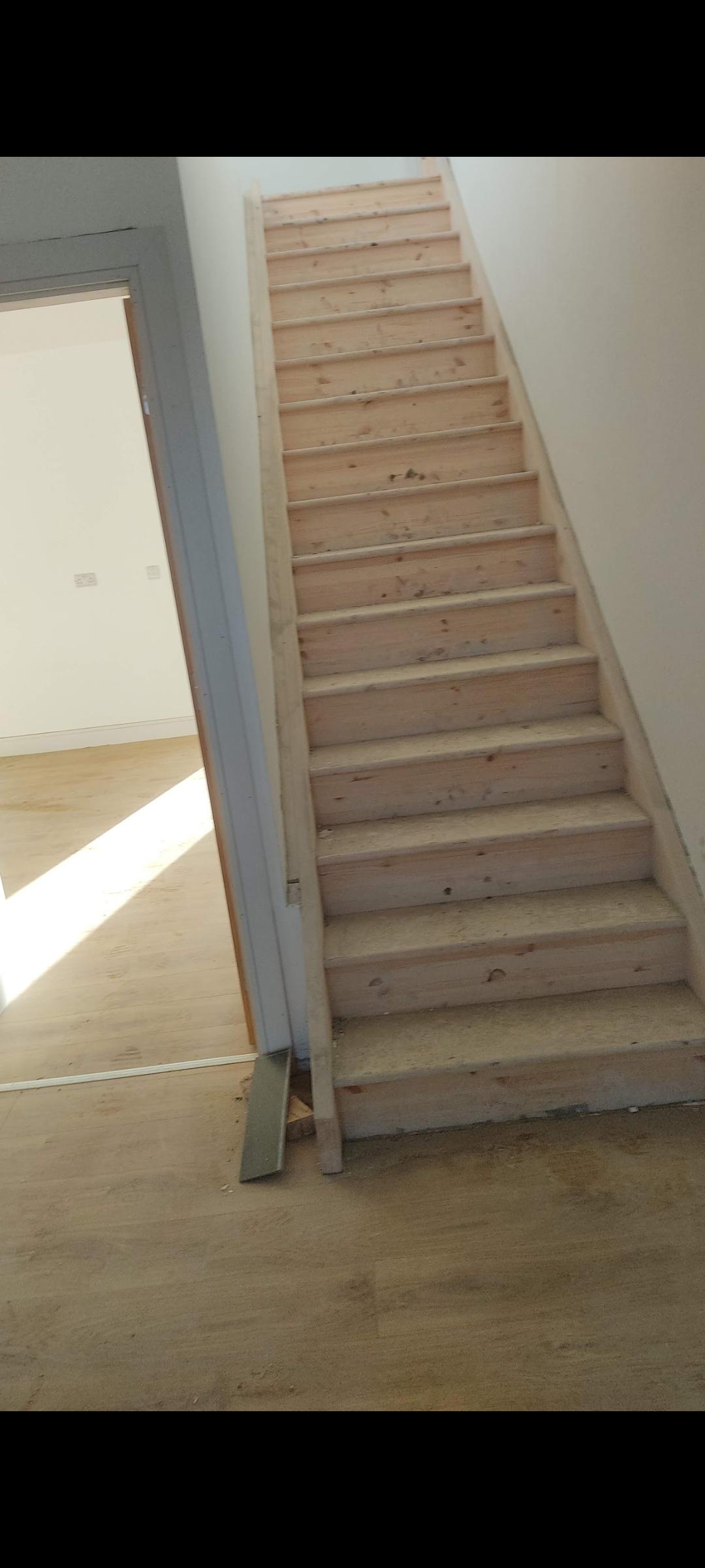

shuff27 Posted March 26 Share Posted March 26 My chippies made a sturdy temp staircase out of scrap timber (mainly left over from the timber frame package) for £200 & installed it shortly after the plasterers had finished the final skim coat. The design more or less mirrored what I wanted for my permanent staircase, albeit with narrower treads. They came back about a week before we moved in to remove the temp 2 flights of stairs & install the permanent ones. I kept the same half landing as it was already in the correct position (laid vinyl click flooring on the board, same as on the GF) & they attached a hardwood fascia to the pine. Where the temp stringers were removed there were just a few small areas of bare plaster to paint. My staircase is made from ash by a local joinery, with glass balustrades - I didn't want oak (too common!) so I visited their workshop to look at various hardwood samples. I've left the ash untreated as I prefer that look & don't have young kids or pets to worry about. Link to comment Share on other sites More sharing options...

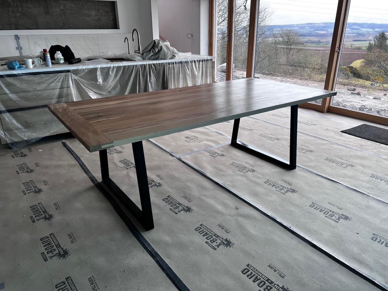

Kelvin Posted March 26 Share Posted March 26 Ash is lovely. We had a table made from ash. 1 Link to comment Share on other sites More sharing options...
