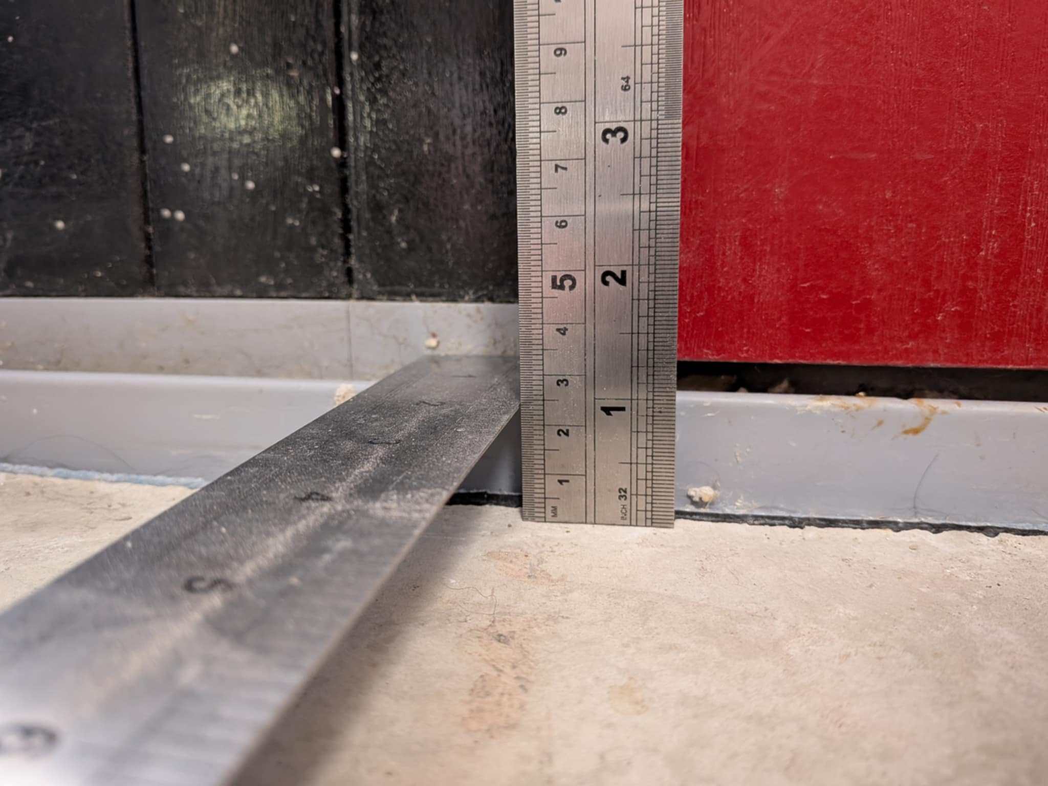

  1. So upstairs hasn't been floored yet, but when it's walked on we are hearing it a bit too much. So wondering what the best acoustic solution would be given we have 12mm approx to work with. Cork? rubber? lvt, laminate? Head is done in so wondered anyone with experience of similar here and the solution. We have a dog that wanders upstairs. Cheers yet again. Daughters room pictured.

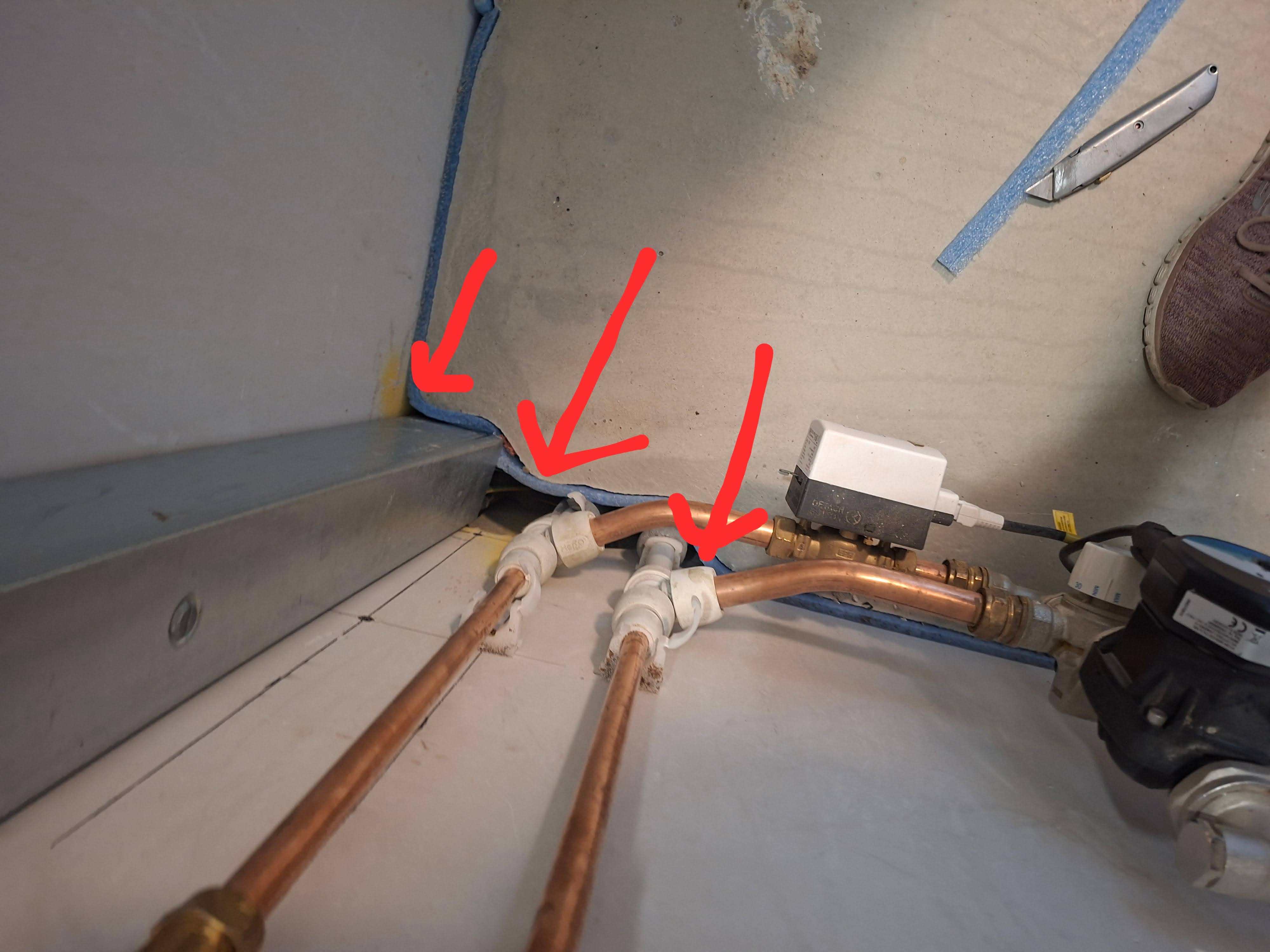

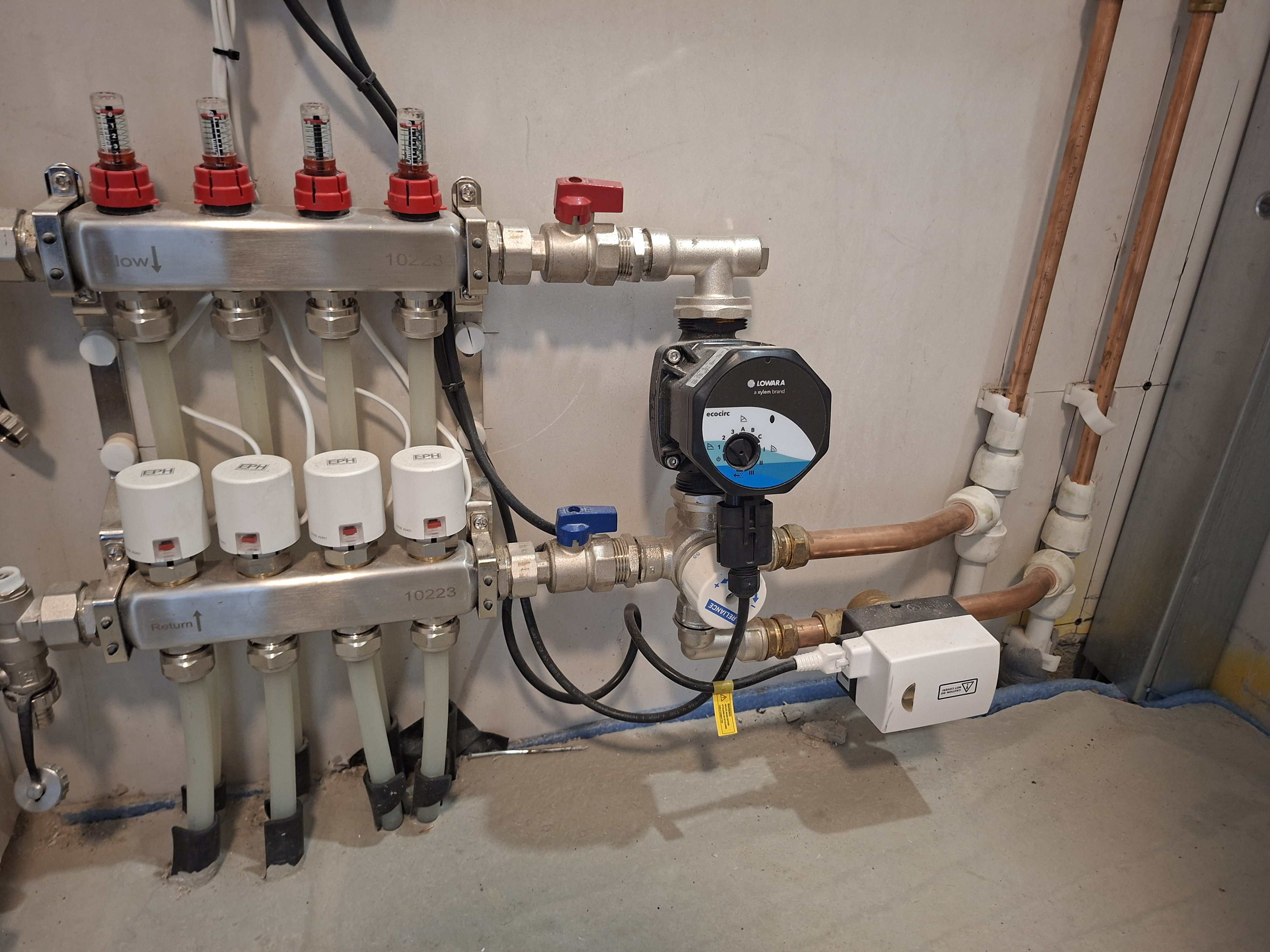

  7. Hello, I am chasing up certs for Building Control in NI. One of the things is a copy of the install id for the inverted heating system. We had our builders who have 2 family members who installed our underfloor heating and ashp. Then they had a separate guy commission the heat pump. The builders/plumbers a;so installed our water tank/plumbing. Who is meant to give this certificate or copy of the install id? The builders or the commissioners and where can i get a blank copy for them to sign? Thanks

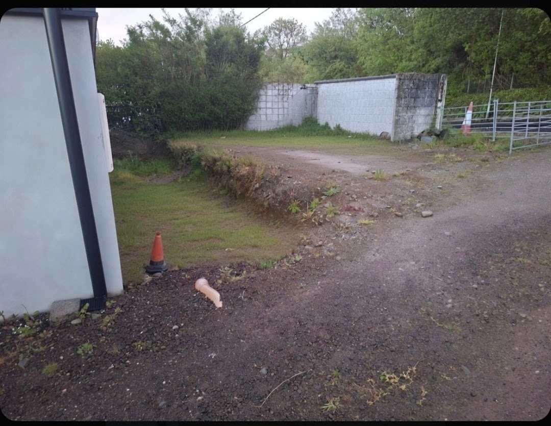

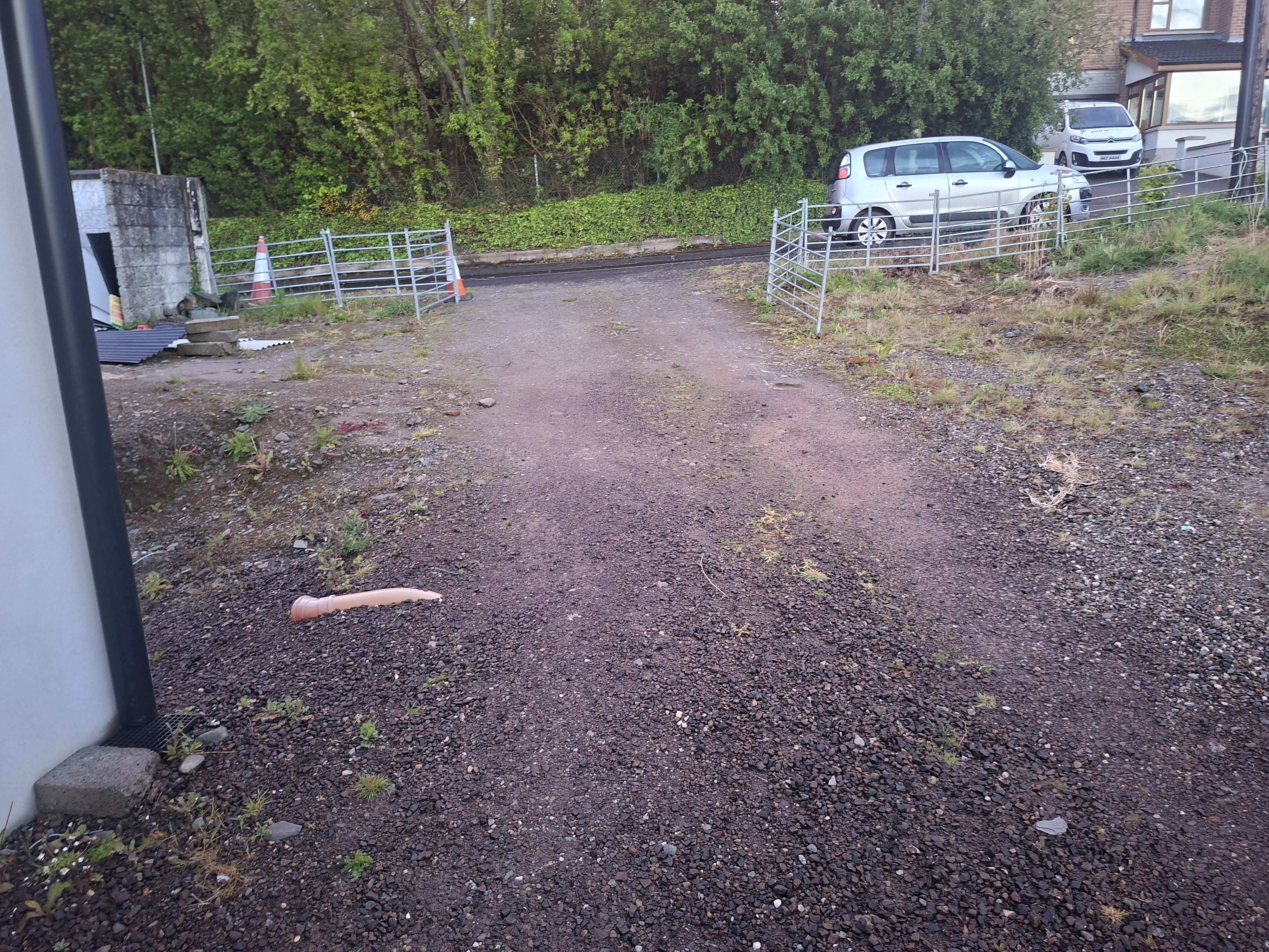

  9. Forgive me for coming back at this, I asked before re a path around the rear of the house and patio area. Our planning says we need semi permeable. We have groundsman coming back tomorrow night. First time he came he said just use gravel and we didn't need any drains/pipes at the bottom of the slope above patio, he would just widen it a bit as requested and slope. I think we need a drain, it rains a lot here. Also now is the time to do it. Advice from here was to use MOT for the path. I think mot1 isn't permeable but mot 3 is, was thinking of putting 14mm on top of donegal quartz 14mm on top in the second stage. Second stage too we will drop kerb, it will be moving the entry slighty to the right, where the silver citroen is parked. We looked at a new builds nearby they all use paving slabs. Any thoughts, it would be really appreciated. That brown pipe just was temporary it was just for rodding drains.

  12. Hi we have the house up and ramp entrance to porch. Driveway is gravel because sisters site is up to ground level and hopefully will be tackled soon. We really just want the length of the house at the back with some surface we can walk on and not spend a fortune. Hard ask I know these days. Have a groundsman gonna come and clear rubble, do dropped kerb etc. But he suggested putting 20mm gravel in back. its about 7ft between the house and the hedge and about 50ft long. Any suggestions other than 20mm gravel? Our budget is tight. Climate is wet so saw some 10mm granite stone, far nicer in a stately home with I think 2 x 4

  18. I thought the pipes going in and out of the ASHP should be insulated and that a kit came with it but I was told not for this kind. Is this correct?
