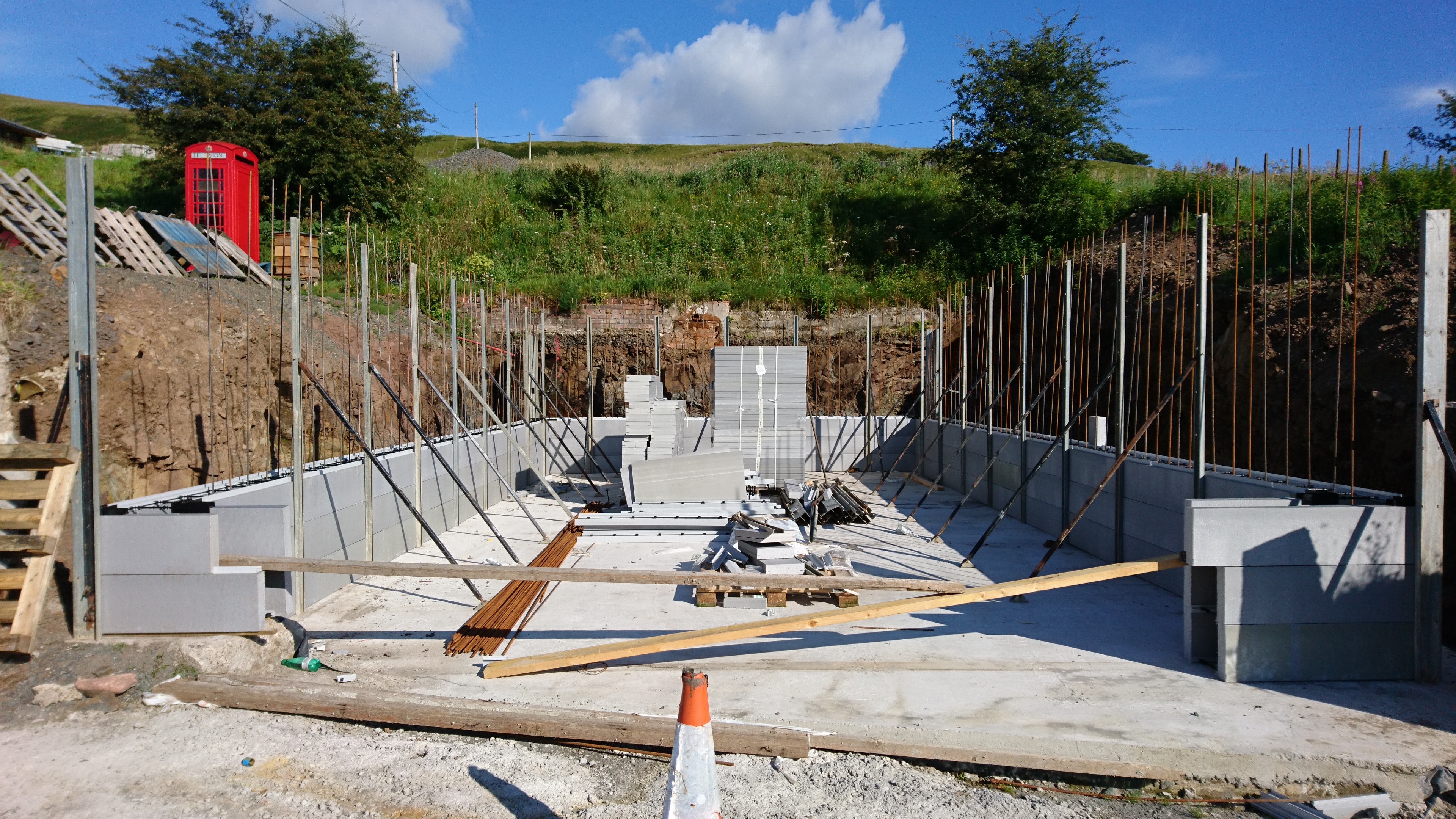

ToughButterCup Posted August 9, 2017 Share Posted August 9, 2017 If you haven't read the backstory, it's here. and an analysis of what happened is here Quick Summary One turbulent night a little while ago, our wall blew down during a newbuild. It was unlucky: just the wrong weather at just the wrong moment. Our builder says that there was no guidance on the ICF producer's website. Verbally , the MD implied that the builder lacked common sense in building so high without pouring to stabilise the build. The production company give no specific guidance on how high to build before pouring or propping. The Loss Adjuster visited last week, and today, the Insurance company has sent me this email: in brief, it's the builder's fault. He should have braced the build,or poured. Here, verbatim (anonymised) is the response from the Loss adjuster. Following a review of our Surveyors report I note that the blocks had been dry stacked. The builder appears to have laid out too many course of block, without being filled with concrete or propped in the interim whilst await the concrete pour. Our Surveyor states that the safe working method would be prop any loose block work when dry stacked and that this ought to have been done until the concrete was poured. The policy provides cover on an All Risks basis, subject to certain exclusions. One such exclusion has material relevance to the claim at hand:- 7 Defective Property Loss of or damage to and the costs necessary to replace, repair or rectify the Insured Property: a) which is in a defective condition due to a defect in design, plan, specification, materials or workmanship of which Insured Property or any part thereof Based on the information available to us the only reasonable conclusion is that the wall would not have collapsed had in been propped. Following my verbal explanation as to the lack of policy cover available you advised that further information will be made available to support the claim, specifically weather records from Cambridge (sic!) University confirming a gust of 70mph was responsible for the wall being blown down and a time lapse video to show the wall had been built correctly. Ok, folks if this had happened to you, what would you do next? Link to comment Share on other sites More sharing options...

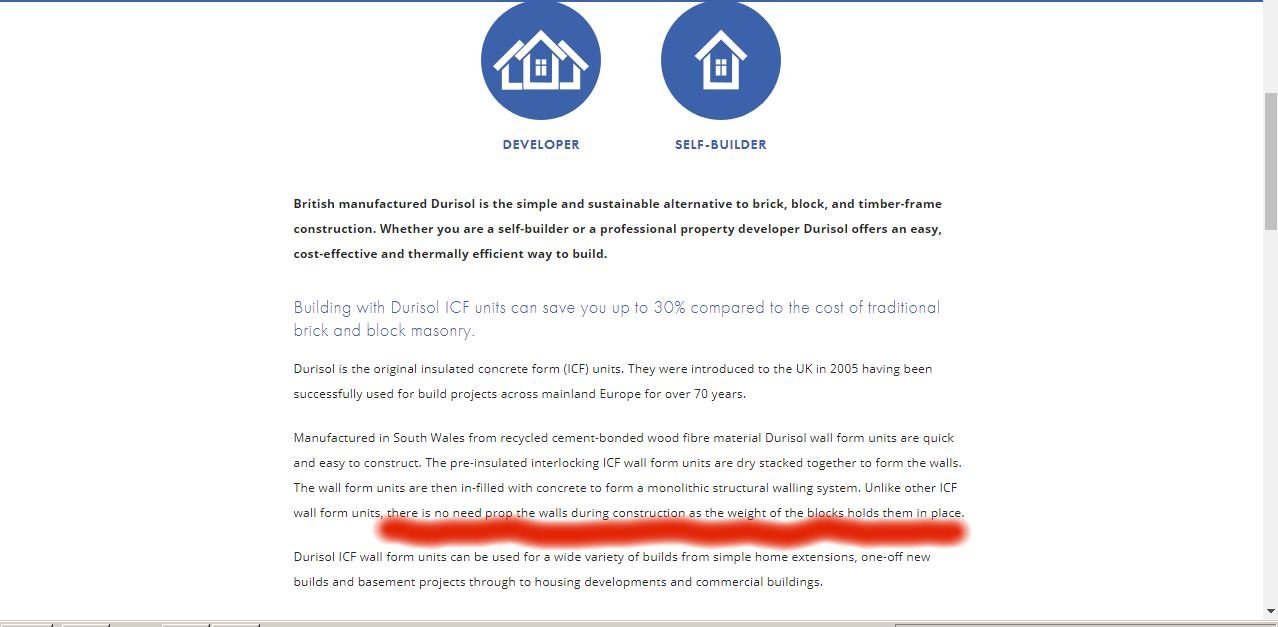

Onoff Posted August 9, 2017 Share Posted August 9, 2017 Home page of the Durisol site: Link to comment Share on other sites More sharing options...
ToughButterCup Posted August 9, 2017 Author Share Posted August 9, 2017 £1200 plus fiddling and messing about. Yes @Onoff, that hadn't escaped our attention. Inclined to do a head-down-arse-up-bye-bye-DIY..... But stuff site insurance from now on. Link to comment Share on other sites More sharing options...
Onoff Posted August 9, 2017 Share Posted August 9, 2017 Fire of that video and wind speed record for a start. If you decide to DIY the project you'll save that £1200 is one way of looking at it. Link to comment Share on other sites More sharing options...

Russell griffiths Posted August 9, 2017 Share Posted August 9, 2017 Did you have to buy new blocks or did durosol replace for free. I think I would be looking at getting some free blocks and taking the cost of the labour on the chin. Did you go on the course was propping mentioned. I work with a bloke who loves to moan he sends off e mails and letters and if he doesn't get his own way he sends off some more, I have never known him not get back what he thinks he is owed. Link to comment Share on other sites More sharing options...

AliG Posted August 9, 2017 Share Posted August 9, 2017 (edited) Unless Durisol specifically recommended propping up the blocks then I would hold them responsible. The Durisol Practical Building Guide makes no mention of propping them either, other than bracing for the concrete pour. http://www.ecomerchant.co.uk/productattachments/index/download?id=59 If this was the instruction the builder received from Durisol it is hard to hold him responsible. However, I can see where the insurance company comes from, how did Durisol come up with this advice - "The weight of the blocks holds them in place" You wouldn't build a blockwork wall with no mortar in it and expect it to stand up in the wind. It seems like crazy guidance where for marketing purposes they are creating a possible problem for their customers. Hence again I would be looking for them to take responsibility. I would also question how they can give this guidance on a blanket basis, some places are much windier than others. So yes, you need to get on with building, but I would be much more inclined to fight Durisol than the insurance company. In fairness to insurance companies they are supposed to be insuring unusual and unexpected events. Most people would expect an unsupported wall to fall over in wind. Edited August 9, 2017 by AliG Link to comment Share on other sites More sharing options...
Jeremy Harris Posted August 9, 2017 Share Posted August 9, 2017 (edited) It's worth a go at the insurers, quoting the Durisol information, before writing off £1200. With my semi-professional, expert witness, hat on, if this were my field of expertise, and if I were writing a report for an insurer, then I would make it clear that the liability rested with them. The majority of my work is for insurance companies, usually trying to avoid paying out claims, and, in my experience, they are pretty canny when it comes to assessing the costs, when faced with someone that isn't going to roll over and accept liability. I've seen many cases where I've undertaken a couple of thousand pounds or more of work, on behalf of an insurance company, concluded that the insurer had no liability at all, only to find that the insurance company settles for a few thousand pounds rather than face going to court. I get paid either way, but the first few times this happened I did get a bit annoyed, mainly because paying out when they didn't need to encourages more dubious claims. If I were in your position I would contest the surveyors report and the insurance companies initial decision, provide the evidence from Durisol, provide evidence that both you and the builder were trained by Durisol, and state clearly that if they do not settle this claim you will consider taking it through the small claims track at the county court. I will happily bet you a pint that they will just cough up the £1200, or something close to it, rather than pay out for an expert opinion. Expert opinions are costly - I currently charge just under the CAA rate, £160/hour, with no VAT................ Edited August 9, 2017 by JSHarris 1 Link to comment Share on other sites More sharing options...
