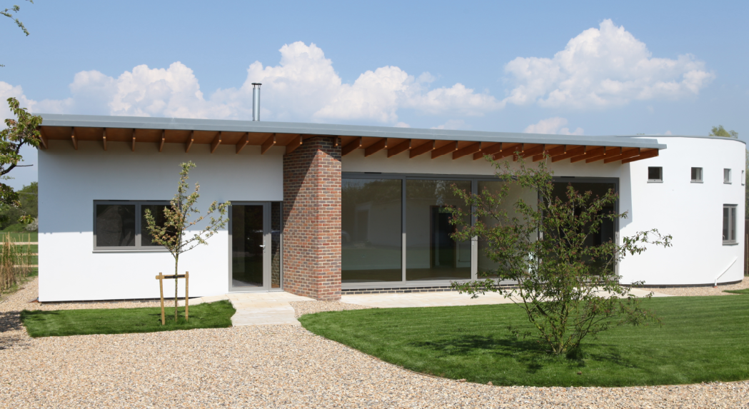

This essentially is a box, with extra glazing. It is three rectangular boxes sat on top of each other, it was specifically designed to be simple to build.
I previously spoke with a turnkey builder that specialises in mansions on the Wentworth estate and even they'd build you a palatial spec house for sub £5k.
This house is quite similar in spec to what I'd be looking to achieve - https://www.rightmove.co.uk/properties/130717802#/?channel=RES_BUY

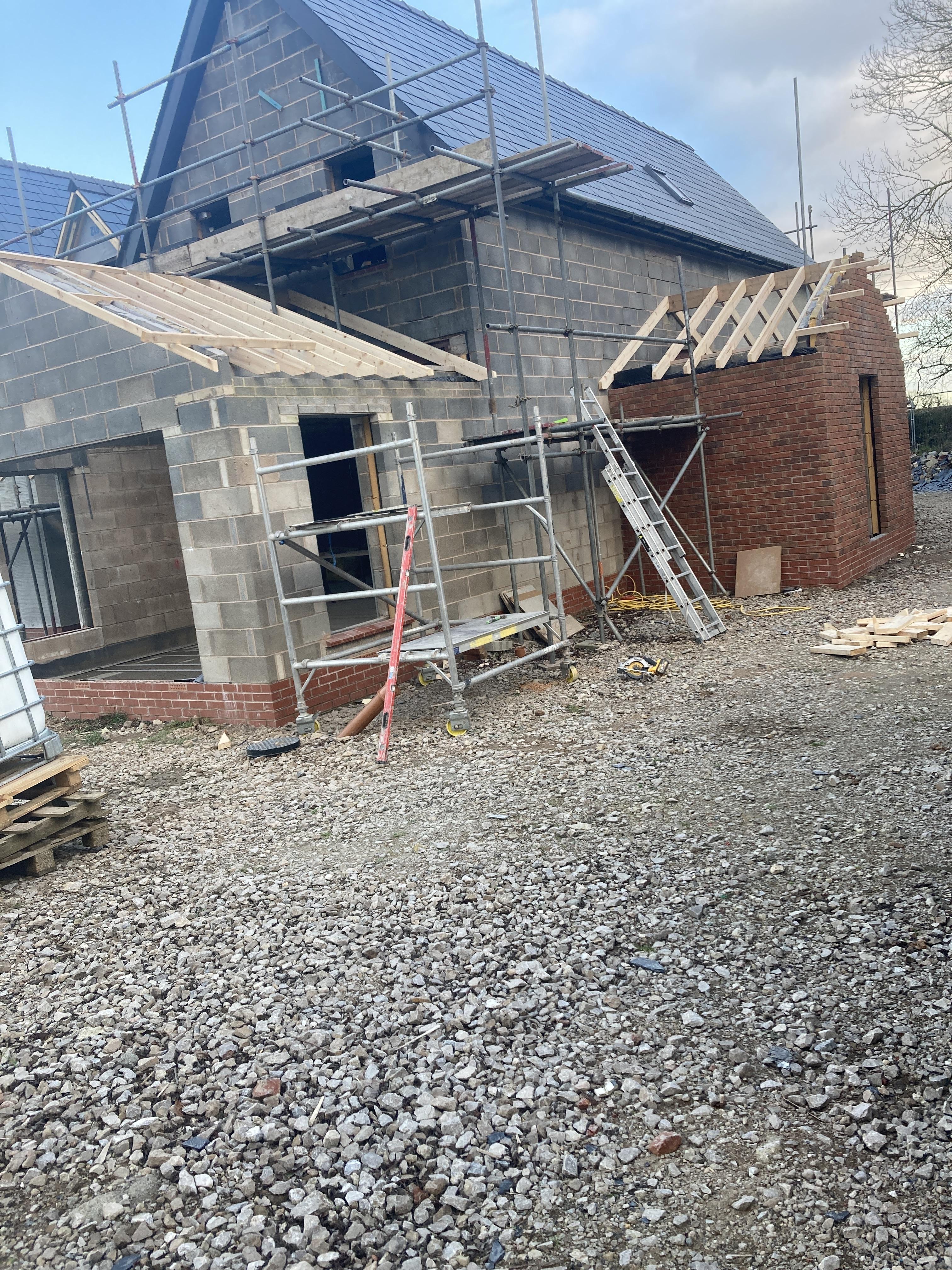

Posted
2 hours ago, nod said:
£815
Pre the wold going mad
Others on here will tell you that to keep the costs low it’s full on
Slating first thing joists from mid morning
Just myself and my wife
