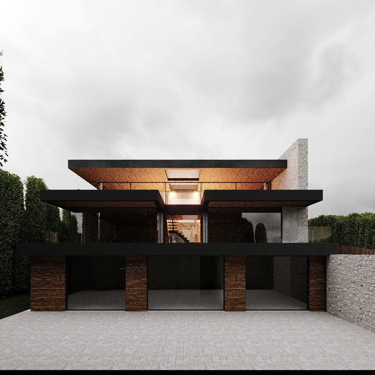

Are these costs realistic for a 500m2 house
I'm about to start building on my contemporary 500m2 house. Planning ended up taking 2 years longer than expected to get, so while the original plan was to give the whole project to a single builder, the increase in construction costs during the past 2 years have put this option out of my budget. I'm now going to be project managing the build and sub-contracting out the work.
I've put together my list of expected costs and the total comes out at £794,750 (£1590 per sqm). The house will be three storeys, with a semi-submerged basement and a two storey timber frame sat on top. 4 bedrooms, all with en-suites. Cladding will be burnt larch and polished plaster.
The confirmed costs so far are for the basement (includes prelims, site clearance, excavation, muck away, waterproofing and drainage), timber frame (supply and erection) and professional fees (engineer + architect). Everything else is ball park at the moment. Utility connections will be simple to this site.
Do any of the below costs stand out as too high/low? I'm also looking for any suggestions on where I could save money as at my estimated build cost, a lot of stuff is going to end up being put on credit cards. Some places I thought I could save is on the flooring and kitchen - I'll be using engineered oak flooring but happy to buy used, same with the kitchen. I'll have about 6 months to source some good deals on these items, which could substantially lower their cost.

Big cost is the basement do you need it, will you use it? Why do you need 500m2?
Big area - big costs, £1500 m2 sounds on the low side, for someone else doing the work.
Can't coment on the breakdown, but I'd suggest closer to £2000 to £2500psqm build only, spec dependant.
Worth getting an online QS service to give you a ballpark.

what size is the footprint of the building? I presume 166m2 (500m2 / 3 ).
burnt larch is expensive (ask me how i know! 😉 ). what is the area being cladded in that?
it's really hard to give an opinion on costs without knowing sizes etc. e.g. screed costs? liquid or sand/cement? area of screed?
project managing will save you money but unless you're getting your hands dirty i don't think you'll hit the £1500/m2. as others have said £2k - £2.5k is more likely.

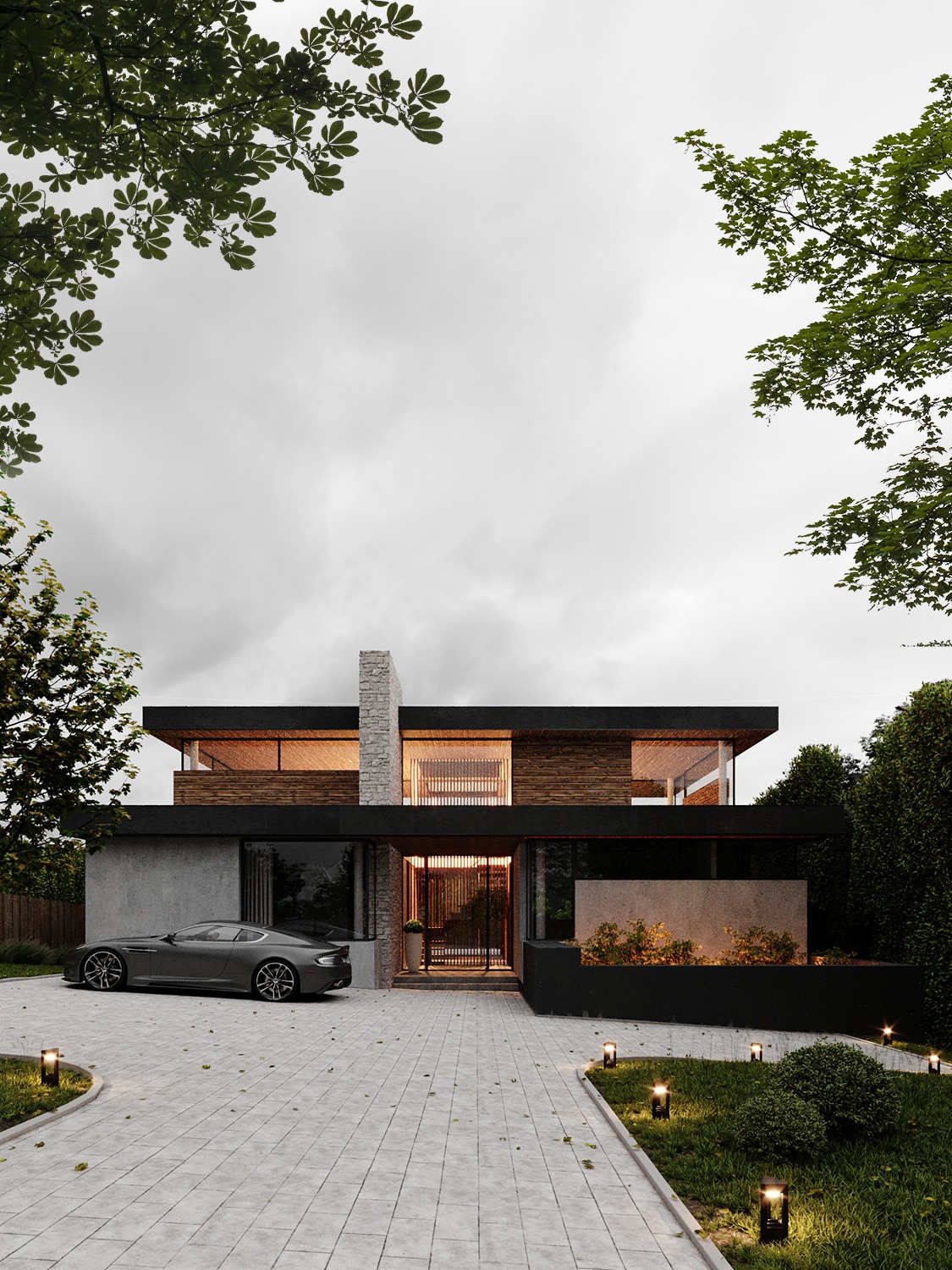

Basement is actually 250m2, middle floor is 175m2 and top floor is 75m2. The area being clad with the larch isn't actually huge, the majority is render and as the bulk of the house is underground, so it's more like cladding a 300m2 house than a 500m2 one. I've budgeted £80m2 for the supply of the burnt larch though.
There's some economies of scale with the third floor, the cost to add that extra space is pretty minimal which helps bring the overall average down.

sounds amazing. maybe you can share some drawings!
i got my burnt larch from Permachar. they were the cheapest i found in the UK. the wood comes from Lithuania but when i tried to contact the factory directly in Lithuania they just redirected my enquiry to Permachar. Also, the more you buy the cheaper it becomes. tip.....don't under order as when you have to purchase more you won't get the bulk discount price! i made that mistake and it was pretty costly.

stunning. i really do hope you post your progress on here. i, for one, would love to follow your build.
and well done on having a Lithuanian mate! 🙂 just in case you didn't know, the Lithuanian company that actually made my burnt larch was https://degmeda.eu/

If you are suggesting putting costs on credit cards it does not sound like you have much room to manoeuvre.
I think the cost is unrealistically low for what will supposedly be a £3m house. You cannot skimp on material quality on that value of house.
As well as some of the individual figures being low, there are the inevitable small items that you don't realise you need until it is costed.
A few things -
1. Fire stopping for the timber frame. £5k+
2.Powder coated aluminium around the roof edges on the pictures. that will cost £50-100 per linear metre fitted. Looks like you might have £10k there.
3. Flat roofs can be surprisingly expensive especially when you include parapets and any features such as water outlets, concealed gutters etc. Plus the cost of boarding the roof, firing strips to create water runs and so on. I think you could be considerably more than your estimate. Depends how much of it is part of the frame.
4. £25k for a kitchen. Maybe doable if you get a used kitchen, the trouble is getting one that fits the plan. A new kitchen for this style of house would have around £10k in equipment in it alone.
5. Presumably you will need 2 stairways. I would be looking at something maybe wood and glass in this style of house, plus balustrades. At least double your estimate depending on the amount of balustrade.
6. Decoration - Assuming that half the floors are tiled/engineered wood. That is £80 a square metre, so £20k, You will have around 100sq metres of tiling in the other bathrooms/en suites so that is £8k. Your £14k estimate might cover the painting for this size of house. Maybe some of this is in the floors/ceilings number.
7. Do you plan on having any fitted wardrobes and a utility room - Maybe another £5-10k.
8. SF Joiner - Doors plus ironmongery plus frames and fitting will be at least £500 a door. Including skirting this number might be more like £15k.
9. Landscaping can be extremely expensive depending on the area of driveways, walls, garden etc. Assume around £100 a sq metre for hard landscaping.
10 Vapour membranes, air tightness tape, silicone etc can run into a good few thousand.
Plumbing and heating look OK.
Net net I think the £2000-2500 range is a much better estimate.
Best thing to do would be to try and get some firm quotes for the larger figures especially the roof.

Budget is tight because I'm attempting to do it without a mortgage. There'd be an additional ~£500k available if I did opt for one but I run my own company and haven't paid myself a salary this year as I've been reinvesting all the profits back into the company, so getting a mortgage now would be a big pain.
2. Roof edges haven't been specced yet. I'm looking at simply rendering them or potentially a black charred wood cladding which I've seen used quite effectively.
4. For the kitchen, if I didn't find a suitable ex-display or used one, I'm going to buy the carcasses from B&Q then purchases premium doors from a separate company so you can get the expensive look without spending a huge amount. Equipment wise, I'd be looking at £2k on an induction hob with built in extraction fan and 2.5k on a built in oven. Add a £400 no-name wine fridge and people will assume the whole kitchen must have cost a lot.
5. Correct on the two stairs. The estimate was based on figures I got from an ironmonger to make the skeleton of the stairs and then fit timber steps. The quotes for the stairs were all over the place though - I sent the same plans and reference pictures to several stair companies and they were quoting 80k+ but ironmongers with joiners were quoting <10k.
6. The engineered wood floor pricing is within the the 'floor' category. I can source this at £30 sqm but will be used throughout the house. Tiling is going to be kept to a minimum in bathrooms, pretty much only in the showers.
Roof is the big unknown one currently though, which I'm trying to nail down.
Respectfully, if I saw a kitchen in a house like this with a single built-in oven, my first assumption would be that you'd run out of money by the time you got to the kitchen!
My general feeling is that you seem willing to sacrifice a lot of quality in order to get a very large house on an extremely tight budget. Maybe you'll be happy with that, but my own experience is that we really regretted some of the cost saving decisions we made, and we weren't working to anything like the budget constraints you've set.
