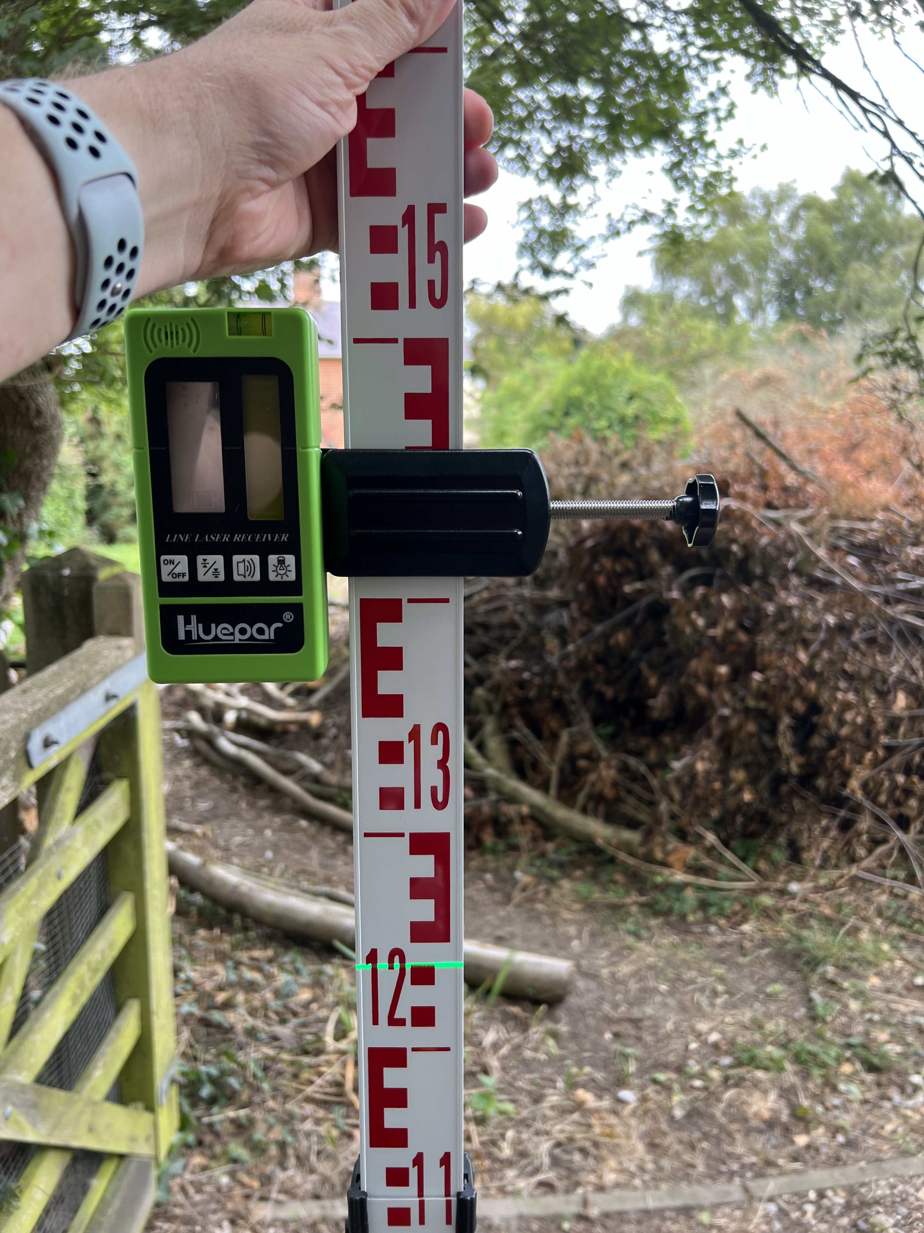

zzPaulzz Posted August 5, 2024 Posted August 5, 2024 (edited) Used my Heupar S04CG-5RG to do a basic (very) survey of my site. It worked very well once I got the hang of using the receiver. Seems to have a reliable range in sunlight of at least 30m. Edited August 5, 2024 by zzPaulzz 1
saveasteading Posted August 6, 2024 Posted August 6, 2024 12 hours ago, zzPaulzz said: reliable range I don't know what you will be using it for. Just to say that the seemingly accurate range can wander off if used too casually. The way you use it too. Are there instructions about, for example, equal backsight and foresight? Maybe I value accuracy more than most. Houses are very approximate usually, and mostly it isn't a big deal. Drains not running is important though.
zzPaulzz Posted August 6, 2024 Posted August 6, 2024 Fair points. I haven’t evaluated its accuracy so will not bet the house on it. Even then I don’t trust my skills here so I will leave the real surveying to the ground works contractor as there’s a main sewer to move as well as prepping for the foundation pad.
saveasteading Posted August 6, 2024 Posted August 6, 2024 2 hours ago, zzPaulzz said: I will leave the real surveying to the ground works contractor That is my unspoken concern. Using lasers , people seem to think everything will be fine. I've had huge errors by letting them get on with it. Lots of block cutting, as usually the concrete is too high. I'm maybe old fashioned but I like working levels to be pre-marked. eg battens up to footing level, or nails banged into trench sides. (or proper motorway stuff of profiles.) Then they are just pouring concrete, not juggling a staff as well. Or you watch their skill level and do the odd check after hours. The equipment benefits too as it isn't covered in concrete or knocked or driven over. More advice upon request after you've searched the interweb for advice.
zzPaulzz Posted August 6, 2024 Posted August 6, 2024 That’s great advice, thank you. I know just what you mean after my first attempt. Consistency must be key, and physical markers have their part to play.
