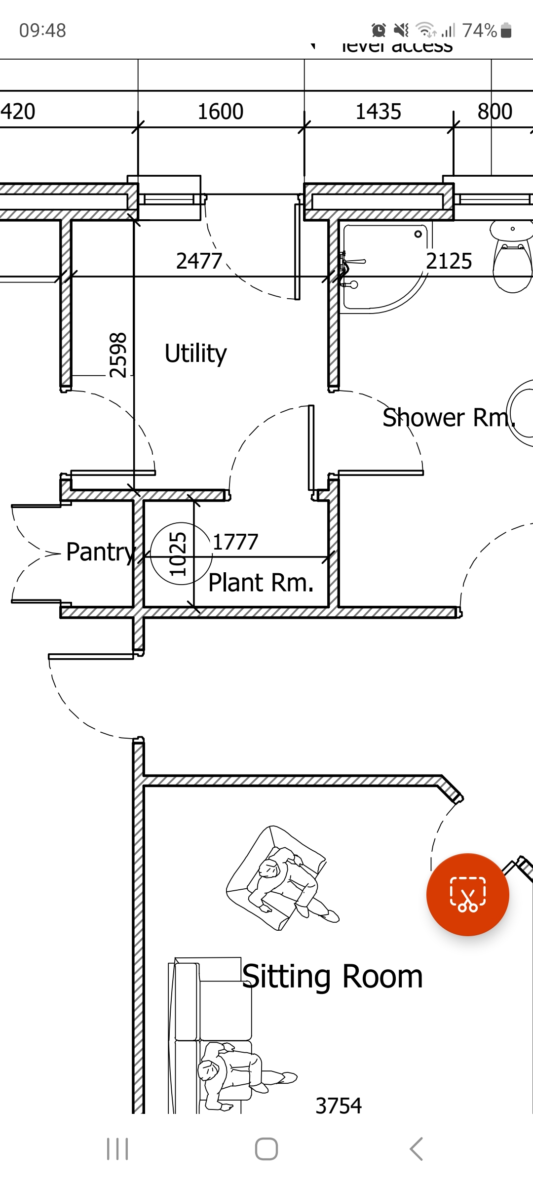

LnP Posted November 22, 2022 Share Posted November 22, 2022 (edited) I'm looking at our new build design and wondering how big the plant room should be. We currently have 2550x950 mm. We're future proofing the house for an ASHP, but will probably initially install a gas boiler, depending on building regs and how the relative price of gas and electricity are looking at the time. So that means under floor heating with all the manifolds and a bigger DHW tank. There will need to be room for the ASHP gubbins. We will have MVHR, but that can go in the loft. Have I missed anything? How big would you advise the plant room should be? Thanks Edited November 22, 2022 by LnP Link to comment Share on other sites More sharing options...

Kelvin Posted November 22, 2022 Share Posted November 22, 2022 Now I’ve looked at your plans you’re probably ok at 950mm as you have double doors across most of the width to give you access. 1 Link to comment Share on other sites More sharing options...

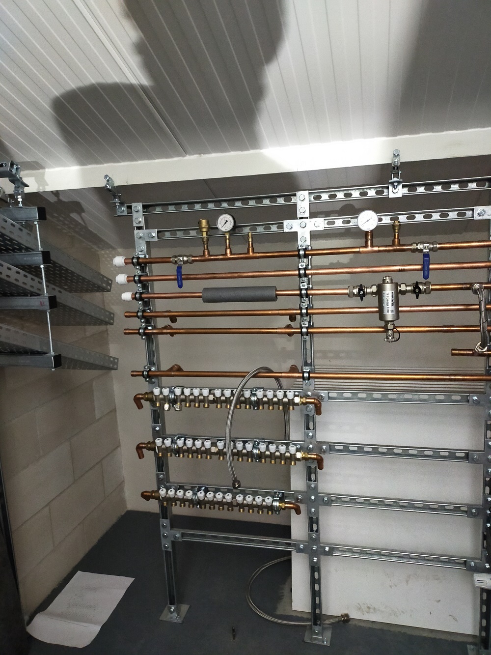

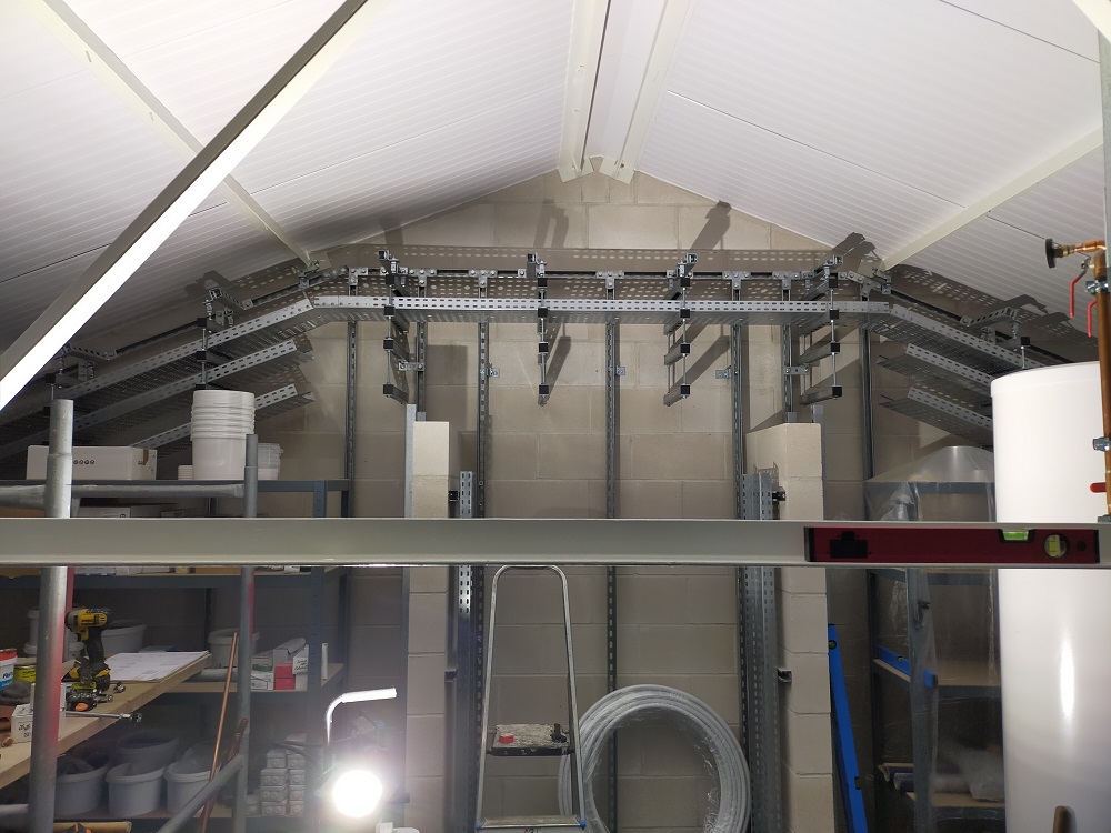

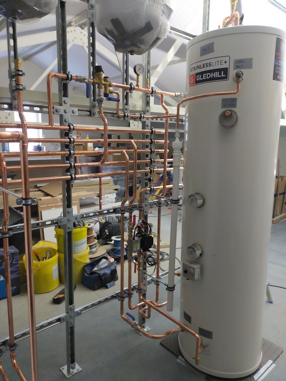

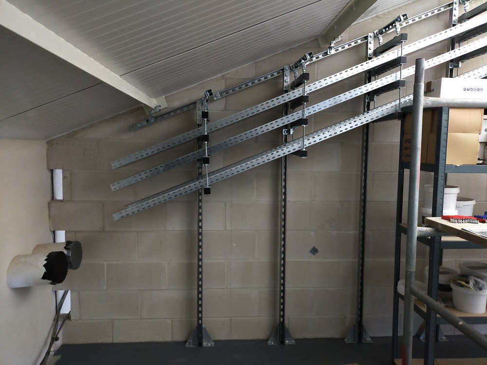

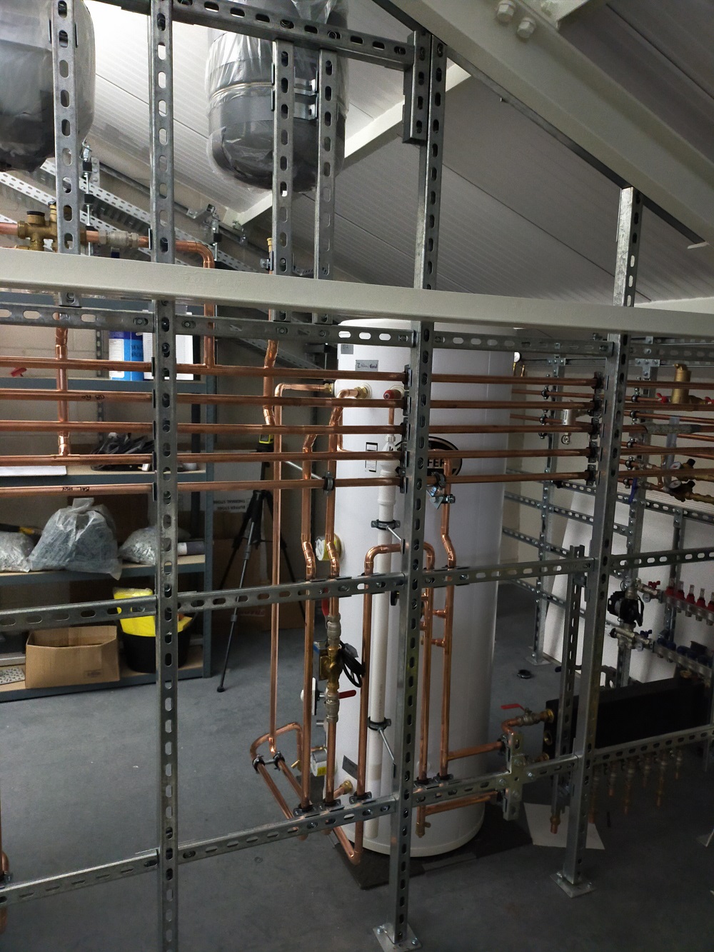

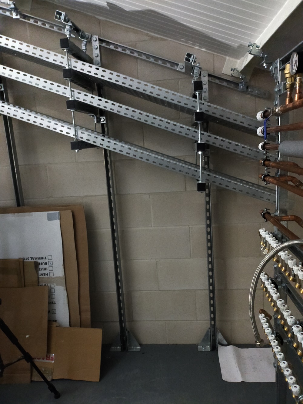

tuftythesquirrel Posted December 21, 2022 Share Posted December 21, 2022 We are quite luck in the sense that we have an upstairs plant room that is about 53m2 (9.5mx5.6m). It was designed to be right in the centre of the house, so wiring, plumbing and MVHR runs are radial in nature, hopefully keeping the length of runs minimised. The area was completely clear so I’ve created some skeletal walls from unistrut, with traywork to carry the wiring, plumbing and ventilation. This saved drilling holes in the plastered walls, which is my airtight barrier and the architectural brickwork. Plus if you have to move anything, you aren’t left with an unsightly hole. I’ve also started to create some partition walls (out of unistrut). It also means you have access to both side to run cables etc. I’ve only got the plumbing in so far, but it seems to be working out quite well (see pics). I don’t see why it wouldn’t work out in a smaller area. 9 Link to comment Share on other sites More sharing options...
LnP Posted December 21, 2022 Author Share Posted December 21, 2022 10 minutes ago, tuftythesquirrel said: We are quite luck in the sense that we have an upstairs plant room that is about 53m2 (9.5mx5.6m). It was designed to be right in the centre of the house, so wiring, plumbing and MVHR runs are radial in nature, hopefully keeping the length of runs minimised. The area was completely clear so I’ve created some skeletal walls from unistrut, with traywork to carry the wiring, plumbing and ventilation. This saved drilling holes in the plastered walls, which is my airtight barrier and the architectural brickwork. Plus if you have to move anything, you aren’t left with an unsightly hole. I’ve also started to create some partition walls (out of unistrut). It also means you have access to both side to run cables etc. I’ve only got the plumbing in so far, but it seems to be working out quite well (see pics). I don’t see why it wouldn’t work out in a smaller area. @tuftythesquirrelYour "plant room" looks amazing! You'll have to give guided tours, it's a work of art! 2 Link to comment Share on other sites More sharing options...
Roys Posted December 21, 2022 Share Posted December 21, 2022 Looks proper, I do like a bit of unistrut 1 Link to comment Share on other sites More sharing options...
tuftythesquirrel Posted December 22, 2022 Share Posted December 22, 2022 10 hours ago, LnP said: Your "plant room" looks amazing! You'll have to give guided tours, it's a work of art! Thanks, it's still a work in progress. I'll leave the tours for my wife - I prefer being on the tools ☺️ 1 Link to comment Share on other sites More sharing options...
