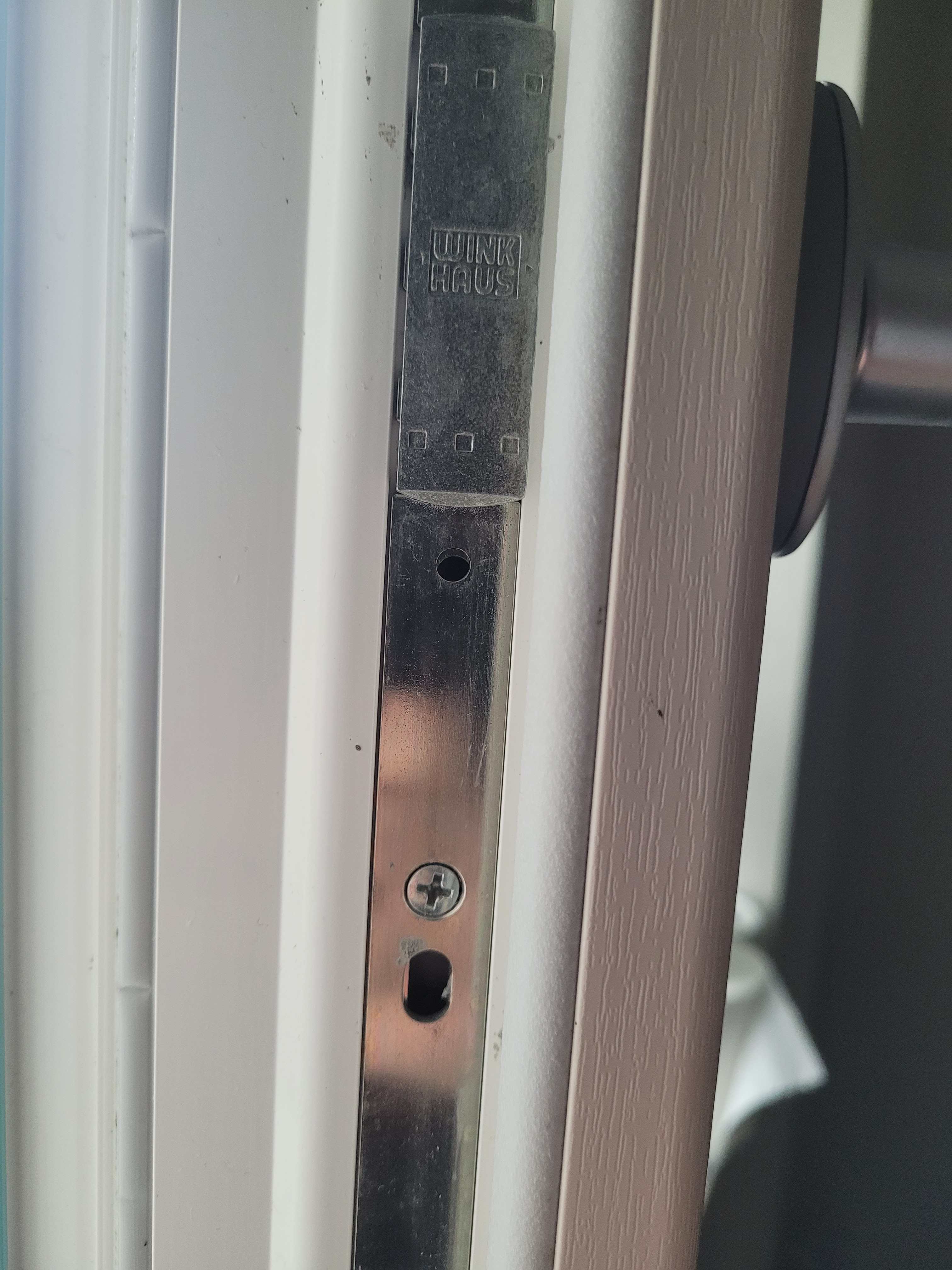

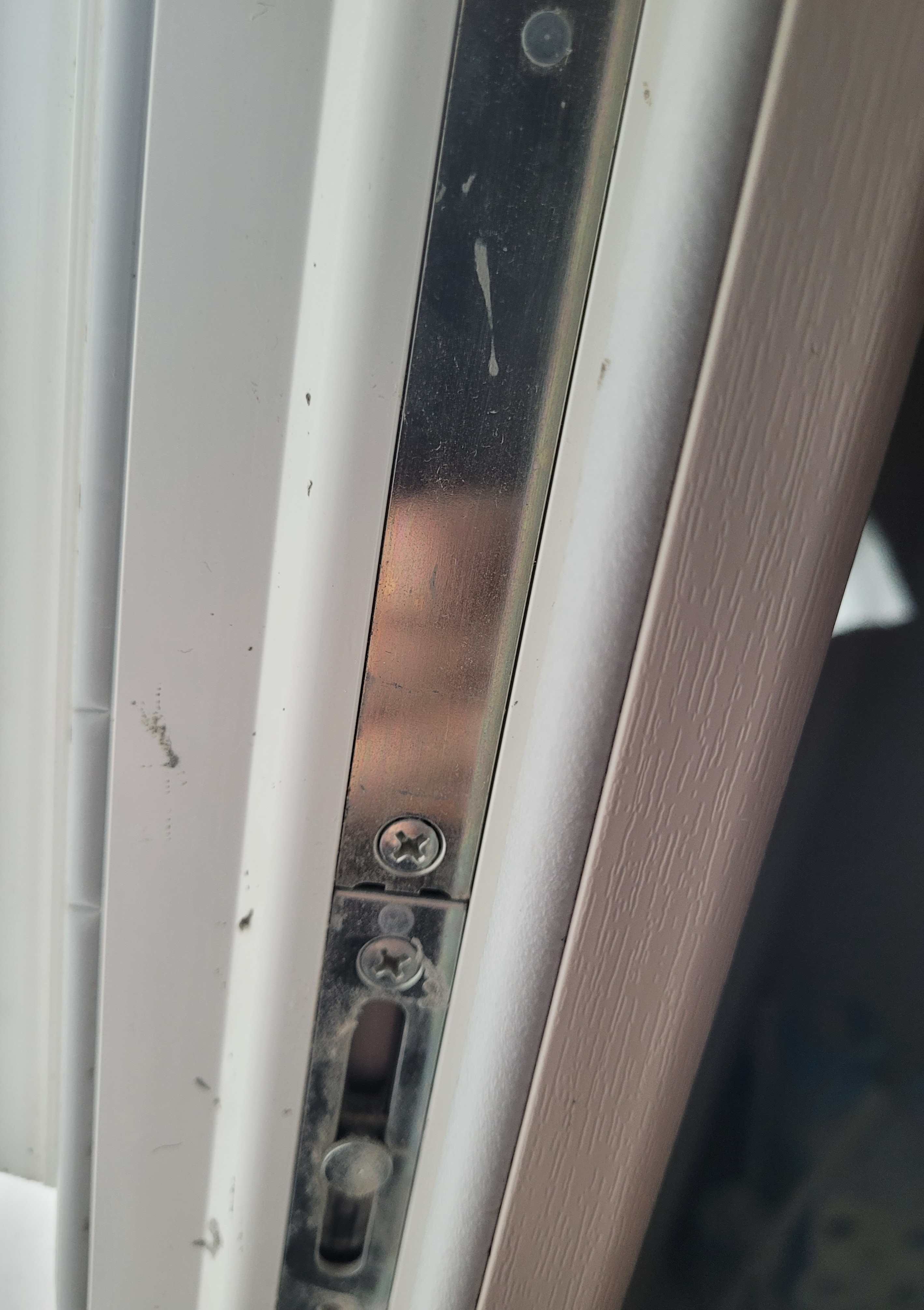

@Mr PunterNo issues regarding leaks, it just doesn't look right. @craig can't see anything that would cause the seal to be pinched, will look into adjustment. I know every openings vary, is there a normal distance between the pin and the locking keep that you've noticed?
Hi all, Anyone with internorm windows notice the seals appear to have pinch marks on them like below grey seal.
