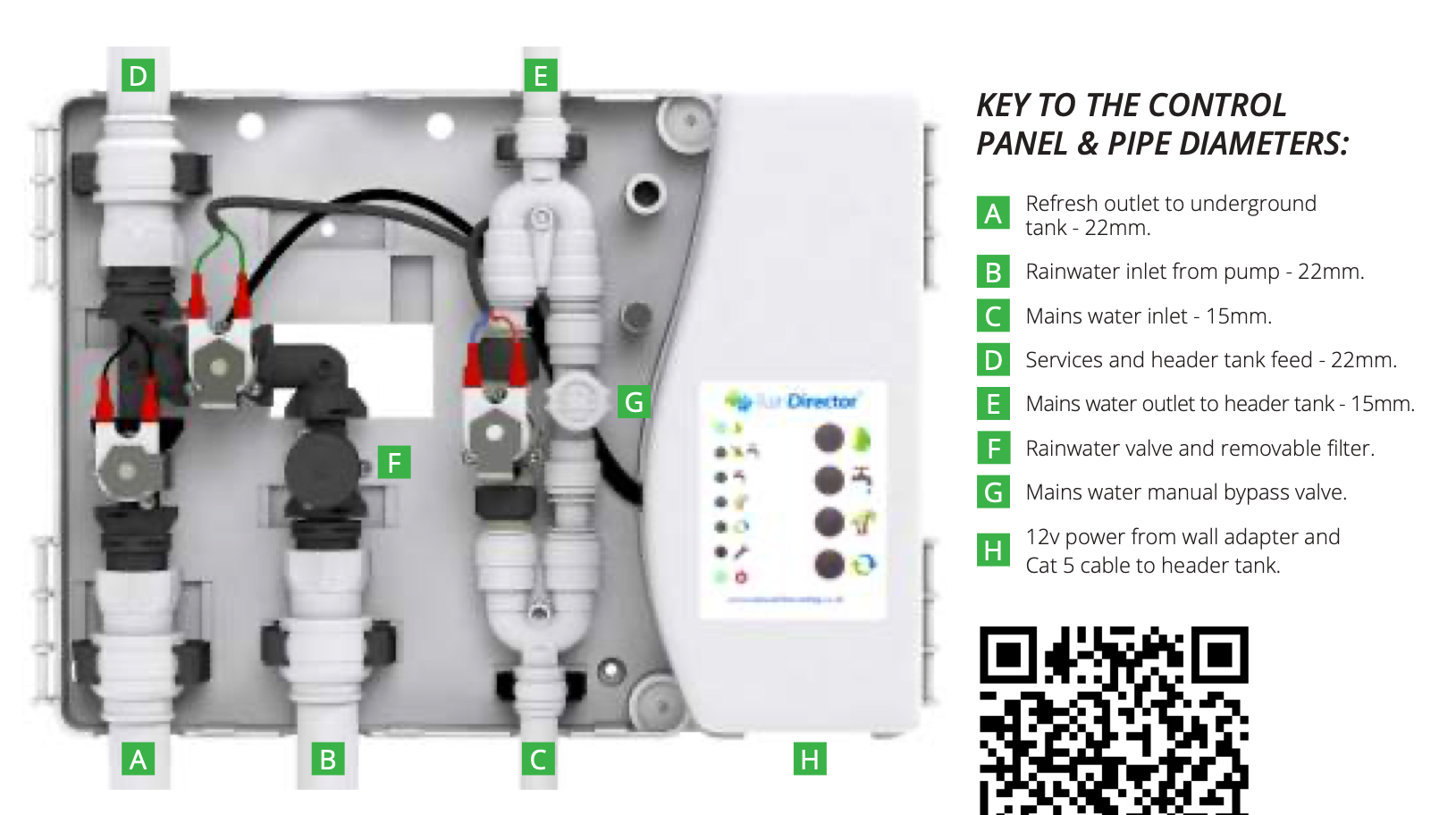

hi all. back on a bit of plumbing thinking and was wondering if anyone would know the easiest/best way to connect a 22mm hep2o pipe in to a soil stack? details are that this is the drain down from the RWH header tank if/when the water needs to be replaced to save it becoming 'stale'. there's a 22mm drain off pipe and the MI suggests running a pipe back to the RWH tank but I'm not sure that'll be possible. when I spoke to them about this they said they suggest that to conserve water but if I don't want to do that I can just put it in to a drain.
so that's what I want to do. I've got the 22mm hep2o pipe. just need to put it in to a 110mm waste pipe. I presume using a boss adaptor but how to I go from 22mm hep2o to something that will fit in to a boss adaptor?
Don’t know . (expletive deleted)ing lame though after all this time 😘
Are you sure it’s 22mm and not overflow pipe size, you know the traditional toilet overflow stuff, if it’s that, then you can get a reducing boss that glues from that to 40mm strap on boss on the 110mm.
Had a quick google. Overflow pipe is 21.5mm in new money, so that might be what your after.
With this?
https://www.screwfix.com/p/mcalpine-boss-connector-white-22mm/719hr
Alternatively you could use an adapter like this:
https://mcalpineplumbing.com/traps/condensate-traps-and-fittings/r16-blc-reducer-abs
to then fit to a normal boss?

definitely 22mm hep2o. I ran it myself! 🙂
it's outlet "A" - refresh outlet to underground tank - 22mm.

thanks. but you know what? I'm a real daft (expletive deleted)er sometimes. I'd already started a thread about this very subject and the conclusion was the very same part. and I've already bought one! 🤦‍♂️

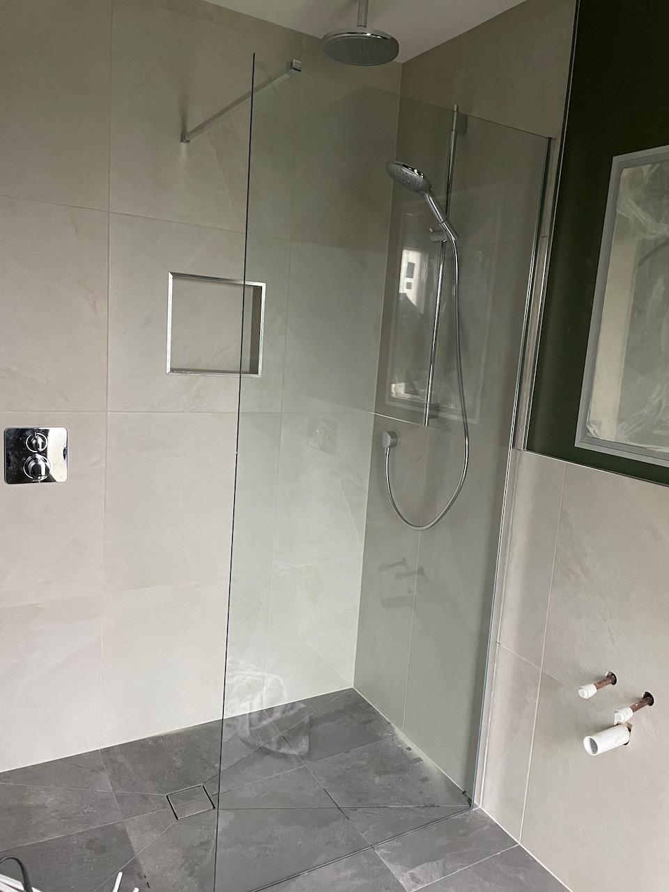

tomorrow I will be fitting shower screens. I have read up on the threads about such stuff on here but I have a question for @Nickfromwales if he's around.
Nick, I know you've been really busy lately and not been on here much but if you do pop on please can you answer this.....
in this post
you have put the screen just to the outside of the grout line at the edge of the shower former. is there a specific reason that you didn't put it ON the grout line? I was thinking to put it on the grout line but if the master doesn't do that then I will re-consider. was just wondering on the reasoning behind it.

actually @Nickfromwales don't worry as in this post
you've put the screen directly on the grout line between the mosaics and normal tiles. so there's got to be no issue with putting the screen on the grout line. I will just ensure I have a nice thick bead of clear CT1 to bed the screen on to and masking tape either side of the grout line.
see.....you're such a master that you don't even need to respond to posts anymore! 🤣
We have the same system - the raindirector was in the garage so we ran the outlet back outside to the downpipe, in copper.
It is very rarely used to be honest, commissioning and holidays for the refresh.
in the end I managed to fit a second pipe through the ducting back to the RWH tank and so the discharge will go in to that and back to the tank.

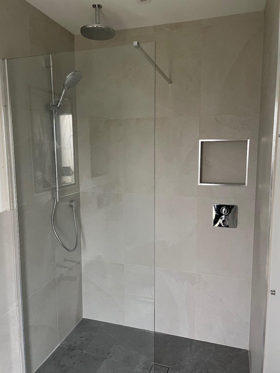

2 x shower screens completed. the scariest bit was drilling holes in the tiles and to ensure they were in the correct place! that's not something easy to rectify. luckily all worked well.

When are going to test it ? I.e proper shower ??
