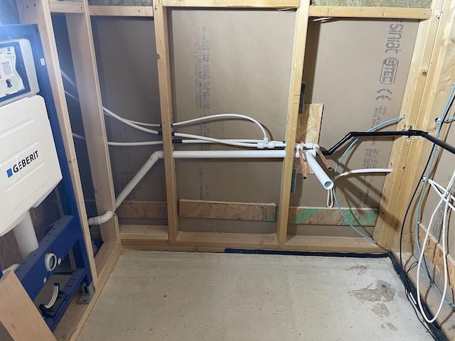

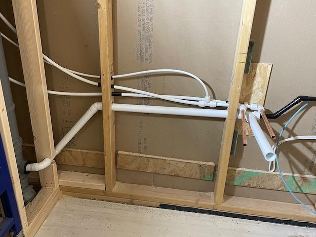

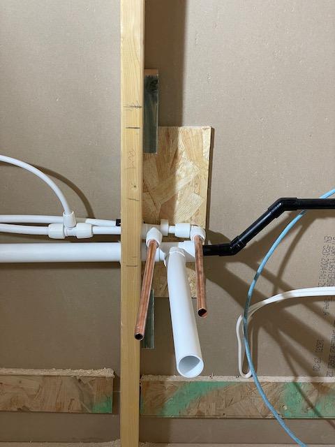

decided to stick with 32mm as suggested by @joe90 and given the go-ahead by @Nickfromwales! this is my first attempt at a basin waste and pipework and this room will be boarded Monday so if anyone can see any issues then please tell me now! I wasn't sure where to bring the copper out for the taps but there'll be a cupboard under the sink eventually so figured it didn't really matter?

on to the toilet waste as toilet water pipe tomorrow.
👍, just a suggestion, when you board the wall pencil on the plasterboard where the pipe is so you don’t screw into it when fixing the plasterboard, what is that black small pipe connected to the basin waste? Also what noggins are you putting in to support the basin?
1 hour ago, TonyT said:
T piece hidden in the wall😩
Exactly what I thought ! Mofo error
Perhaps I’m missing something; but why the copper ?
Why not hep20 right to the taps ?
small black pipe is condensate pipe from an AC unit.
18mm ply fitted within the studs for fitting the basin to. that's also on tomorrow's list of things to do!

that's the HRC. if you can tell me how to make that connection NOT inside the wall without having a load of connections under the sink then I'm all ears! I did think about the potential risk of making that connection behind the wall and then figured I'm already putting 90° elbow bends behind the wall to bring the hep2o out so there's already a risk behind the wall.
to make that HRC connection outside of the wall I'll have to bring the 15mm hot and the 10mm HRC out through the wall via 90° elbows and then join with the reducing T. all sounds rather messy.
I need to 90° out of the wall so converting to copper is easy as I can push fit it into the 90° hep2o elbow. I don't see the issue here! I see most posts that people come out of the wall in copper and run plastic in the walls. 🤷‍♂️
Ok . But why not hep20 all the way ? If you really want copper ( still can’t see why ) change at a point under the sink where you can access it .
I guess I’m asking why hep20 and then copper anyway ? ; what’s the Benefit ?

tbh, I don't know the benefit! nor do I know the downside. both copper and hep2o can be dismounted if required so I don't see the difference. only thing I can think of is that copper comes out of the wall straight but it's hard to get plastic to be nice and straight?

3 minutes ago, Thorfun said:

Usually you are needing compression fittings where the Hep terminates, under sinks etc, so converting to copper is what I do each and every time. Usually with the Hep 90 in the wall, and the copper disappearing into it out of sight.
Anyone who has pushfit on display is low down on my list tbh, looks horrible and unprofessional, plus all the pipe and fittings can then rotate and move about / around....

Agree . But you can hep20 right to the tap tails !
