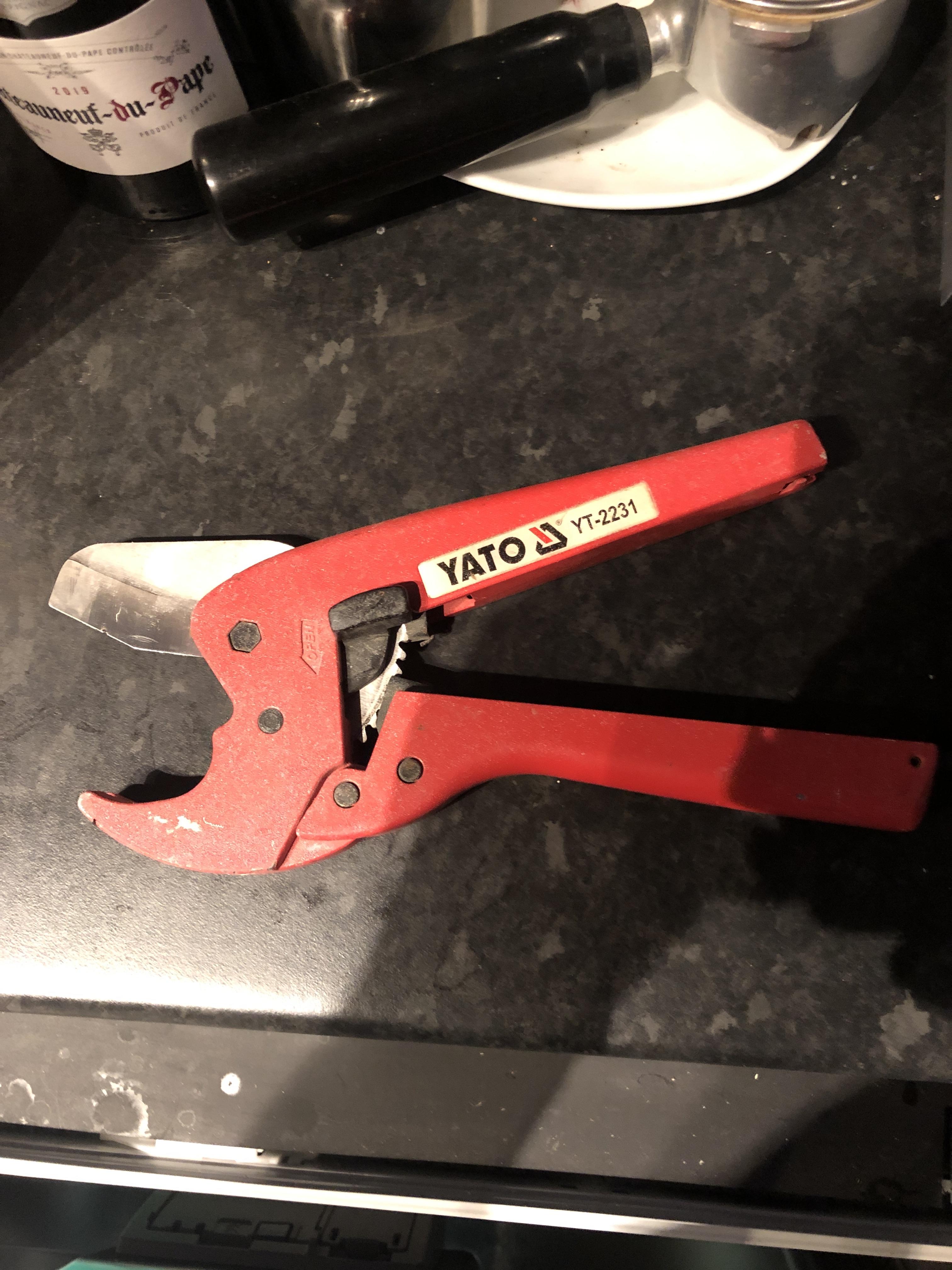

@Thorfun if you haven’t already . Get proper pipe cutters 👍
got a pair that I used for the UFH from Wunda. but I might look to spend quite a few quid on a proper quality pair from a named brand!
Buy a pair of Rothenberger shears
