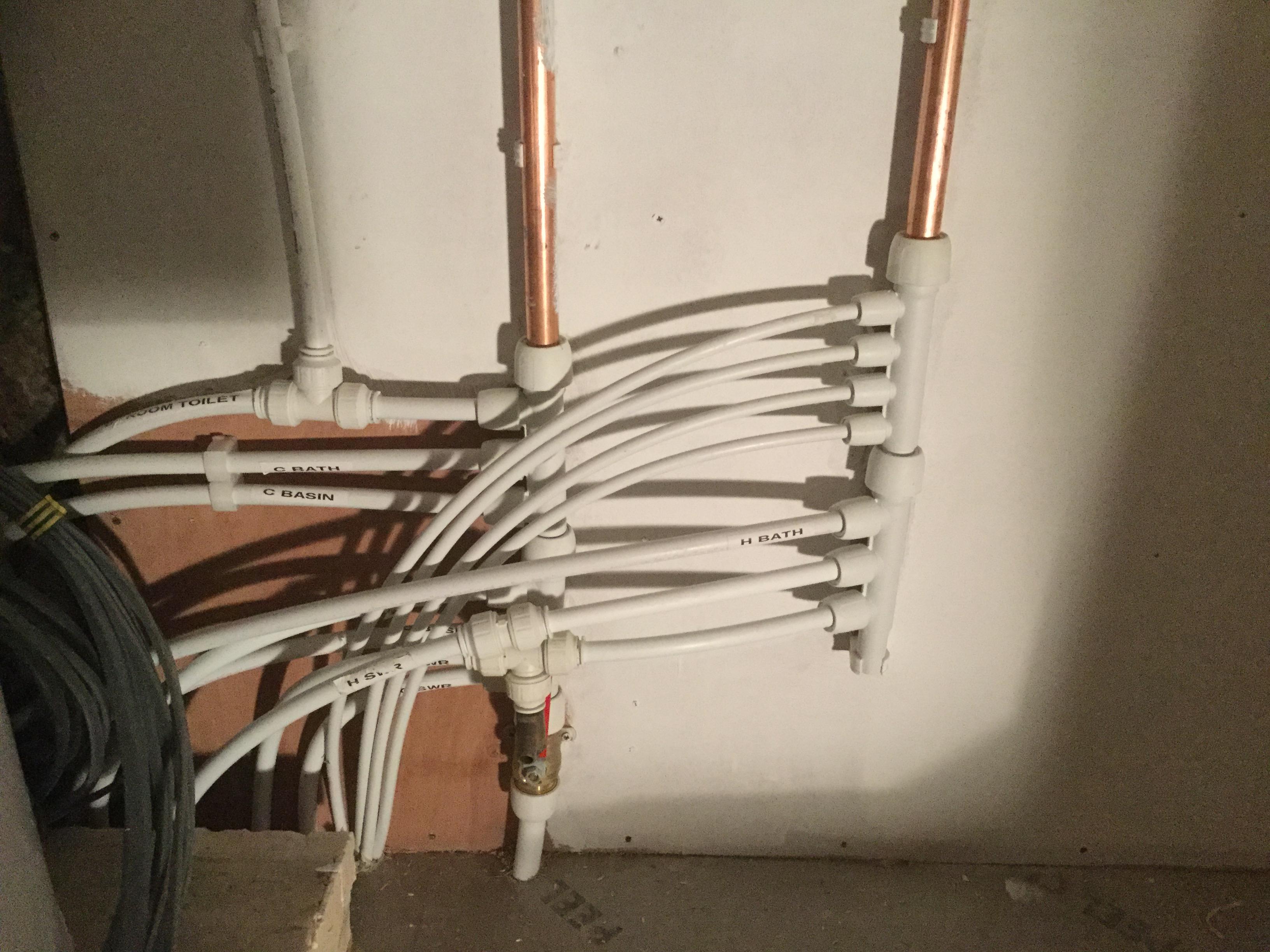

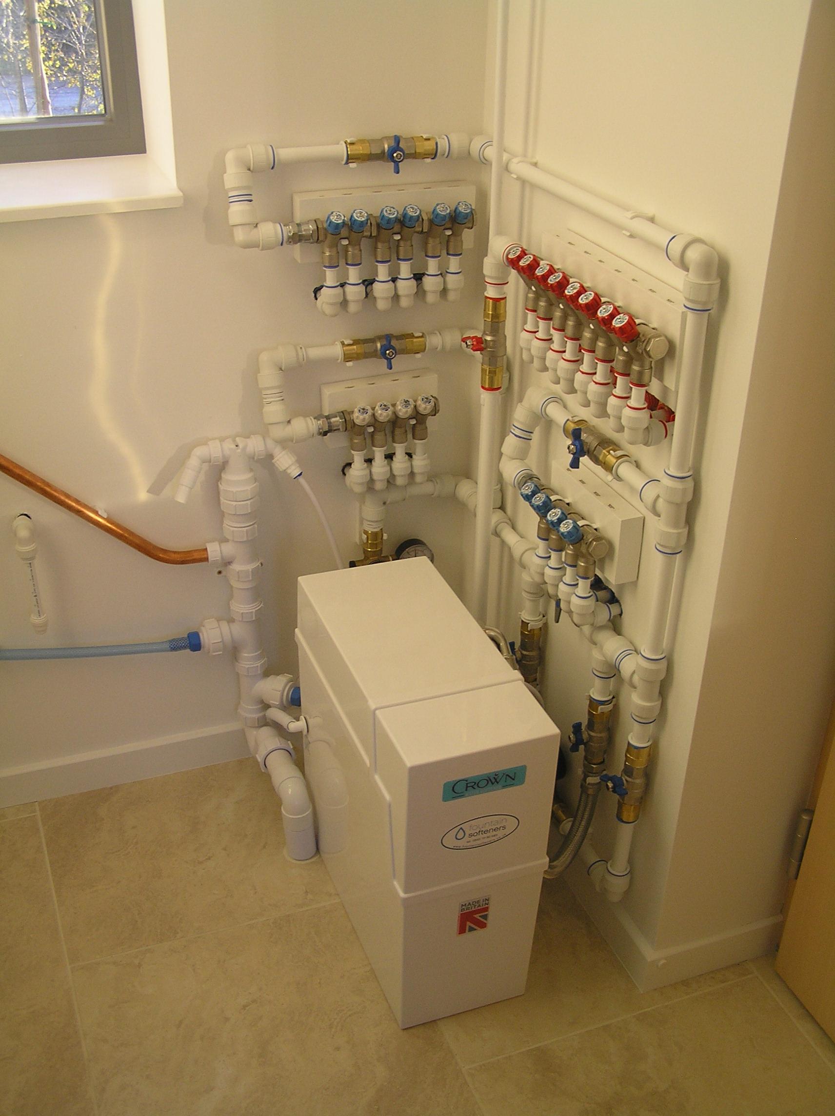

Gone West Posted October 5, 2022 Share Posted October 5, 2022 I designed a manifold system and used plastic pipe, never done it before but it worked out ok. 6 Link to comment Share on other sites More sharing options...

Thorfun Posted October 5, 2022 Author Share Posted October 5, 2022 50 minutes ago, Simon R said: Me too. Ours is all done now, hep push fit and plastic pipes used to keep the number of joints down. I don't have underfloor heating but do have pumped rain water. I air pressure tested each section of piping as I went, pressurising it and checking the gauge the next morning. Also where practical I tried to keep joints in accessible locations, we have lots of "routabout" hatches. By testing as I went along it was fare less stressful when the water got switched on. I had a couple of leaks where I managed to put a plasterboard screw through central heating pipes, but dry other than that. Pressure testing threw up a few bad joints, all where I had failed to fully insert the pipe into the fitting. I pretty quickly got into the habit of using a sharpie to mark the pipe so I could easily see if it had fully located. One area that cased a few headaches were shower trays. Our ground floor is a concrete raft and despite best efforts to accurately position soil pipes it took a bit of fiddling to get the trays right. I even ended up building a partition wall in slightly different location so the shower drain matched. The toilets were not so bad as we have wall mounted pans which means there is some flexibility in the couplings. I'm on the south coast, just west of Portsmouth so probably not to far from you. Let me know if you want some help. thank you! great advice and I'll let you know. 🙂 Link to comment Share on other sites More sharing options...
Thorfun Posted October 5, 2022 Author Share Posted October 5, 2022 35 minutes ago, Gone West said: I designed a manifold system and used plastic pipe, never done it before but it worked out ok. yep. seen your posts on this thing of beauty! if I can get it half as good as yours I'll be very happy. 1 Link to comment Share on other sites More sharing options...
