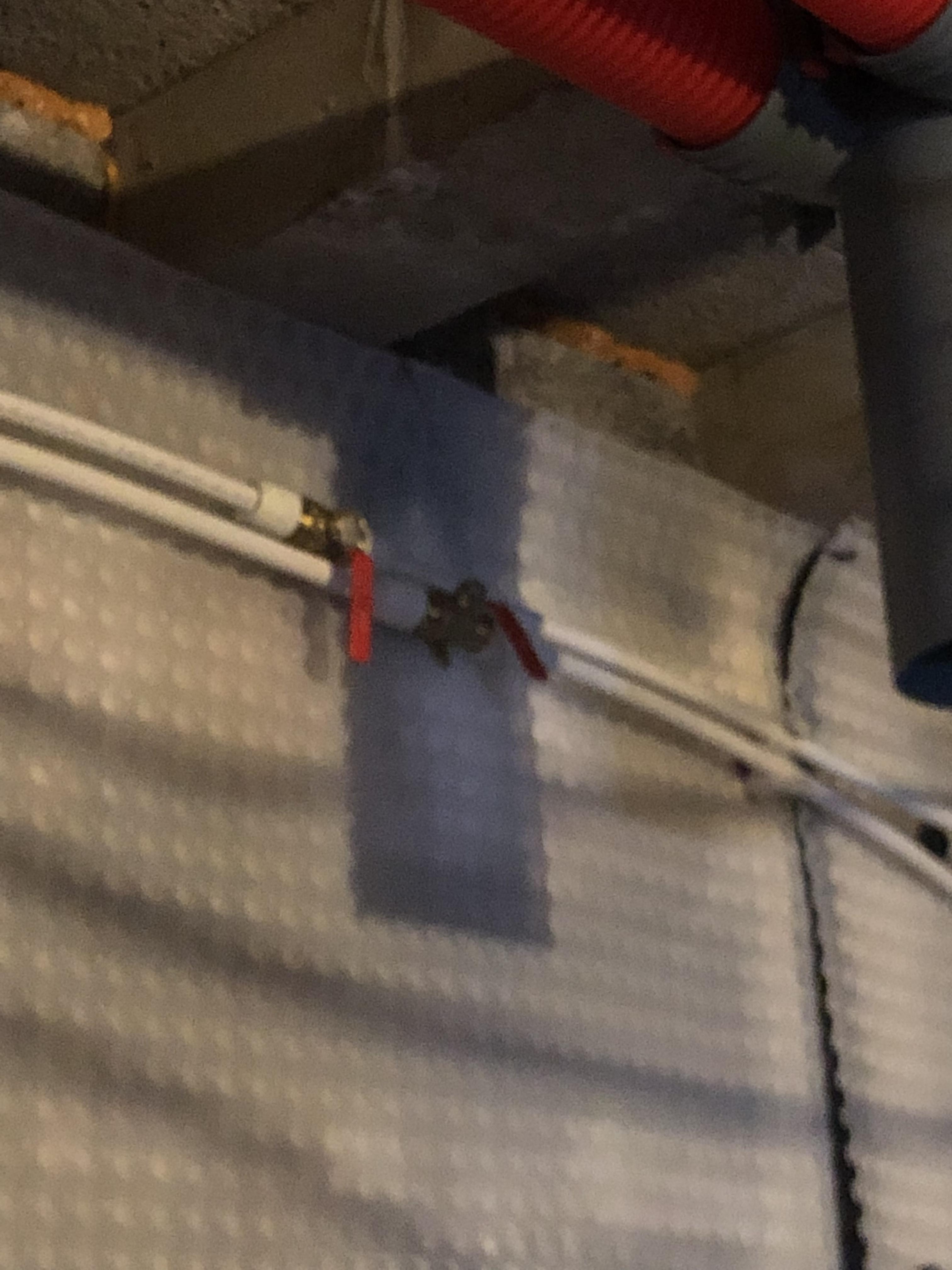

    If you need some ideas, here is my attempt at the manifold setup in my garage 👍
  • I designed a manifold system and used plastic pipe, never done it before but it worked out ok.

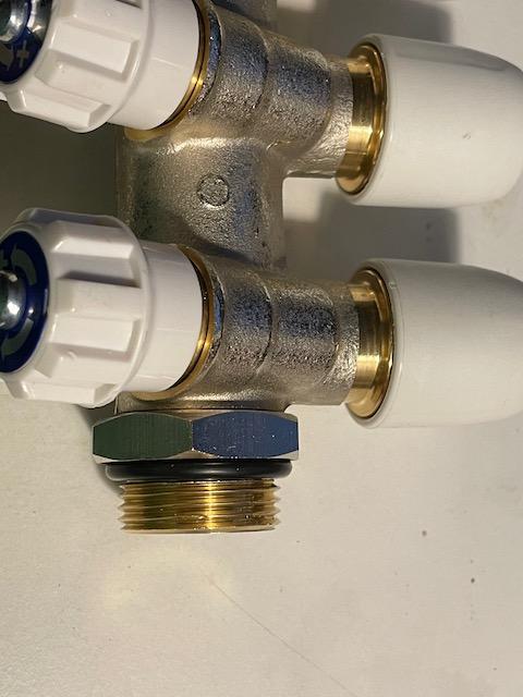

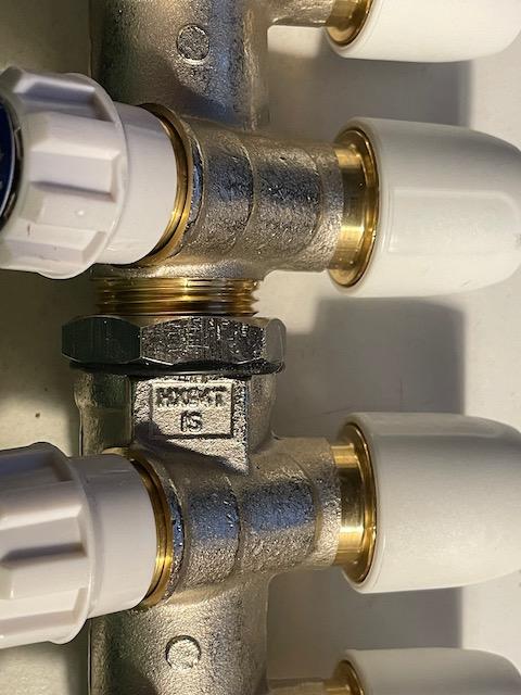

got another noddy question. putting together my hep2o brass manifolds and I notice that there's a rubber grommet on the male end. does that mean I don't need any form of tape and do I tighten until the rubber grommet is fully squished?
my first attempt I've used some loctite 55 on the male thread and screwed in to the female end and then tightened the nut which has squished the rubber ring as shown below
here's the rubber ring at the end of the one I attached waiting for the next manifold to go on.

My futile opinion…
not sure about that washers function .
Put tape on it . You’ll soon find out when you pressure it up …
Edit : looks like you’ve got the same manifolds I have . Don’t remember a rubber washer ….
Edited by pocster
Just checked mine for you .
No washers ; but plenty of tape .
cheers. I've put the recommended amount of Loctite 55 on it and it's pretty darn tight. guess I'll find out when water is connected as to how good it really is!
maybe the rubber washer is a new thing from Wavin?

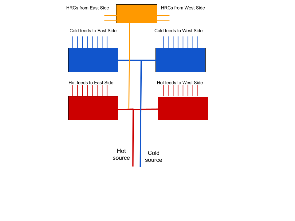

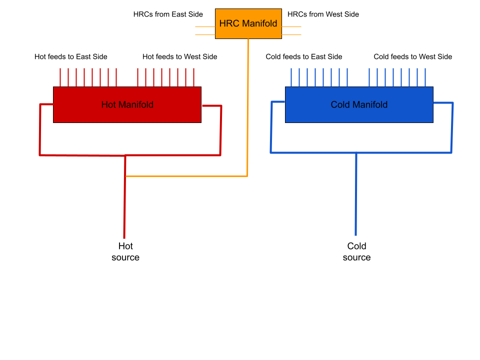

now I've started creating the manifolds I'm thinking about my proposed layout and whether it's the best way of doing it. this is what I was going to do (option 1).
have separate manifolds for each 'side' of the house. but I'm wondering if it might be better to do one big manifold for hot and cold and feed the source from both ends, like this (option 2):
any preferences or benefits to either way? or is it all pretty much the same?
I'm still a bit confused as to how the HRC manifold feeds back in to the hot manifold but I think that's a question for later!
I can see logically why you'd do the east/west split, but practically, for me it would be the one manifold each for me, for no other reason than simplicity.
