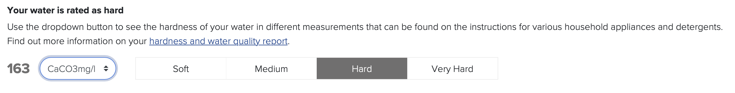

we've discussed water softeners quite a bit in our household.
according to Southern Water we have 'Hard' water
863030809_Screenshot2022-11-04at08_54_59.thumb.png.b29465fdbf265b15add7dea4e0c21aae.png
which according to this website (https://www.aquacure.co.uk/knowledge-base/uk-hard-water-map/) makes us at the lower end of 'moderately hard' water.
with that and the fact that our plant room is in the basement and I'll need some form of sump and pump for the water softener discharge we've decided not to bother with a water softener.

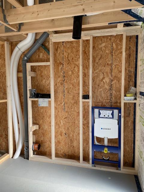

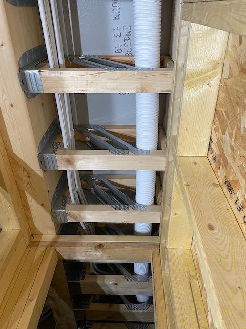

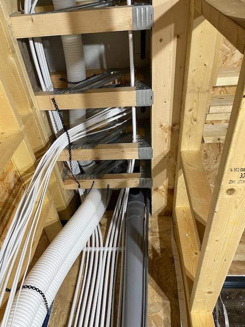

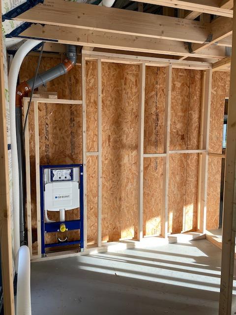

spent a couple of days building the stud walls in the kids bathrooms for the Geberit frames. overall, I'm pretty happy. need to do some magic around the soil pipe going to the loft for the AAVs to get plasterboard fixed but in true @pocster fashion I'm sure I'll figure something out!
Use the gerebit recommended height and account for flooring?  Our plumber was putting our in crazy-high until I noticed and told him to follow the geberit sticker.
yep. all at the correct height for the toilet's we're buying and the FFL and the soil pipe branch. waiting on the pans to get here so I can test fit to check 'squatting' levels before final fixing of the frames and building the shelving space that will go above the toilets.
I think that's what we all do but @pocster is one of the few to openly admit it! 😁 I always find those bits around soil pipes and other services to need some extra thought for plasterboard fixings. I find one of my most common questions to self is: how the hell am I going to make that work? Lots of spare battens come in handy, or some cls ripped in half. It's interesting that the carpentry/framing books all miss out the difficult bits too.

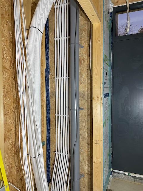

20 minutes ago, Thorfun said:
here ya go @pocster. some hep2o for you.
To (expletive deleted)ing neat for me . Of course you are only showing us the best bits .
