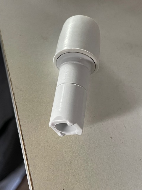

looking for some quick assistance here please (probably from @Nickfromwales as the resident hep20 expert!).
bought some 15mm -> 10mm spigots for my HRC pipes. they look like this:
I can't fit an insert in the end that goes into the 15mm connector on the manifold. I presume that's by design? I just need a 10mm insert in the 10mm pipe that goes into the 'mushroom' end of the spigot?
I've found some pictures on the web that show these spigots with inserts and some that don't! maybe Wavin changed the design?
Yes . The ‘funny’ end just goes straight into any hep20 fitting 👍.

1 minute ago, ToughButterCup said:
Yeah, but the thing is, can you get the damn thing back out once  - in error - you've put it in.
hopefully with those metal thin hep20 pipe removers?
it's a good point though. i might have to return these and get normal reducers (short length of 15mm pipe into manifold to 15mm->10mm reducer) if you can't remove them as i'm bound to make a mistake!
This is also true . Spigot end in - it never comes out !
I’ve used them when I have too ( or all I had on site ) . If wrong ( and you can’t undo them ) just remove it . You’ll use it somewhere else for sure .
Just now, Thorfun said:
I'm worried now. what if I **** up?
Buy new fittings . They are cheap - don’t worry .
are you talking about the spigots? if i can't remove it then i'll need to replace the manifold!
the brass hep20 manifolds are not cheap! and if i've got a spigot stuck in one port then it could be a problem.
