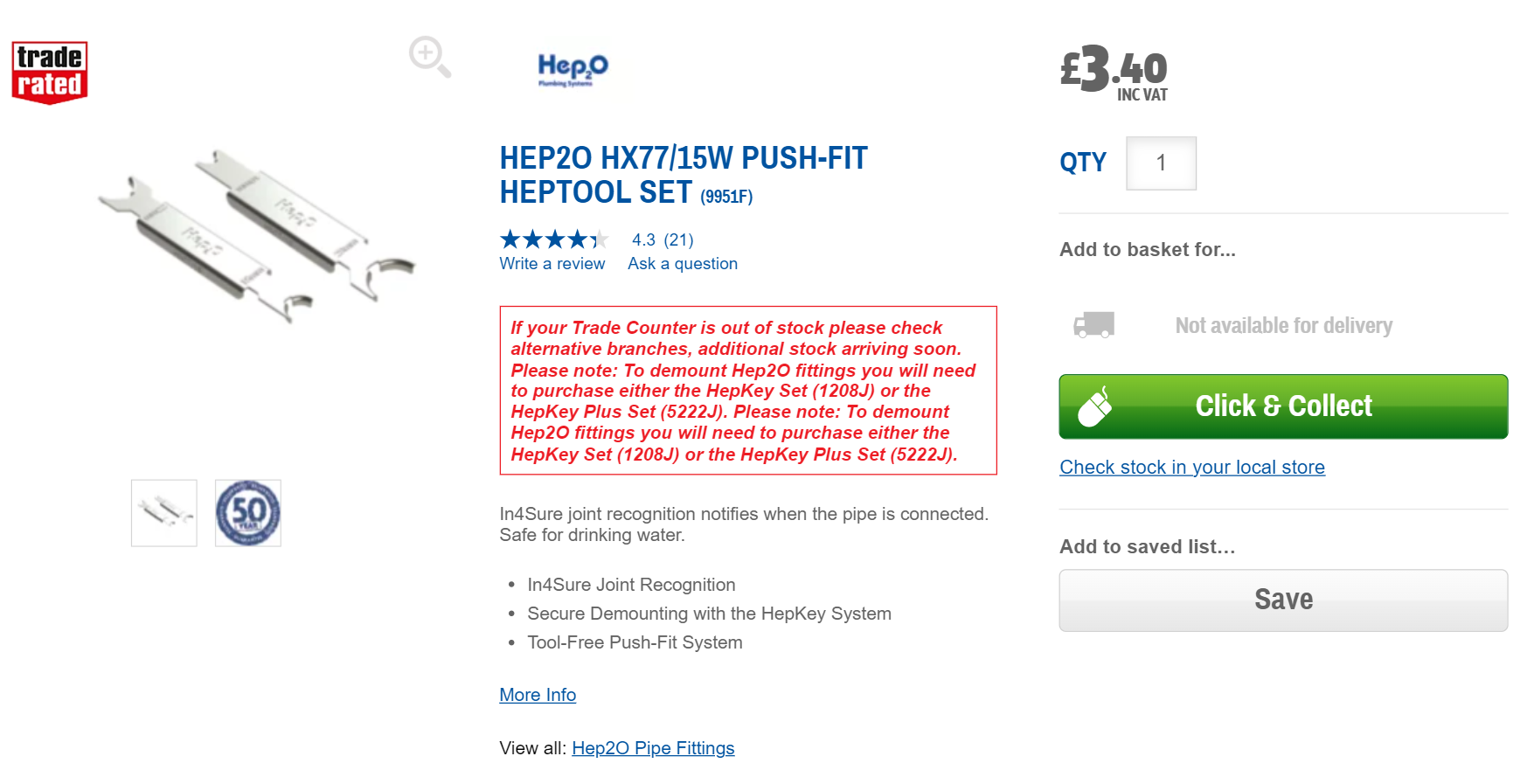

I have these. I thought they'd be the ones to remove the spigots.
I'm now conflicted. obviously the spigots are a lot neater and I "shouldn't" ever need to demount so maybe I should (as the master @pocster often says) grow a pair and get on with it! 😂
In hand ( not in situ ) plug a spigot into a fitting and test it a few times . If you find it easy to dismount ( remember not in situ - so will be easier anyway ) then go for it . If after 5 attempts and swearing - you might decide otherwise 😁
