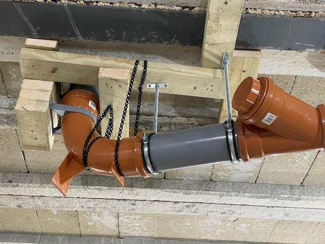

I don’t use clips, I use all round band, black powder coated. For the HRC I use 25mm wall 22mm bore Climaflex and then a 50mm waste clip works perfectly.
You can also use a 50mm Munson ring style clamp, only 50p each at Direct Channel.
9 hours ago, Thorfun said:
No. Use another bracket and rod, just bend the rod to the angle, will look loads better and offer more support.
all round band is for fixing straight to walls and ceilings or pipe insulation touching structure.

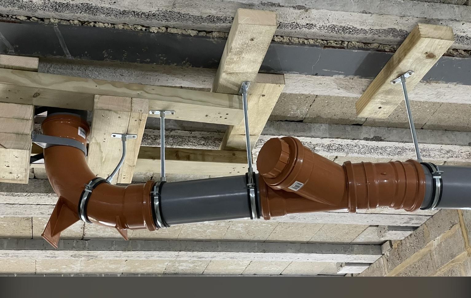

33 minutes ago, Nickfromwales said:
Lose the banding, and put another rubberised clamp just under the shoe of the rest bend.
Do as @TonyT says.
you both mean here?
and how am I supposed to bend a threaded steel rod?! I don’t have a rebar bender.
49 minutes ago, Thorfun said:
you both mean here?
You just find two bits of wood close together, put a long piece in, and bend it.
“Use the force…..”
Yup. 1st year apprentice would be sacked on the spot for that 💪.
Sack him !!!
35 minutes ago, pocster said:
Sack him !!!
union rules state I need a written warning first.
BH T’s & C’s state that we can bully you at out leisure.
No retreat, no surrender.
Please sir. May I have my job back. 🙏
Just now, Nickfromwales said:
You can.
Above = bombproof 😎👍
thank you. every day is a learning day. 🙂
I looked at that and my first thought was, that ain't pretty but it works and ain't going going anywhere.
