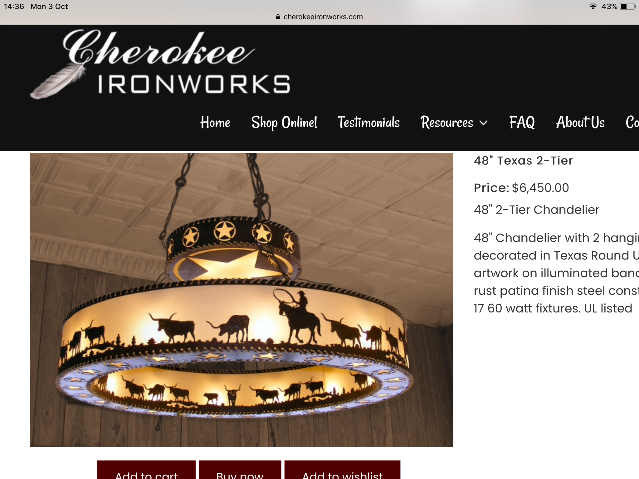

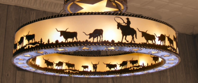

Russell griffiths Posted October 3, 2022 Posted October 3, 2022 (edited) so we sort of have our hearts set on a light like this, however if you can see the price you will see that’s a bit ridiculous. So im going to make it myself. Im after a collection of ideas on how to actually do the build, but also what are the legal implications of making a light fitting. I can obviously get a qualified electrician to wire it up, but is that enough. Using off the shelf certificated parts would be a start. Anybody want to join in on this crazy journey @Onoff I’m sure this is up your street mate, not like you have much else to do 🤣 @pocster you can just sit in the background as anything technical you say will just be ignored, you are allowed to add insults and inappropriate pictures though. Edited October 3, 2022 by Russell griffiths

andyscotland Posted October 3, 2022 Posted October 3, 2022 One option might be to explore LED strip - it would give a more even light than the individual lamps in that photo which IMO would look better. And as it's extra-low voltage and cold running avoids any safety/legal issues. If you want to do it with individual lamps, from an electrical POV so long as you use off-the-shelf fittings designed to be exposed e.g. batten lampholders, and keep all wiring connections inside the fittings, there's no real legal/regs issue. It's not that different from making up a table lamp, or e.g. replacing a pendant lampholder with a new one/a different fitting, both of which are things anyone can do. If you want to get an electrician to check it over you can, or just stick to 12V e.g. halogen capsules or similar. If the frame is metal then in theory if you use enclosed lampholders you don't need to earth it but I probably would. The bigger safety thing is probably fire, multiple lamps enclosed in a box can get pretty warm, less so with low-energy but even still. It'd just be a case of having some ventilation (holes in bottom and top) and a reasonable distance between lamps and surfaces. 1
Carrerahill Posted October 3, 2022 Posted October 3, 2022 13 minutes ago, andyscotland said: ...there's no real legal/regs issue. As it would be a bespoke piece of limited run there are no regs, certainly no legal issues. Any unskilled person can make a panel or machine or light. In this case, technically the minimum requirement would be a PAT test. Most don't bother. Install it and then do a circuit test and earth check. 1
PeterW Posted October 3, 2022 Posted October 3, 2022 These guys can do your steel laser cut piece - up to you now you then finish it https://gboutdoorfires.co.uk 2

Temp Posted October 3, 2022 Posted October 3, 2022 1 minute ago, PeterW said: These guys can do your steel laser cut piece - up to you now you then finish it https://gboutdoorfires.co.uk Copper would be nice. Solders easily and you can get chemicals to give it a bronze like patina or green verdigris etc. 1

Onoff Posted October 3, 2022 Posted October 3, 2022 (edited) I've seen some hideous, tasteless carp but this is right up there! 😂 Reminds me of the fake western tat at the theme hotel I stayed in at Disneyland Paris. However...ever willing to help a fool part with his money...going to post on the mig welding forum for thoughts. The cutting out of the shapes, assuming you can find suitable graphics would be a doddle for one of the lads over there with a fibre laser. It would then need rolling into a hoop and tacking together. Only bit I'm thinking of "how to" would be the opaque section. Edited October 3, 2022 by Onoff 1
