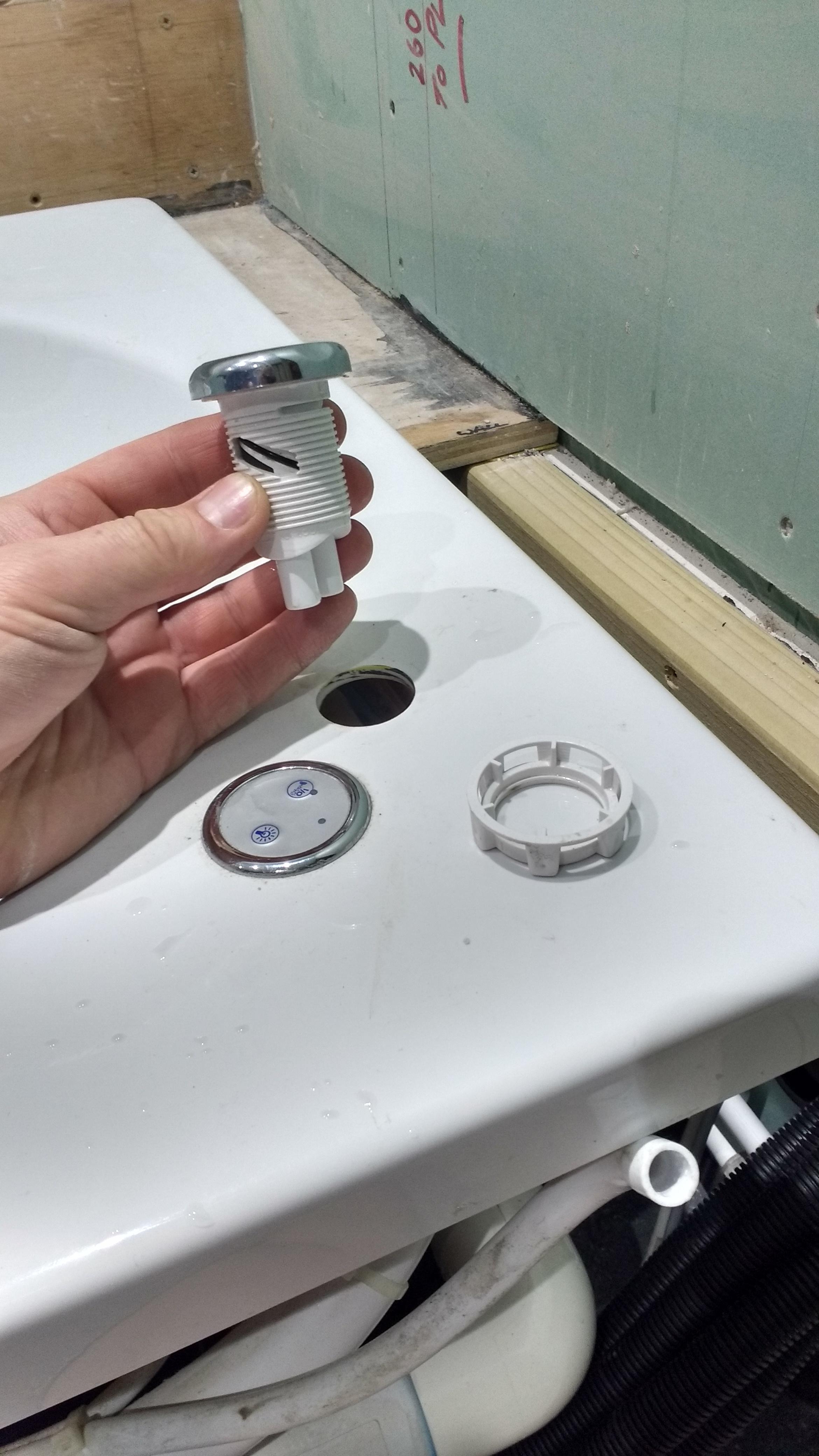

Appears in good nick too. One pipe in one pipe out, spiral valve with an o-ring that appears in good nick and well greased (silicon grease?).

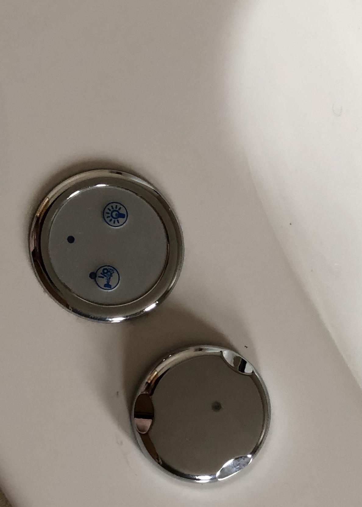

Hot and cold ran out before I could fill above the jet line...i
Light on/off works fine but jets are either full whack or off...what I think is the jet control does nothing...
How do you run out of cold? ?
My controls look like that. Am filling the bath up (with cold) to see how mine works and will report back. I’ve only ever used that bath twice and have no recollection of twiddling any knobs ?.

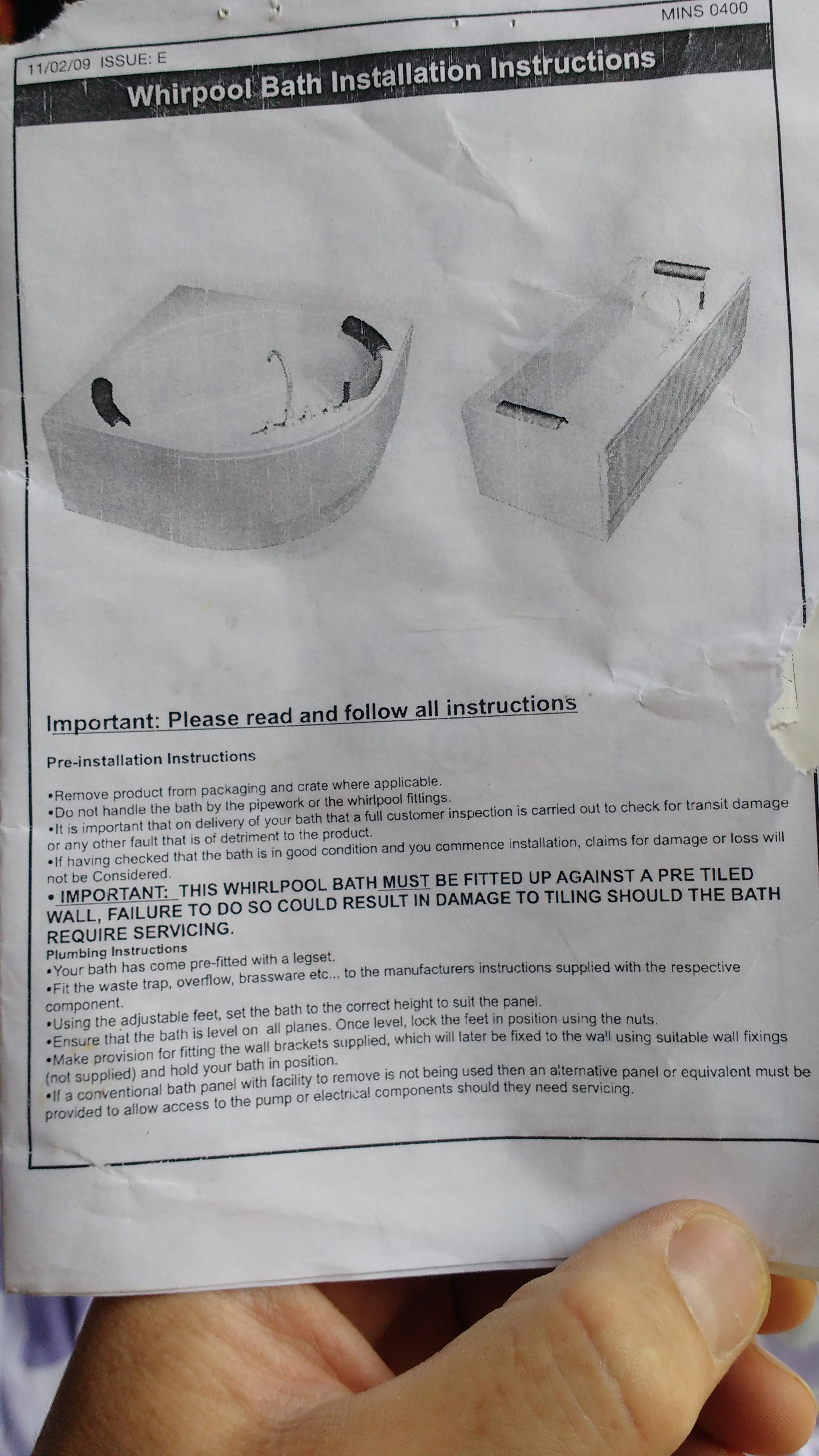

Do you really have instructions for it? Mine must be long gone. It was bought in 2010 too. I used it for the first time in about 2014 lol and only once since then.

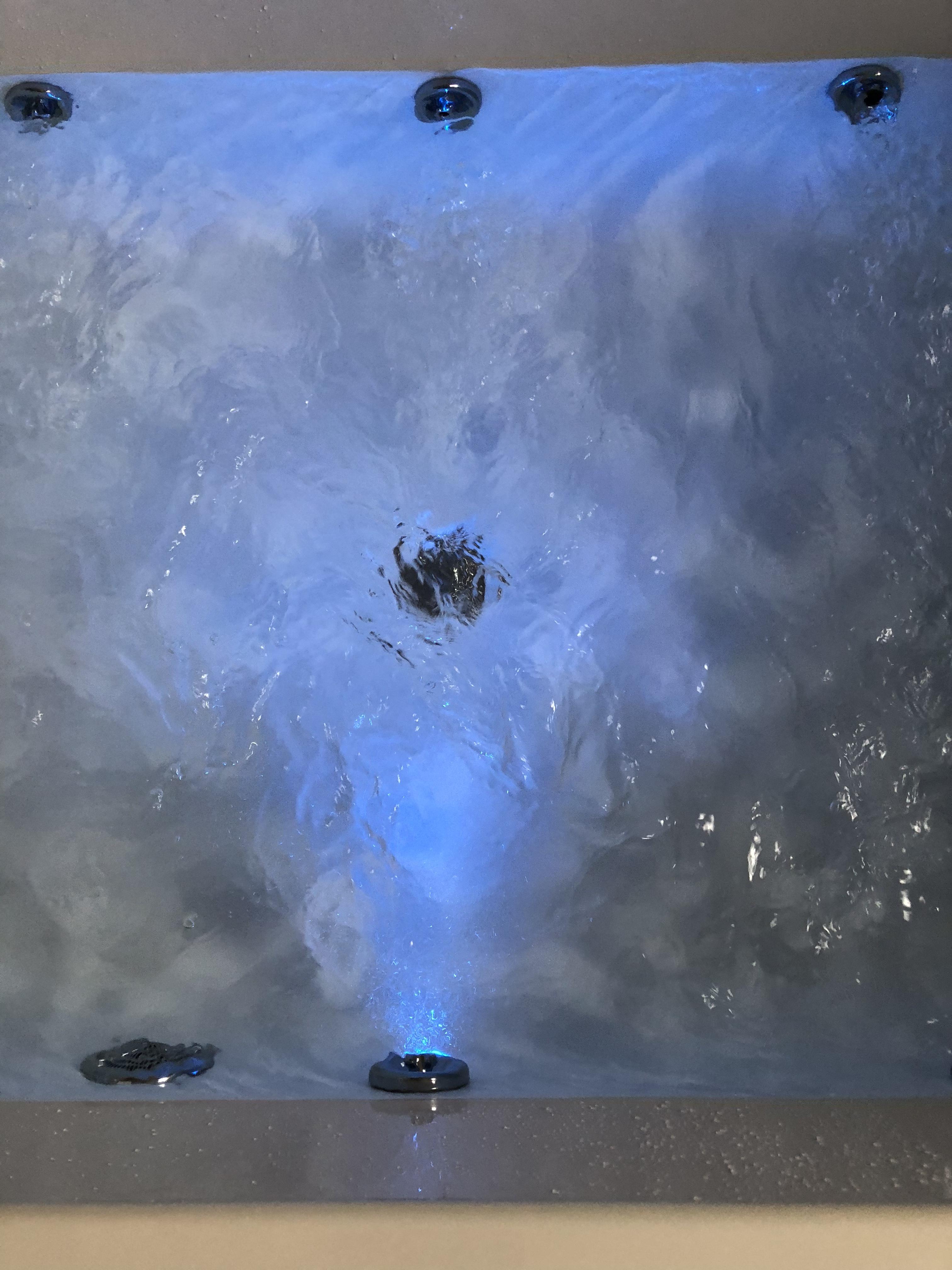

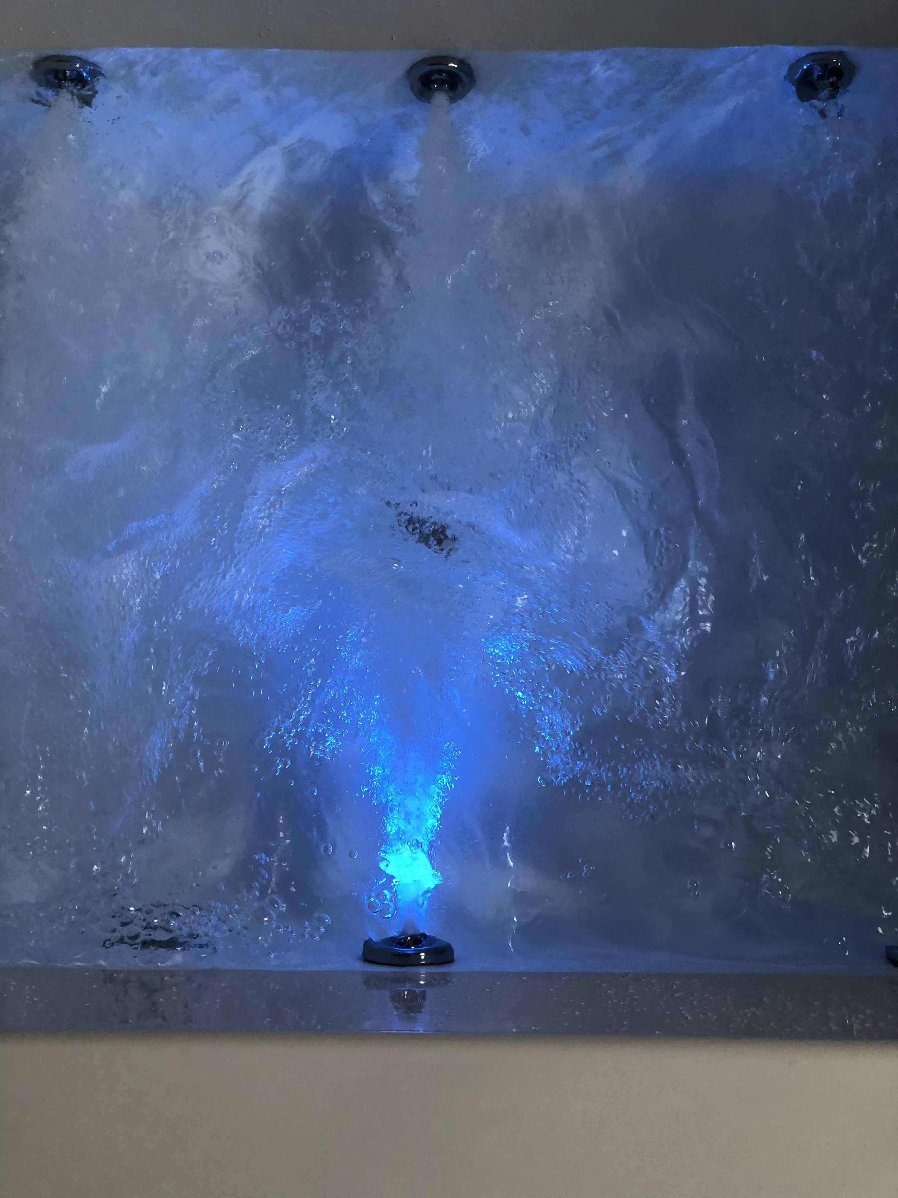

Yep the knob regulates the flow. It’s not blindingly obvious unless you put your hand in tbh. First pic light jets, second pic full flow. It possibly doesn’t show up much but the light is more intense on full flow. Must be the way the light reflects / refracts or summit.
Yep, have the instructions still:
Thanks. I'll have to video mine to show the lack of difference turning the knob makes.
As I understand it turning that knob just controls the amount of air vs water in the  jet stream. Not sure how it's meant to work...would have expected to be able to adjust from "gentle massage" to "grand rapids". At the mo it's the latter or nothing!
I'll give you a tip though! Don't turn the jets on until they are fully covered. I got bored waiting so pressed it while they were only half covered. It shot a spray of water straight over me :).
Seems that was the problem! I know who to come to for plumbing tips from now on!  :)
I made sure the jets were fully covered and ran it again. The jets were much "calmer" and quieter when fully submerged.
Just to check the air valve I ran it with it off and stuck my fingers over the ends of the two white pipes which varied the intensity of the jets. Put the valve back on with a tad more silicon grease and that works fine.

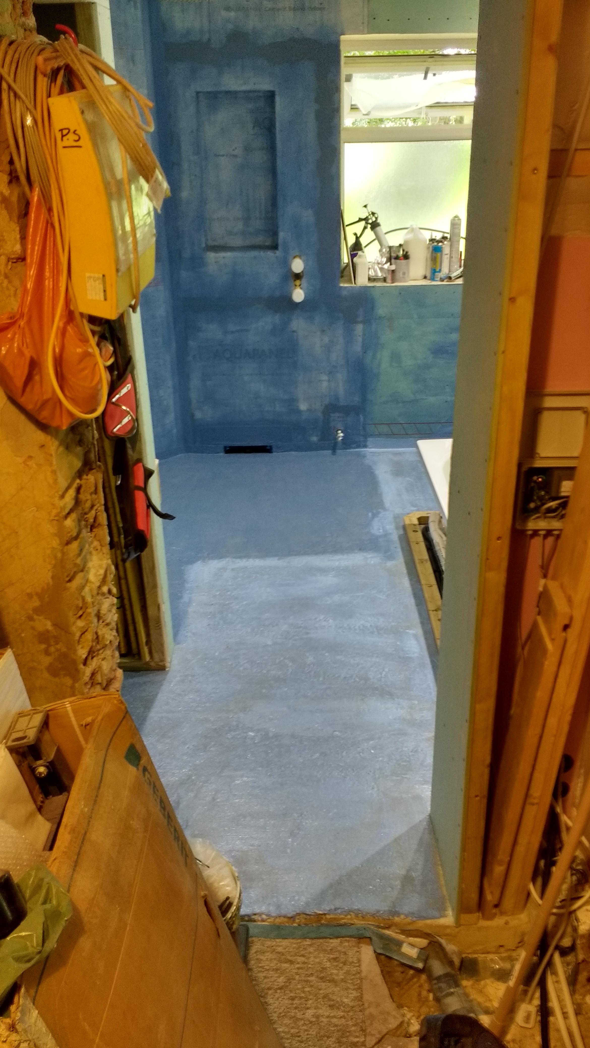

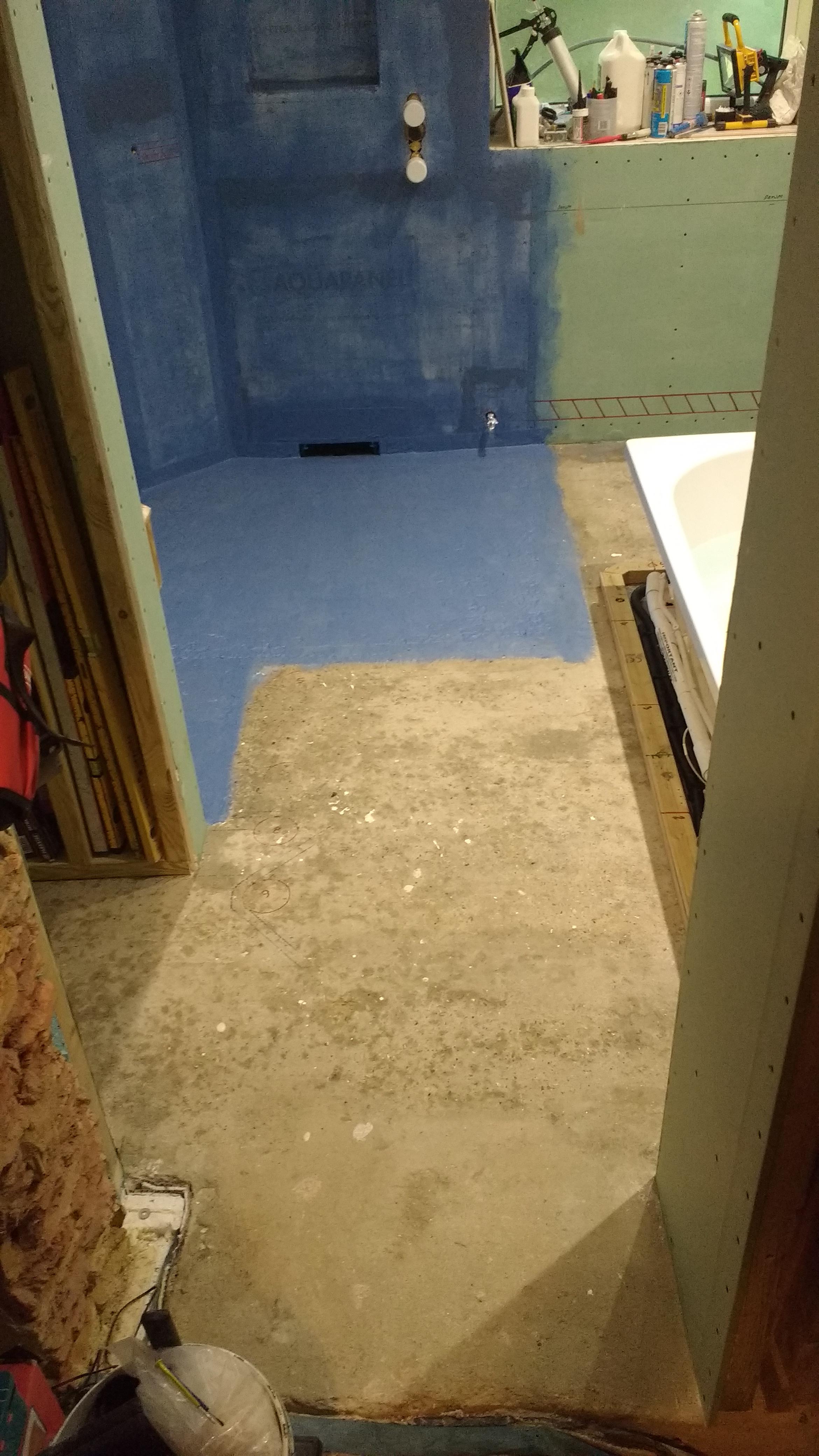

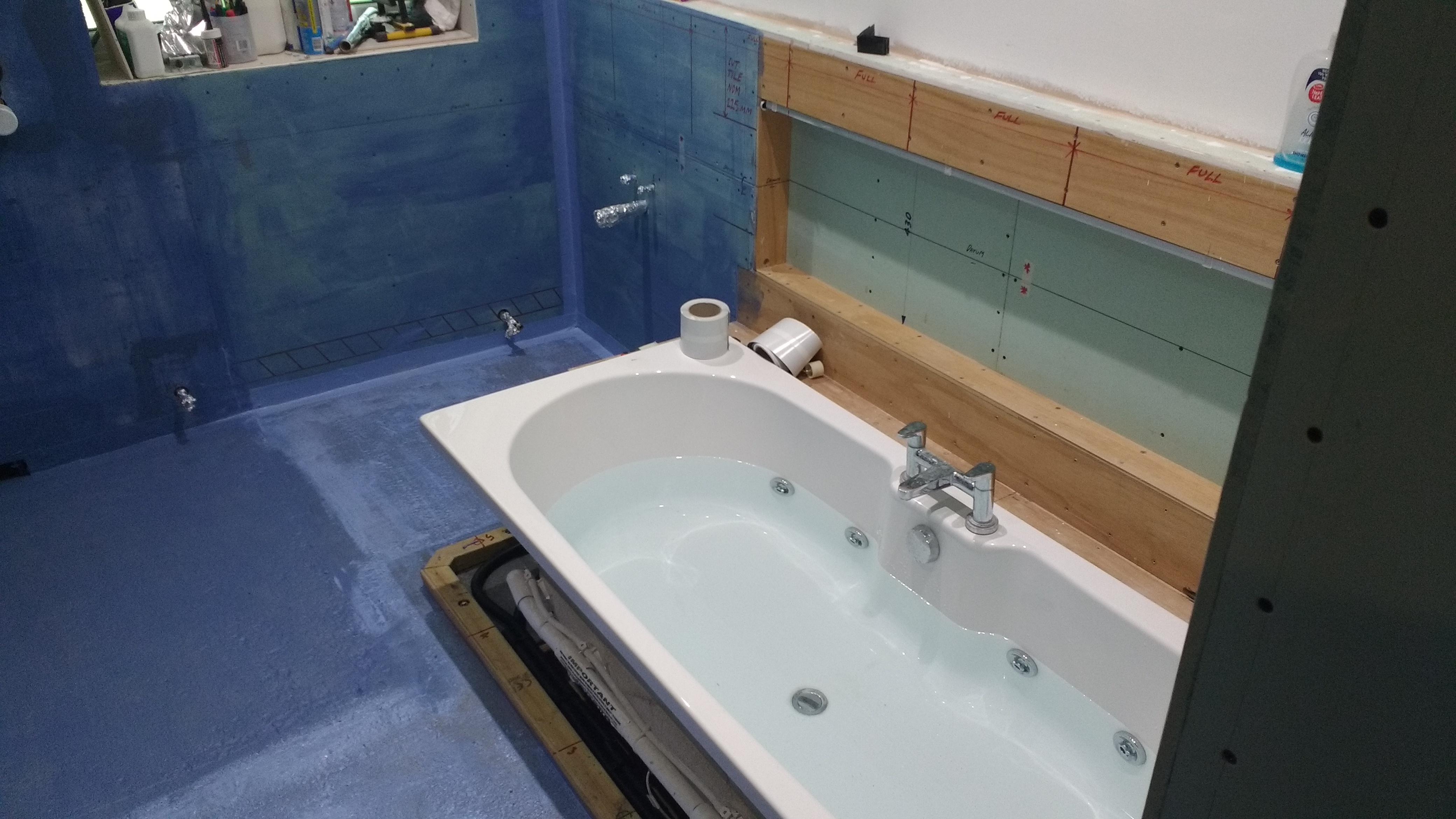

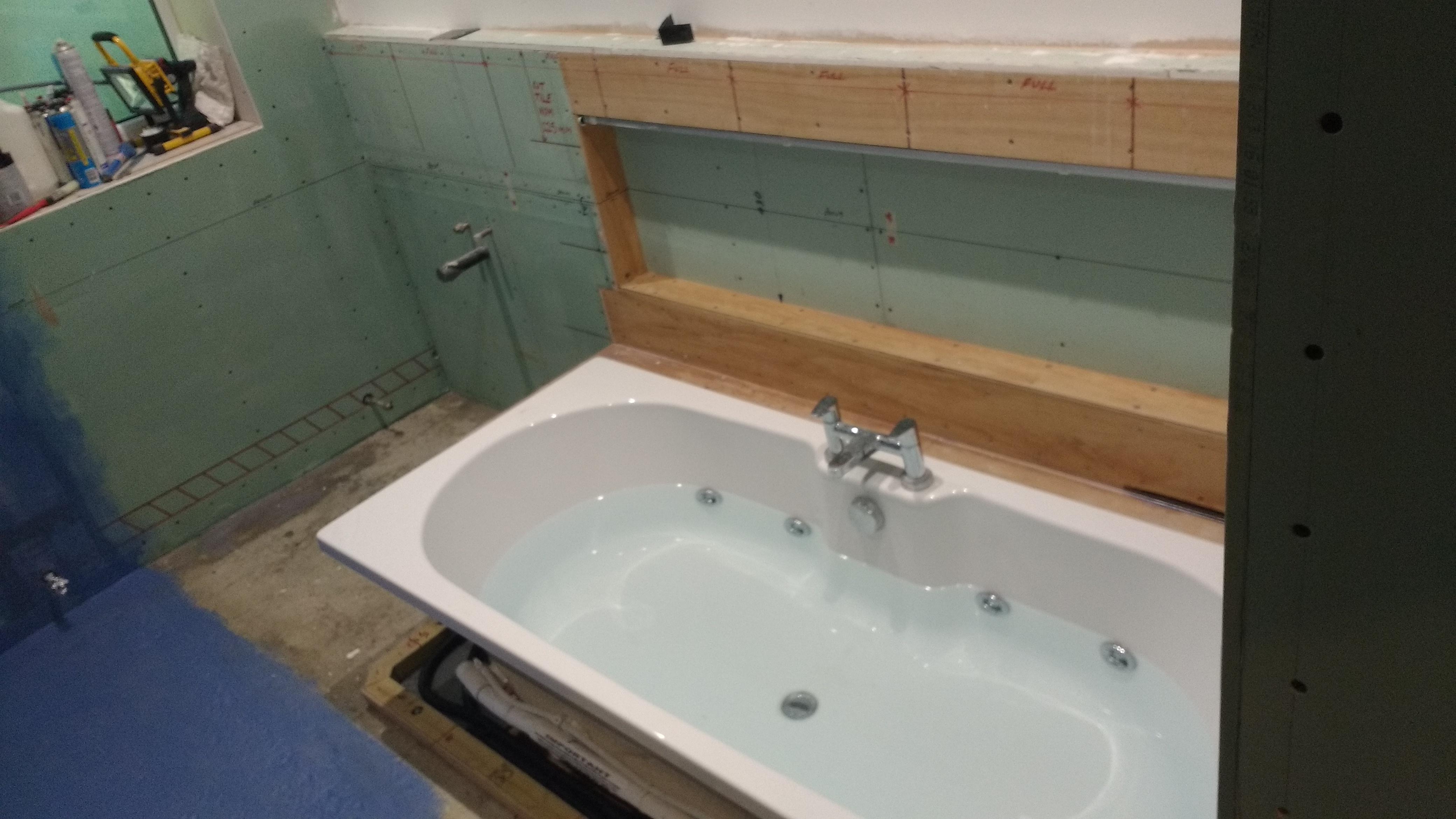

2nd coat of tanking, on the other "half" of the bathroom goes on 9pm tonight!
Other bit of bath surround will go back on once the floor tiles are down. I'll tank it then although the ply in the picture above and pocket is all primed.
In the above picture:
The bath sits on a ply "deck". Prior to tanking I will tape the horizontal ply to vertical ply junction.
I'll also tape where the bath meets the wall at the end. That'll be horizontal ply to mrpb.
Should I also tape the horizontal ply to vertical mrpb junction at the back of the long pocket?
