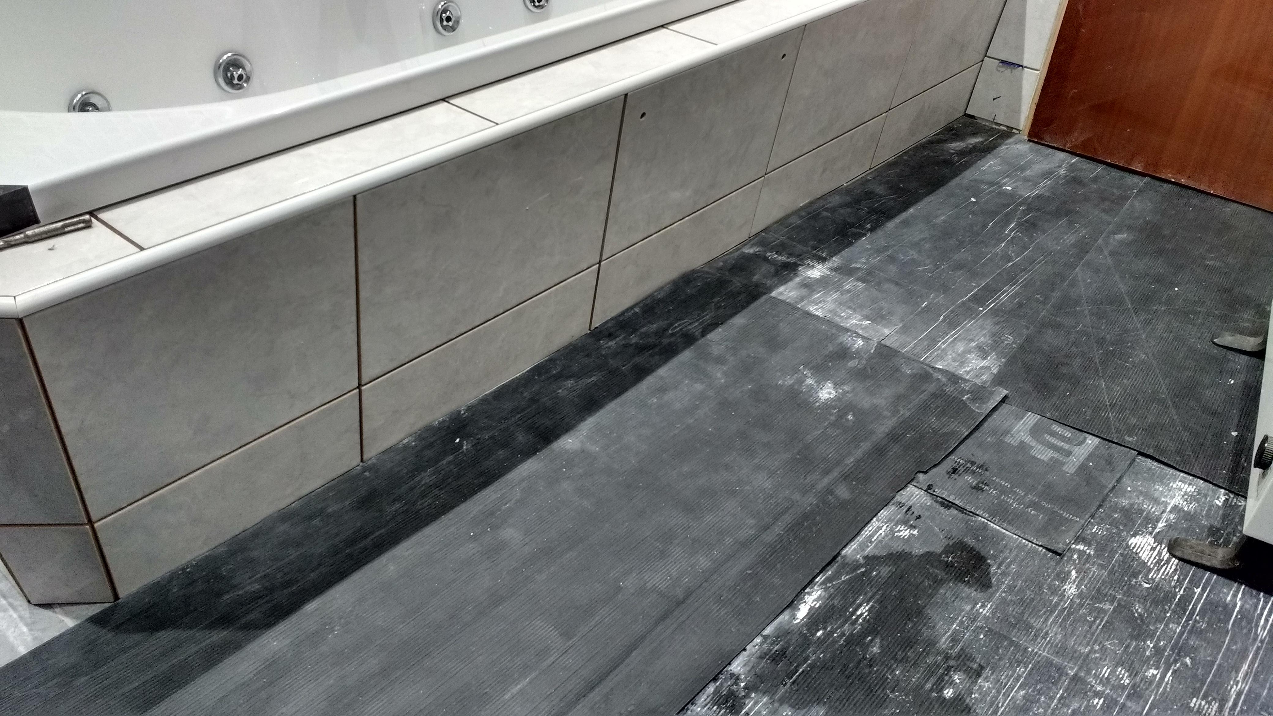

I WAS going to have 4 deck lights along the side of the bath panel down low along the floor and probably two on the end.
When I say low I mean halfway up the slimmer tile at the bottom.
To that end I've 6 20mm conduits that exit into a service void outside the bathroom.
2019-01-21_10-31-52
But...a slight, last minute change in layout means I've now 5 "big" tiles instead of 4.
So just 5 down the side maybe?
Or even 9 as in one in EVERY tile including the corner one?
Too Close Encounters?

Not sure about that layout of tiles on the front of the bath, but you've got to look at it not me!
9 is over kill and 5 might be too, maybe have a look what 3 looks like on the front
I’m with you, that would irritate my OCD! The tiles would have to line up for me to relax in that bath ? ?
I hear you both! :)
It was done initially as the removeable ply panel halfway along is only one tile wide. It has one full and one cut tile bonded to it. I could have centred the tiles with the rest and had two full and two cut tiles on the removeable panel. I felt that would make for a fragile removeable piece with overhanging, unsupported tiles once removed.
The main reason for it though is both SWMBO and I would rather look at full or near full width tiles. Centred and we'd have had thinner vertical tiles each end; by the wall and the mitred corner.
Really doesn't bother us. Beauty is in the eye etc.
Sit on the wc if you really want to stare at it full on! :)
(That is when the wc is finally fitted...).
Going to try 3 down the side and one on the end. I can always add more. Cheers.
As to "three down the side" do we reckon one in the centre and one each end or 3 in the main 3, uncut tiles?
1 hour ago, newhome said:
Where does the middle one land if in the middle?
Roughly where the 22mm hole is! :)
2019-01-24_08-26-09
SWMBO decrees we see what 3 looks like with the option of going to 5.
Chucked the lights in. I'll sleep on it. Then SWMBO will decide!

Why are some of the grout lines on the floor black? Or does the camera lie?
They're wet under the Antinox sheets.
A combination I think of never really having lifted them up since tiling when I was sploshing water about in there. I also think there's an element of condensation about it. Room is v.cold at the moment. There's 175mm of insulation under the slab. Where warmer slab meets cold room maybe?
It'll all come good with some proper heating and venting in there.
