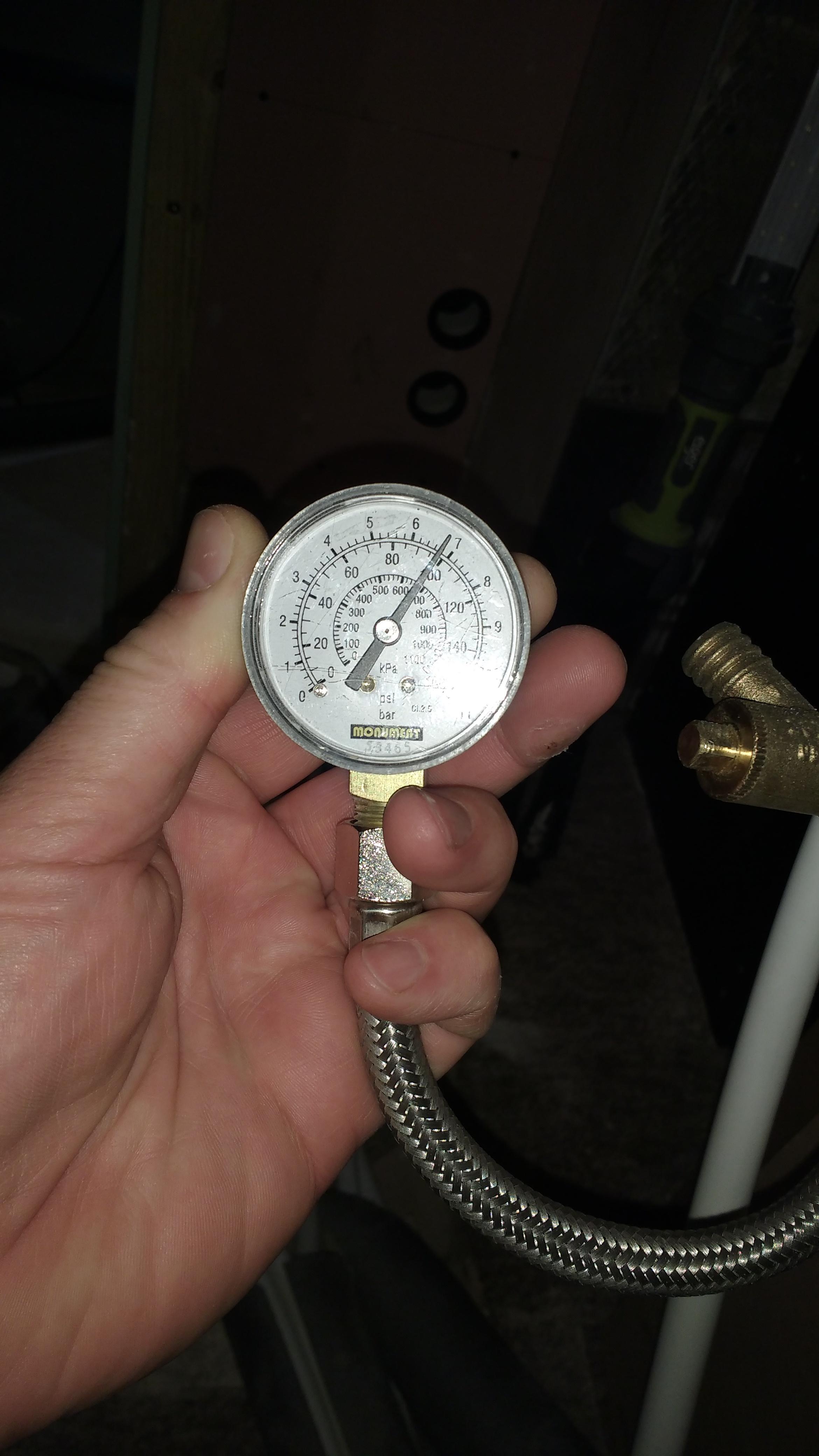

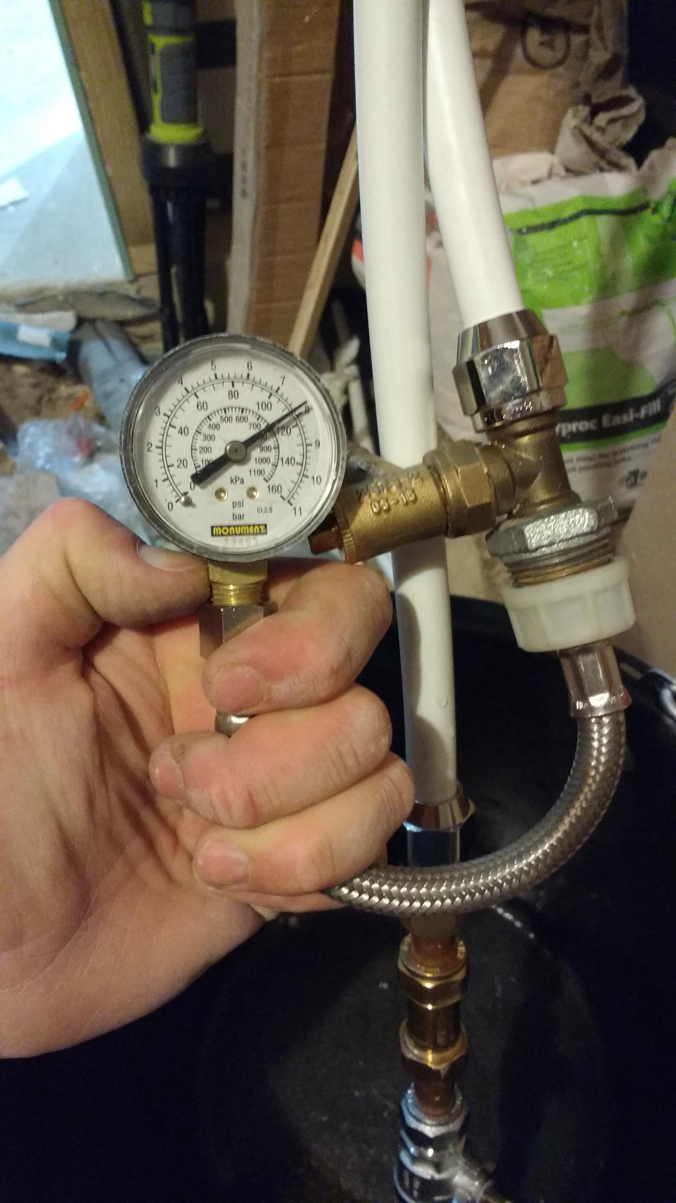

Pressure testing the towel radiator loop with my silly mains pressure!
Holding at 8bar.

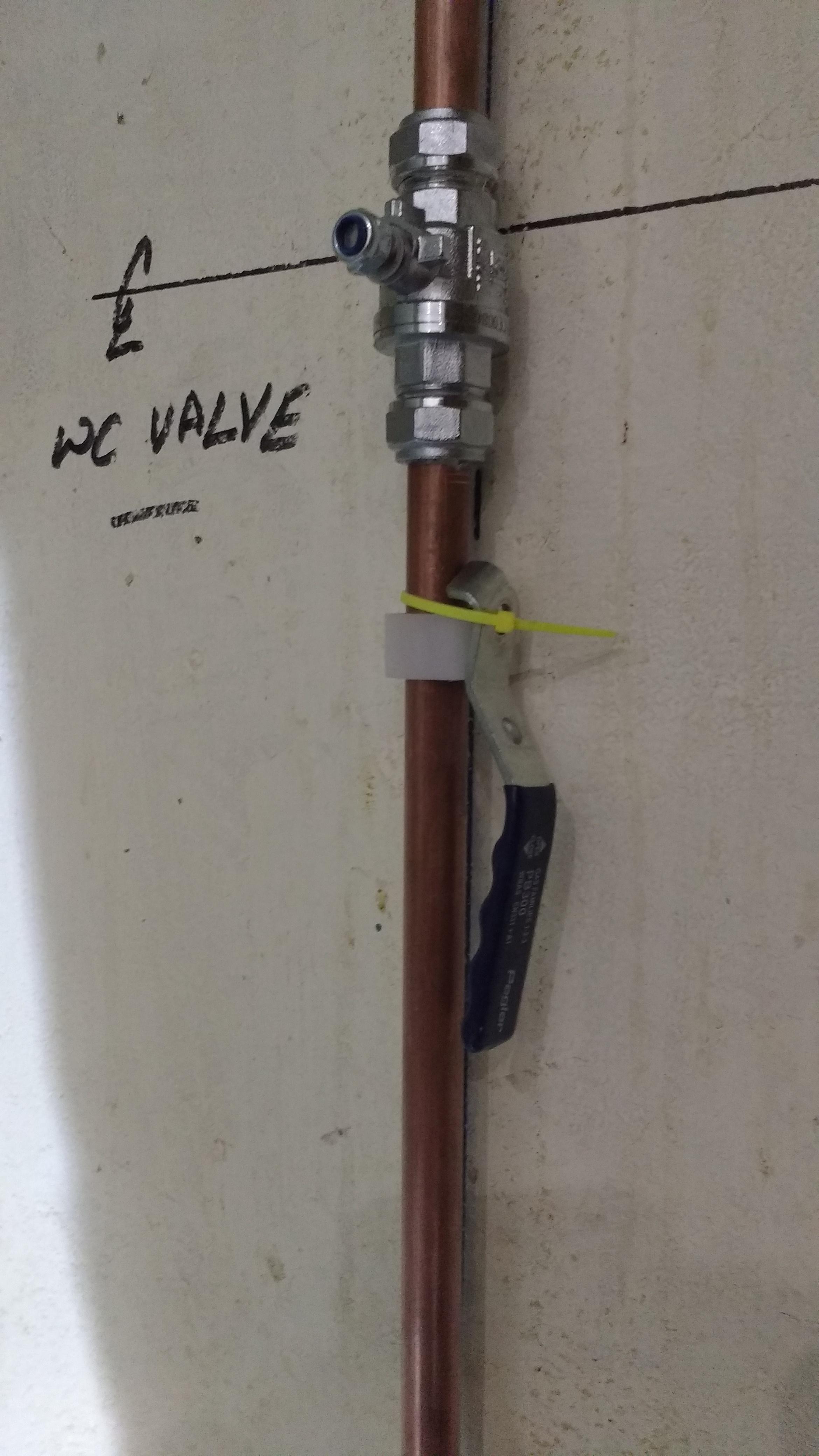

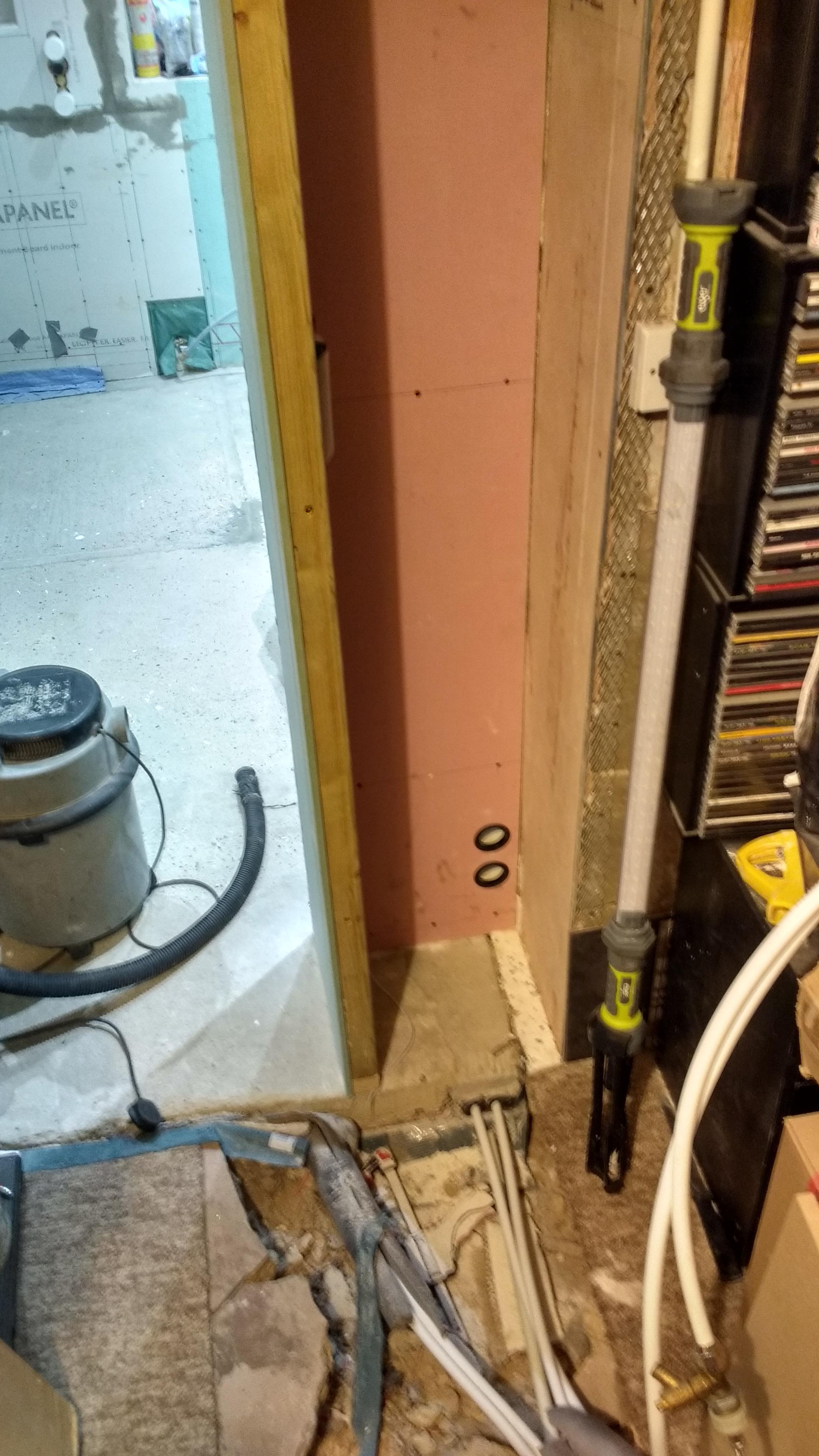

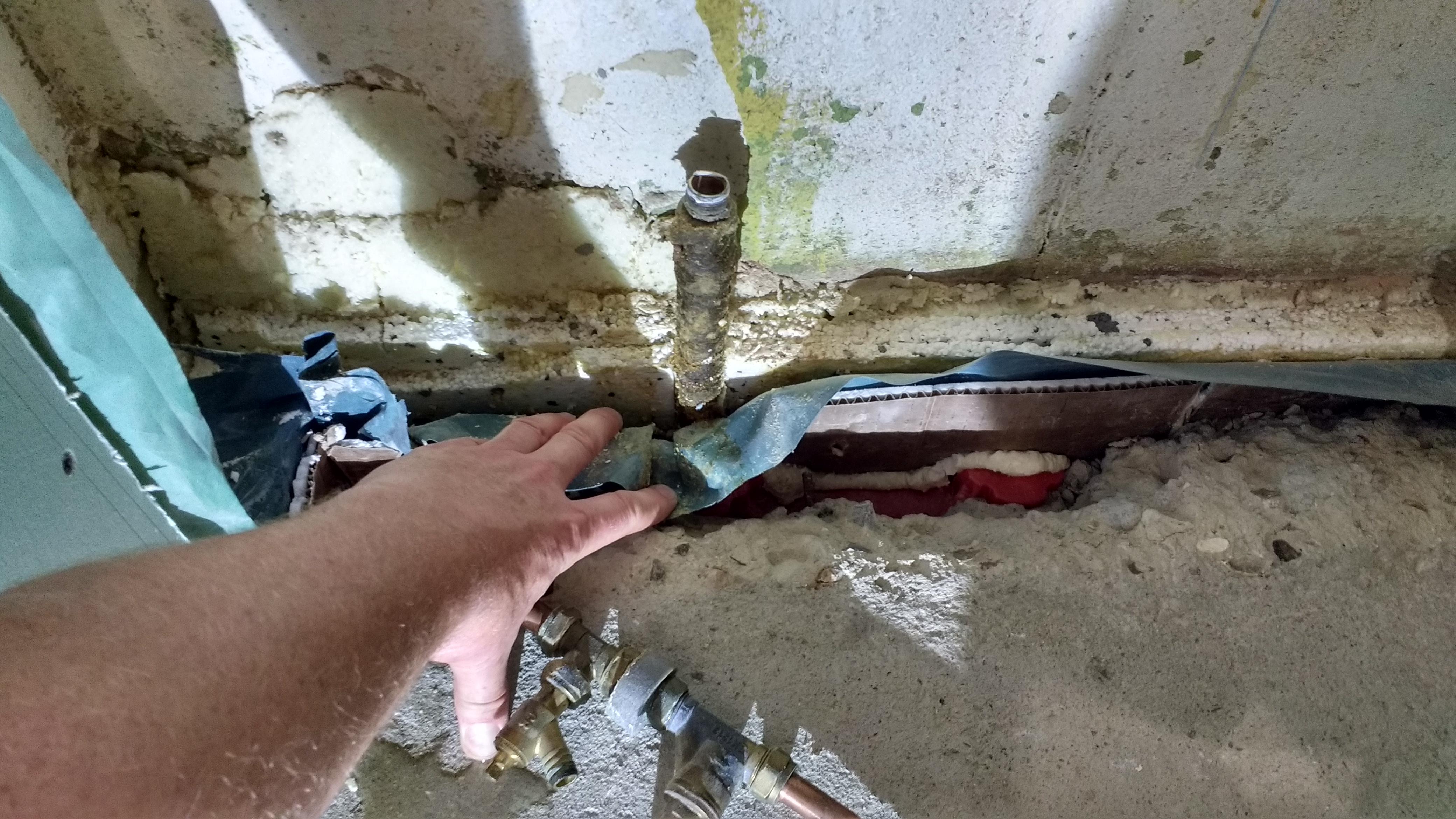

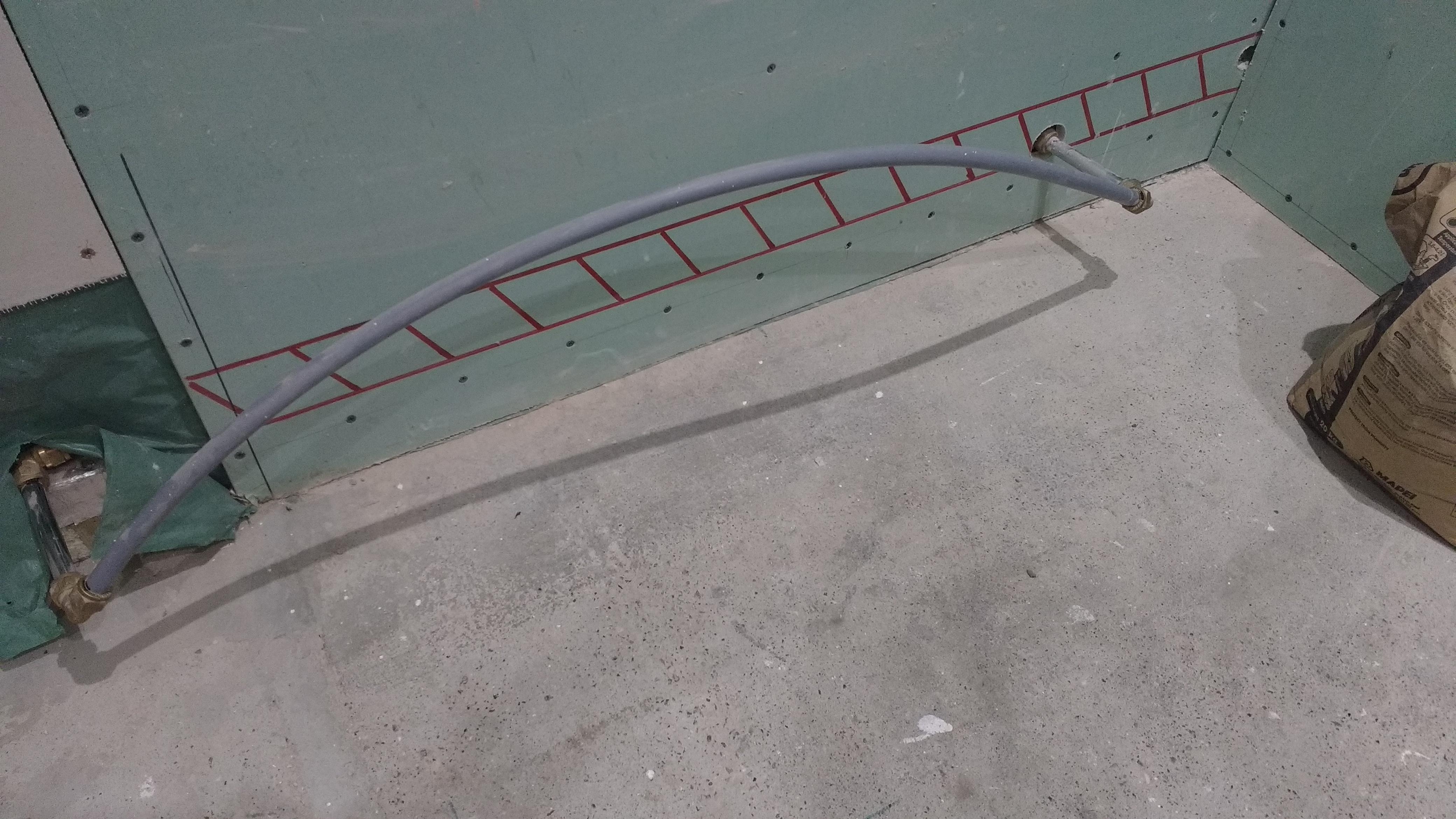

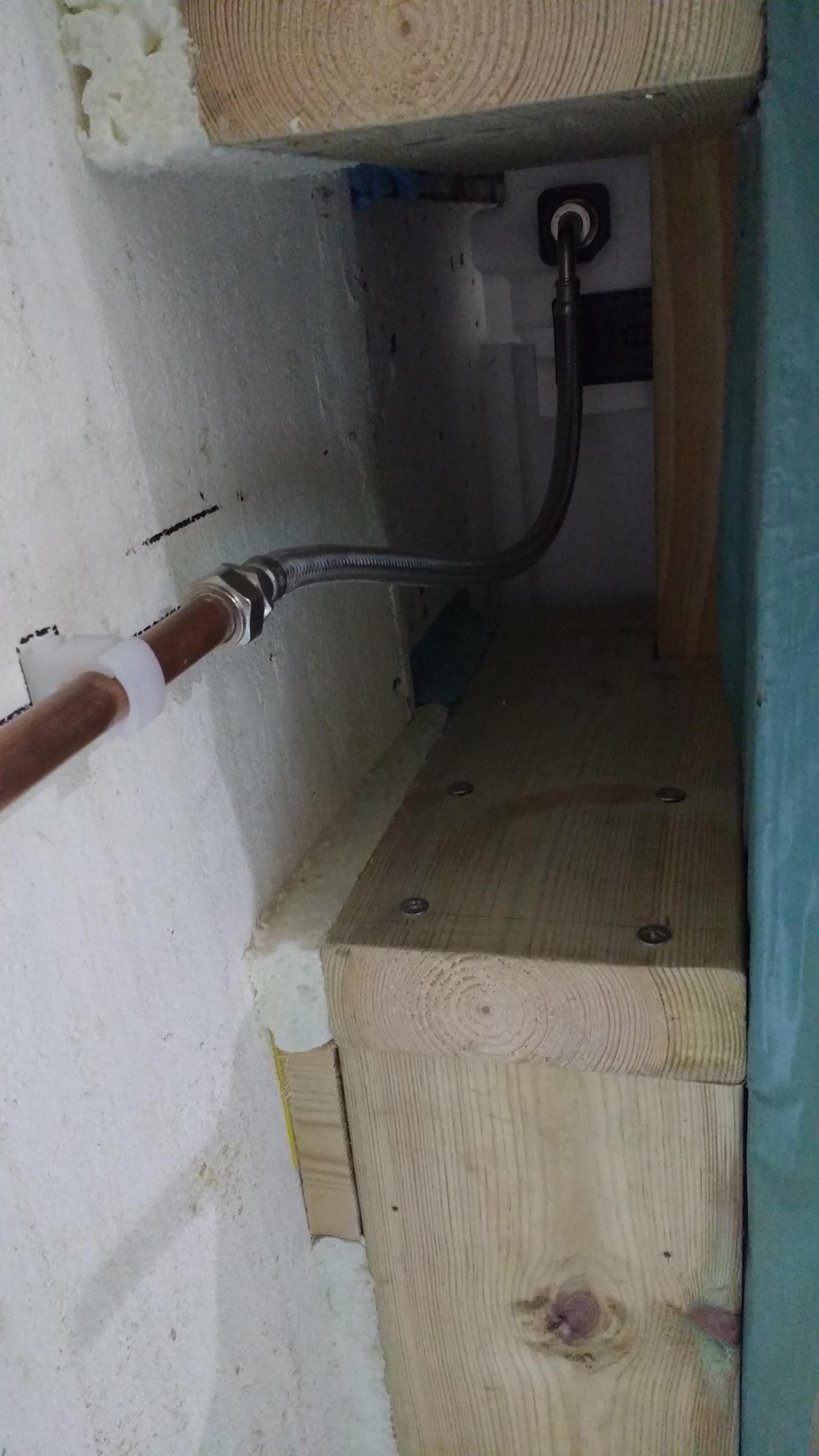

Finally got the old incoming mains re-routed to feed the Geberit cistern!
Not sure still how I'm going to finish off the back of this cupboard!
Isolation via a decent Pegler valve:
And good access from the back of the cupboard:

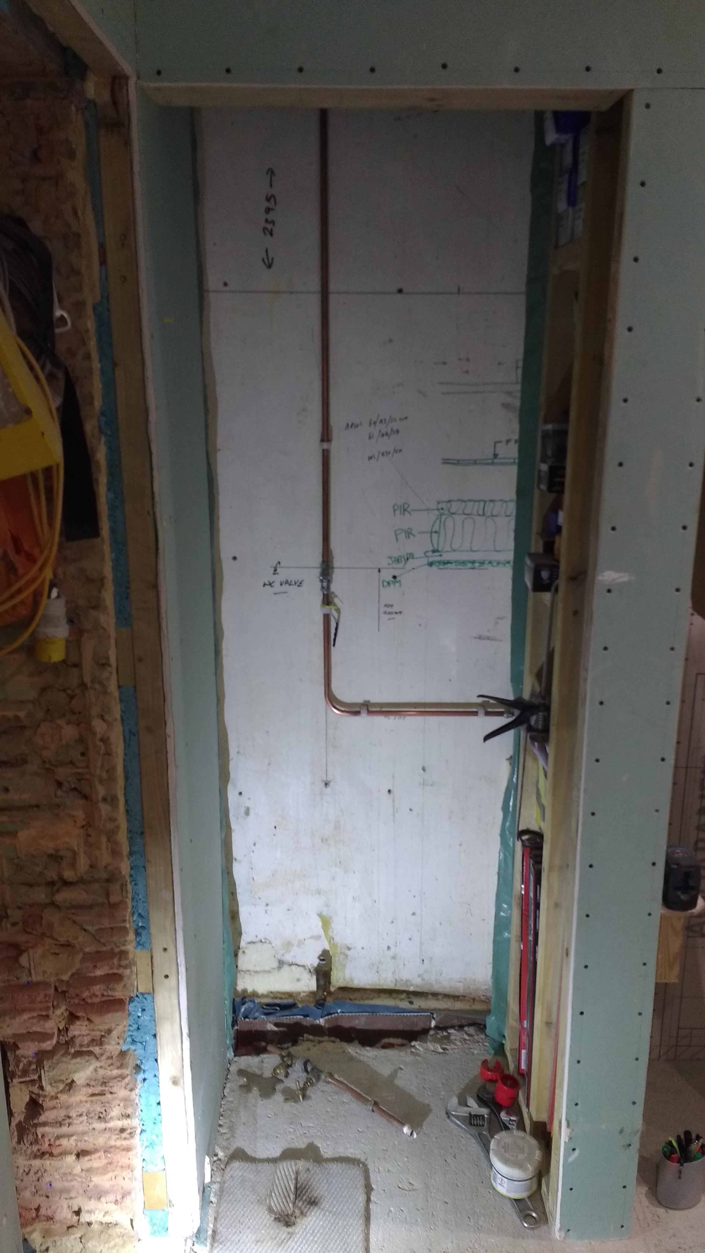

I need to hack off the old incoming iron pipe below the concrete and infill that bit...angle grinder straight through?
Do I need to "cap" the iron once cut?
It goes nowhere, just out under the footings, about 700mm down where it's happily rotting away.
Ta.
2 hours ago, Nickfromwales said:
Load of pink grip and a metal dowel banged in will suffice as a cap end.

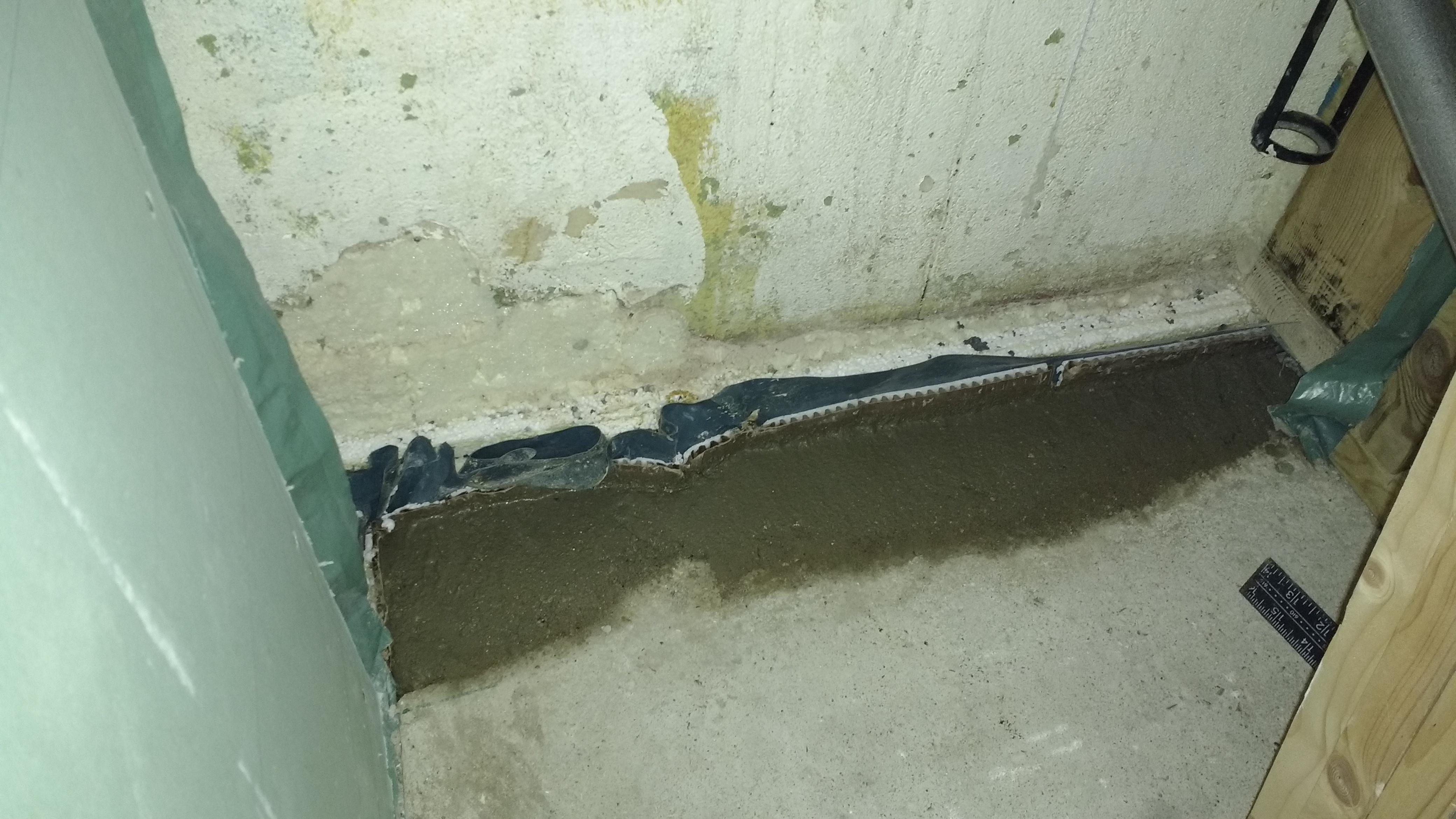

I filled the floor void at the back of the cupboard. Wetted the void with 5:1 SBR then 4:1 concrete made with the same SBR mix:

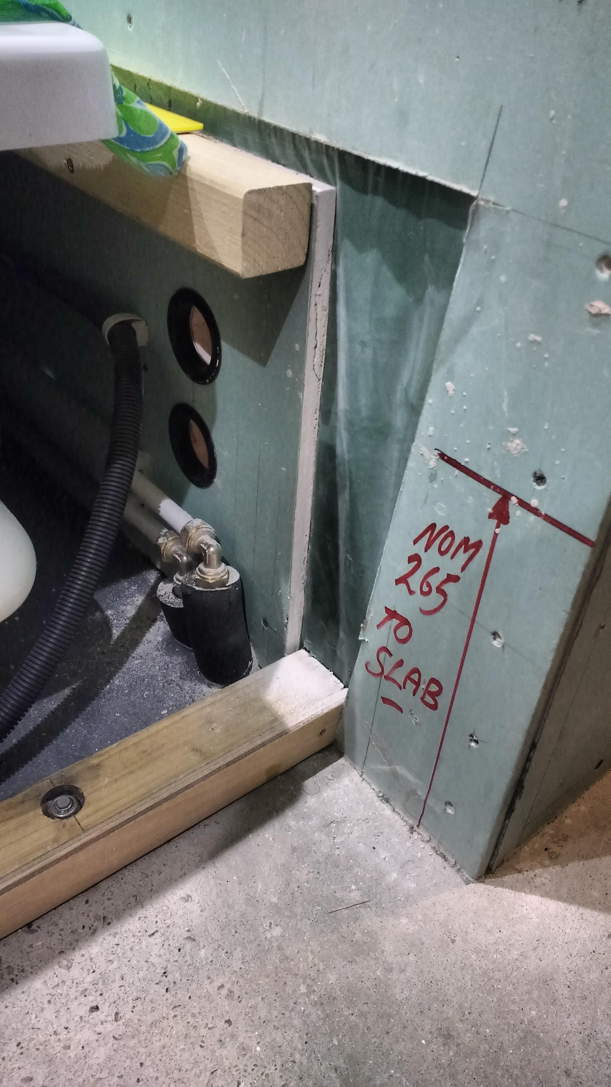

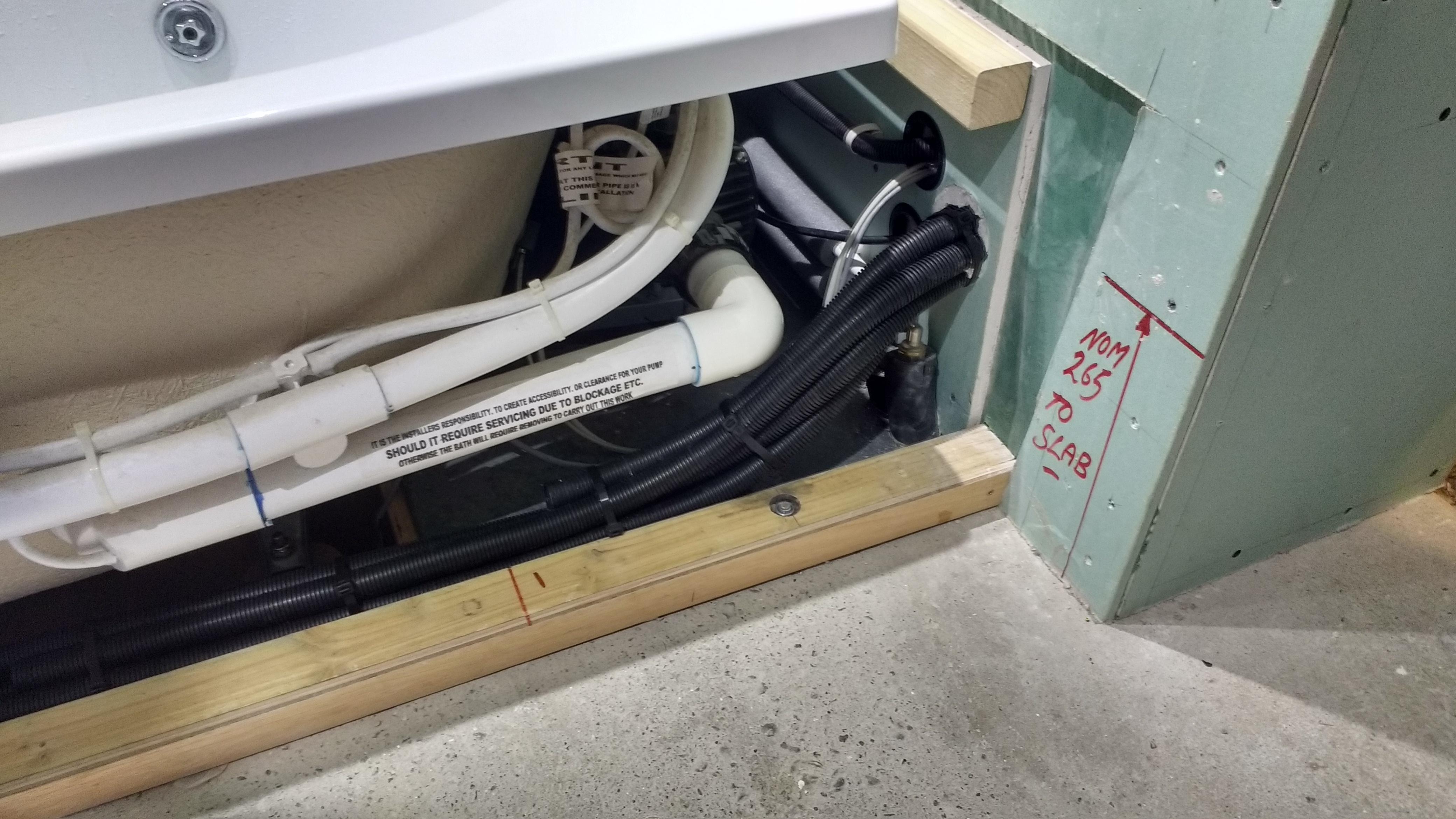

Made a start on drilling thru for the bath cabling. Some frpb in the little cupboard outside the bathroom where the relocated bath controls will sit at a convenient height (they were strapped u/side the bath originally). The black plastic things come off of heat shrink reels I use at work and fit into a 50mm Starrett cut hole a treat:
Tapered the pockets too with tile adhesive.

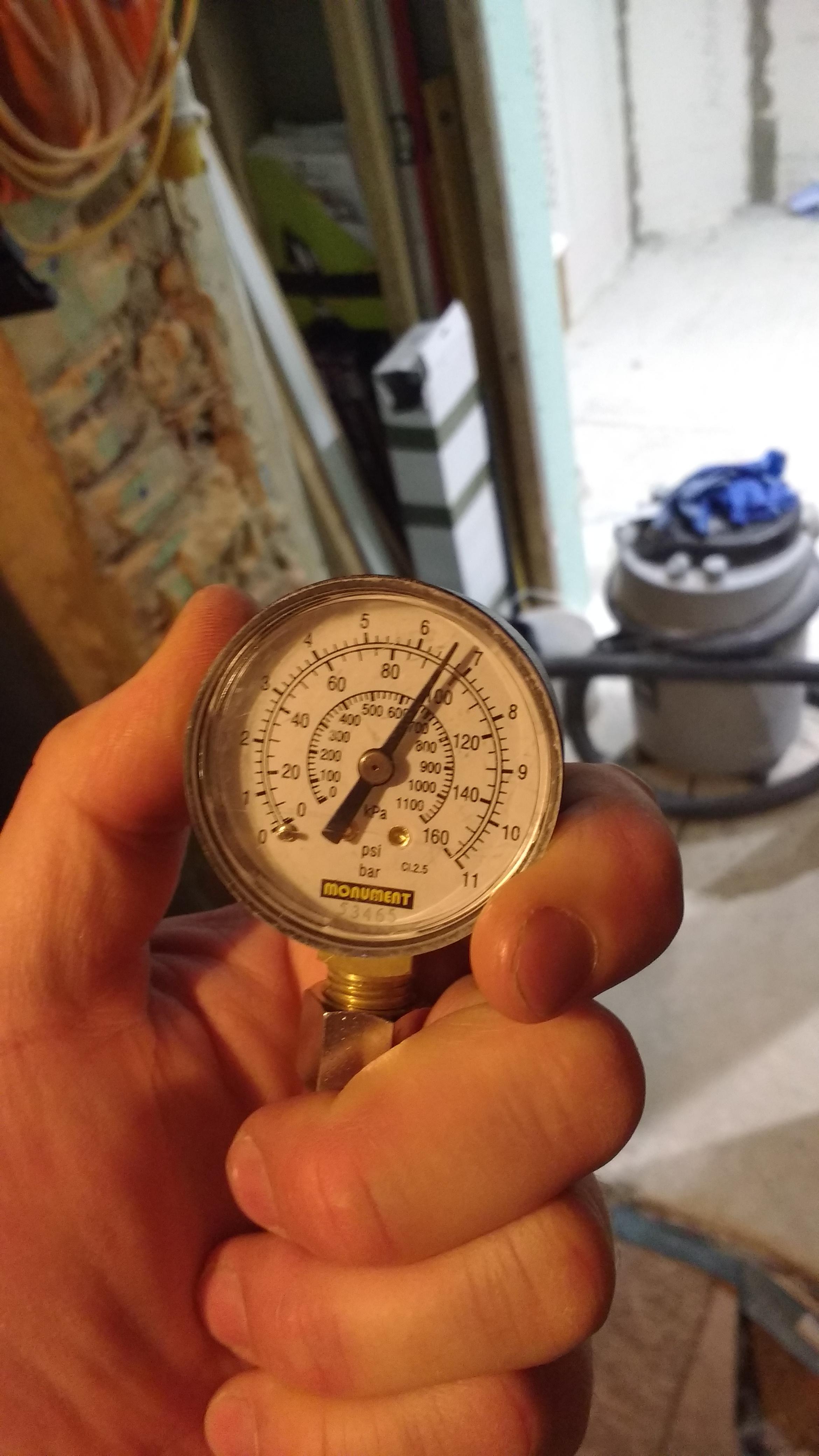

Pressure testing the towel radiator loop over the last 24hrs and it's dropped by a bar.
Can't see any leaks though, at least at the testing end or 6 elbows!
There's one hidden elbow on the RHS in the wall that's straight onto Pex-Al-Pex. Nothing on the floor though.
Ambient has dropped massively though. Could that be it?
I bled it pretty well I thought too. Via the drain valve one end of the loop until it ran bubble free.

Temp does have a big affect on pressure, so could well be that.  Chill.  Tanking wasnt as bad as I thought it would be - just a bit slow with a brush / roller combo.  Ive got tiling to do next - putting it off but need to man up now really.

How did you apply the primer and did it go far enough?
Wtf? I can't see a leak anywhere! Dropped a little more maybe?
At 7 bar you will see even the smallest temperature fluctuations ..! Ever considered your cheapo gauge is letting by.....??

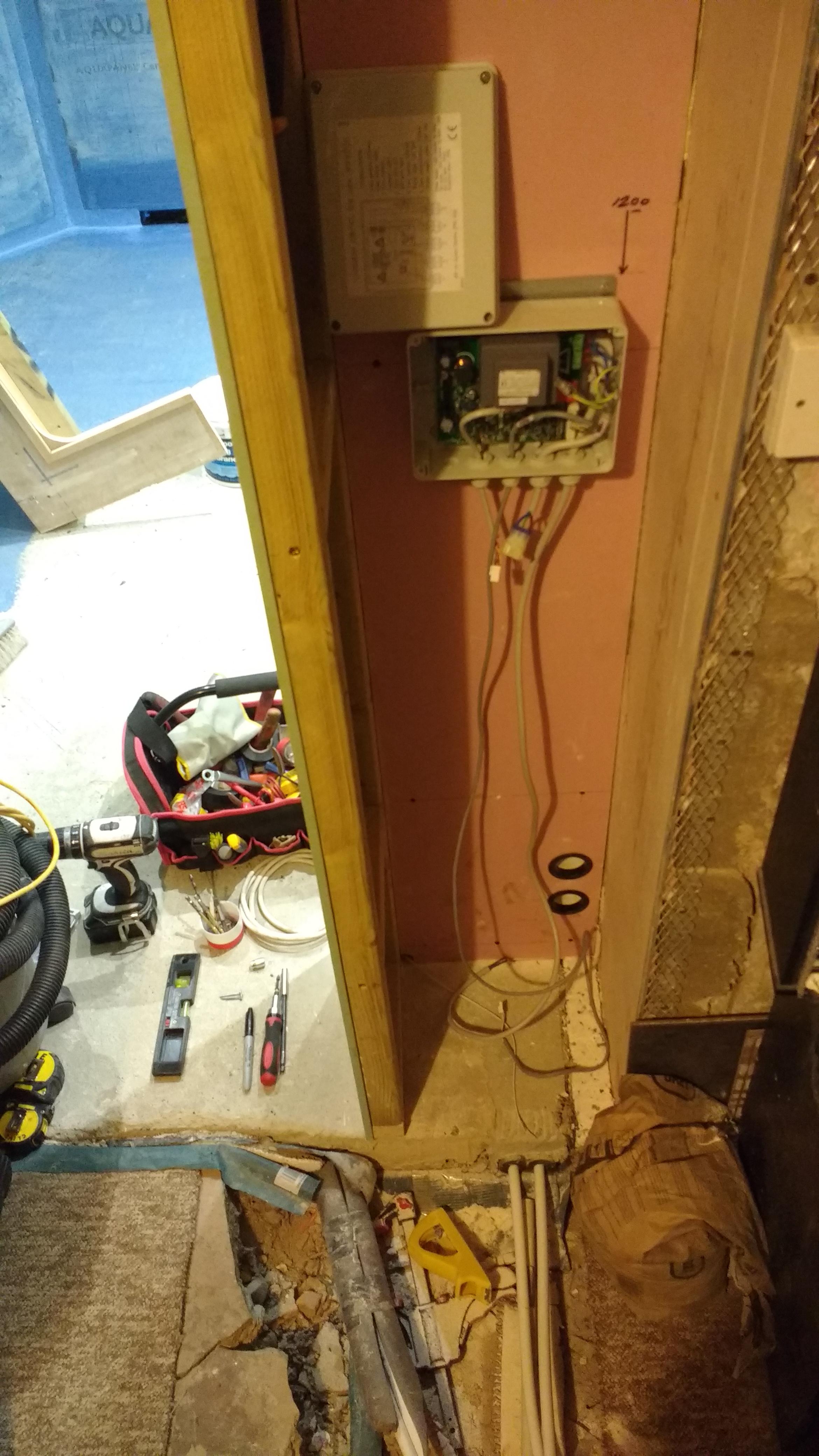

Looks like I've got to extend just one screened cable, result!
Has anyone seen the bath control box? :ph34r:
Seriously, wtf did I put it???
Edit: It appears SWMBO has "tidied it up"! "Grey thing with grommets and a black lead?" she said...
She's now looking, I'm now drinking! :)
Edited by Onoff

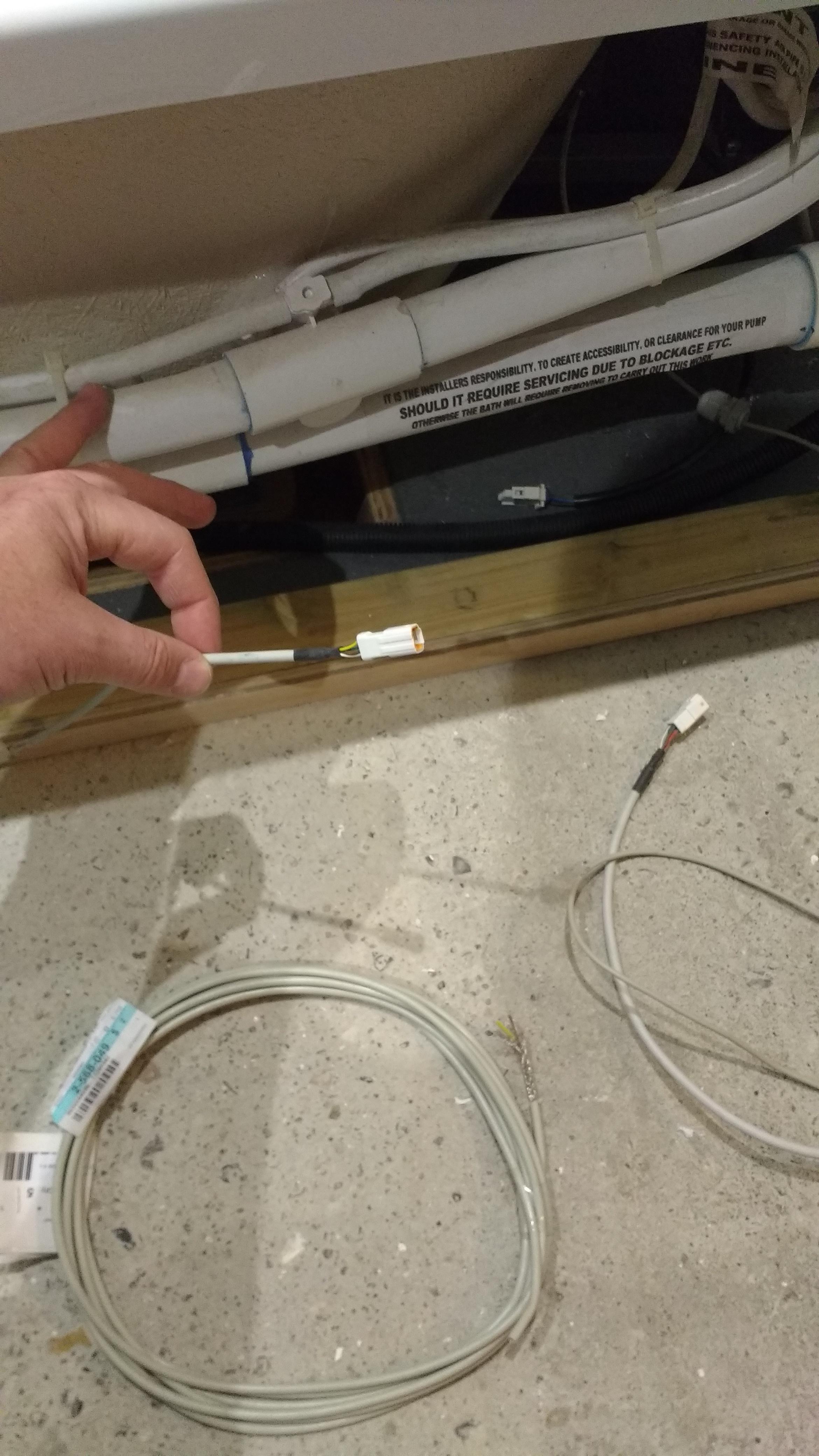

Found it and whacked it on the wall:
Not acheived much today...too flamin' hot!
Each 12V deck around the bath has its own 25mm duct so replacing should be a doddle. All connections are outside the bathroom in an accessible cupboard/ riser:

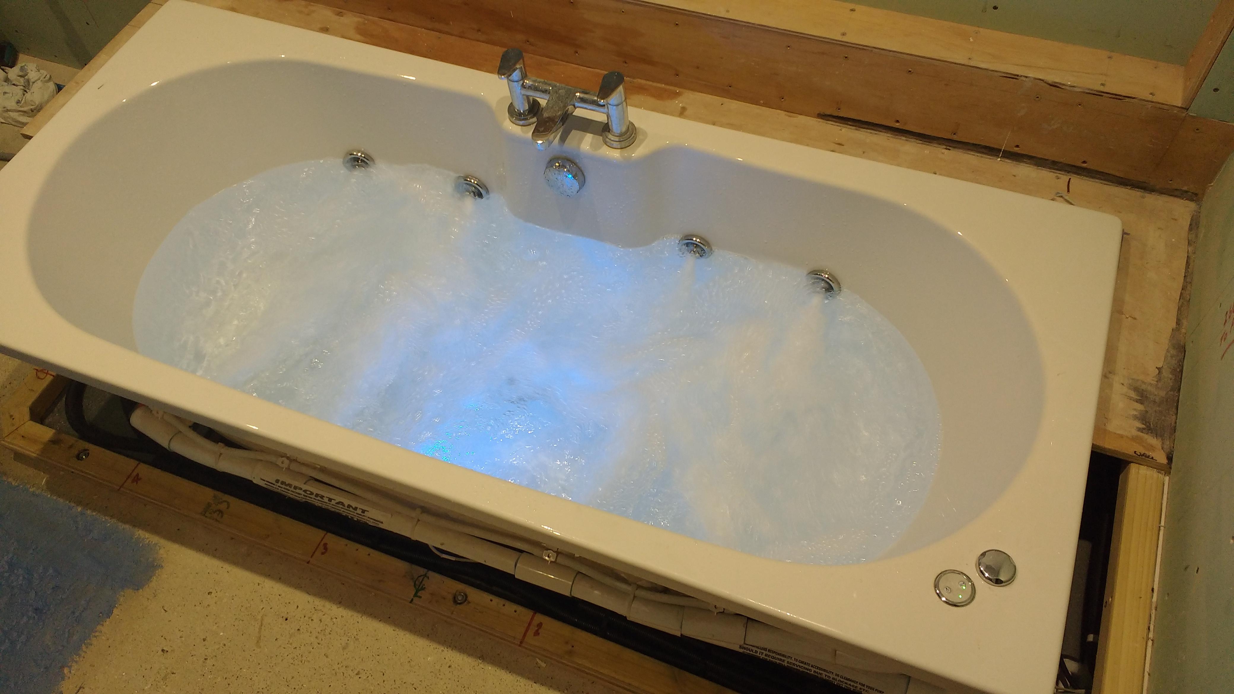

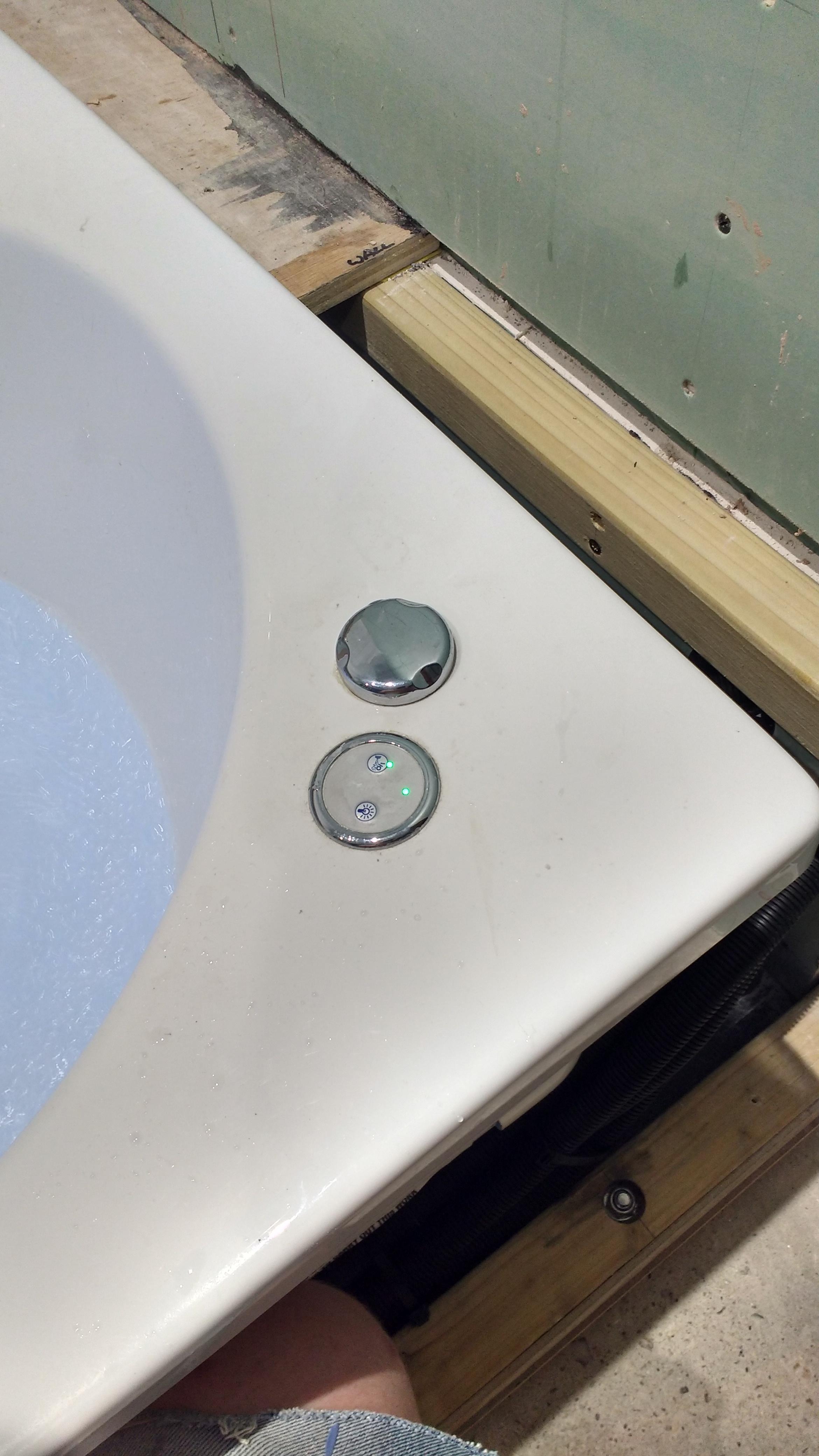

Well we have lights and bubbles!
All off a plug top at the mo but I want to check for leaks before closing the bath in.
Hot and cold ran out before I could fill above the jet line...it's just about on it.
Light on/off works fine but jets are either full whack or off...what I think is the jet control does nothing...
Found one snapped wire on a pcb connector, no surprise there seeing how long it's been sat! :)
