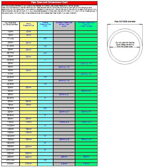

Does "50mm" on these solvent weld ABS fittings refer to the nominal bore? The internal dia of this elbow is 55/56mm. On the outside it says "Plumb Centre CB3  55 (2) 88.5deg" yet it's marketed as "50mm".

Just come across this which seems quite handy:
Pipe Sizes and Dimensions Chart
