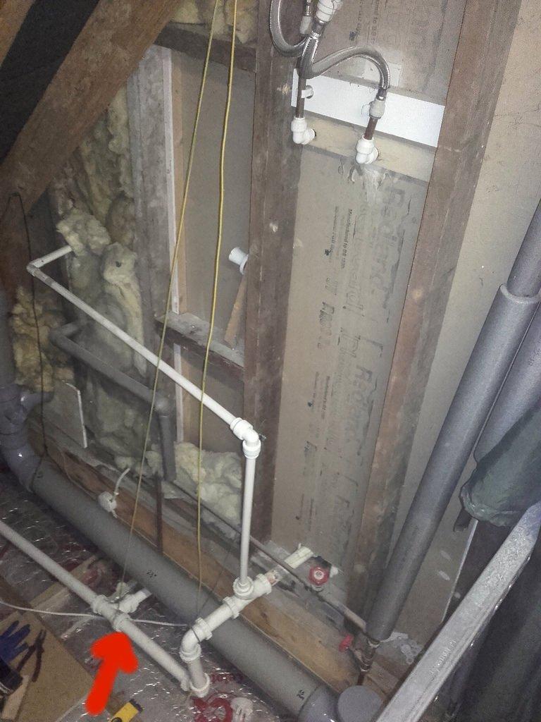

The existing, upstairs basin waste as the red arrow points to below:
That cannot be raised up. It's touching the underside of the 9"x6" that white JB is on.
Sure, I could drop the shower in like you said but the basin waste, best I could do is come into the grey soil via a side mounted solvent waste boss maybe?

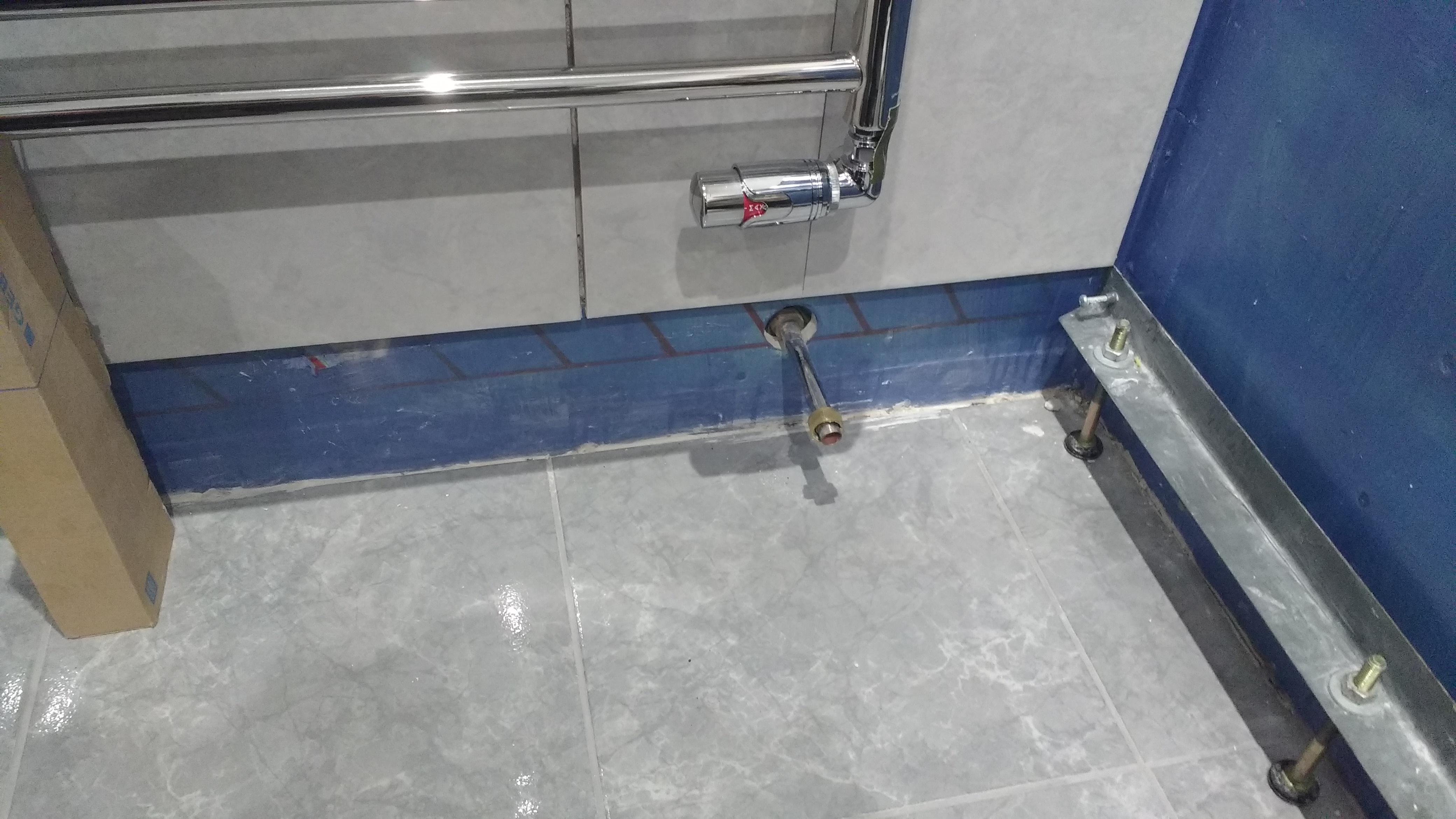

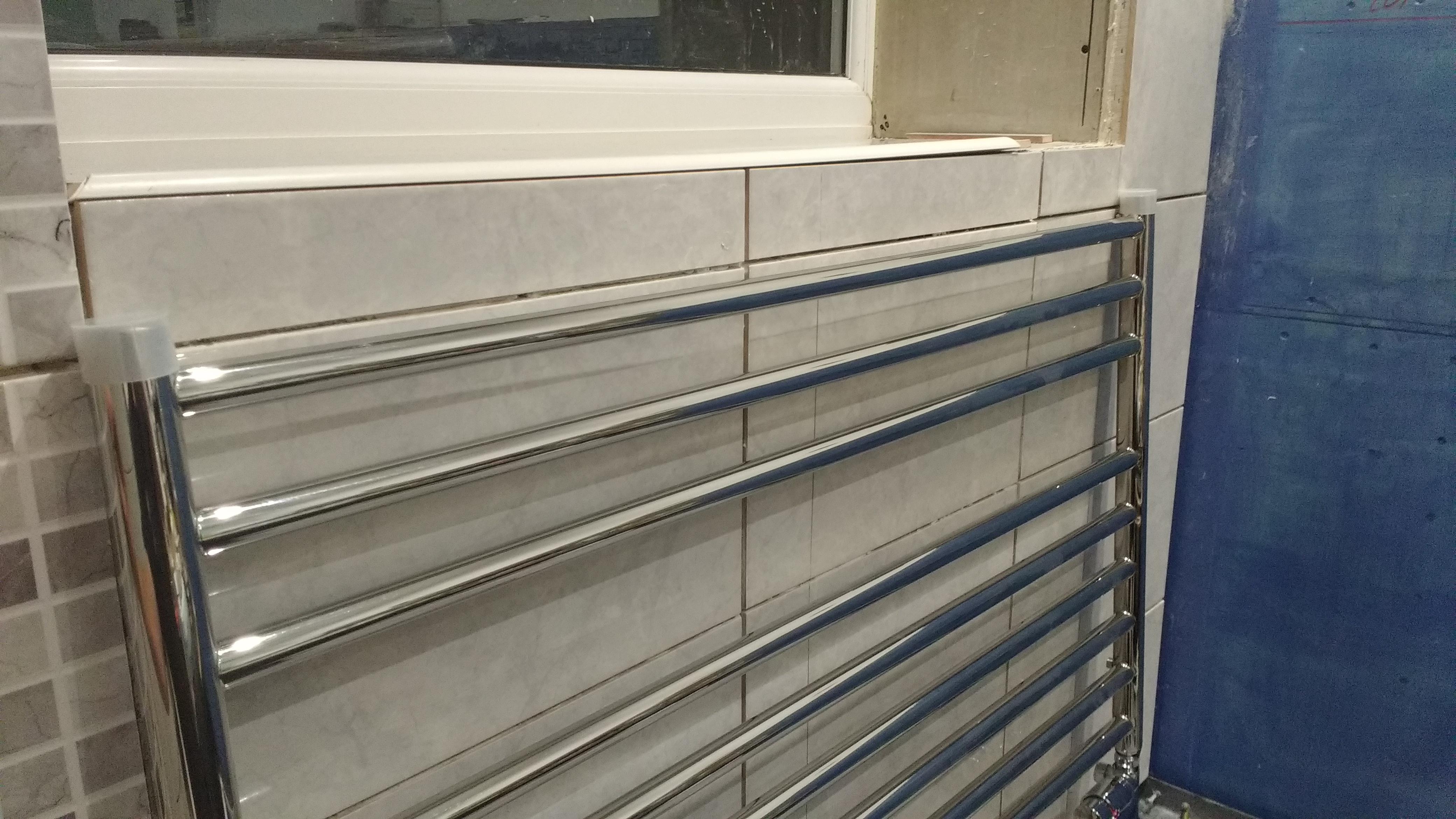

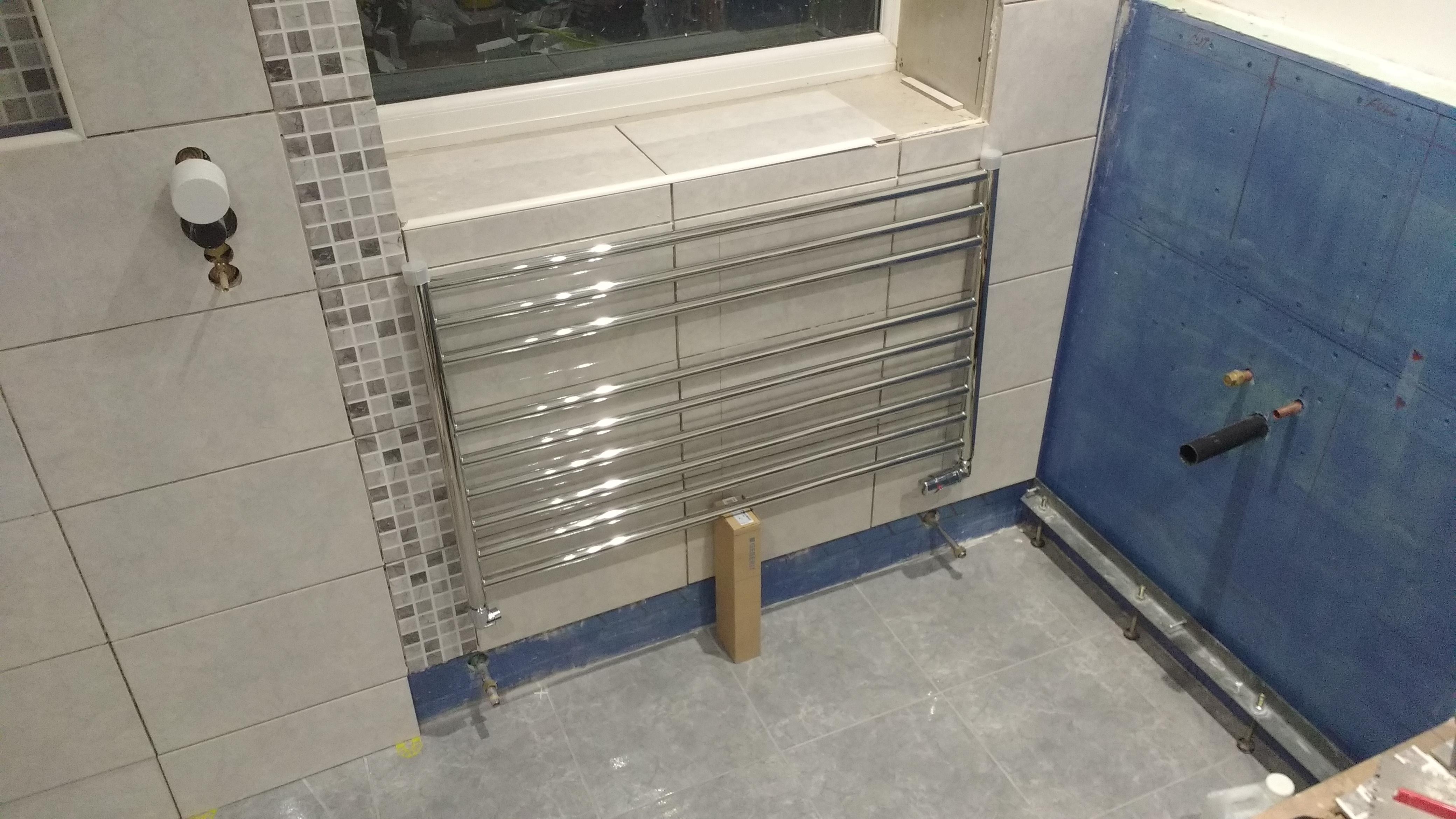

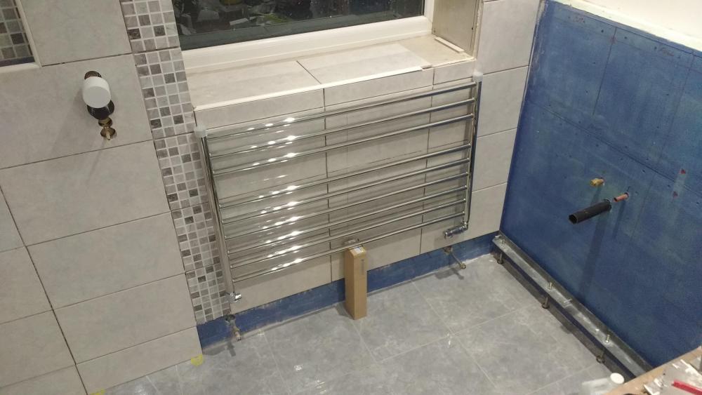

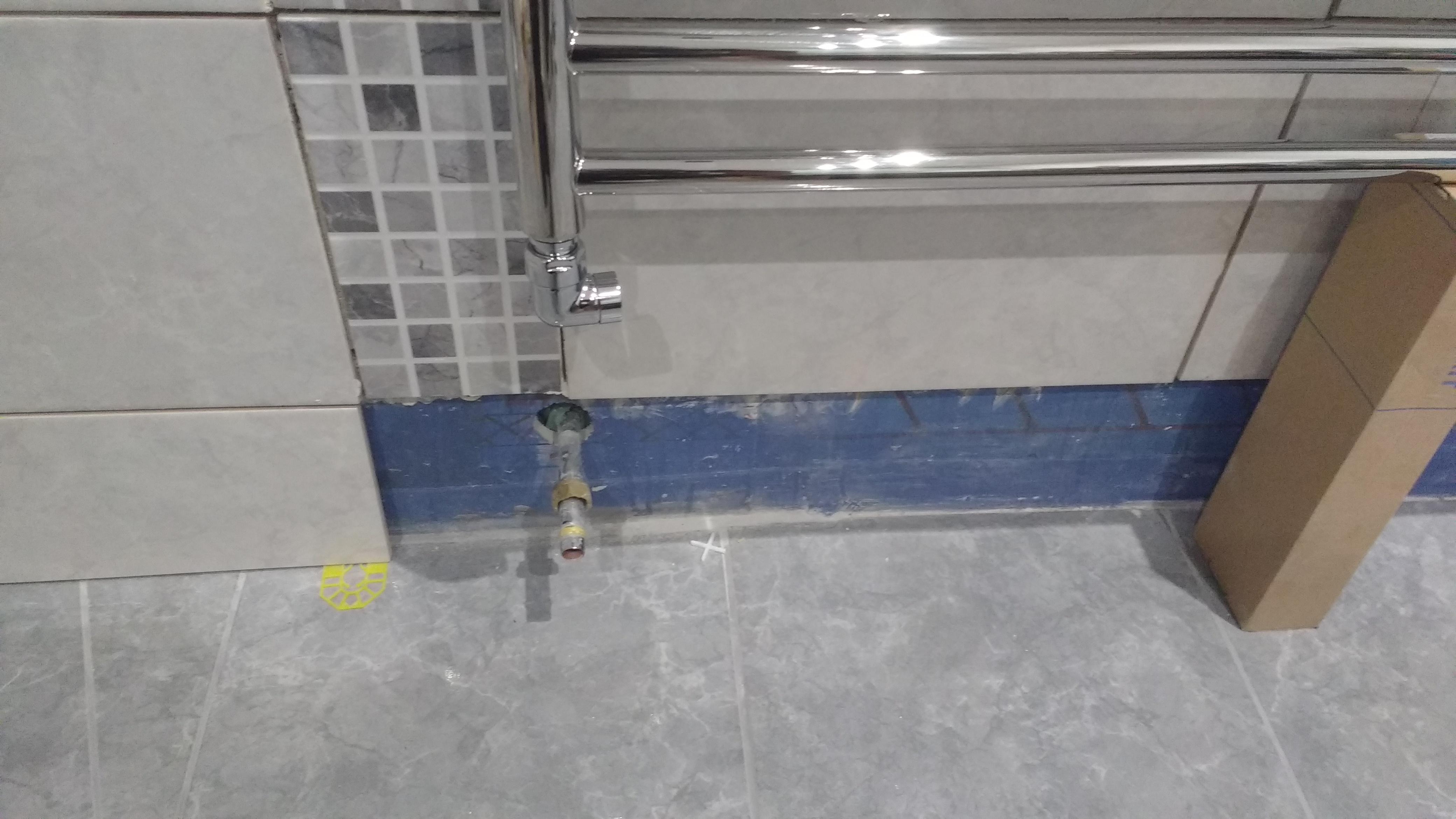

The towel radiator...
It's going to have to sit a lot higher than I'd envisaged to look right. Currently balanced carefully on a Geberit box:
So presumably I need to drop the valves lower onto the chrome 15mm stubs coming out of the wall? Then have chrome verticals coming up to the rad? Going to look strange having that trv on its own low down by the stub pipe.
Thinking if I move the rad up a bit I can lose that line of rips at the cill?
With hindsight maybe I'd have brought the stubs out of the wall higher up. Or should I just have the rad low?
It's been a helluva long time since I've fitted a radiator and never a fancy one.
Any glaring mistakes, tips etc?
Cheers
Edited by Onoff
You could put chrome compression elbows on the stubs coming out of the wall and then another short section of pipe up to the valves
Bought these and a couple of Pegler 15mm compression elbows:
https://www.screwfix.com/p/drayton-trv4-white-chrome-straight-trv-lockshield-15mm-x/34063
Should let me put the valves up by the rad rather than down by the floor.
@Nickfromwales, how many turns of ptfe tape in these fittings where it screws into the rad?
Cheers
Edited by Onoff
You could puts straight male 15mm x 1/2" chrome 'copper to irons' in the rad, then short pieces of chrome pipe, then straight rad valves, then more chrome pipe and then into chrome comp 90's. That way you'll be able to put the valves 'mid-way' thus satisfying OCD ;)
18 turns should suffice. Crossed with the other replies.
Edited by Nickfromwales
straight
