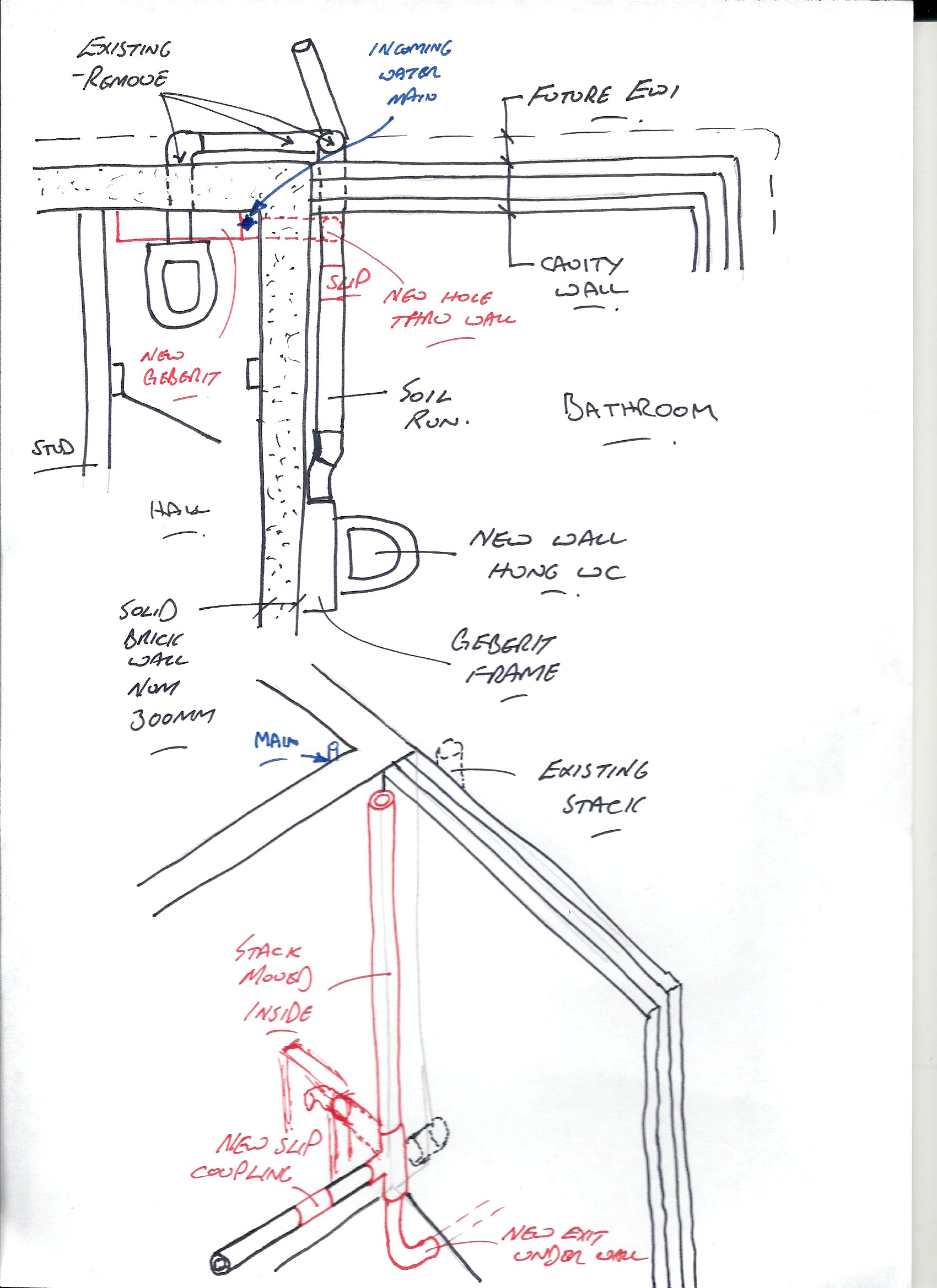

I think one thing holding me up is "regret" that I didn't bring the vertical stack inside, up the corner where it currently exits through the wall. Then down and under the floor. Could have got a totally clean, external wall, easier for future EWI.
8 minutes ago, ProDave said:
Not too late to change it?
No, but maybe too early? Don't want to do it all at once now. That could be a 218 task? :P
Never too late...but...
Mod the stud wall - easy 'ish
Dig out the foam & introduce a slip coupling to the horizontal (brown) waste from the wc - easy. Then worry for ever more?
20170730_101136
Excavate that corner with restricted access, OK the 100mm slab isn't there. It'll mean digging (coring? ), down through the Polypipe panel, PIR, EPS, the concrete to square off footings then through the footings themselves:
Selection_192
Breaking out the concrete I introduced in that corner will be tight  - where the green rake handle is:
SAM_1086
Mod the soil pipe in the loft
Introduce a swept bend and bring out under the footings -
All to get rid of all this. The further over, black soil from the d'stairs cloak would also need to be changed to down thru the floor and out under the footings. If I later change to a gable end even the drain pipe could go. Then blast all that paint off, render and EWI!
SAM_4277

Bull by the horns, and do it. You'll regret it later if you don't, but then I'm not the one having to do it. Plus it'll extend the thread to a definite record.
If you put 200mm of ewi on the outside you could go straight over the soil pipe and never know it's there.
Winner. ?????????
on a serious note is it a possibility to make boxing out of Ewi and hide the soil pipe. ?
Winner. ?????????
Is that a serious option? A boxed in soil pipe would still be an ugly feature on the wall.
Would it?
What if the boxing was quite wide like a chimney breast on an outside wall 900wide 150deep
could it look like it was always there ?

How reliable are 110mm (brown) slip couplings? Do they do then with a rubber double seal each end rather than just one?
Or...is there such a thing as a solvent weld slip coupling though I can't see how that'd work!
Ta.
Ta.
They have to be double socket ( double seal ) to slip, and they're as reliable as a Volkswagen :).
Can't see these alterations to lose the external soil pipes going down too well...where I brought the new incoming water main in is a pita!
Edited by Onoff
Just extend them for now and EWI the walls. Then cut them back so they can be clipped onto the EWI and move on with the bathroom. ;)
I thought soil pipes penetrating the EWI sort of defeated the object and created a cold spot? Plus after a smooth exterior wall.
It's the real world which means two tiny cold bridges on an otherwise thermally efficient existing dwelling = infinitely better ;). Sometimes you've got to accept a little compromise.
Calculate the additinal energy loss from those two insignificant bridges, and then work out the cost of re-doing all the good work so far and you'll have your answer. Just simply not worth it imo. Is the elevation in question at the side / rear ?
Calculate? That'll be a first! It's all plagiarism and gut feel in this house! :)
NNW facing elevation hence takes the brunt of the wind coming up the valley and always in shade. 50%  of the elevation is solid brick nom 300 thick. Then the later bathroom extension that's a cavity wall (pick a brick/block type and it's probably been used from what I can tell). All covered externally in bullet proof render made with God knows what.
I'm may regret this but sticking with what I've got and living with external soils.

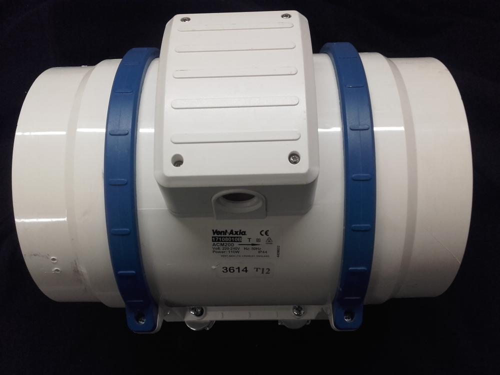

SCORE! Client wanted this 200mm fan replaced as it was "noisy". All it was was a piece of errant plastic trapped inside and rattling around. Nobody's interested in repairing nowadays! :(
Not sure on the spec but thinking it'd make an extract off the back of the cistern / pan. Shove it up in the loft proximity det. next to / above the pan.
A big job for big jobs! :) Overkill?
