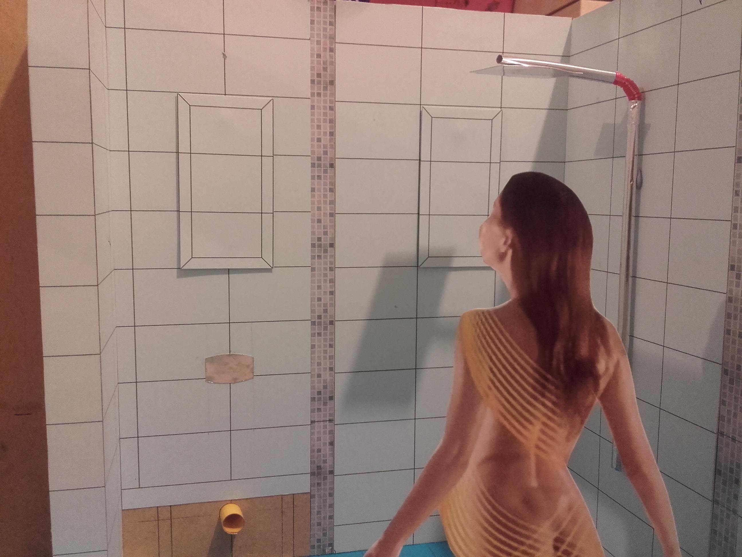

So pockets, bit of a quick cheat on the model rather than making more MDF dust but it gives me an idea. Thinking two lit pockets on this wall as I've a good few inches depthwise.
2017-12-31_12-18-14
Not sure whether the pockets would be better next to the mosaic. This would allow the shower mixer /  riser to go on that strip of tiles next to the pocket. I was though thinking of the whole "you don't want to get wet turning it on / remote mixer" thing. Tricky this!
2017-12-31_12-28-38
Probably need to see this in context with the big pocket above the wc...

The whole "I don't want to get wet turning the shower on" thing is just a load of bollo...... You turn the shower head to one side and then flick the switch. You also don't want to be dripping on the non sloped floor when adjusting the valve from head / handset / temp etc, so I'd actively put the valve wiring the confines of the wet floor area.
Jump the pockets up a tile high each. The bottom one is too low.
8 minutes ago, Nickfromwales said:
Oh, and square looks so much better. :)
Square pockets? Could drop down to two tiles which would be 400w x 500h?

A bit of reconfiguring:
Three pockets didn't really work. It put the height of the "shelves" of the two right hand pockets at 700 and just over 1600 - too high and too low!
20171231_165244
Two pockets giving shelf heights at 1200mm seems better:
20171231_184200
Couldn't resist mocking up a shower (& flush plate) but tbh I think it's the best place for it (the shower) on the other wall:
20171231_184302
2 hours ago, Onoff said:
20171231_184302
I quite like the two pockets set out like this. Just raise them up, where they are, 2 tiles higher, then make them one course taller and bingo afaic. ?
Hmm...
OK pockets 1 course taller and moved 2 up:
20171231_220748
20171231_220732
Or 1 course taller and moved just one course up:
20171231_220422
20171231_220531

48 minutes ago, Nickfromwales said:
The latter. Looks much better and if tall enough you can put a glass divider to double the shelf space.
Still mulling whether I'll need a 1200mm high shelf in the wet room space. Thinking if we ever need to shower in a wheelchair or sit on a chair. A lower shelf would put shampoo, shower gel etc within reach. Like the divider idea, I'll play with that.

Just playing with the floor tile layout. Nice to print off the CAD wet room corner to scale and it fitted. The wet room area has spacers but the rest doesn't so is slightly off:
20171231_224335

Just realised the pocket's are a tile too high!
20180103_211403
20180103_211330
I reckon if I go for a tile width on the mitre I can go two full tiles either way if I maybe widen the mosaic strips a tad.
