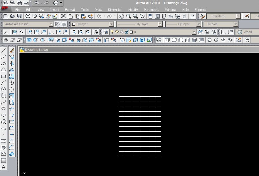

I was going to say that I’m sure you could have mocked this up on cad and made any alterations a lot quicker. But then again who am I to say about doing things quickly. ?

The old chicken and egg problem - what comes first the tiles or the walls.. have you thought of switching from landscape to portrait for the tiles they may create a better layout - I dimly recall there is maths for this but I can't find it. It's something to do with the aspect ratio of the tiles matching the aspect ratio for the walls - all of which look like they are higher than they are wide.
