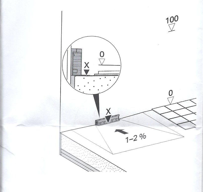

So, to continue I need to finish the floor which means laying the wet room corner to falls. At the moment, as above I've left a bfo piece out of the slab NOMINALLY the right size!
Roughly this is how the floor falls to the wall drain:
So it needs to fall from "0" to "X". The width at "X" (of the bit with the little inverted triangles on) is 410mm.

@Nickfromwales, sorry to hassle you on a Saturday. What do you reckon on concrete fall %age wise over about 1.3m for this wet room corner? The Geberit instructions say 1 to 2%. Equates to say 1/2" to 1" max. Thinking the lower as it might be less noticeable when you walk around the corner of the bath.

A 1500mm Impey has less than 20mm iirc. Any fall will suffice TBH as long as the drain is capable of 150% of the shower head max flow rate. You'll have that with ease as it's a linear slot.
Thank you as always. Less fall is better as it'll also give me a bit thicker slab.
