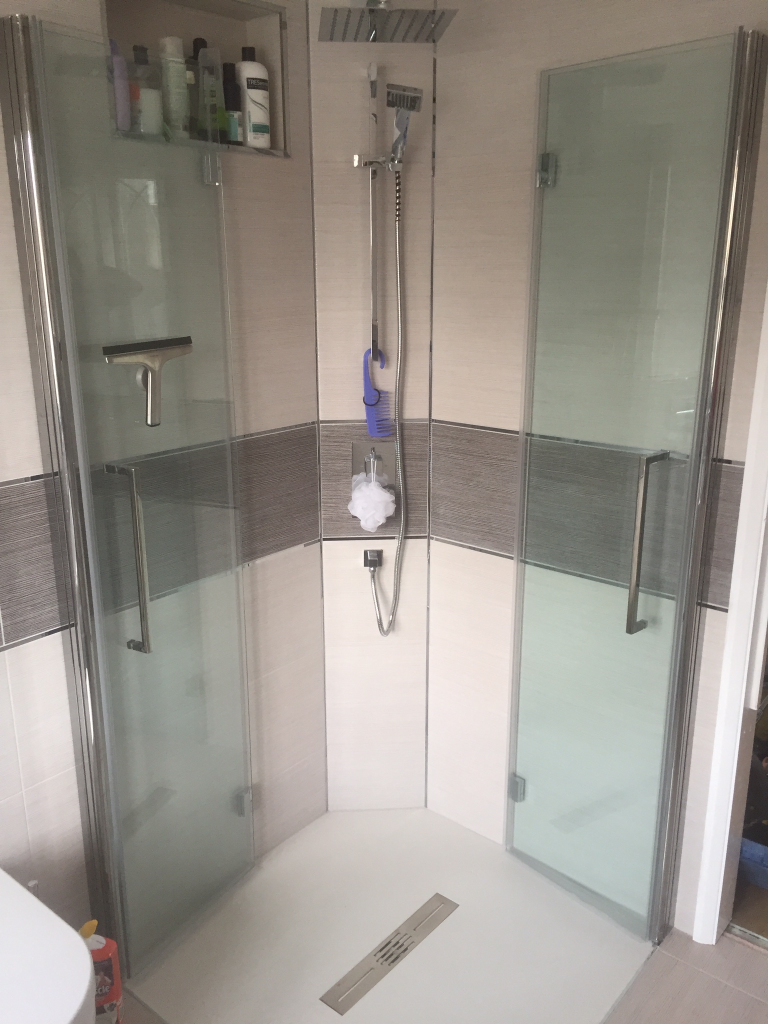

I have followed @Nickfromwales advice and bought one of these:
Complicated is good, keeps the brain ticking over! As for the mitred corner, it was Nick who posted one he's done and it looks cool...plus the wife is keen. A big dose too of could I as opposed to should I! :)
1 hour ago, JSHarris said:
Mitreing the corner reduces a geometric thermal bridge?
That corner is bloody cold as it's where the 4" soil comes in through the wall. Can't see that packing it with a bit more insulation can hurt!

Pretty much what I'm aiming at. You now have me thinking whether it would be better to have the pocket off to one side and the slider rail on the mitre like you have. Much card to be guillotined before I decide!

I would not have a shelf in direct waterfall / constantly splashed over TBH. That's a water trap and you'd struggle to stop water getting under the tile. If I was doing that for an insistent customer ( :ph34r: ) I'd put a solid sill ( cill ? how DO you spell that ? ) like granite / Corian sobit can be sealed back to the vertical faces and it could be angled slightly 'downhill' so the water didn't sit there.

I don't know if the missus will go for it but I have, salvaged from our first house a +1" thick marble kitchen slab. That might work for sentimental reasons  if I were to get a triangular piece water jet cut out of it?
When those doors in your picture opened up did they "join" together as in a magnetic strip etc to form an enclosure?
Yup. 'Twas a narrow room so the idea was a completely fold away shower so they could cut a straight line to the peepee machine and have a bit of room when using the sink.
I desgned it from scratch and it worked out great, other than when Novellini gave me the wrong sized shower glasses and tried to blame me. I nearly knocked the Rep out when he came to site 3 weeks later with an unusable shower. What a condescending prick he was. I actually said that I'd like him to get out of the bathroom so when he hit something on the way down it wouldn't be expensive.
Tossa. ?
I'm betting those Novellini doors weren't cheap? Going to try without first. If it's impractical then I'll attach glass wings or doors up the mosaic line as I've studs there.
This is the current manisfestation! 1 tile width for the mitre then 2 either side. Just need to widen (move?) the mosaic strip:
IMHO it looks odd. I think it would look better if the shower were mounted on the mitred corner as in Nick's picture. Could just be that I like everything symmetrical though.
But Nick's single shelf to the left and drain alignment messes up the symmetry imo!
I'll have another think...mount the slider rail on the mitre and have a pocket either side. Only issue there is limited depth for the pocket on the right.
