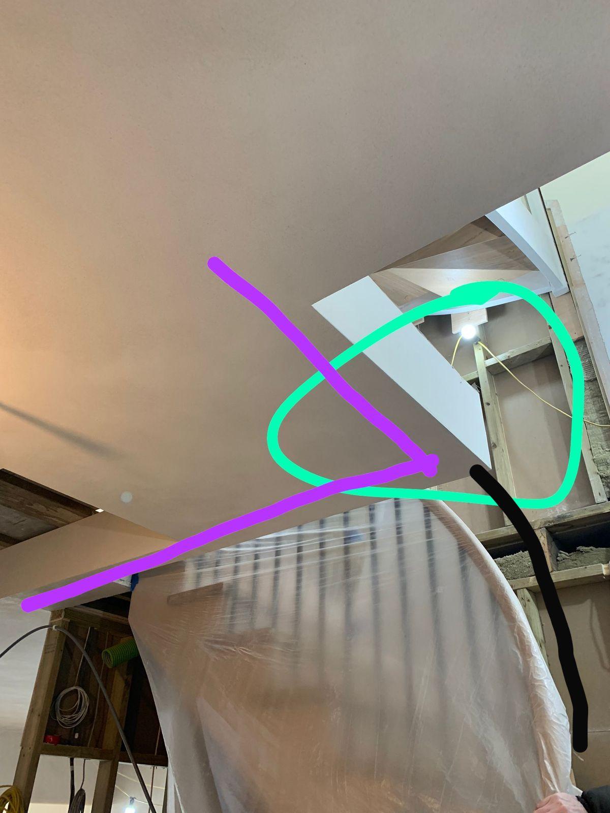

Adsibob Posted March 12, 2022 Author Share Posted March 12, 2022 (edited) 31 minutes ago, ProDave said: Trusting an external render to actually be waterproof and stay stuck to the wall. So now I have told you mine, you tell us yours. Why tell, when a picture says 1000 words: Spent a fortune on a beautiful oak staircase, with a lovely swooping bannister. Except that this corner of the floor (which is completely unnecessary as there is nothing above it) is obstructing a big chunk of it. There is no breach of regs, as plenty of head height above the stairs, just bloody ugly. not so straightforward to round off this corner because there are steels where the purple lines are. The steels are to support an internal skylight, part of the hole for which can be seen to the left of the picture. Here is the structural drawing (the junction between steels 10 and 11) is the ugly corner: Both steels in question are 150 x 90 PFC. Wondering if they can be cut shorter and the shortened ends joined by a diagonal steel. Obviously need to consult with an SE, but it’s a Saturday night and I’m pissed off! Edited March 12, 2022 by Adsibob Link to comment Share on other sites More sharing options...

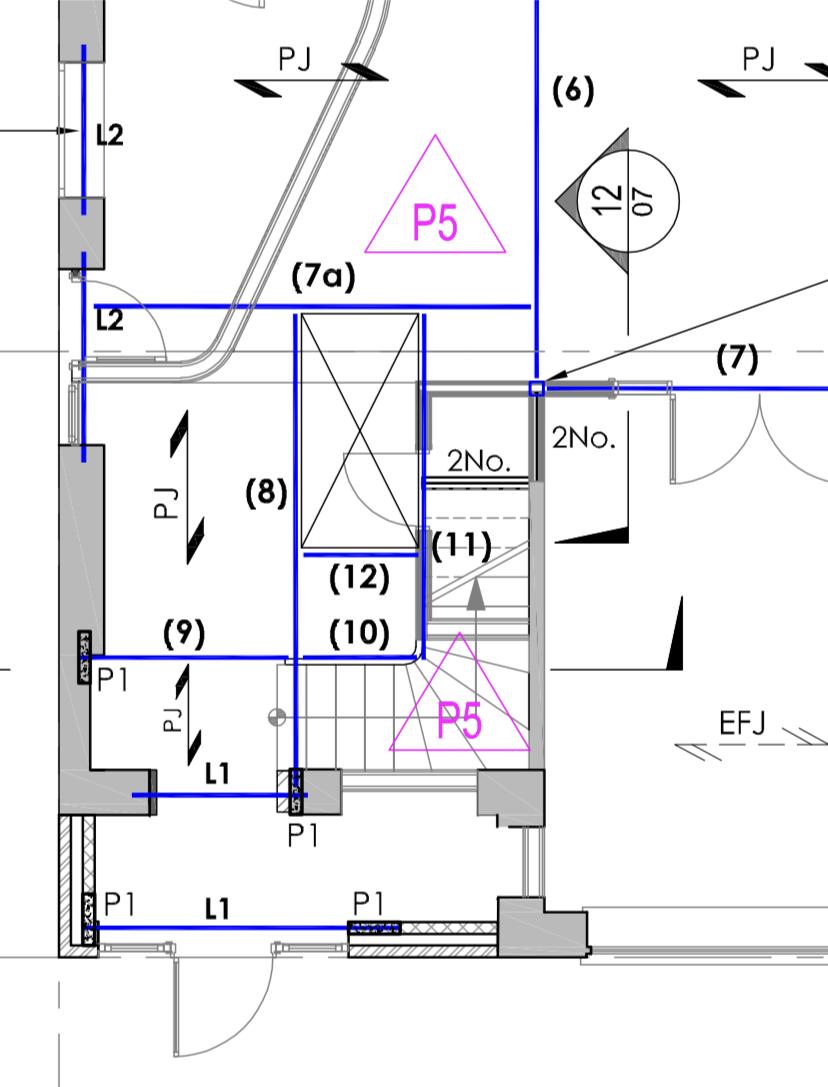

joth Posted March 13, 2022 Share Posted March 13, 2022 10 hours ago, Adsibob said: Both steels in question are 150 x 90 PFC. Wondering if they can be cut shorter and the shortened ends joined by a diagonal steel. Does it even need a diagonal steel? If it's just a floating cantilever of boxed in ceiling, the cross member could probably be timber? What is steel (10) actually supporting? From your description it sounds spurious Anyway commiserations for that. Our worst mess up was putting too much boxing in around the downstairs WC sink and by the time I realized it felt too late (tacking done but not yet decorated) so we decided to swap it to a tiny hand basin which looks ridiculous under the giant lit mirror we planned to go over it. I now look back and think should have just fixed it when I had the chance. Link to comment Share on other sites More sharing options...

ProDave Posted March 13, 2022 Share Posted March 13, 2022 @Adsibob what is your actual issue here? Just that the ceiling corner is square but the stairs are rounded as they turn the bend so it overlaps a little? I take it the "skylight" is walk on glazing? 1 Link to comment Share on other sites More sharing options...
Adsibob Posted March 13, 2022 Author Share Posted March 13, 2022 39 minutes ago, joth said: Does it even need a diagonal steel? If it's just a floating cantilever of boxed in ceiling, the cross member could probably be timber? What is steel (10) actually supporting? From your description it sounds spurious As far as I can see, all steel 10 is doing is connecting 9 to 11. Two thirds of 11 is holding up the sky light, but I’m not sure Why steel 11 needs to project beyond where it connects with 12. Maybe @Gus Potter has some views on this. Just now, ProDave said: @Adsibob what is your actual issue here? Just that the ceiling corner is square but the stairs are rounded as they turn the bend so it overlaps a little? The issue is purely an aesthetic one. The staircase would look much better with a bit of space around it. If we got rid of that redundant corner, it would show off the staircase more, and let it “breathe” a bit more (visually). Difficult to explain, it just looks wrong having the beautiful sweeping bannister almost touch this very angular corner. If it was cut along the diagonal, we could then build out the diagonal into a curve. Even if it’s just a 250mm or 300mm radius curve it would look so much better. Link to comment Share on other sites More sharing options...

Mr Punter Posted March 13, 2022 Share Posted March 13, 2022 Funny that the staircase person did not pick it up. It looks doable to rectify, but a bit messy as it looks like you can remove no. 10 and trim back no. 11. Take your medicine now though. Link to comment Share on other sites More sharing options...
Adsibob Posted March 13, 2022 Author Share Posted March 13, 2022 1 minute ago, Mr Punter said: Funny that the staircase person did not pick it up. It looks doable to rectify, but a bit messy as it looks like you can remove no. 10 and trim back no. 11. Take your medicine now though. Yeah, bloody ridiculous that. But what I don’t get is why the SE specified 10 in the first place. If it can be removed, what’s its point? I fear that when we consult the SE on Monday, he will say we can’t just remove it. Link to comment Share on other sites More sharing options...
Radian Posted March 13, 2022 Share Posted March 13, 2022 I would look into getting a length of 150 x 90 PFC cut/rolled/shut into a 1/4 ring beam to link 9 to 11/12 junction. 1 Link to comment Share on other sites More sharing options...

Adsibob Posted March 13, 2022 Author Share Posted March 13, 2022 26 minutes ago, TonyT said: Why would the staircase person highlight something that he didn’t do had no input in? he’s there to fit the staircase as it was designed not offer design opinions? Well annoyingly, it was the staircase designer that pointed this out AFTER the staircase had been installed. 1 Link to comment Share on other sites More sharing options...
SteamyTea Posted March 13, 2022 Share Posted March 13, 2022 Bit of a left field idea, can you dazzle camouflage it? Link to comment Share on other sites More sharing options...
Adsibob Posted March 13, 2022 Author Share Posted March 13, 2022 8 minutes ago, SteamyTea said: Bit of a left field idea, can you dazzle camouflage it? hmmm. not sure that would work. I think the options are to clad the projecting corner in an oak veneer to match the staircase or leave it as it is or ask the SE whether we can reduce it. Assuming it can be reduced by shortening steels 10 and 11 and then joining them together with a 1/4 ring beam to link 9 to 11/12 junction as suggested by @Radian, anyone have any idea what it would cost to remove the plasterboard around this 85cm by 85cm corner, cut the steels, connect in the the ring beam and patch it up again? Link to comment Share on other sites More sharing options...
