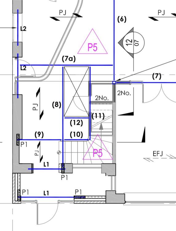

    Hi all.   I can't quite see where all the supports are to the steelwork but there are plenty things that could be going on here and the SE looks like they have spent some time thinking this

On 14/03/2022 at 00:53, Gus Potter said:
Hiya.
Yes I think your SE has put a bit of thought into it.
Can it be changed?  On the face of it you would move beam 9 to line up with beam 12 and that would open up the stair well. But the load from beams 9 & 10 would move from roughly the 1/3 point of beam 8 to its mid span so the bending forces not least in beam 8 may increase, I'm not sure though how much they may increase if that much as you will have to support less floor area. I can't give you a definitive answer as I don't have all the info.. but ask your SE the question as it may be simple to change. They may be a bit peeved as I think they will have put a good bit of effort into this.. so you may need to part with some cash.
But if you don't need the floor space the extra light may offset any aditional SE fee. But perversly if you are going to sell the house on the every sq metre of floor could count.
So SE has said it will take him 7-9 hours to design a change and wants to charge me his hourly rate. Seems excessive to me. Can a design change really take that long?
Surprisingly yes. Once you change the loads and the stiffness / positions of the beams framing in then you need to review the whole thing. If you move the steel supports you need to go back and check the bearings and so on. It can be quite involved. Then sometimes you need to redraw a lot of it, change the detailed specification and so on. Before you know it the clock runs up.
@saveasteadingmakes good points.. good flavour of how things add up.
I think your SE is probably doing you a favour here. In the grand scheme of things if you want to open it up more then pay the SE and enjoy the result. If you like the open feel then others will often too. When you come to sell you'll get your money back anyway?
