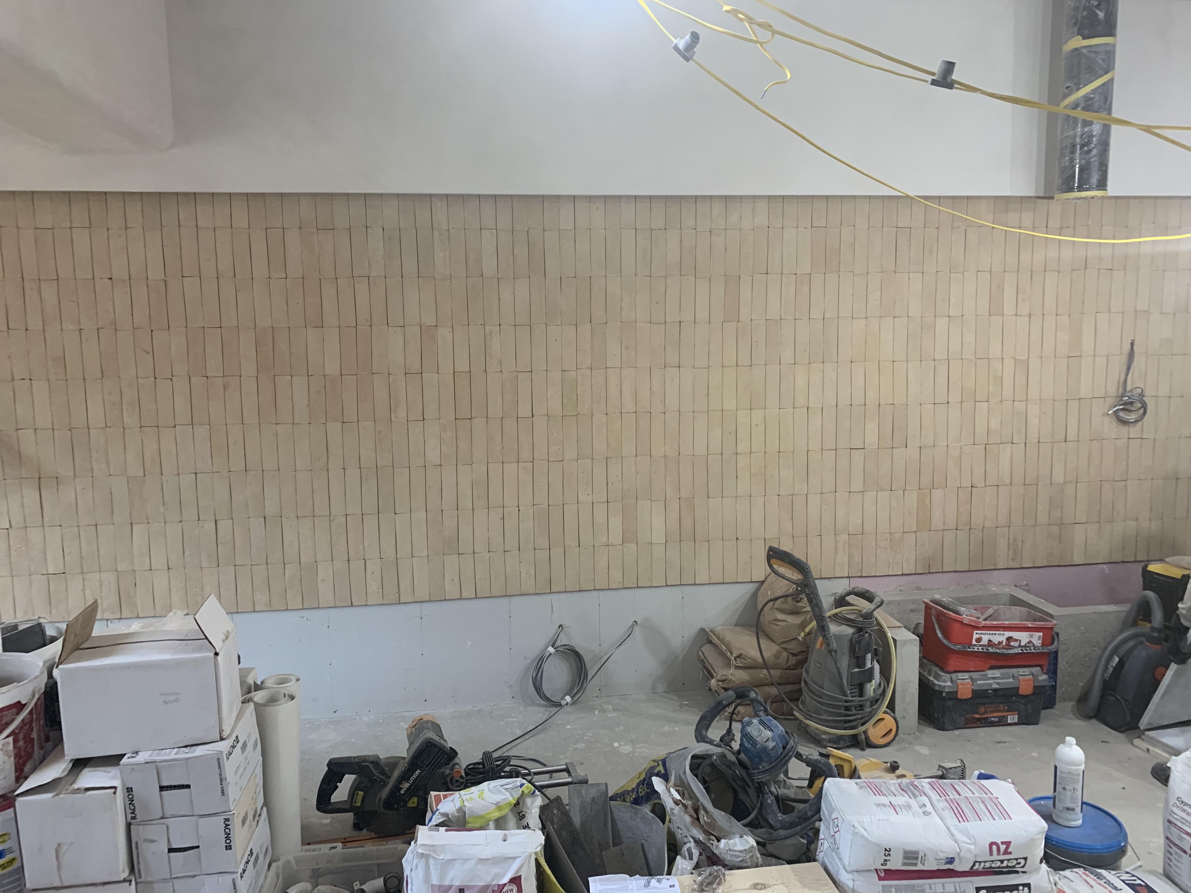

nod Posted February 14, 2022 Share Posted February 14, 2022 (edited) 21 minutes ago, Adsibob said: We are using decorative clay plaster. It isn't painted, just left nude after a bit of polishing with a water atomiser and a cloth. So although it's more expensive than normal plaster, it saves a lot of money in not needing any painting. It is only meant to be applied 1mm to 1.5mm thick, directly onto plasterboard. My architect thinks we could plaster over the tiles but we would still get see the outline of each tile and the shape of the tile's surface (which is not smooth at all as these are unglazed zellige which are all wonky; each one is completely different to the other in terms of shape and overall dimension - part of their "rustic" charm). We do quite a bit of clay works and Venetian The surface needs to be perfect before applying the primer We normally tape and joint PB Or skim prior to priming I take the tiles off and make good Edited February 14, 2022 by nod Link to comment Share on other sites More sharing options...

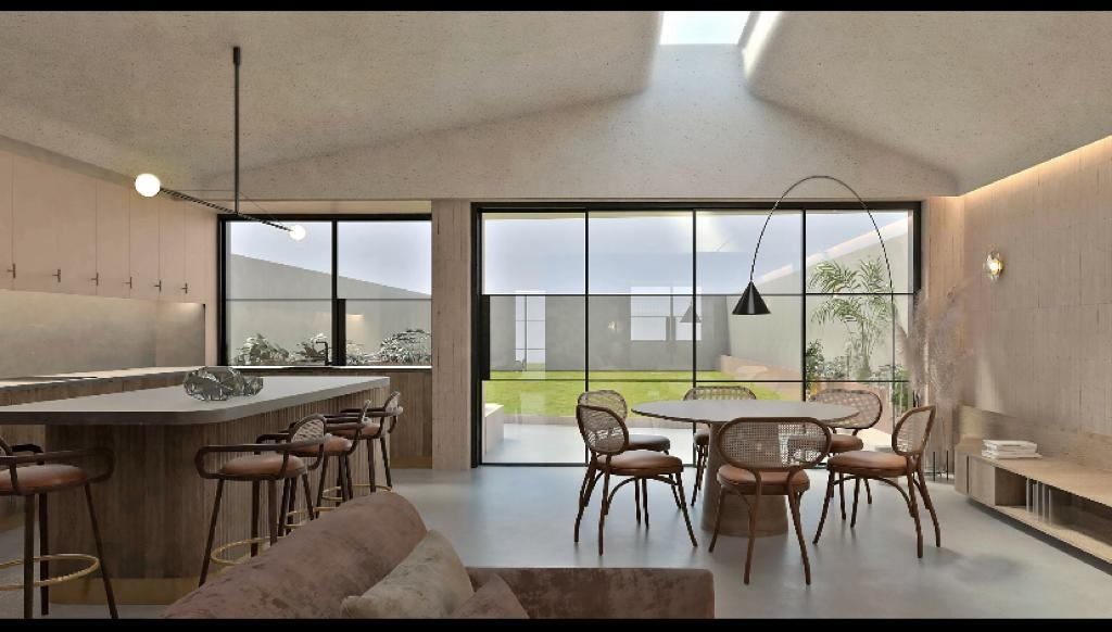

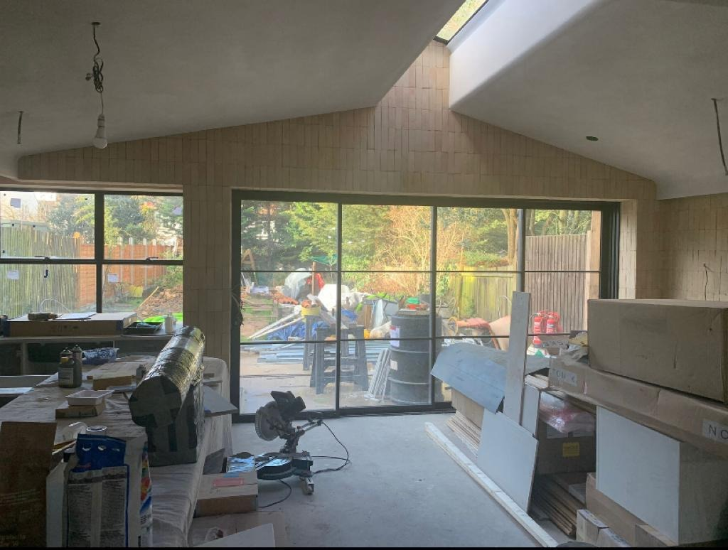

ProDave Posted February 14, 2022 Share Posted February 14, 2022 1 hour ago, Adsibob said: In the render there is no tile above the sliding doors (that triangle shaped gable bit of wall). That is decorative plaster as is the sloped ceiling either side of the skylight. In reality we took the tile up to the skylight on that wall. So quite dramatically different I guess. It's a rustic clay tile made in morocco and has come out a little more rustic than we were expecting, so she is annoyed there is more of it than we had originally planned. Right, that level of change to me is weeeeeeeell outside the scope of the architect and is in the realms of "interior decoration" that you choose once the building is up and you get a real feeling for the space and how you want to dress it. That would never register for me as a major change and just assumed that is what you both chose to do with the space. Clearly it is what YOU chose to do with the space without discussion? 1 Link to comment Share on other sites More sharing options...
Cpd Posted February 14, 2022 Share Posted February 14, 2022 I prefer the render version….. the rustic look is very different and I can see why it’s causing conflict. Personally I would cut your losses and remove and redo it and agree never to talk about it again…… 1 Link to comment Share on other sites More sharing options...

JamesP Posted February 14, 2022 Share Posted February 14, 2022 I do prefer the render version especially where the pillars are set back in the gable end and It flows better back into the ceiling. The tiles seem to pull the room back in towards you. Stunning when complete. On Valentines day as well. Get on eBay quick.. 1 Link to comment Share on other sites More sharing options...
Shire2020 Posted February 14, 2022 Share Posted February 14, 2022 Got to say… I prefer the tile! Build looks great btw Link to comment Share on other sites More sharing options...
SimonD Posted February 14, 2022 Share Posted February 14, 2022 4 hours ago, Adsibob said: there are no curtains. Let me give some more details for context: Version in digital render: What we did (without consulting SWMBO): I've got to say I'm with SWMBO, the rendered look is better. Maybe now SWMBO will make that long overdue decision about your architect and show him the door, he does like causing you problems, doesn't he? 1 Link to comment Share on other sites More sharing options...
LaCurandera Posted February 15, 2022 Share Posted February 15, 2022 Render looks better to me, sorry. Link to comment Share on other sites More sharing options...
billt Posted February 15, 2022 Share Posted February 15, 2022 I initially preferred the render version, but on closer examination it seems as if the side walls on the render version have the same tiled finish as the reality, but it doesn't look like it. IOW the render is lighter than the reality which skews the effect rather a lot. the lighting effect is very different too. 1 Link to comment Share on other sites More sharing options...
