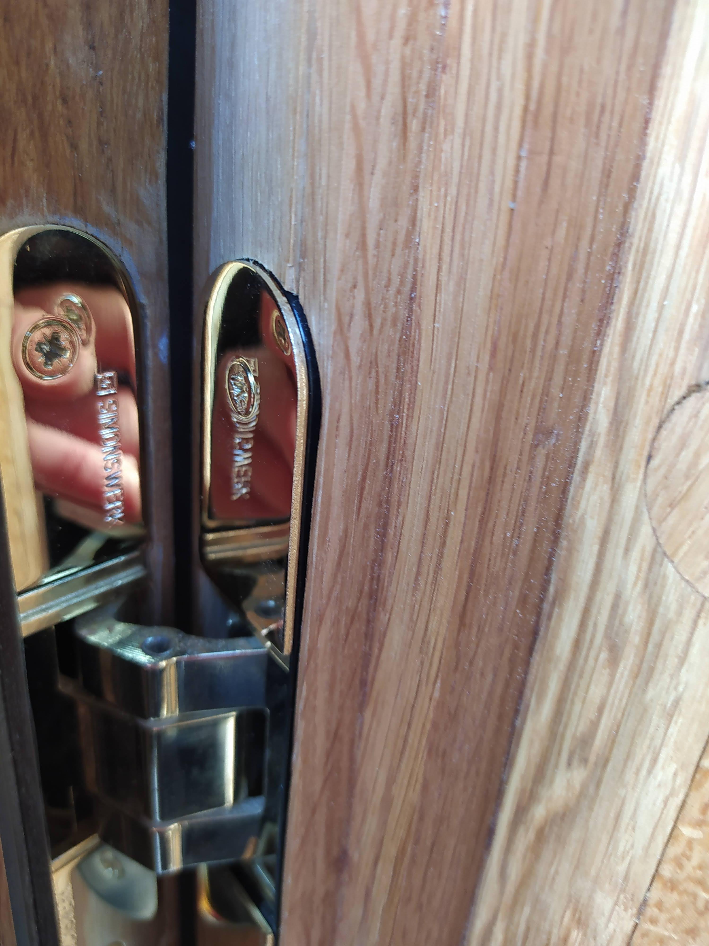

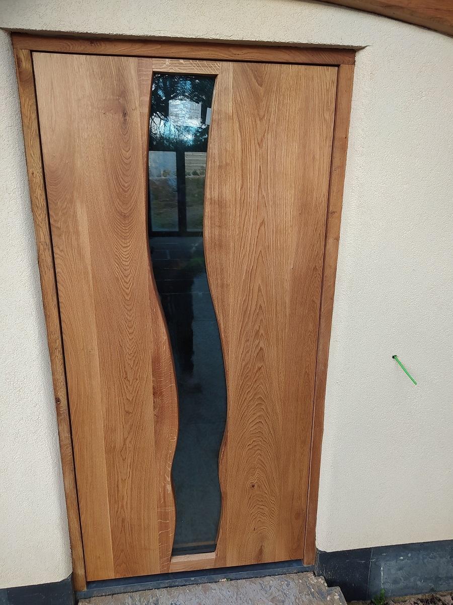

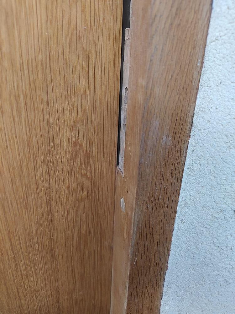

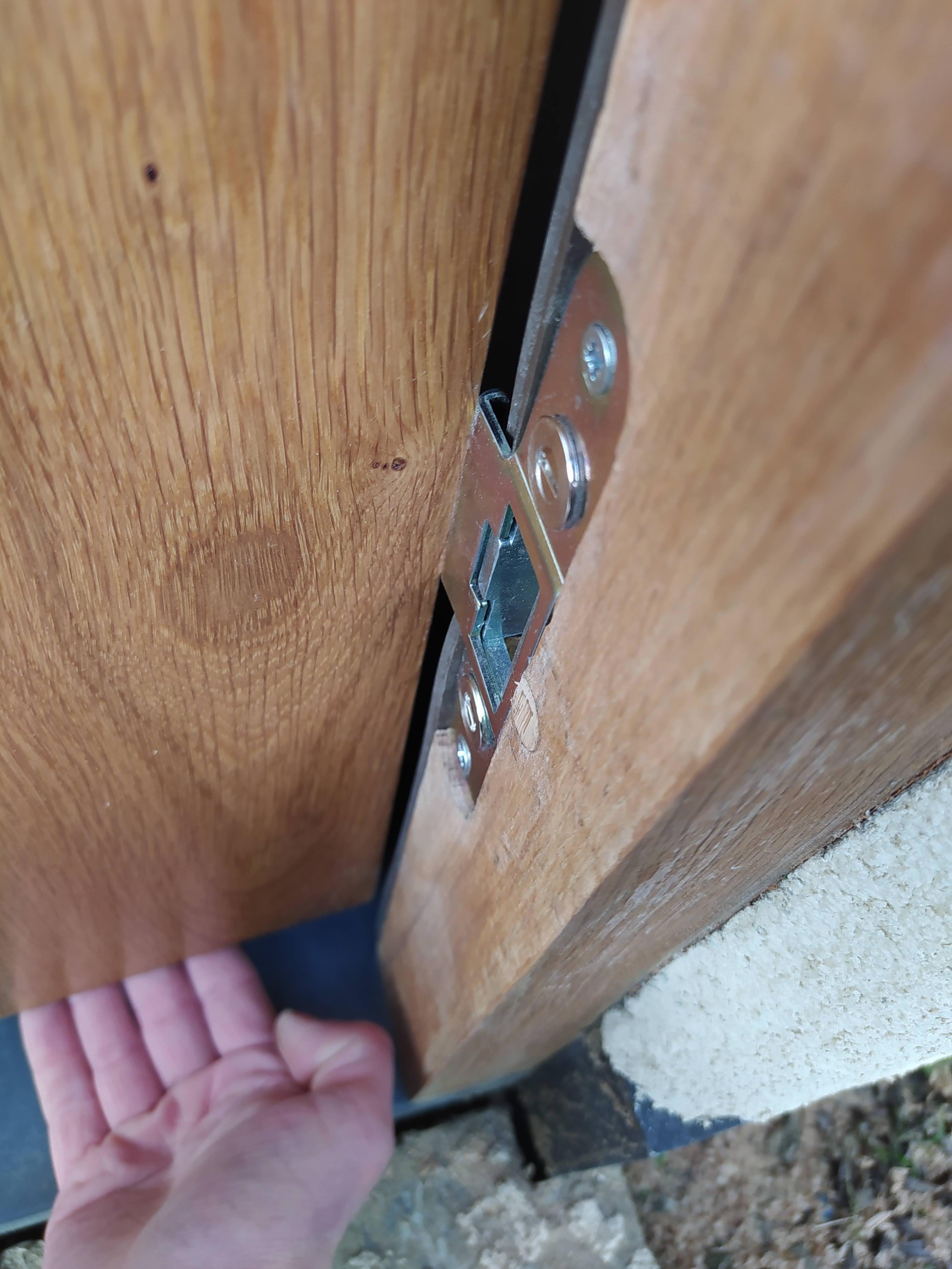

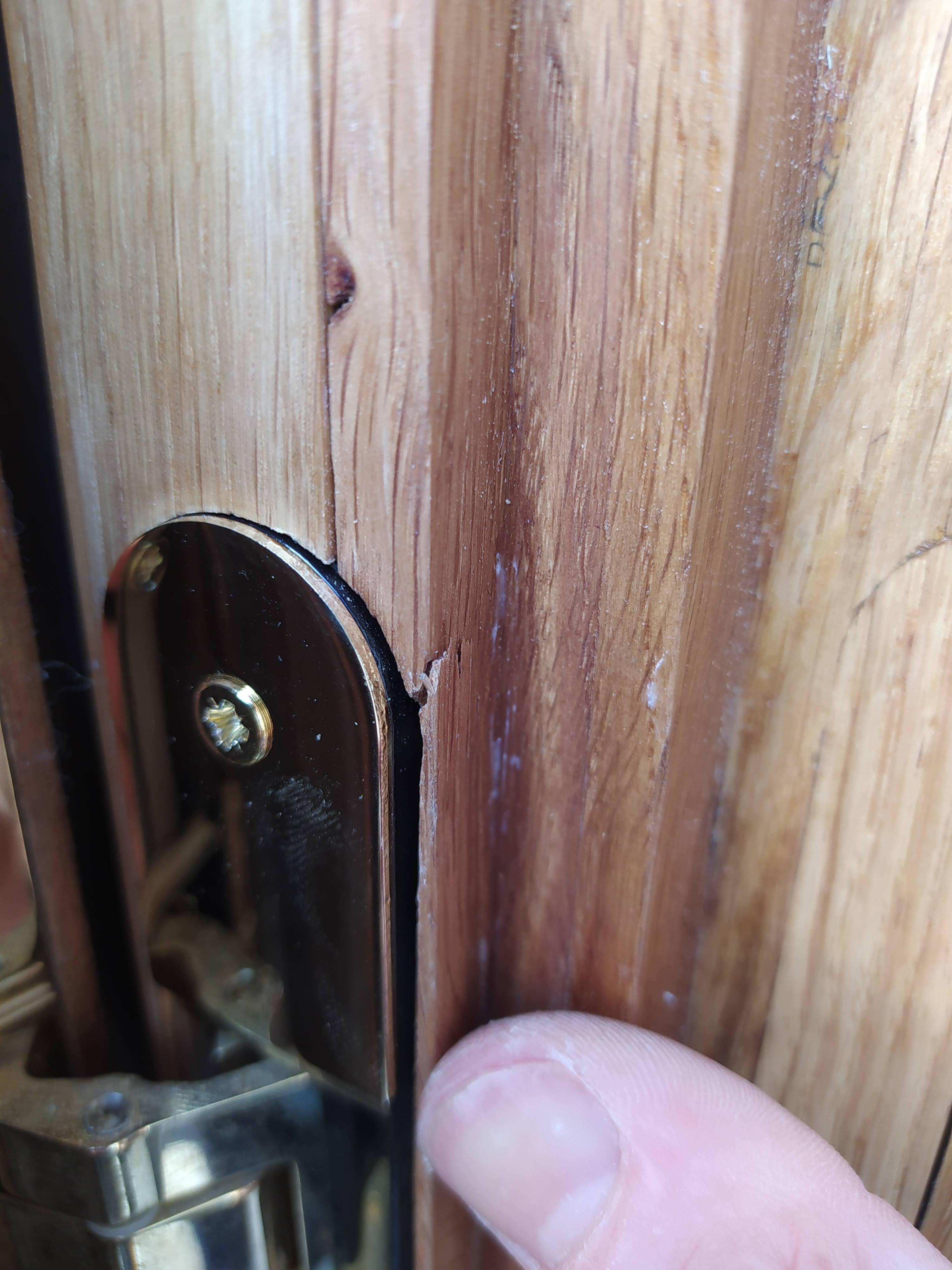

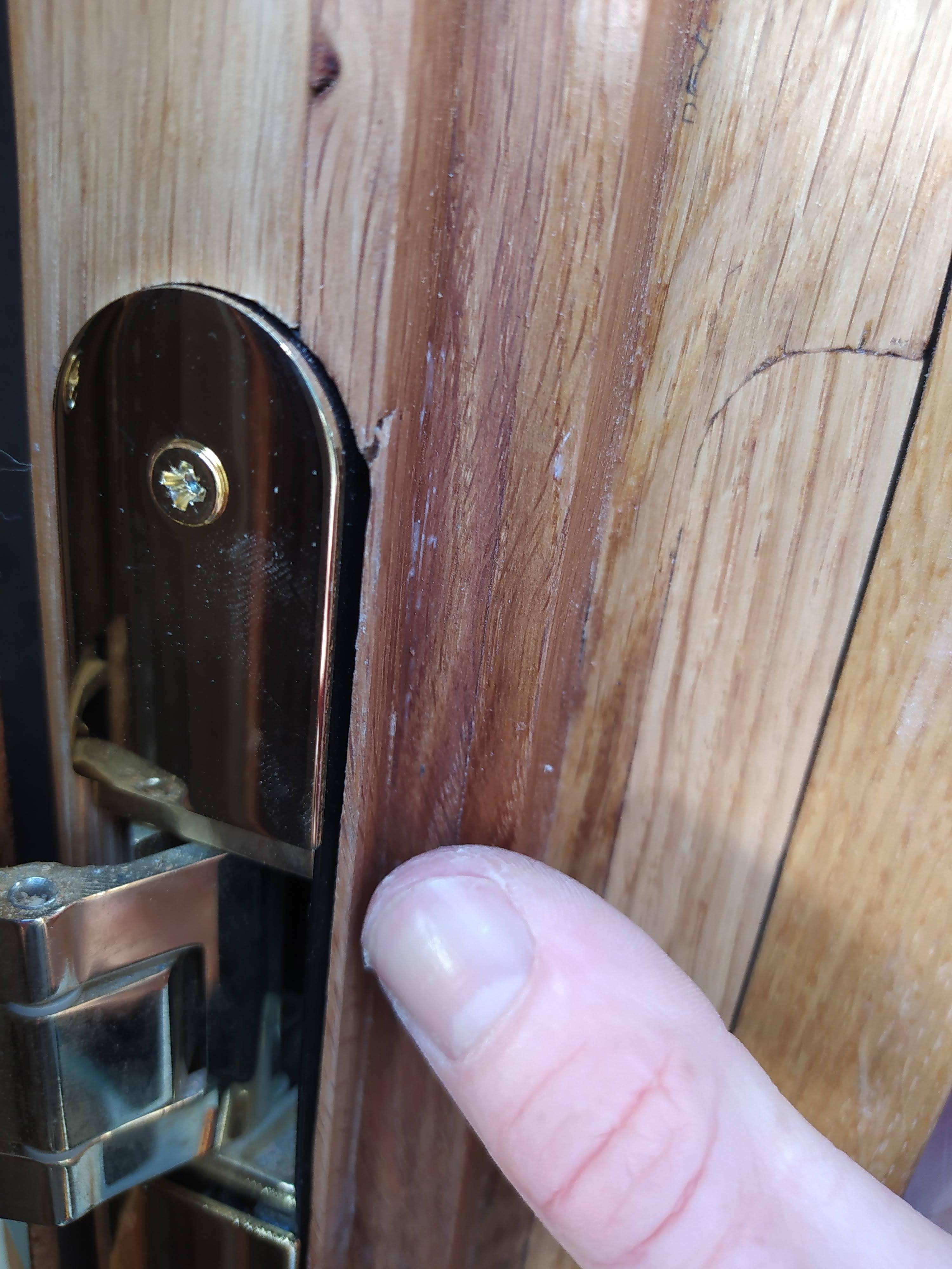

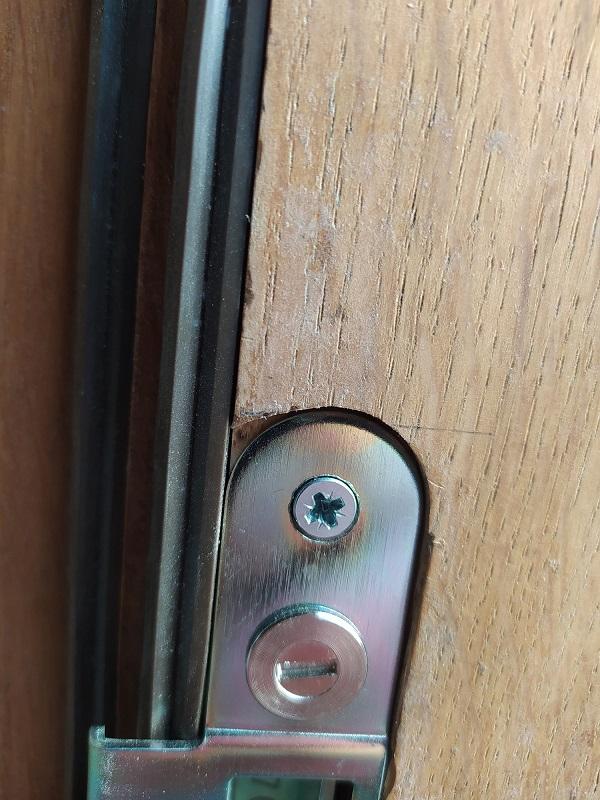

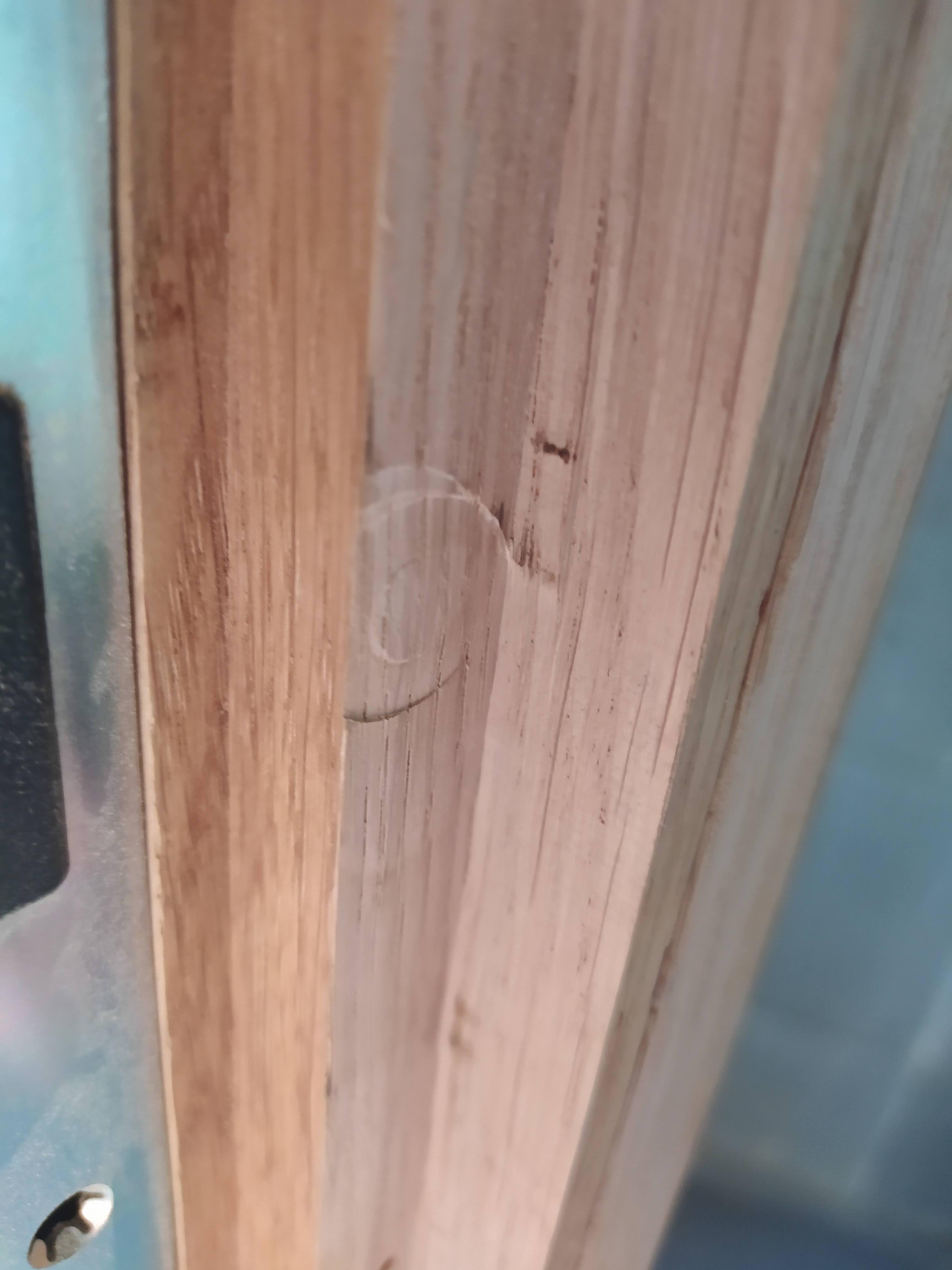

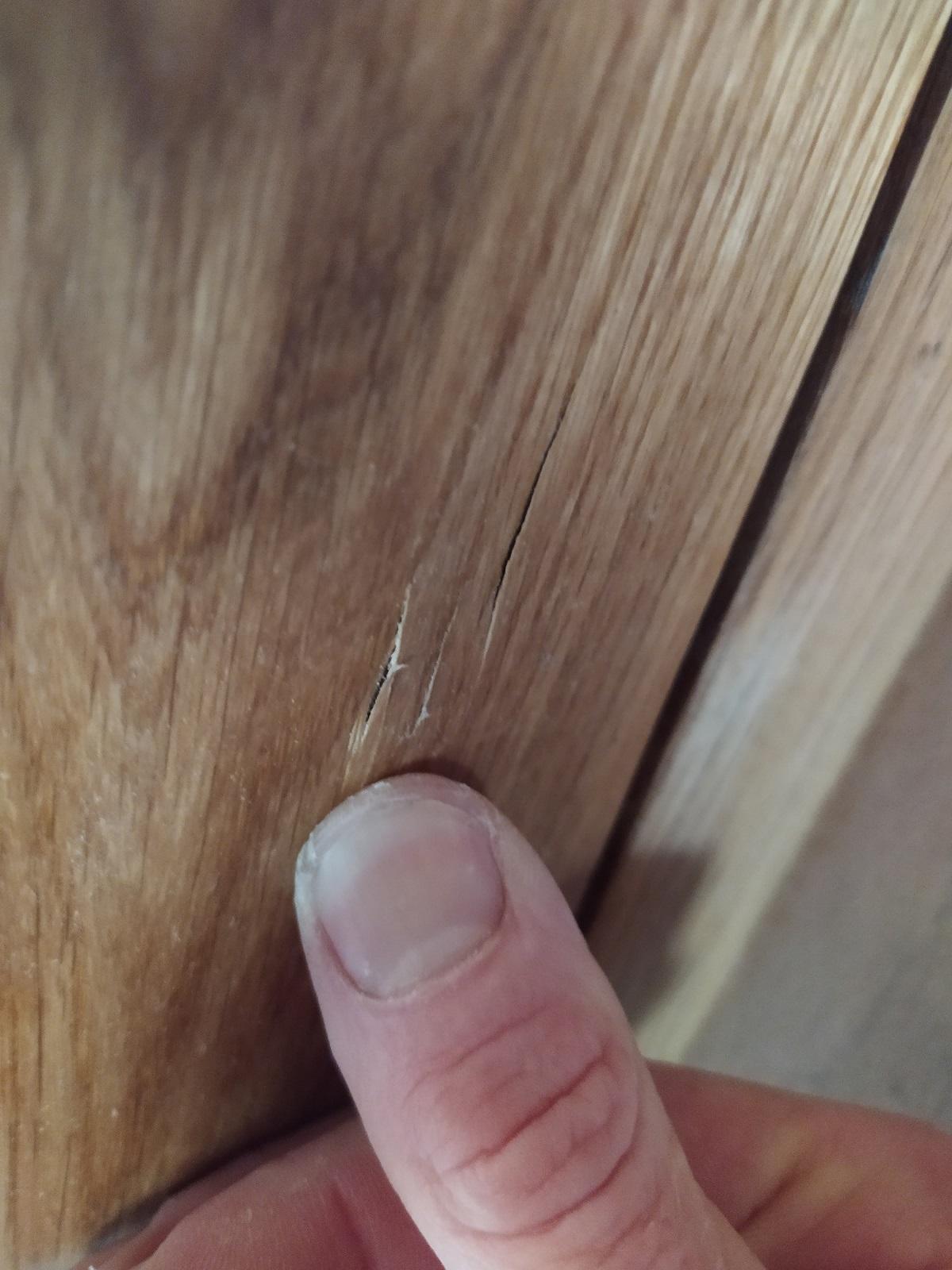

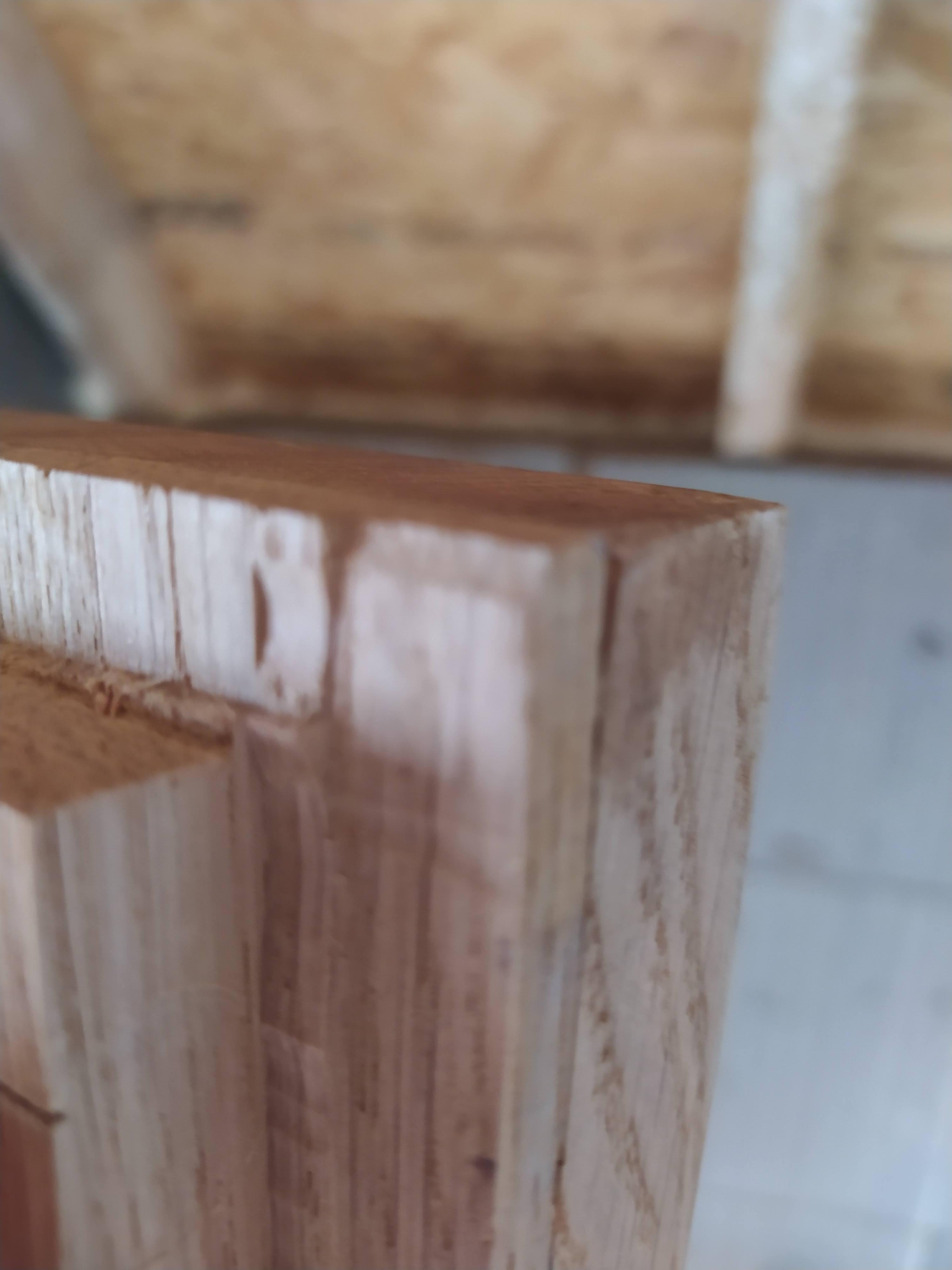

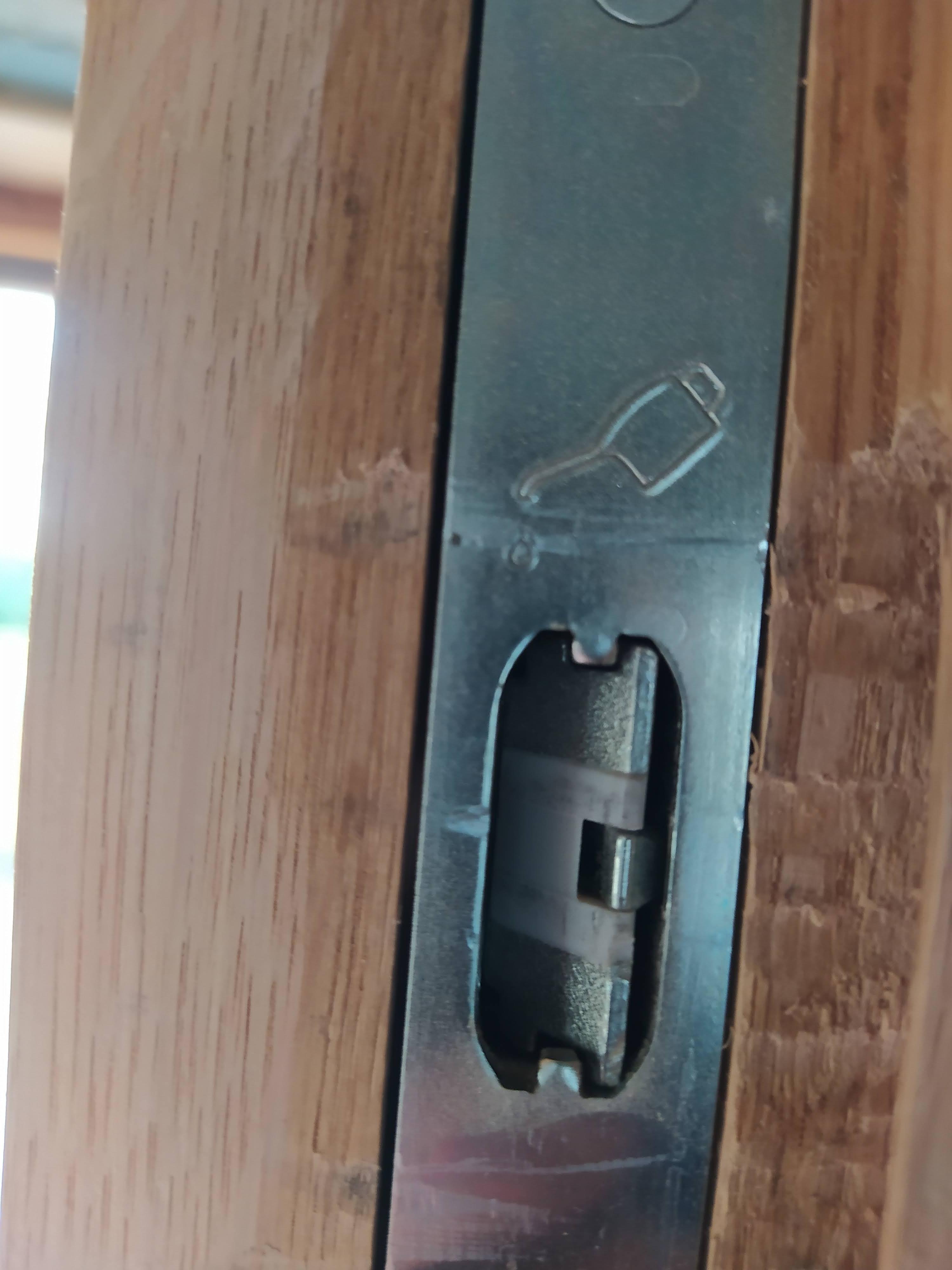

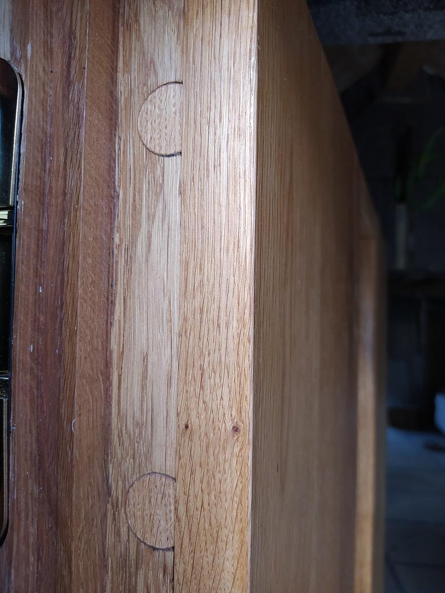

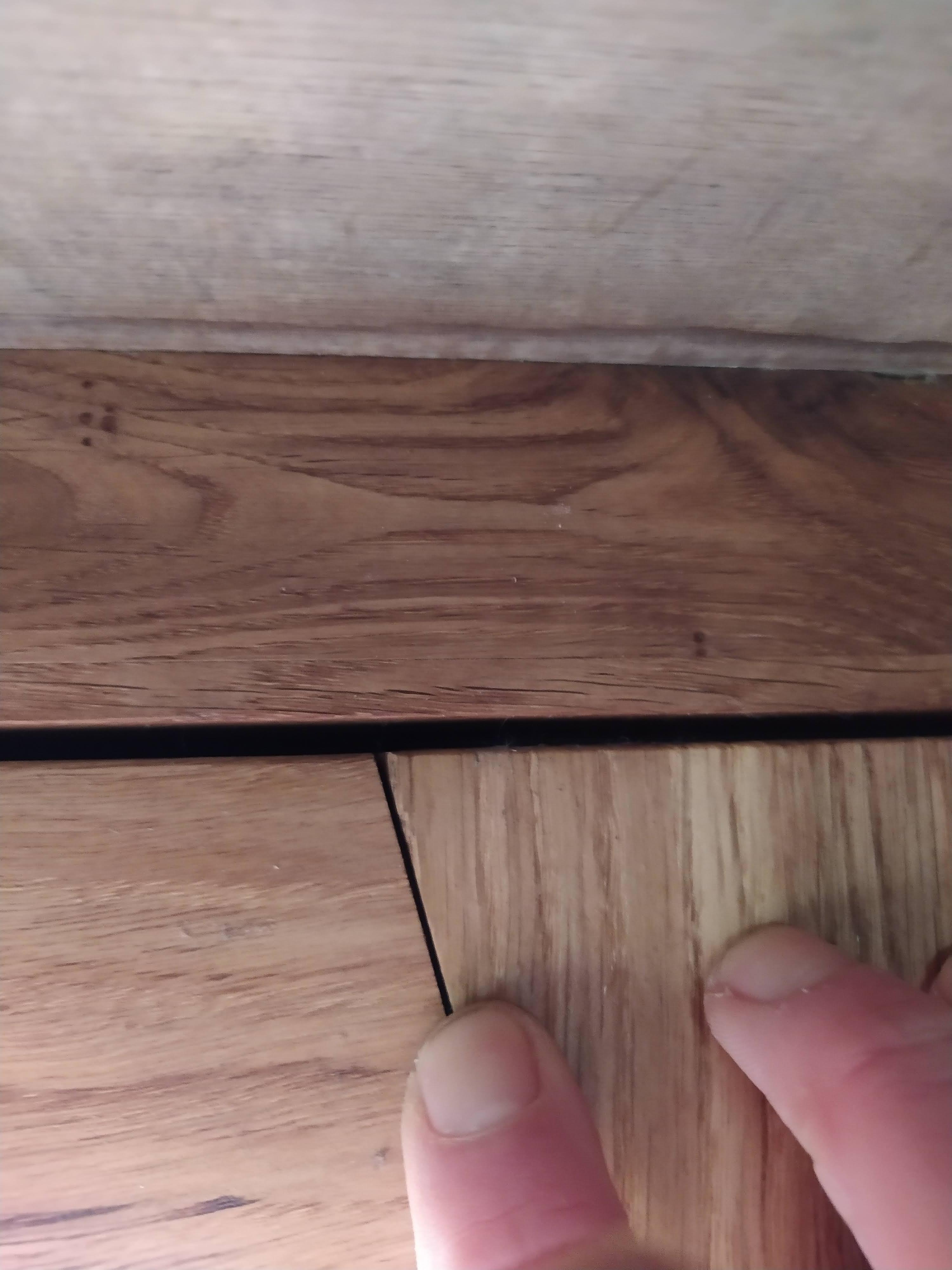

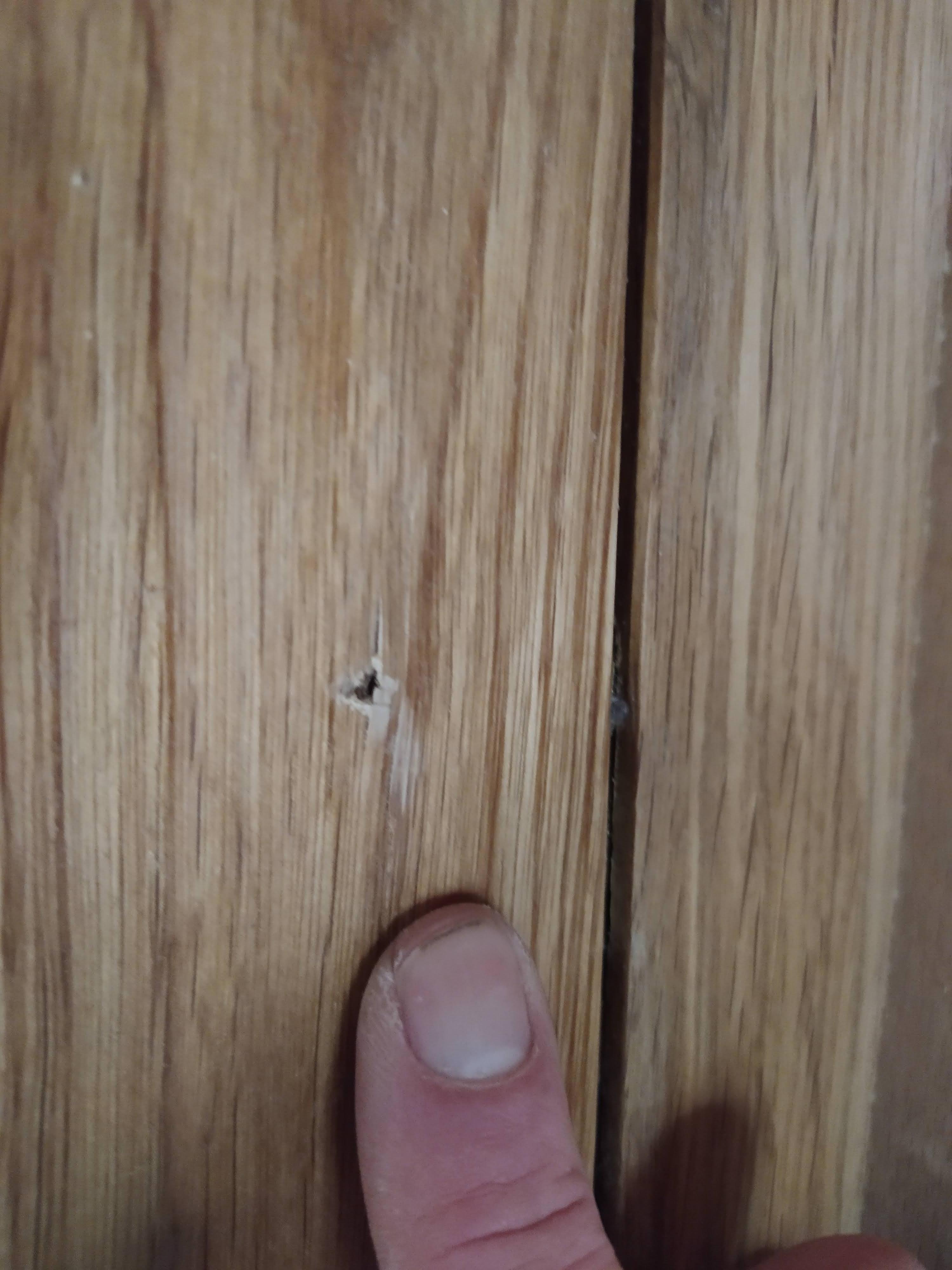

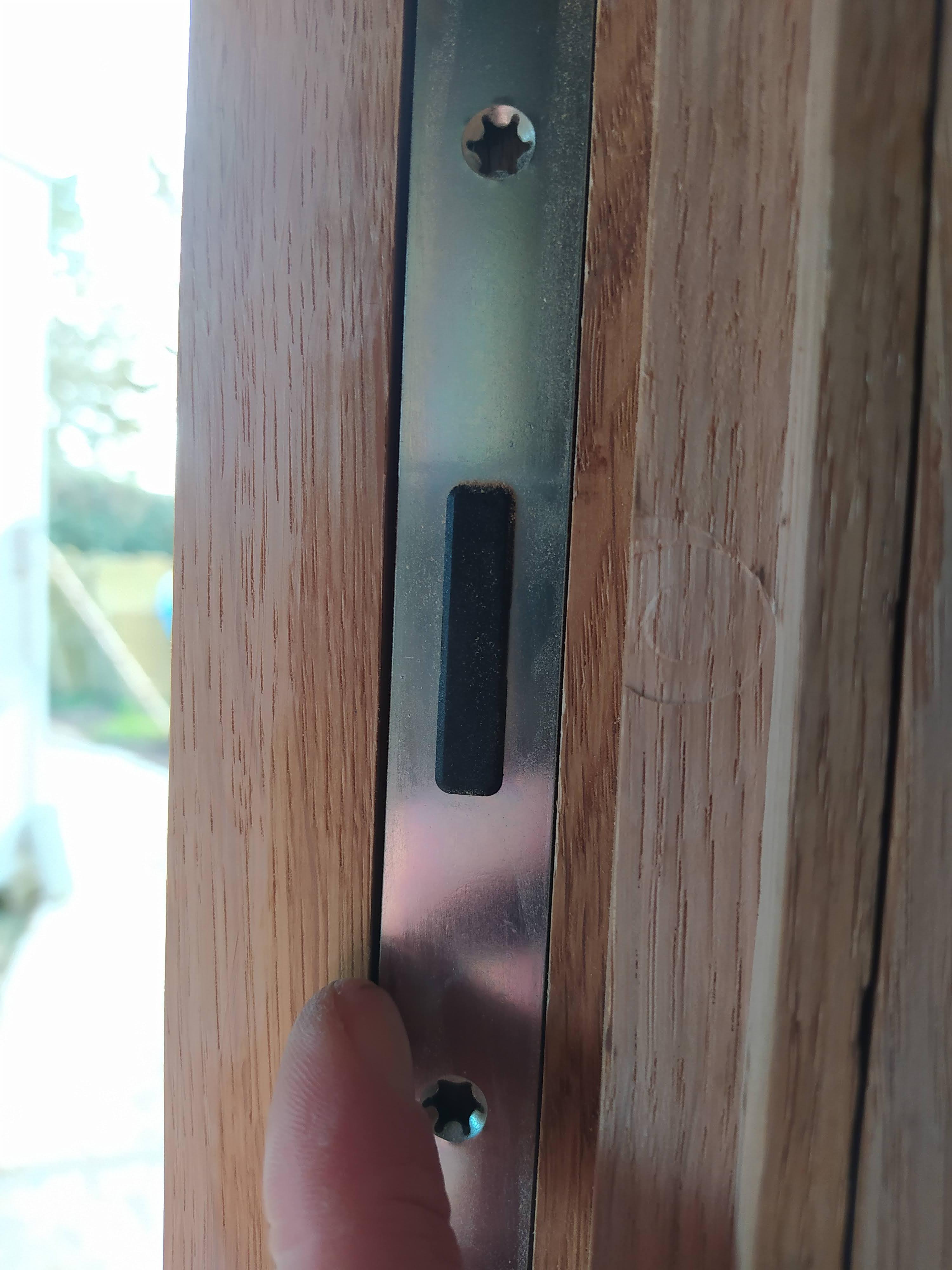

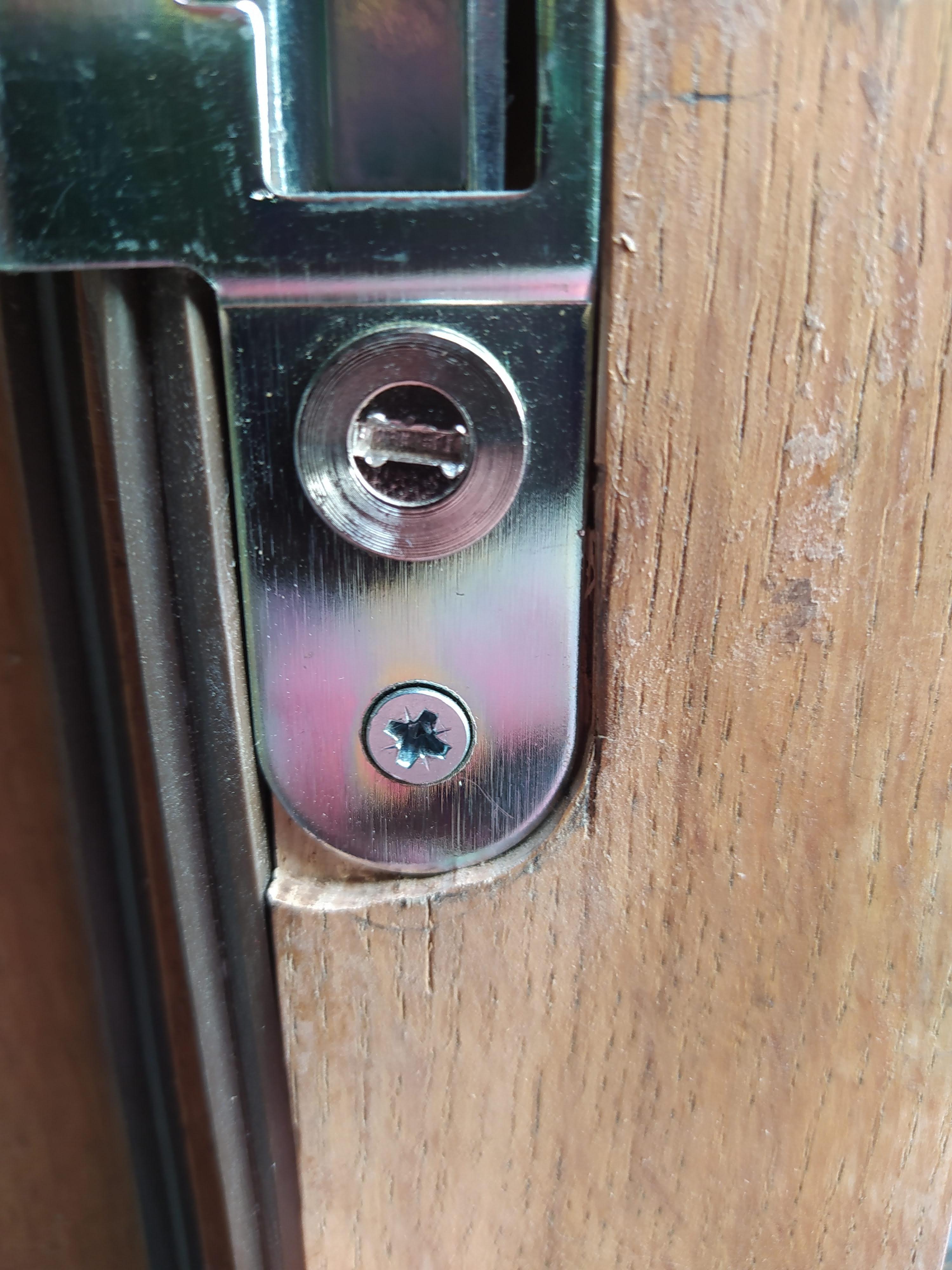

willbish Posted February 1, 2022 Posted February 1, 2022 Looking for some opinions please on how to find an amicable solution to the poor quality of this bespoke front door I have had made. I don't think there is any doubt that the joinery is below par. See pictures below. I'm unsure how best to move forward and find a resolution that works for both parties. I am tempted to reject the door and ask for a full refund. I don't think any repairs or bodges and able to bring the door up to an acceptable standard. I may be wrong. Maybe my standards are too high? I've paid 90% for the joinery and have received the invoice for the final 10% The issue with a full refund is three fold. -The frame has been fitted prior to rendering. Removing would require making good of the external render. Would the joiner be liable for this cost? Yes. Would I successfully get the money for it though? - If I received a full refund I would most likely commission another joiner to make a similar door. I haven't seen anything off the shelf (yet) that compares. Looking at 6months plus for design, manufacture & fitting - Move in date is approaching. A secure temporary door will be necessary. Time, cost and general buggery required. So I guess I need to decide whether incurring the above hassle is a better course of action than accepting and living with the defects. Essentially the door works as designed, just about, for now. But Im pretty sure I can argue that it doesn't meet 'reasonable expectations' 50mm Celotex sandwiched inside. Triple glazed sealed unit. Double rebate with continuous twin seals and electronic lock (untested). So here's the pictures of the poor joinery. I think as soon as the door moves even a millimetre it will not close, it is already touching the frame. The tolerances are too tight. What will it be like in a couple years. 1. Door hits lower keep. Simonswork Tectus 3D hinges are already adjusted as far as they can go. 2. Door touching frame as it closes. Keep with Ten-F function to be ordered 3. Something protruding through internal face. 4. Random screw hole on internal face 5. 2mm gap in joint 6. Spacer in sealed unit higher than timber 7. Random machine marks, of which there are many 8. B*stardisation of door to accept lip of keep 9. Machining damage to lock and door 10. Top of door, butchery 11. 2mm gap that moves when squeezed 12. More quality joinery at the bottom of the door 13. Mistakes plugged?

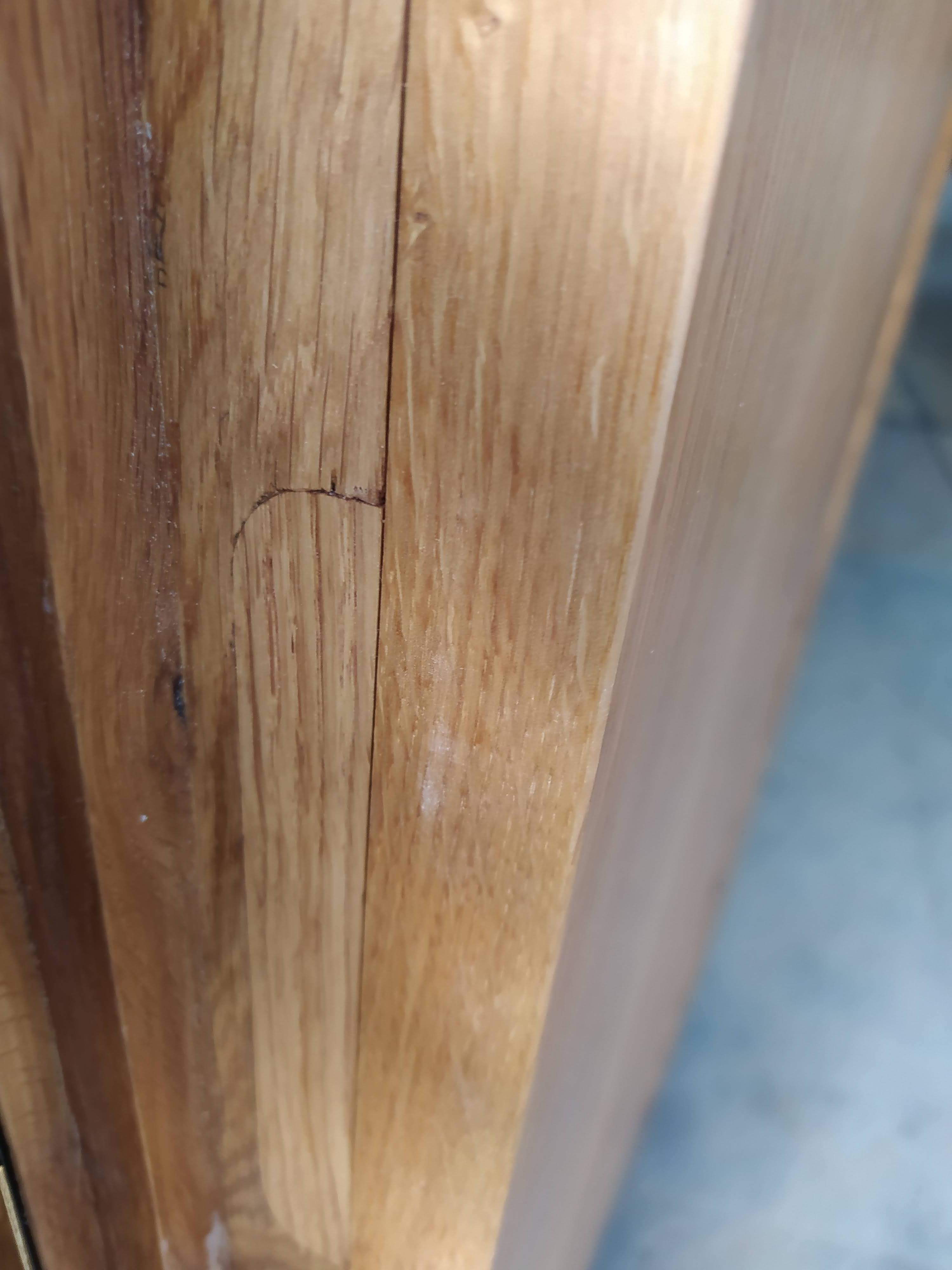

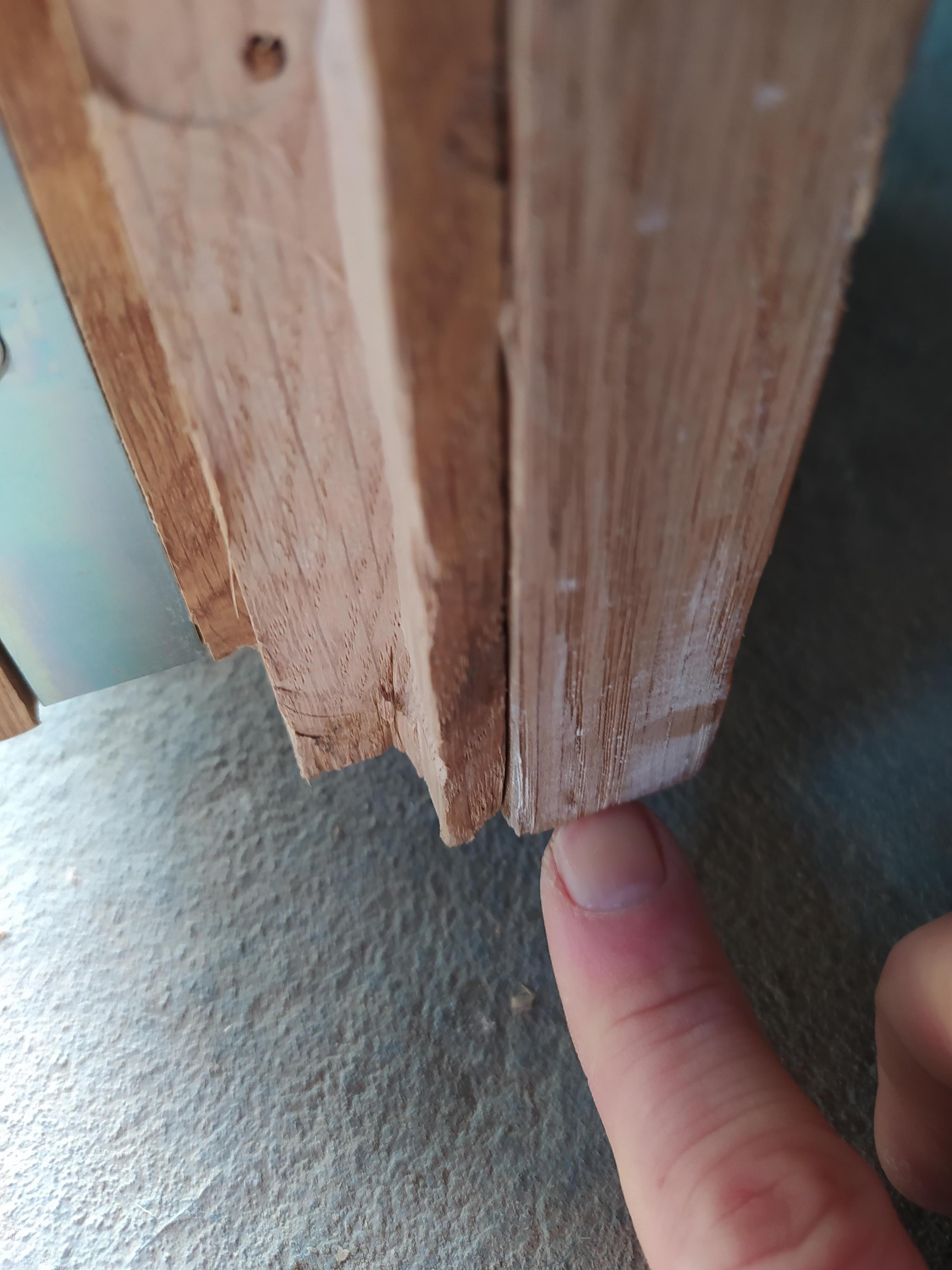

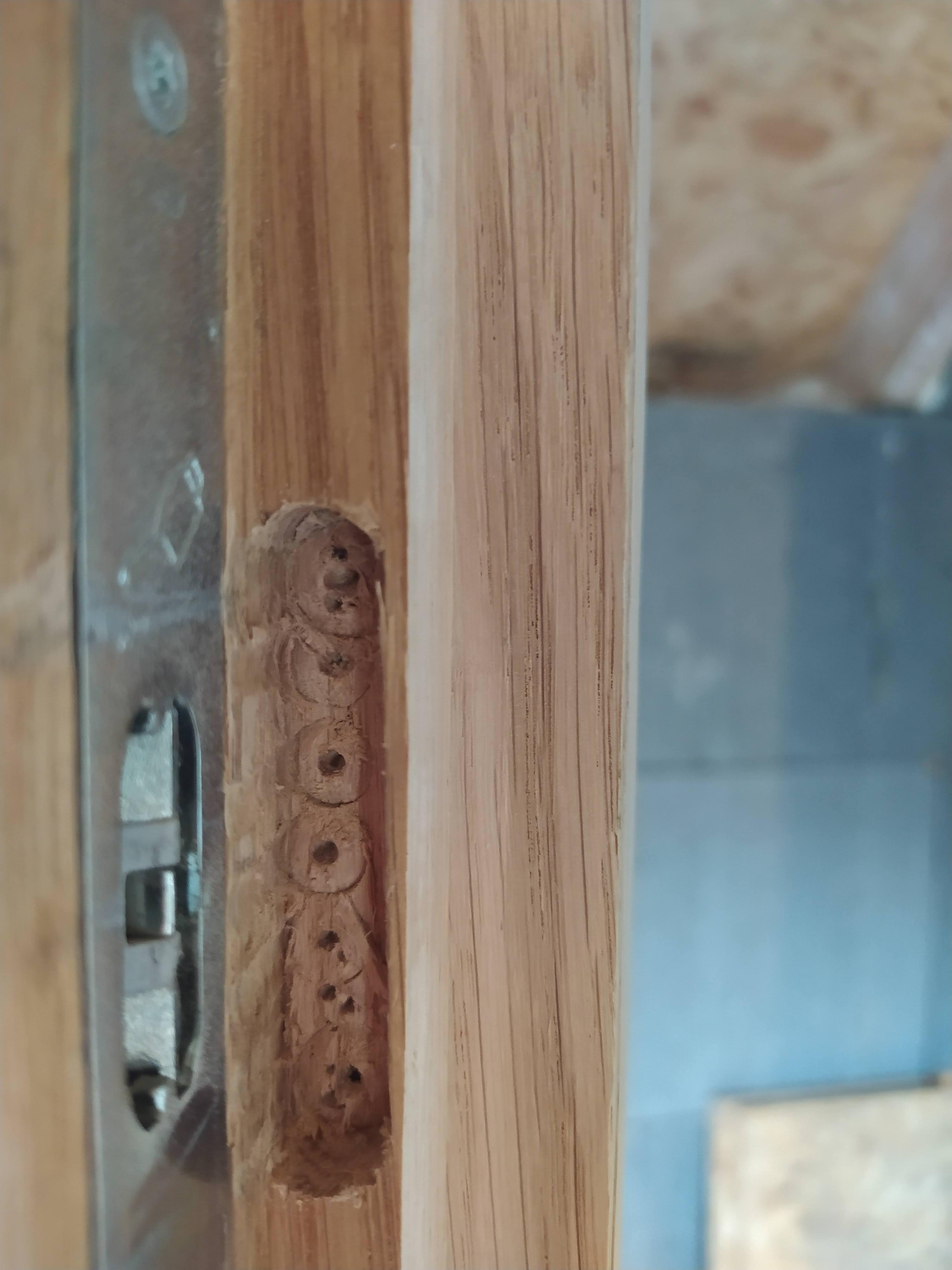

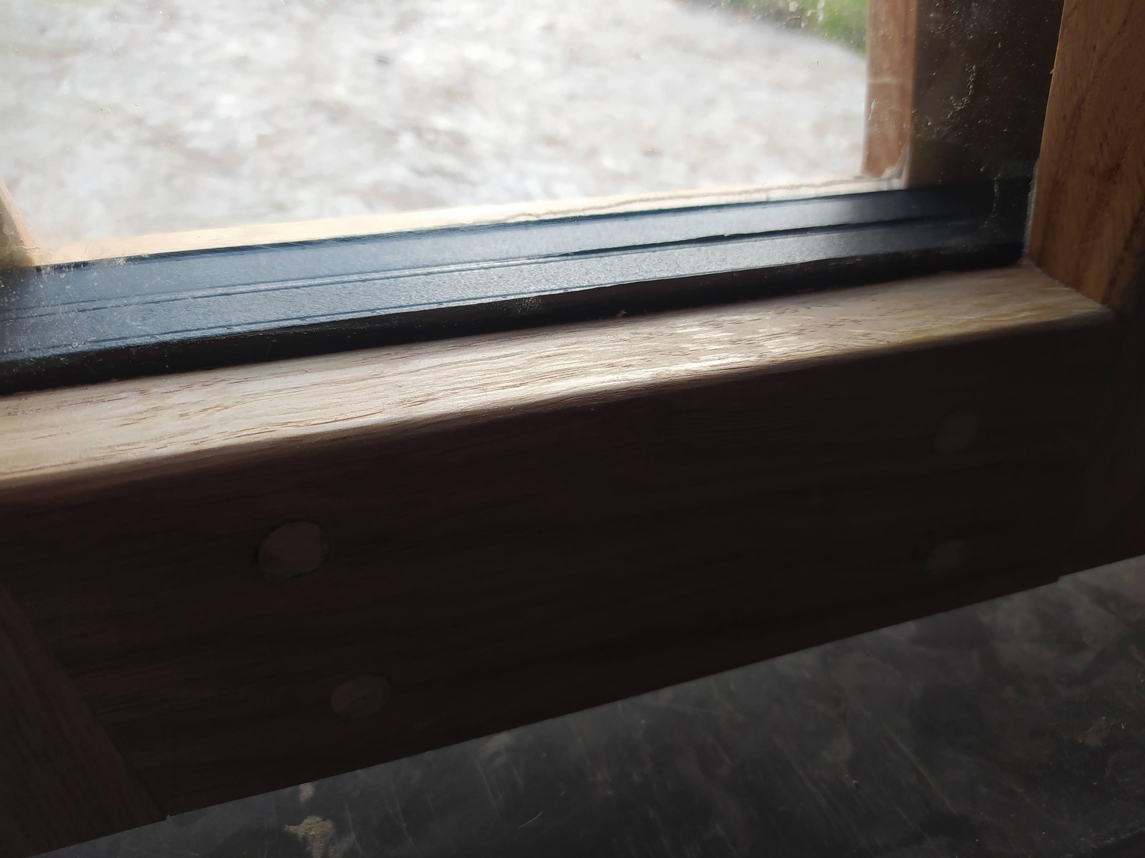

willbish Posted February 1, 2022 Author Posted February 1, 2022 14. Bigger mistake plugged? 15. Hinge not recessed far enough into door 16. Wafer thin amount of wood material, how long will that last? 17. Yep splitting already 18. Quality 19. 20. Looks alrite if you squint hard enough. 1

Simplysimon Posted February 1, 2022 Posted February 1, 2022 i mentioned a week or so ago about 'people who work with water and 'leccy', that's been made by someone who watched someone who worked with wood ? in the last pic it looks alright as long as you don't look bottom right. not acceptable even in the dark, money must be returned and a new door made by a joiner to match frame and existing hinges, assuming they are ok on the standards. just realised pic 19 is standards so new frame needed as well. door looks to be too thin to start, small claims court? unfortunately there is always someone who accepts a job outwith their skill level and tarnishes the trade they are supposed to represent

Adsibob Posted February 1, 2022 Posted February 1, 2022 This is really shoddy work. I think you just need to ask for your money back as it seems unlikely that a second attempt will be much better. There are so many mistakes! If they get difficult, state your statutory rights in writing (fit for purpose, made with reasonable skill and care, of reasonable quality, of reasonable durability, free from defects, etc), attach all photos and explain why each photo shows a statutory right being breached, give them 21 days to resolve the issue by refunding you your money, and then sue them.

Gus Potter Posted February 2, 2022 Posted February 2, 2022 (edited) Pragmatically I would consider the following. Show them what you think is wrong. The "Something protruding through internal face." is one point you can really hang your hat on. A lot of the rest, while unsightly is hard to benchmark against any standard. Yes the door is tight.. normal would be a 2.0mm clearance on an internal door.. 3.0 mm on an external door..when fitted in a mid range moisture content / environment (who decides what that is?) but who can say the reduced gap is not due to the moisture content of the surrounding fabric etc in your house? I would open negotiation on say paying 25% of the cost.. thus you are asking for a refund but not all of it. At the end of the day you may get enough of a refund to be able to say.. hey we got a good quality door but badly fitted.. but for a good price. Once it all gets knocked about a bit then the current pain wears away? If the door sticks then a good joiner should be able to sort it out with a bit of thought. From their point of view (supplier and fitter) it's not a total right off so your installation may come close to cost neutral from their point of view so they may play ball. Edited February 2, 2022 by Gus Potter
Adsibob Posted February 2, 2022 Posted February 2, 2022 (edited) 35 minutes ago, Gus Potter said: Pragmatically I would consider the following. Show them what you think is wrong. The "Something protruding through internal face." is one point you can really hang your hat on. A lot of the rest, while unsightly is hard to benchmark against any standard. Yes the door is tight.. normal would be a 2.0mm clearance on an internal door.. 3.0 mm on an external door..when fitted in a mid range moisture content / environment (who decides what that is?) but who can say the reduced gap is not due to the moisture content of the surrounding fabric etc in your house? I would open negotiation on say paying 25% of the cost.. thus you are asking for a refund but not all of it. At the end of the day you may get enough of a refund to be able to say.. hey we got a good quality door but badly fitted.. but for a good price. Once it all gets knocked about a bit then the current pain wears away? If the door sticks then a good joiner should be able to sort it out with a bit of thought. From their point of view (supplier and fitter) it's not a total right off so your installation may come close to cost neutral from their point of view so they may play ball. I disagree with this. You are entitled to reject the door and demand that they redo it properly or give you a full refund (their choice). Of course whether they actually oblige is another matter, and maybe that is what @Gus Potter is alluding to. If you don’t want to sue, and you haven’t paid by credit card, you might have to compromise. Edited February 2, 2022 by Adsibob

Declan52 Posted February 2, 2022 Posted February 2, 2022 I would try and salvage the frame as this would be the least noticeable and would mean you don't damage the structure removing it. The door on the other hand needs removed and cut into firewood. You could maybe live with a single one of them issues but that list of pictures showing all the faults is taking the piss. A joiner didn't build that. A 2nd year apprentice on a Fri afternoon knocked that together. 1

Makeitstop Posted February 2, 2022 Posted February 2, 2022 One or two very slight errors or incorrect cuts is one thing, (although still not really acceptable on a quality bespoke product) but that has far too many issues to be tolerable. Anything puncturing or severely marking the visible faces is just not on, not at all. It needs to "look" perfect. You absolutely must not pay anything for this, and whatever you "might" have paid by way of deposit, you should seek a refund. Whether it's the first time the person has made this type of product or not is irrelevant, they have accepted the job and are seeking to charge you for it, therefore, it needs to stand up to any reasonable competitors work. It isn't difficult to argue it does not do that. The problems this displays appear to be so easily avoided too, so my question would be why weren't they?
Mr Punter Posted February 2, 2022 Posted February 2, 2022 I think as a finished oak door there is not much hope for it. At the risk of offending @willbish, would there be any mileage in perhaps filling, sanding and painting part of the door and frame? I would still expect a refund of at least 75%. The joiner could either accept this or arrange a full refund or replacement, which, on the basis of the door you have, would probably not be up to standard either. 1
willbish Posted February 2, 2022 Author Posted February 2, 2022 Joiner has had the defects highlighted to him. I've raised the idea of a return and refund. Before asking for that I feel obliged to allow him the chance to repair/replace. I've asked that he try to do this within 21 days. Think that seems reasonable. He has responded that he will be back next week to "sort it out". I don't have much faith that repairs are possible and I think he may be wasting his time, polishing a turd springs to mind. However I shall leave him to it and review in 3 weeks.
