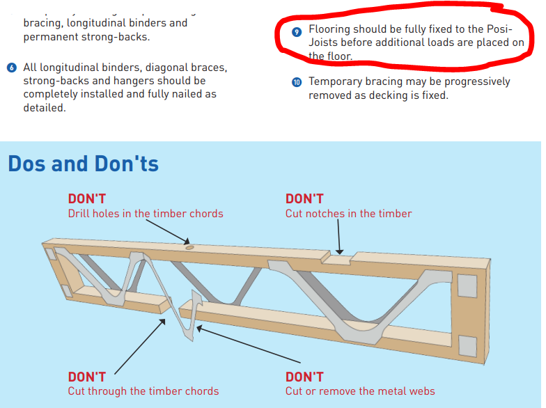

As you are not allowed to notch Posi joists, would you take bends through the gaps in the joists?  That seems to be the only option.
Your 2 choices are feed the pipes through the web of the joists, but on anything other than a very small room that is going to be a very tedious process feeding a long length of pipe through every web.  Or lay battens on top of every joist and you can of course notch or leave gaps in the battens, but that will raise your floor height by 25mm or so so you have to design everything else, e.g. door openings and ceiling heights to allow for that extra build up.

I have never seen that as an approved method.
32 minutes ago, Happy Valley said:
We have decided to router out 16mm across the top of each joist to get the pipe to the next area so we don't have lots of ups and downs.
I recently looked into drilling a small hole in an existing posi joist and all the evidence suggests no form of drilling or notching is allowed. Have you checked this?
49 minutes ago, Happy Valley said:
... We have decided to router out 16mm across the top of each joist ....
In our case 16mm would be just under  half the chord of some of our POSIs.
And thats a lot. I'm not an SE, but out of caution may I suggest you consider  sistering or perhaps some other form of stiffening or support where you have cut part way through the  POSI ?
How do they cope with screwing down floorboards?
Awaiting a response from the manufacturers - ours have 47mm of wood depth before the void the another 47mm.
 According to the posi joist technical handbook, holes and notches are forbidden, but fixing flooring and strongbacks etc is allowed:

Don't touch the flanges of the posi joists.. it's dangerous, a big safety risk and you could really trash your house..
NOOOOOOOOOOOOh.
I am repeating the wise (and crucial) advice from above.
If you don't understand the reason, I suggest looking into it as it is a fundamental part of building knowledge.
(Unfortunately, many plumbers and electricians don't know this either (or perhaps don't care), and damage the buildings they work on).

As above in notching, though electricians & plumbers willfully carry it out in a very regularly basis.
Sister the joists if you have already done it, & suggest screwing a metal plate over the pipe to avoid screws being driven into the joust overlap.
Providing you arnt loading the floor up excessively you should be fine... Its just bad practise.
