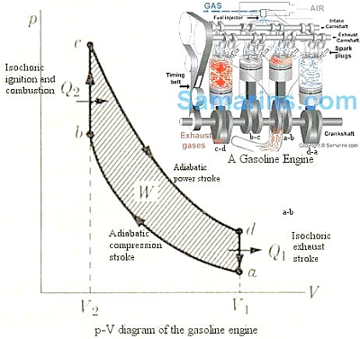

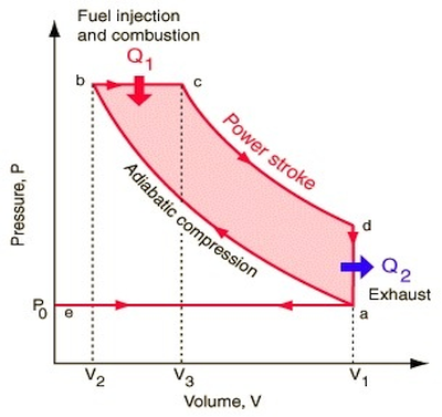

SteamyTea Posted April 17, 2022 Posted April 17, 2022 (edited) On 17/04/2022 at 13:48, saveasteading said: why does a diesel engine Expand A very good question. An ICE is a spark ignition engine. Fuel/air goes in, gets compressed, and at the right time, ignited by the spark. Now the fun starts. The temperature rises extremely fast, closely followed by the pressure, THEN the piston starts to move. There is a slight bit of combustion happening as the piston moves down the bore (flame front and all that, why Wankles are hopeless on fuel economy), but basically the temperature and pressure rises at the very start of the stroke, then rapidly decreases. Diesels on the other hand, limit the initial amount of fuel that is injected, this is ignited purely by the temperature of the compressed air. As the piston moved down the stroke, more fuel is injected, keeping the flame front alive, this keeps the temperature and pressure high for a greater amount of time. It also means that when the crank is 30° either side of 90° from TDC, on the ignition cycle, combustion is still happening, this is the crank position that allows most dynamic torque to be produced. Diesels are often referred to as 3 stage combustion. There are also differences in air delivery pressure and temperature, bore/stroke ratio, gearing etc. Gasoline engine Diesel Engine Edited April 17, 2022 by SteamyTea 1
dpmiller Posted April 17, 2022 Posted April 17, 2022 Diesels run un-throttled and have a much higher compression ratio, too... 1

SteamyTea Posted April 17, 2022 Posted April 17, 2022 On 17/04/2022 at 18:32, saveasteading said: On 17/04/2022 at 15:09, dpmiller said: Diesels run un-throttled and have a much higher compression ratio, too... Expand Glad to hear it. What does that mean (as simple as you like) Expand Diesels are lean burn engines. The power output is varied by making the mixture of air and fuel either fuel heavy (more power) or fuel light (less power). Petrol engines have the same air/fuel ratio across the whole power band (stoichiometric). You may have noticed that when some diesels pull away, or accelerate heavily, they smoke. This is unburnt (wasted) fuel. No extra power is produced at the smoke limit. There is a fine balance, for all combustion, on the air/fuel ratio to get maximum power at any given moment. This has got more complicated with the introduction of turbo charging. This has the same effect of putting in a larger normally aspetated engine i.e. you get more fuel to burn in more air. Turboing has the advantage that it is also scavenging energy that is usually wasted from the exhaust, and you can have a better bore and stroke ratio i.e. reducing the total surface area to reduce heat losses. The compression ratio has two functions. The higher it is, the more air is heated up, this aids combustion in a diesel. But go too far and you get pre ignition. This is when the compressed air is hot enough to ignite the fuel, before the piston has reached the top (TDC). Fuel in both types of engines is actually present before TDC, this is to allow for a few milliseconds that it takes for combustion to start. To get around this pre ignition problem, fuels have ignition retardants added, octane and cetane are the rating numbers for gasoline and diesel respectively. Low numbers burn faster. This is why old American cars had large engines, their fuel was at a lower octane rating (this does not mean lower energy density or quality), so lower compression and lower power. But also lower emissions of CO2 and NOX. It is the higher compression ratio of diesels that has caused the NOX problem that VW cheated on. By reducing turbo boost, and running the engine cooler while being tested, less NOX is produced, there is less power, but they does not show up during a static tests. Ideally an engines power is measured as Specific Brake Power. All this means is how much power comes out for the amount of fuel put in. It leads to some interesting numbers for large engines, which are generally more thermally efficient at part load. Tried now and it is getting dark, time to head home from the very end, almost, of the country. 2
