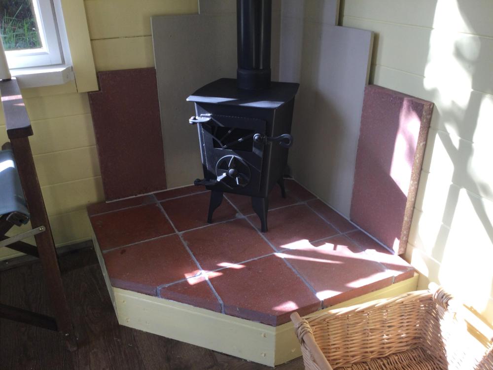

3 hours ago, saveasteading said:
You know that is the right solution really.
I do, but wasting 3/4 of a board, @ £15..
So I'm going to try the Muuri painted tiles 1st. Monitor. I think Im far enough from flue at 8", top area.
If they get super hot.. I can remove & redo.
Looking forward to firing her up! Hoping for a silly cold snap.
Thanks, zoot.

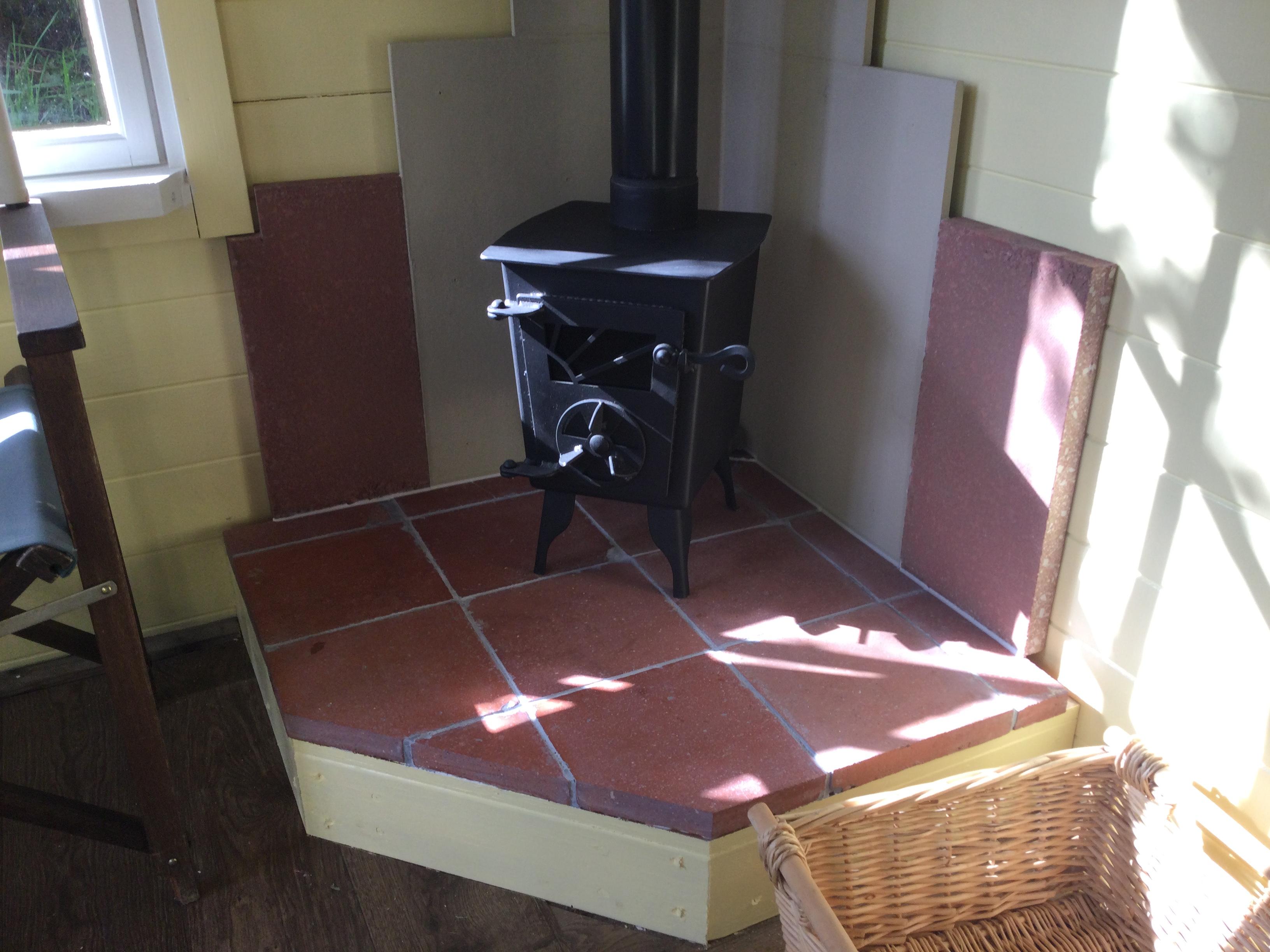

Last bits done/ job fully complete. I'll add an update once fired up, maybe september or so.. but hugely grateful to all for the help ( & patience with my Q's!).
Zoothorn.
2 hours ago, ProDave said:
Looks good.  Go on, I know it would be wasted, but stoke up the fire just to give it a go.
I will do when a cold snap comes ProDave..  I'll roast in there now.
If we had 26*C in feb last year, we might get 5*C in june.
3 hours ago, PeterW said:
Spot on job - To set and cure the fire cement it needs heat so I would do a small test burn, then do another a bit warmer.
Hi Peter- that's one thing I forgot then. But I guess it's too late now having set for a week, so when I fire up 1st will be same now as if I wait-?

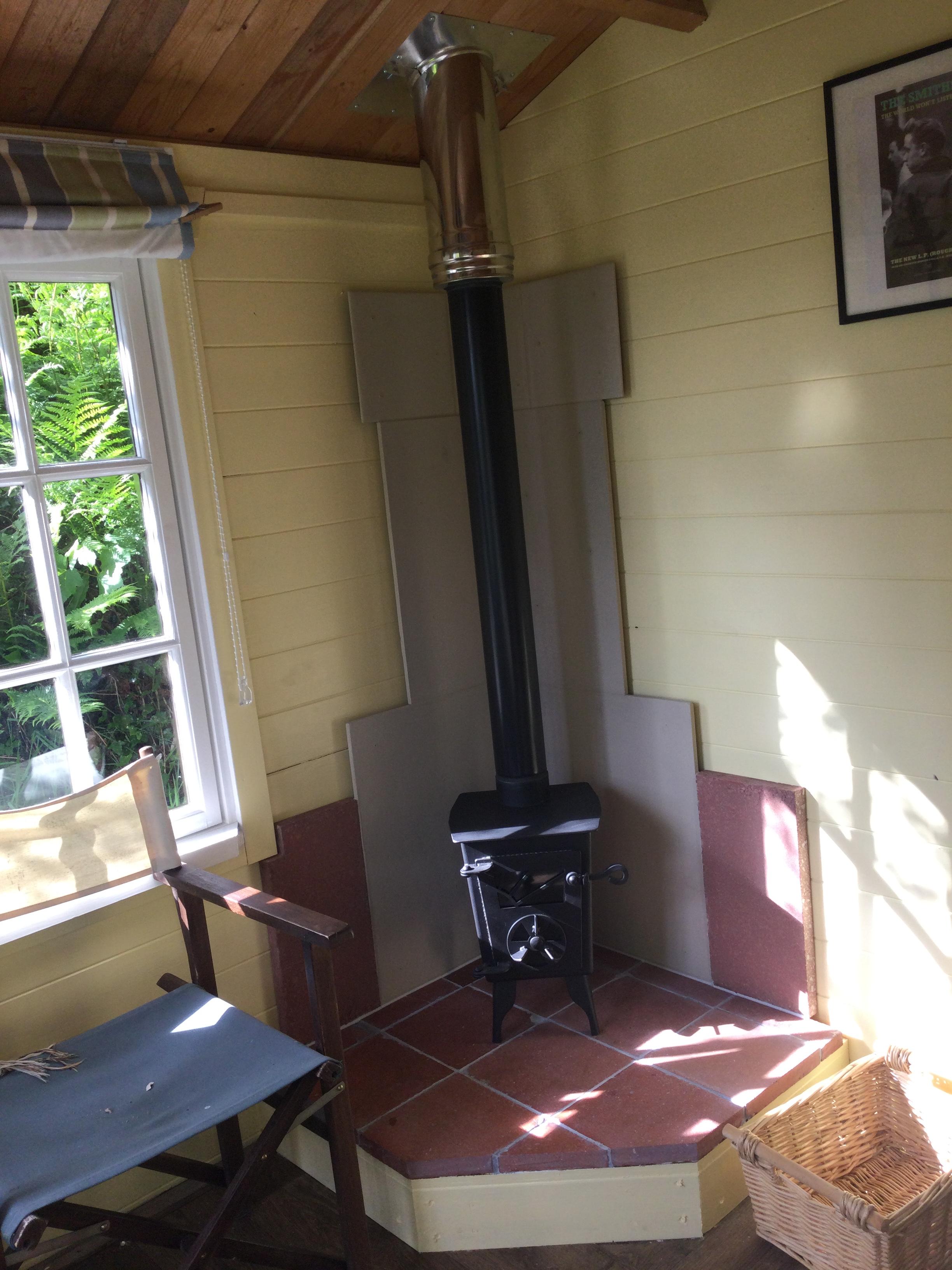

1/2 a cut up 450mm pave slab each side, & ceiling plate nipped to shape around trickier LHS of flue. A bit 'zincy' but cheap & you don't look at it.
Just fired her up! Omg there was all sorts of smoke nasties coming from the stove, but I saw from general 'all over' areas not vent areas.. & subsided after a fretful 3/4hr. I think.
Blazingly sauna- hot. Wow. I only did a small fire as Peter suggested too. This thing is mighty capable, fab design. But have I got twice what I need? Hmm.. seems so to me.
2 other concerns: the twinwall gets almost as hot as the single, you can barely put a hand in more than a second; now I did the fire test of a knauff fluff offcut ( stuff I ID'd a few posts before).. & wouldn't catch/ impressive.
Lastly the fireboard directly behind/ nearest stove gets mighty hot just from my small fire. I checked outside @ this exact spot, hand on wall, & cold as can be. I am therefore putting alot of trust this muuri paint + cement board.
Quite a 2 hours! Much guinness needed, for strength. Zoot.

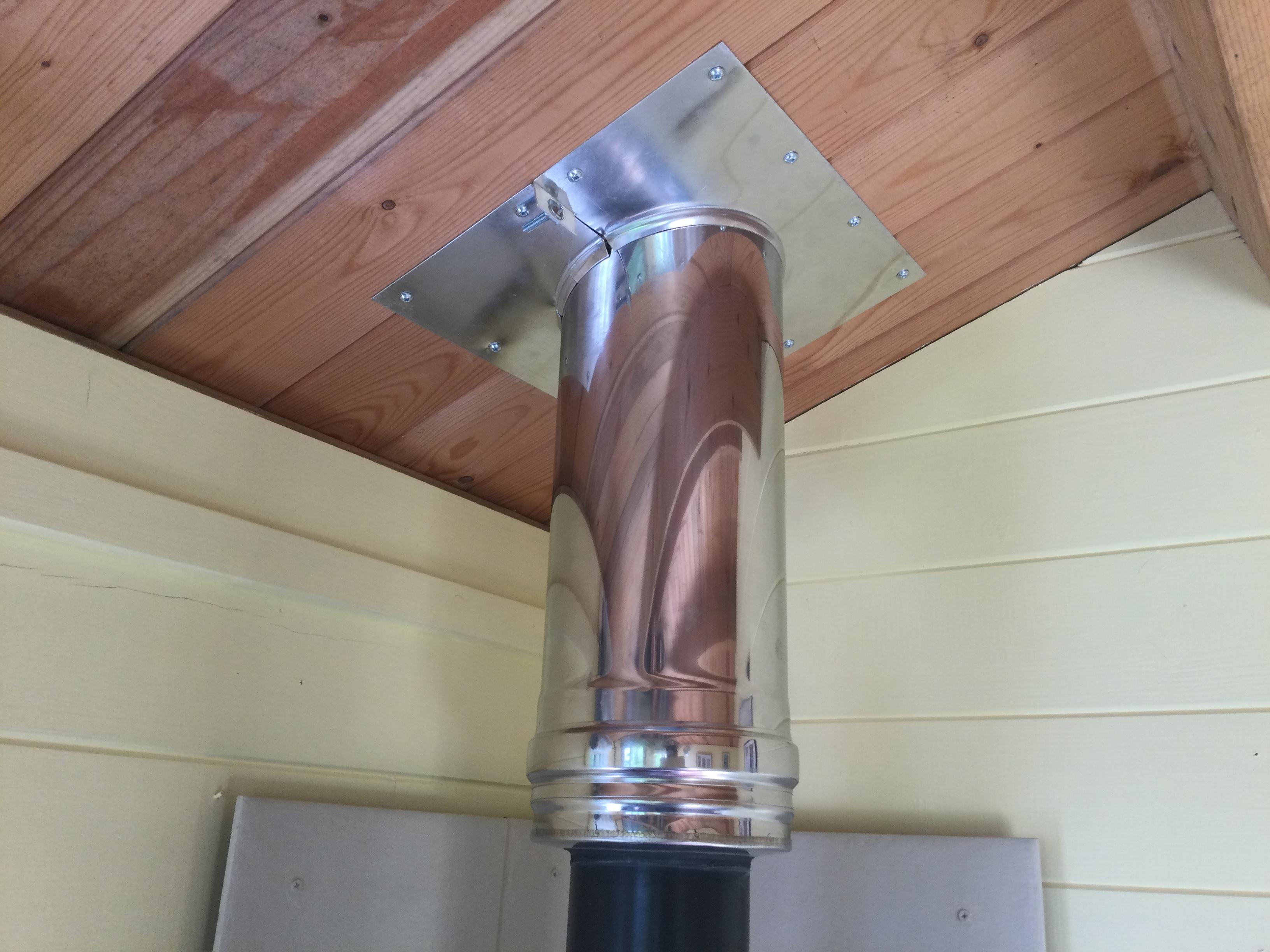

I noticed the twinwall section within cabin, was pretty hot. Hand on say 3 seconds.. then too hot. Still only done 1 fire.
I was surprised, expecting it to be only very warm at most.
Is this anything to be concerned with? I wrapped loft knauff insulation around it, fairly compact, in gap above ceiling plate.
Thanks, zoot.
How thick, and what keeps it in place?
My concern would be with the adhesive which may not be heat resistant.
Good point. No adhesive used, I just nipped a long  4" thick sausage off top of a knauff loft roll. Then pushed it in.
Also no adhesive on the inside collar plate which just holds it in sitting above it.
The only adhesive I've used, is Stick Like Sh*t all weather stuff I stuck down the rubber johnny roof collar thing, to the felt (& screws too into osb below).. & also a thin bead of it around the meeting of the johhny to the twinwall.
This tube stuff says heat tolerant up to 180*. Perhpasthen more Important I check this exterior application of it then.. rather than my concern of the knauff fluff.
Thanks, zoot.

32 minutes ago, PeterW said:
@zoothorn the twin wall will get warm but nothing to worry about. How high up were you holding..?
Hi Peter, well on the middle of the 400mm H twinwall section within the cabin. It wasn't warm, as expected.. but hot.
Maybe I can attatch a radiator thermometre to it next fire.
That’s only 200mm up from where the 2 sections join - not surprised it gets hot as at the join to the enamel the inner and outer skins are connected.
