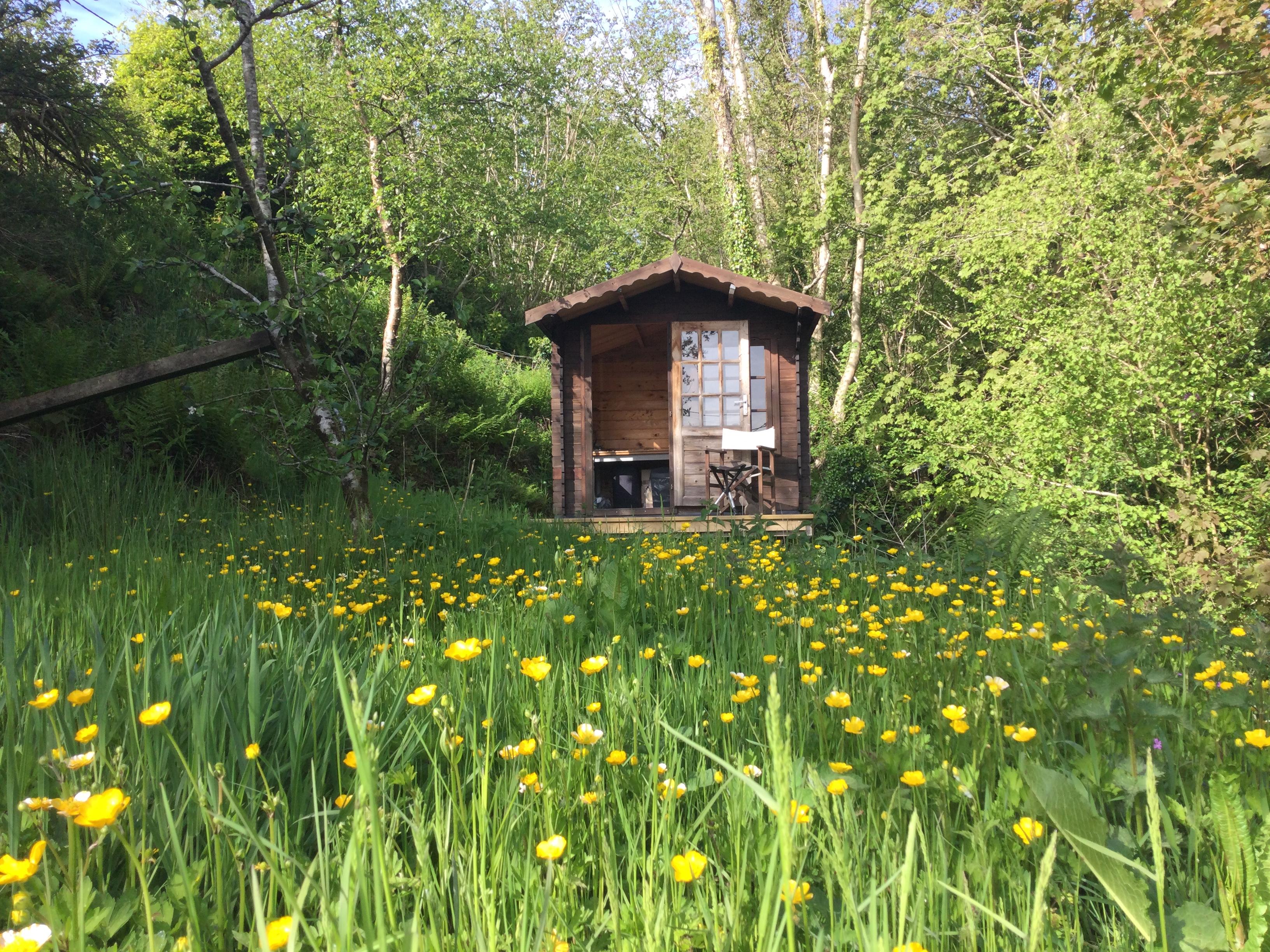

On 14/04/2022 at 21:59, zoothorn said:
Stream can swell to max 3 ft or so of quite rampant flow,  eg after a 2 day deluge, making quite a racket akin to a waterfall.
Pic looking onward past cabin here ( 6ft on from back pillar is my boundary end). Pretty wild this bit, no mans land really.
Odd place to find two gooseberry bushes I thought ( @ pillar, another opposite bank).
