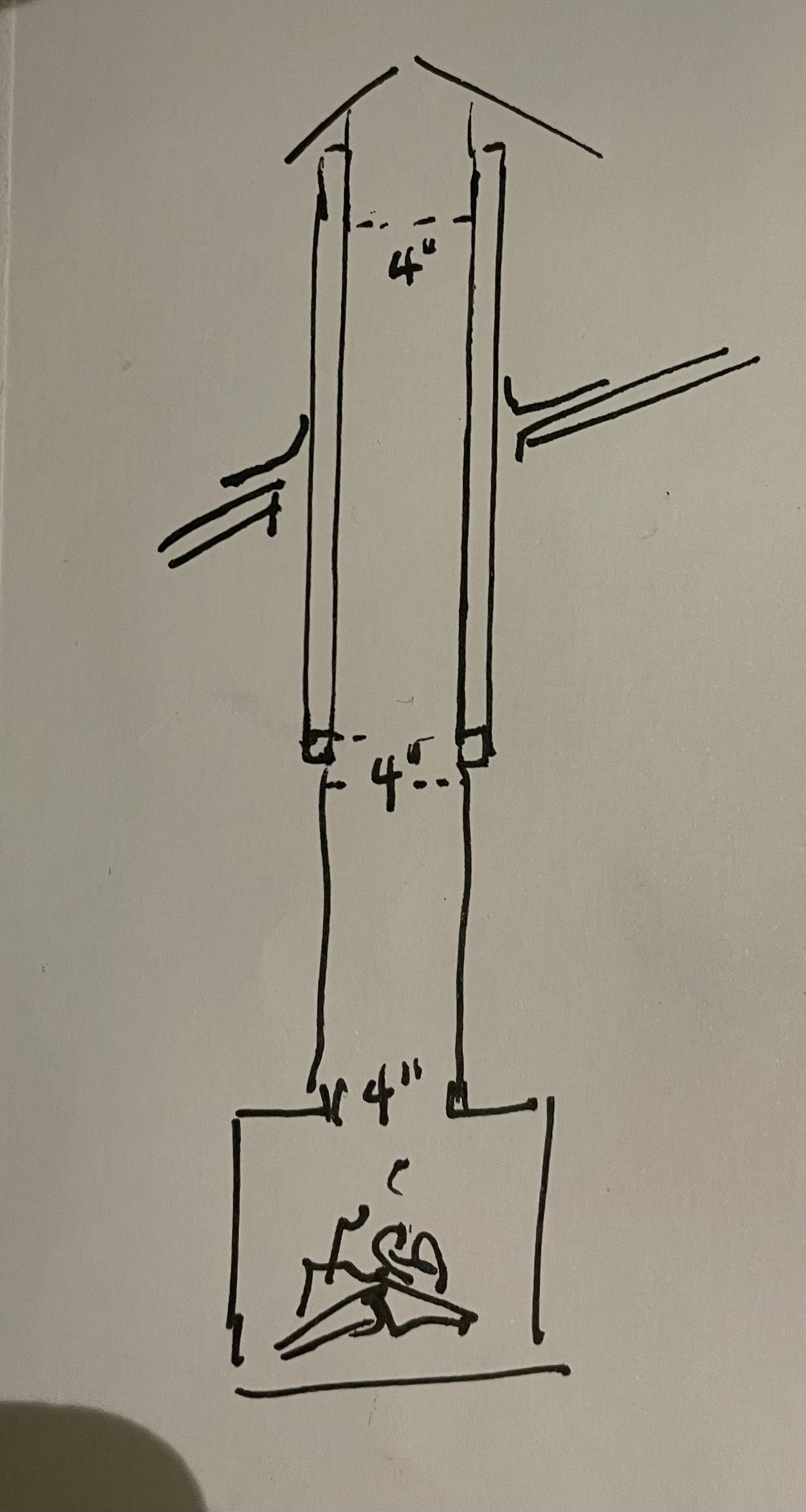

4” single fits to 4” twin wall using an adapter. …
Does this help..???
(And before the pedants point out the flue goes into the inside flange of the stove, it is a sketch not the bleedin’ MI’s…!!!))

Haha. Thanks for the sketch Peter.. Onoff skills there/ really helps this eejet.
NOW Im on board, now I understand flue figures refer to the - internal- flue width. I was only ever thinking outer width!

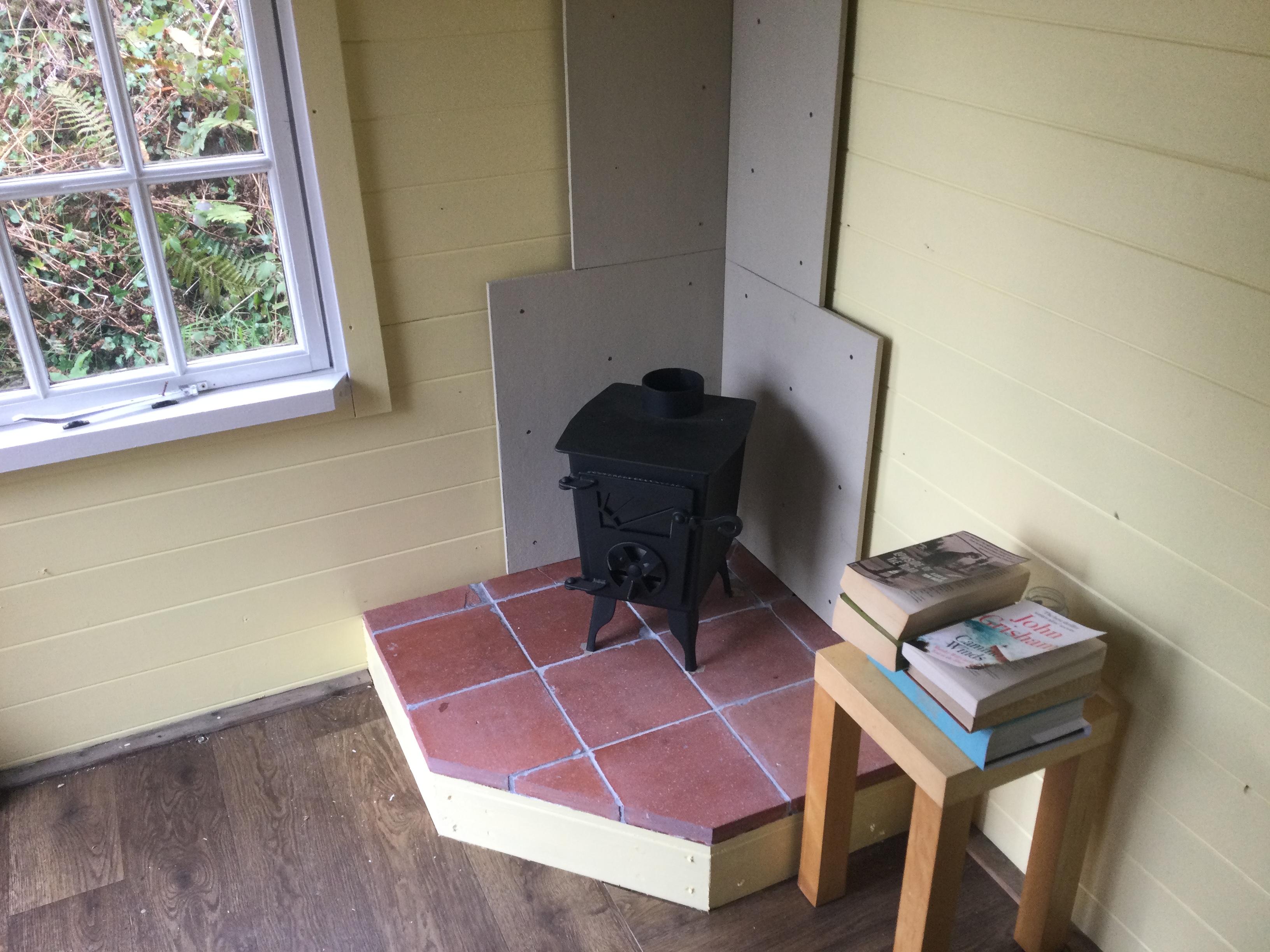

Pictures please!

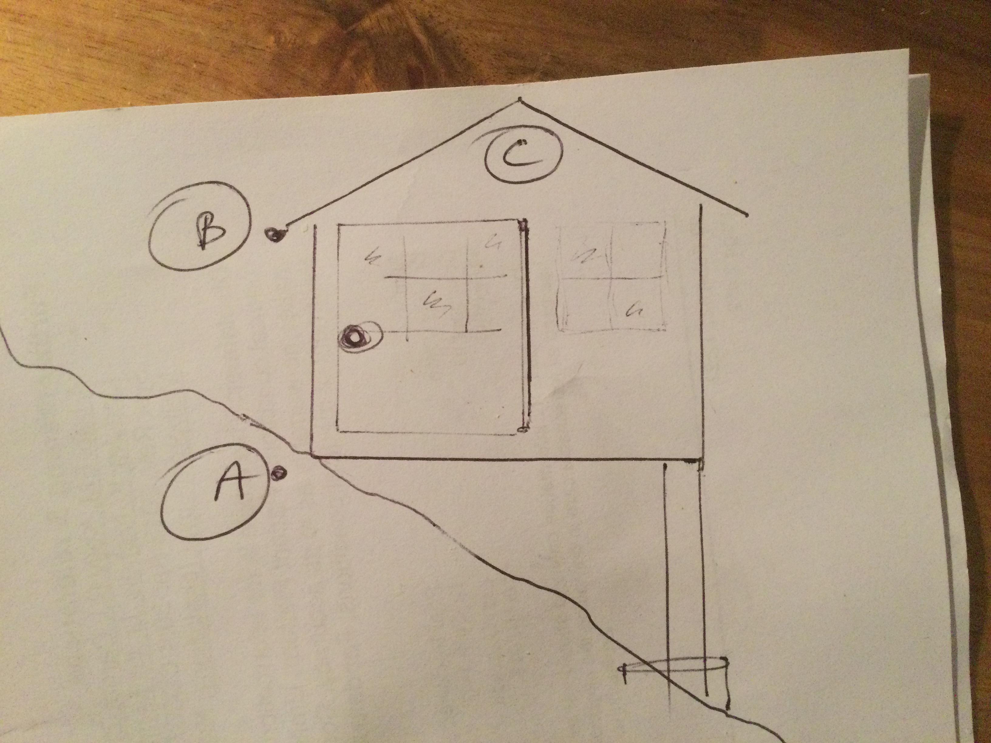

Ok Ive been clarifying B.regs with Peter via pm. And procrastinating too much etc. Could one of you remind me please: the overall Height of my cabin (with regard to B.regs) is determined from the higher slope point... so -not- including the pillars on the steep slope-side?

Height is from the highest part - so basically it’s the top of your slope to the bottom of the eaves.
Im just being super thouragh here, so it's from A to B yes?
And why would it be the eaves.. & not to the tallest point? I mean in theory it could be a far higher/ steeper pitched roof.. & even a small window @ C.
Thanks Peter.

Is my post with my drawing above correct? Im  pretty sure it tallies with what your saying. Best to be fully sure.

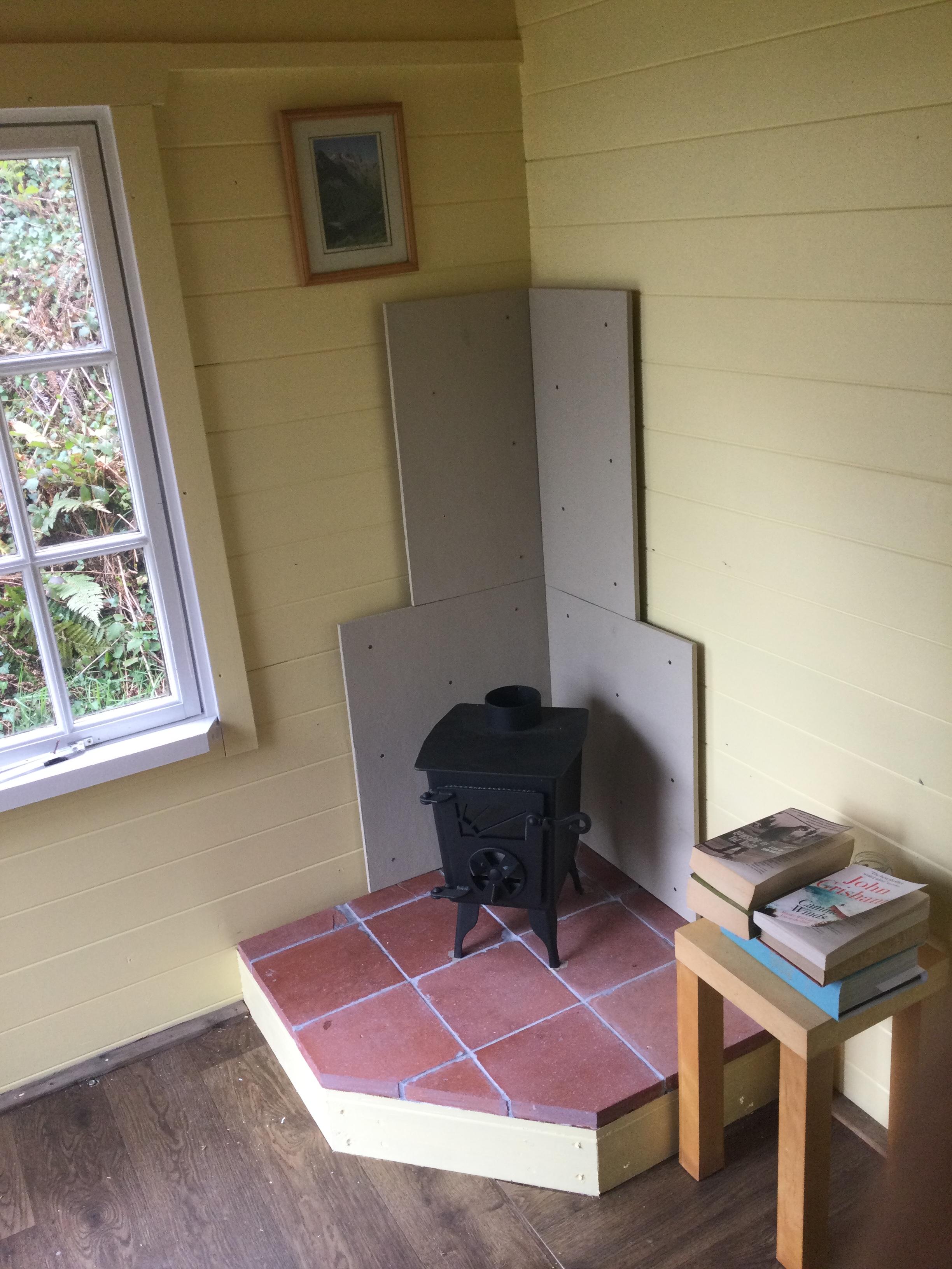

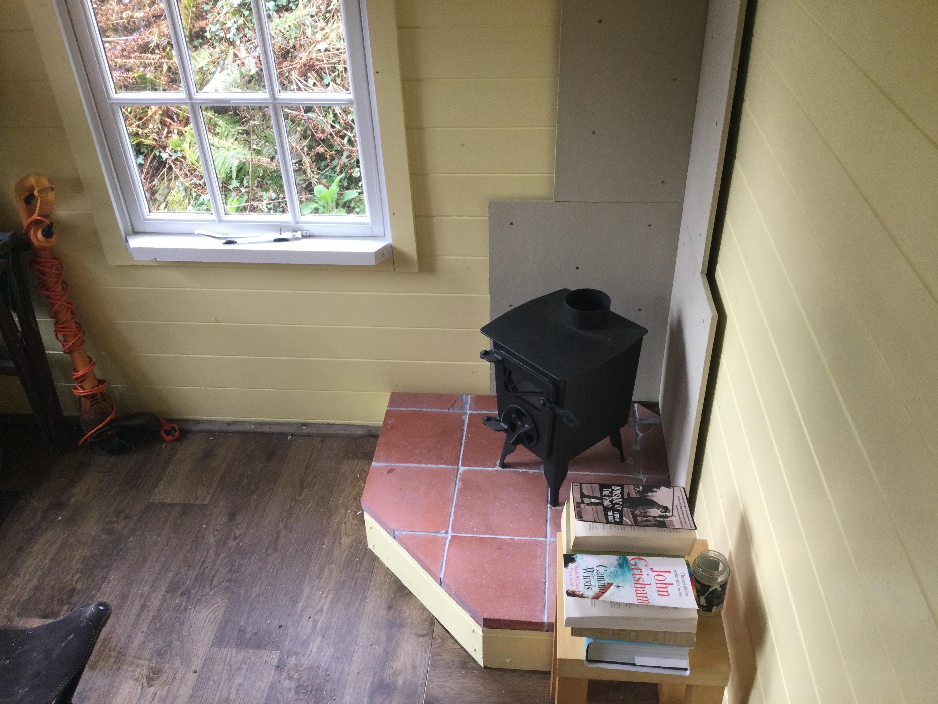

A bit short on the fireboard width.. might -just- be ok. A few bricks to widen the stove area section should sort this area, & flue further away than stove from the walls.. so hoping to just get away with it here too.

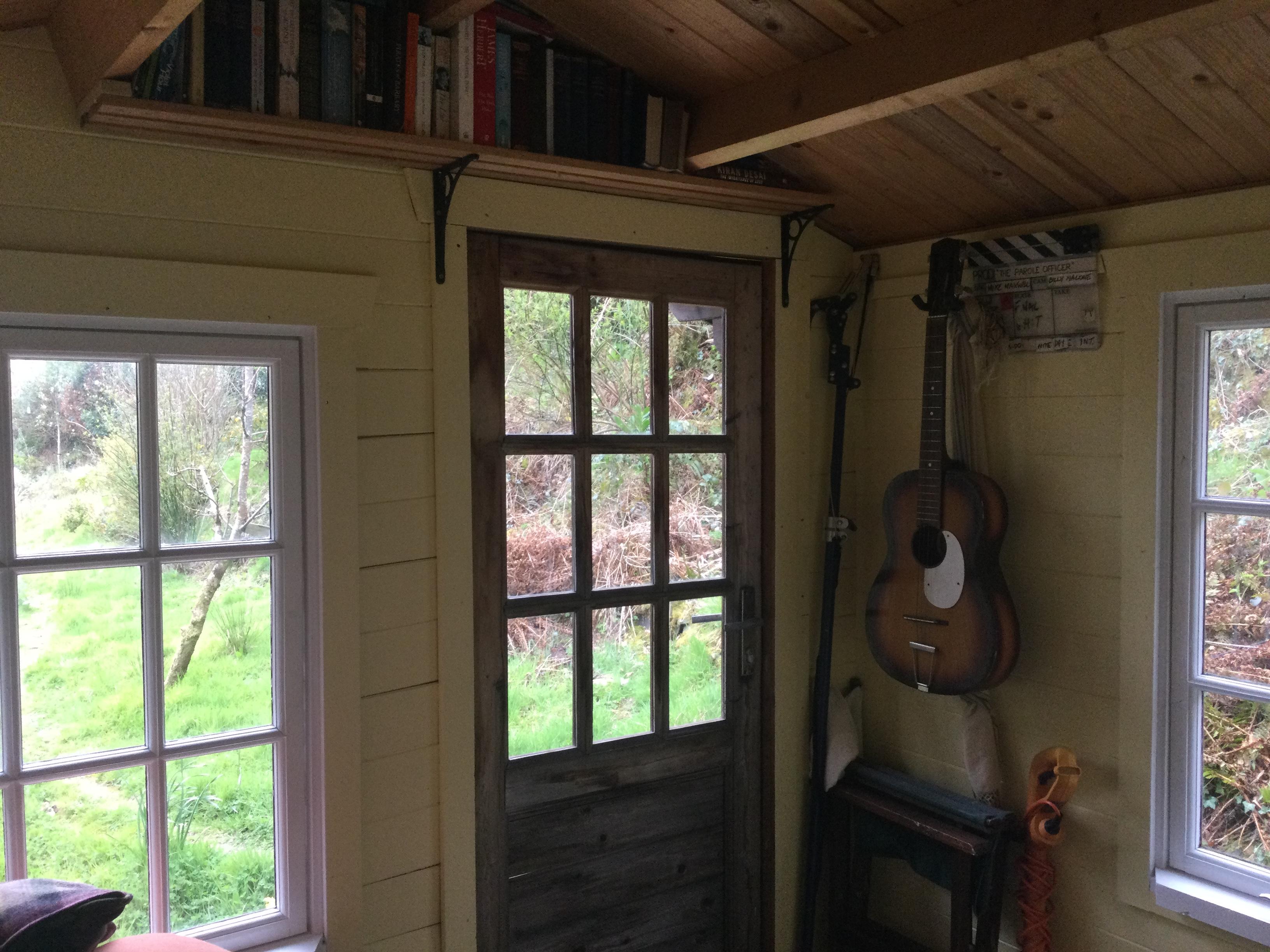

Door is a pickle (pic in post below) lopsided, terribly dark water stained.. rain gets in. A summer job to replace, or ideally tart up s'how.
