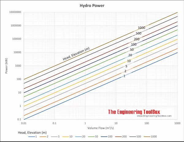

So: the water turbine idea.. I trust your judgment as you know Peter, is this a proper feasable idea (I'd imagine a very light capacity needed/ a light & an ipad battery block if there's such a thing).. or more of a fun 'project' with a 50/50 chance?
Not sure if you're able to give an opinion. Thx if so, zoot.
If you get 10 m³/hour (divide by 3,600 to get flow in seconds) of flow and the head is 1 metre, then you have a maximum of very little.
Edited by SteamyTea

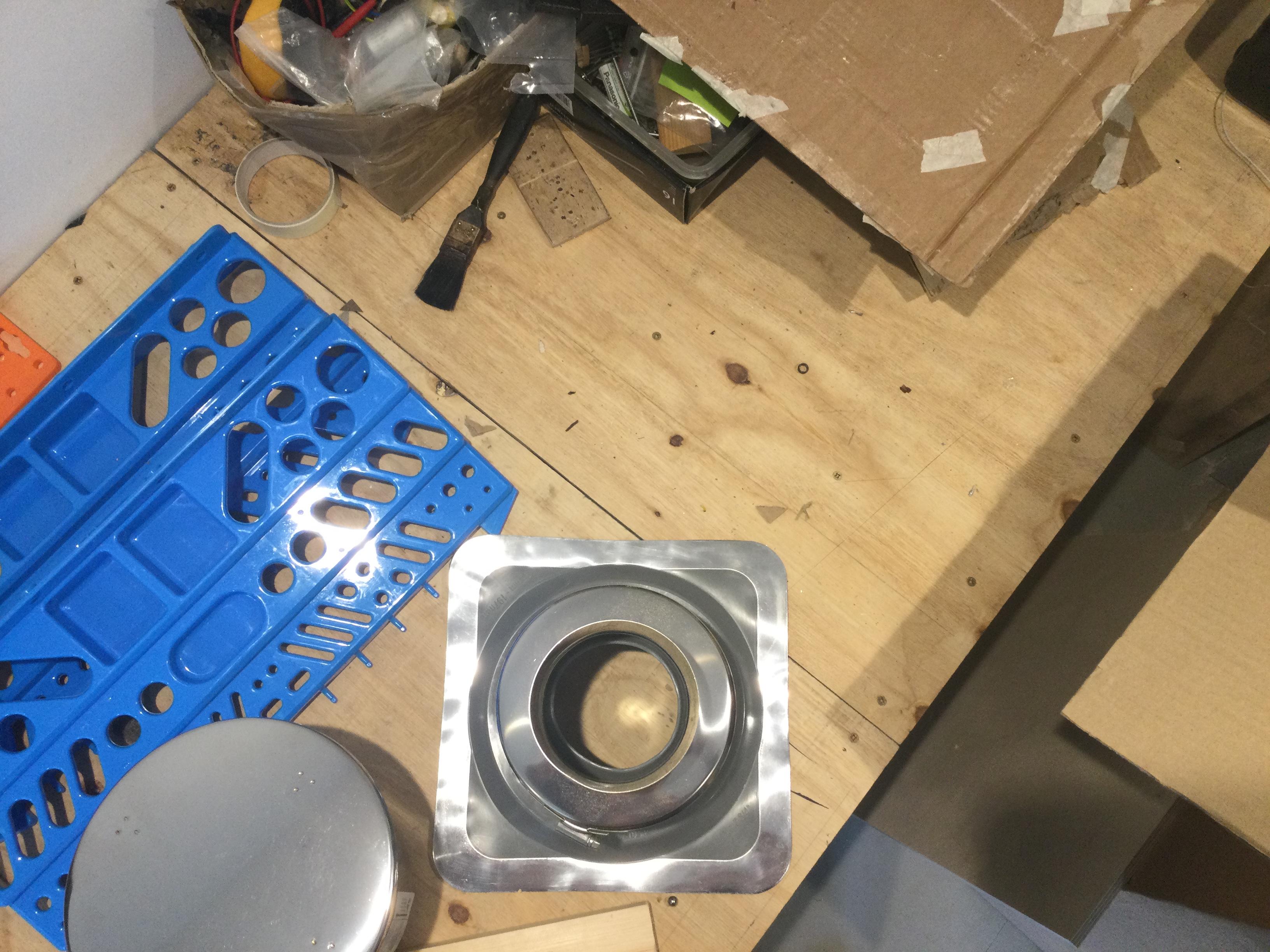

@SteamyTea Hi ST. Thanks for this chart info. I'm yet to dive in to the replies on the turbine idea, but will do over wknd to see how feasable an idea it is.
In meantime I think ProDave mentioned the size of the roof rubber thingy, & my flue relative to it. Im not sure if Ive got too small a roof johnny..
Small white tape mark @ the 6" diameter of my twinwall flue, on the rubber.
Bird nest seems vacant- not sure if cat got the chicks, or fledged. So can think of doing job now.

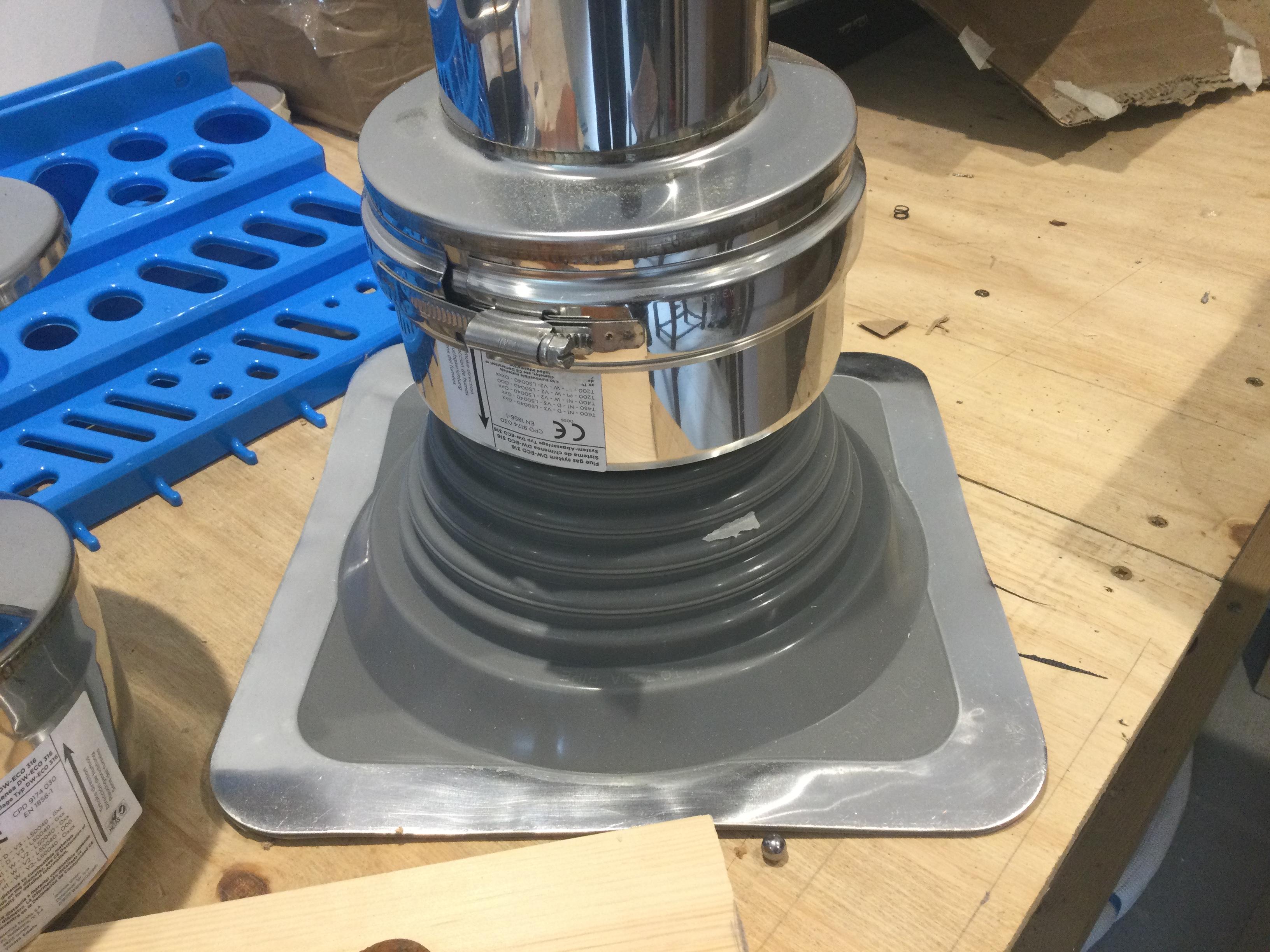

@PeterW Peter could you help.
I'm not sure if my rubber roof collar, is suitable. ProDave or someone says to get the biggest one, perhaps. So I don't know if mine is suitable, for use with my 6" flue ( far wider than I had anticipated).
I know you linked me to the one I bought, but perhaps you just forgot to factor in the slant of my roof ( totally understandable, & my fault as the smallprint says "for flat roofs" I read -after- buying it).
You have given me the idea of hot water, which I can roughly understand makes it more malleable. But. Do I have a wide enough ammount of rubber? Is my flue too wide for it to sdd this slant? I just cannot answer this Q. All I can do is add a photo, of a section of my flue, resting ontop of the collar.
I added a small white tape mark, on the rubber, to show where my 6" diameter coincides down. It is roughly midway along the concertina rubber. Is this too close to the outside of it, to form this slant idea with it?
Thanks, zoot.
So .. how to cut your oval ….
6” flue will need about 8” hole with an allowance for heat so you then need to add about an inch to the circle to make it oval given the slope. So quickest way is to draw an 8” circle, cut through the middle and stick a piece in the middle that’s got another 1” in it. That will give you an oval that is 8” wide and 9” long. Mark the centre both ways and then go inside.
Now use a plumb line to find the centre of the stove outlet. Once you have that, drill a hole through at that point and back on the roof, find the hole and lay the oval of paper on the roof. Trace round the oval and cut out with a jigsaw.
Slice the top out of the grey condom on your white line, then align with the centre of the hole you’ve made and mark round the aluminium bit. Now cut the felt 1” inside the line, leaving the lower edge uncut.
Slide the ally up under the edges of the felt until it’s in place … check for plumb again and build the chimney up dry. Soak the condom in hot water for 5 mins then slide over, replacing it under the felt.
Check it’s all plumb, pull the ally flange out (leave it on the flue section ..!!) and a good gloop of black gutter  sealant under the edges and then put the felt back with some more sealant.
now plumb the flue again, and when you’re happy put a small screw and washer through each corner of the felt, through the ally flange and into the timber.
Finally, quick wipe round the edges to remove any stray sealant and that’s the roof done. Now put your fire cement into the joint (quick tip, wrap the flue just above the outlet and stove outlet with masking tape to stop the cement getting on it.) smooth down with a damp sponge and crack open a beer …
It’s fine… read the above and carry on
