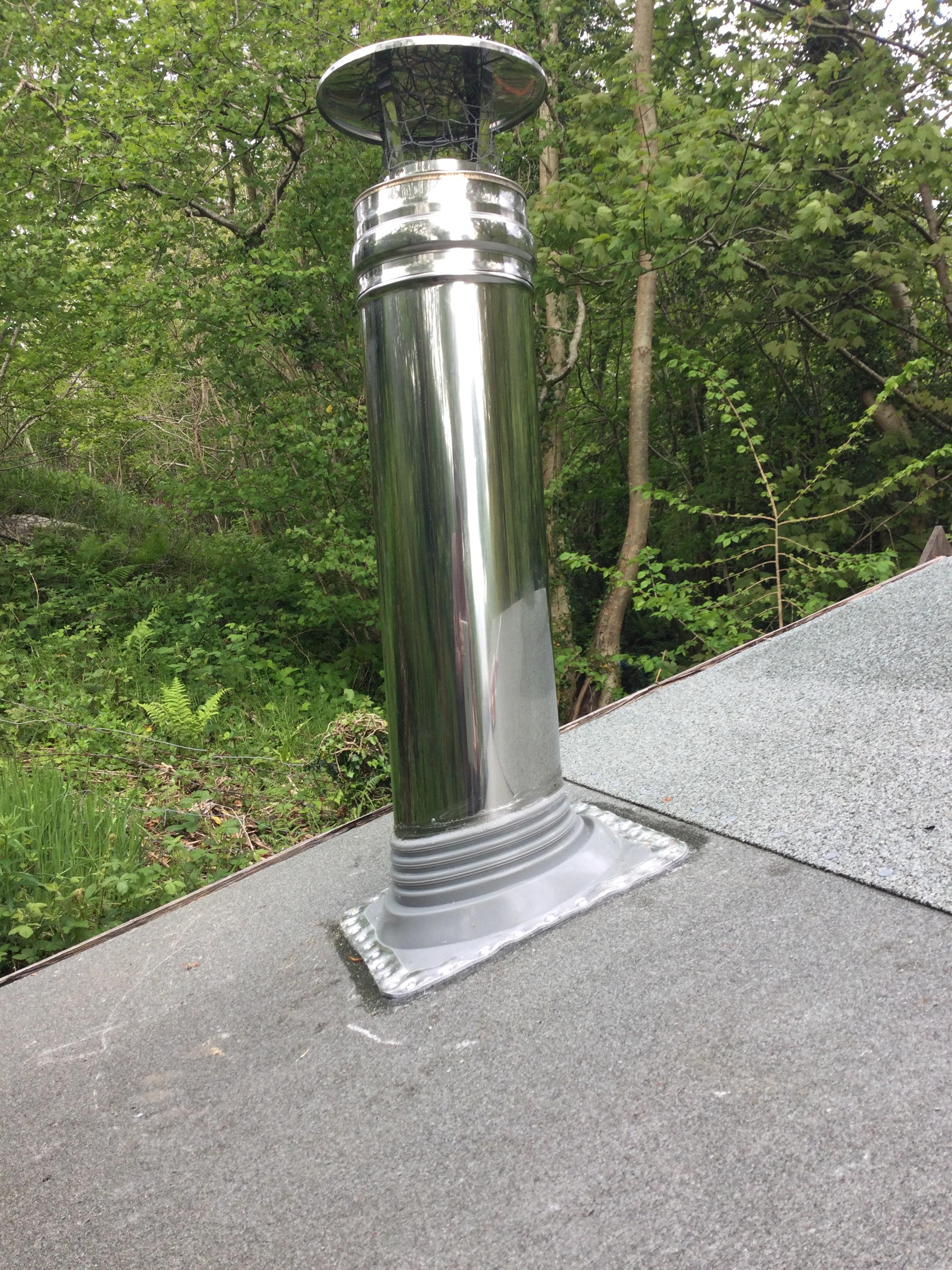

Job.. done! Woohoo!
Started raining of course soon as I cut me hole.. & (new) gun whatnot broke when I went to stick my johnny down.
But rain stopped, dried up.. & fab results. This, I think, is the most satisfying build job so far. 4 hours flat out 'blitzed' it.
It warrants a zoot musical interlude, before pics tomorrow.
Thanks so much. Zooter.

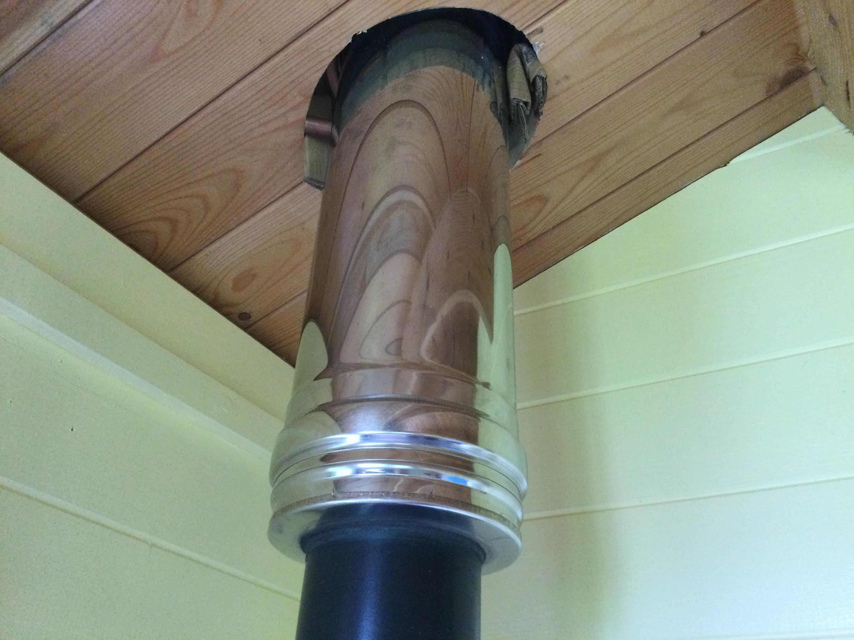

I've got a few things to address before firing up.
1. is sealing around fireboard gaps/ joins, got some NN'sense fire tube stuff.
2. Im a bit short on the fireboard, so need something to add top of enamel flue -ideally an offcut cement board bit, if I can find.
3. I have wedges in my ceiling oval at the mo, I was going to add L shape brackets, under the johnny, 3 to secure flue solidly but was in a rush. So maybe add say two inside @ pic 2?
4. some plate thing to cover over the ceiling oval cutout, not so easy being an oval shape.
5. Lastly: something actually in the ceiling gap.. Ive seen some folks stuff rockwool here. Need to find offcut/ can do this job & 4 in time. No rush, warm weather on it's way.
Thanks, zh
2 minutes ago, ProDave said:
Fit one of these to the inside of the ceiling, it will tidy up the hole and secure the pipe  (choose size to match your pipe, don't just buy that one)
https://www.flue-pipes.com/finishing-plate-30-125.html
(this covers item 3 and 4 on your list)
Hi ProDave,
useful link thanks. Did see these things. Thing is as it's on a slope, this won't fit too well I'd have thought? Its that pesky oval shape etc.
What about something in the 1" gap around twinwall, actually in the ceiling?
Thanks, zoot
They come in different levels of "ovaliity"  that one is designed for a slope of 0 degrees to 30 degrees so should fit your roof. That's what I used in the mobile home.  I used the 45 degree version for the flue through the house roof, that is a more elongated oval shape.
Fill the gap with some rockwool or similar non flammable insulation.
Aha great thanks, understood. I forgot rockwool was non flammable. I do have my 1" of ecotherm board sandwiched between my roof layers. A bit late in the day, but this is no issue.. is it?
Grateful, zoot
Got any of that cement board left?
Take a rectangle of it. Mark an oval to suit dead centre plus say 5mm all round.
Cut the oval out with an old jigsaw blade.
Cut in two halves.
Screw to the roof.
Cut in two halves.
Screw to the roof.
Intumescent mastic the gap around the pipe.

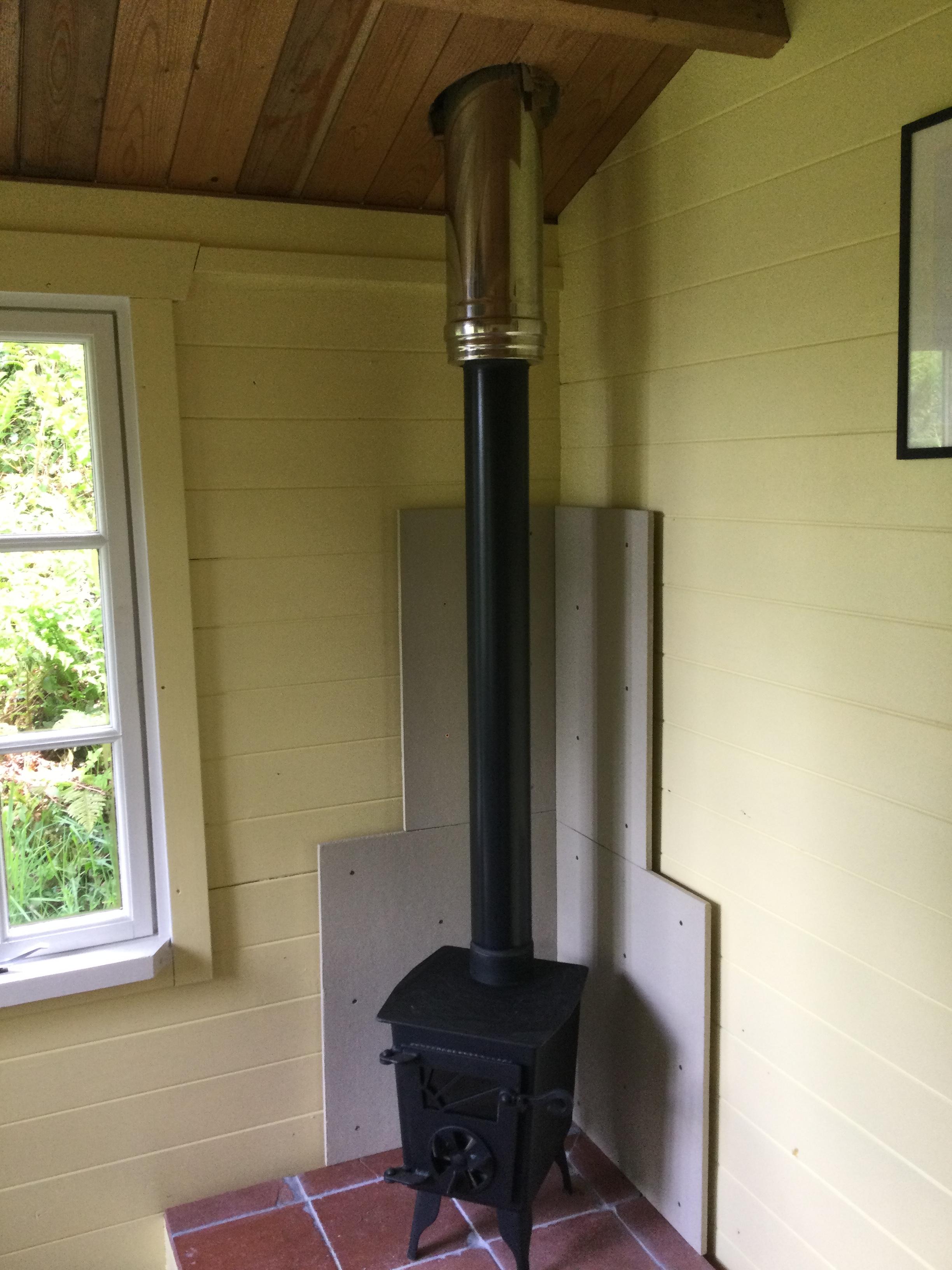

Very last Q if I can chaps. As you can see on page before, I was an eejet measuring & fell short with my fireboard. So top of enamel flue is unprotected by 9" H.
Now thankfully the black flue is a good 8" away from both side cabin walls here.
Would I be ok to just paint the walls say 3x in Muuri paint? Or should I wait & add 10" H more cement board? When an offcut comes along.. Annoying.
Thanks, zoot.
Paint 10" sq (8mm D) ceramic tiles 2x in Muuri paint... then gun adhesive/ stick to walls here?
Pic again. Also could do same around stove, to broaden the fireboard width by 10".
Pic again..
