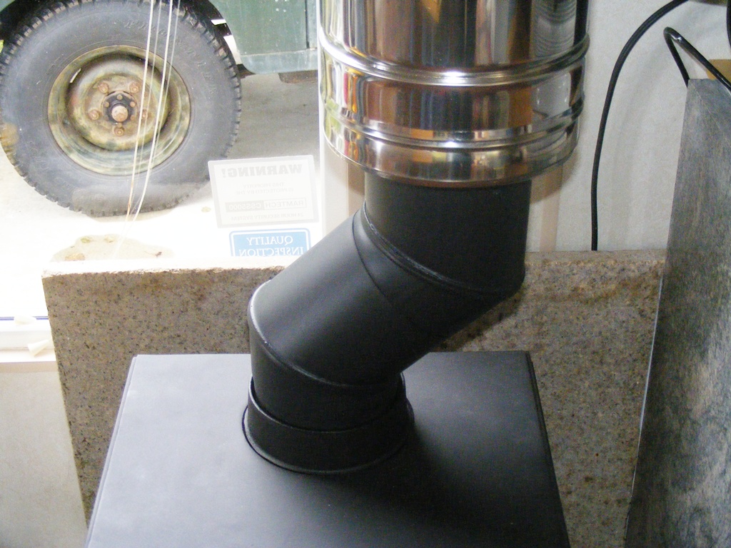

Most flue manufacturers will make a special fitting to go on the bottom of the twin wall to convert to single.
This is what I did in the caravan.  I then had to add two 45 degree bends to make an offset as taking the flue straight up from the stove would have been right in the middle of a roof rafter.
You could take the twin / single adaptor straight into the stove, or a short length of single wall flue.
Thanks for the pic ProDave. Ok this is now a bit costly & complicated I think with adaptors.. & the twin stuff bigger than I thought too.
Im going to have to go single from the stove up 1m. Then Im 400mm shy of ceiling. So twin from there up thru roof. If walls get too hot at this 600mm gap above my heat boards, then I fit more board. Or, I paint the walls with the heatproof muuri paint.
The flue edge will be a good 8" away from walls. I think/ hope this might be sufficient. We'll see.
