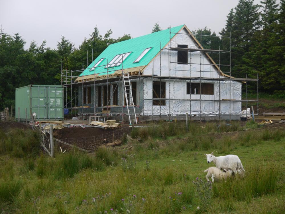

Thedreamer Posted January 3, 2022 Posted January 3, 2022 I decided to go for a stick build kit for our self build, a few years ago. I found the large timber frame companies to be very expensive. It cost £13k for the materials to build the kit. Included within that is £5k for engineered attic trusses from Pasquill. Labour was £9k, for making the kit, erecting it and also a suspended ground floor. Other expensive items were a steel beam for the vaulted ceiling and three Kerto beams for the middle ridge part. I also had to hire a telehandler with a truss jib for two weeks that cost around £750. By the end of that we looked like this (excluding the velux windows). 1
saveasteading Posted January 3, 2022 Posted January 3, 2022 19 minutes ago, Thedreamer said: By the end of that we looked like this Well done. A few years ago was before the current shortages and price rises, perhaps 20%? you have declared £28,000, so say £31,000 now. If this was your job, it would be interesting to know what do you think you would have charged a customer?
Thedreamer Posted January 4, 2022 Posted January 4, 2022 10 hours ago, saveasteading said: Well done. A few years ago was before the current shortages and price rises, perhaps 20%? you have declared £28,000, so say £31,000 now. If this was your job, it would be interesting to know what do you think you would have charged a customer? £13,000 was the total materials, including the trusses. £9,000 in labour (two joiners). £750 for telehandler. This was the Summer of 2018, cheap timber prices then. This project is too bespoke to mark up. But adopting this approach, managing on a contractor basis, being careful with prices and applying for any grants along the way has resulted in a lot of equity.
