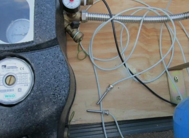

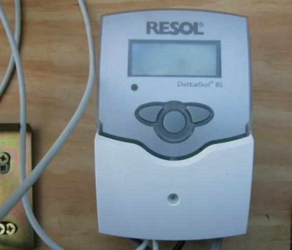

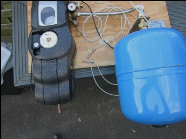

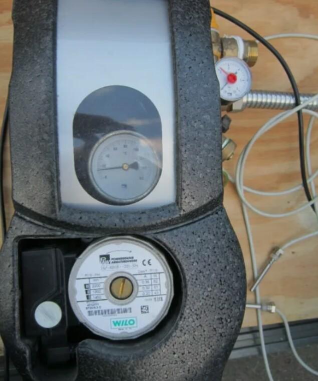

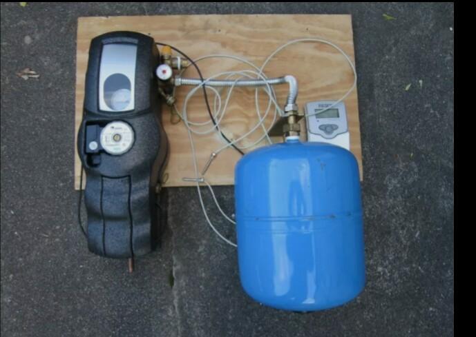

I've also just scored this tank, controller and pump combo. Bought off Gumtree (for £50) but in Edinburgh! Someone's gone and gotten and is holding it for me. Got a mate visiting rellies up there in July who can bring it back down South.
Just hope it works with these panels!

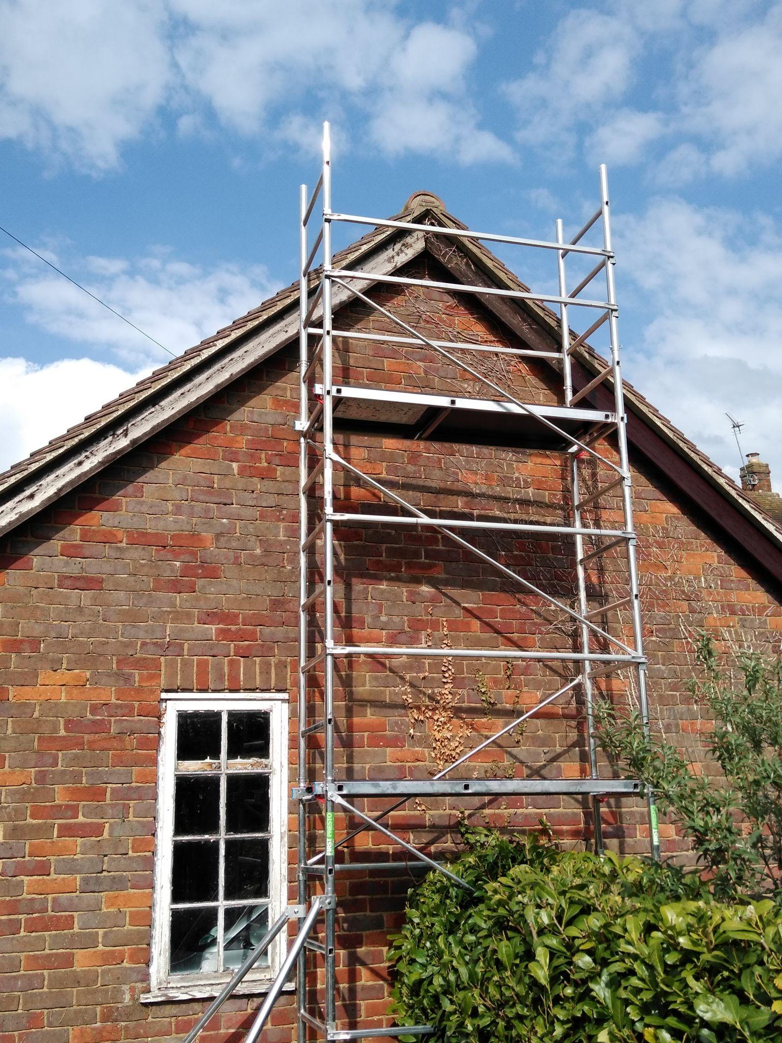

Next step is some scaffold up and strip off some tiles. I'm going to renew the felt under where the panels are going. Then stainless steel brackets and some Unistrut to affix the panels to.

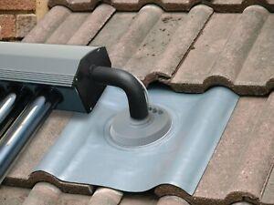

I need to find a couple of these roof pipe entries cheap or make something similar:
Scrap copper HW tank & tin snips?
Copper would be maybe no good if you meant soldering to make watertight? Temperatures can get too high. More of an issue on the pipe joints I guess if a pressurised system where they can soften and burst.
You got scaffolding?
My scaffold tower is currently in Bucks for the foreseeable. Pretty close to yours.
Think I'm sorted thanks.
That's not a "tank" but an expansion vessel.
Silver soldering, brazing or compressions???
Sorry, that's what I meant. Thinking to invest in a decent big heat store. Options for heat sources etc.
It's all compressions on the panels I have here.
