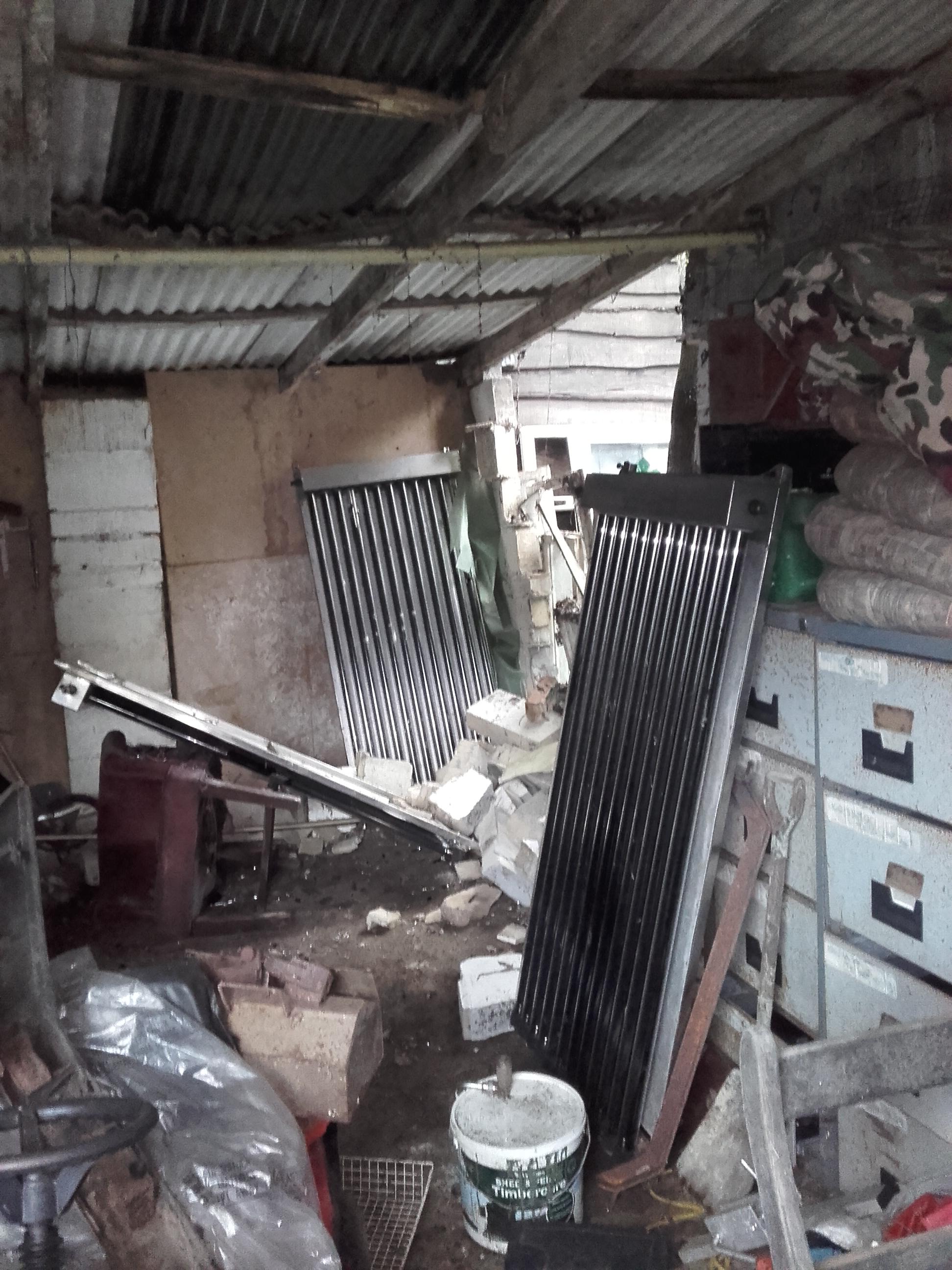

Well this has really fu**ed my Saturday morning up! :(
Apologies to @richi for a start.
@richi kindly donated 3 solar thermal panels to me the other year. I put them "safely" in the corner of the old ramshackle stable block that came with the house. Utter crap the way it was built. Adjacent to the stable a neighbours tree (ash?) has grown and was pushing against the wall. More than a few times I've suggested nicely it  (the tree) be taken down but haven't been overly fussed as the whole stable really needs to be demolished & rebuilt.
Neighbour calls round this morning to tell me the wall has collapsed.
Two panels out of the 3 destroyed.
I'm really quite upset. Bad enough their fu**ing conifers are so high.

OK...in the cold light of day I just ventured into the stable and cleared the blocks off of the ST panels.
1 panel is intact. On the two damaged panels 9 out of the 24 tubes are totalled. The rest look to be in good order.
Are these replaceable easily (soldering job?) I'm seeing spare evacuated tubes on eBay etc.

They are usually just a push fit into the manifold, often with a bit of thermal grease around the end of the heat pipe.
How many are just the tube broken and how many is it the heat pipe as well? Heat pipe just pulls out the top. £15 for just the tube, £25 for tube and heat pipe on the Navitron site at the moment (for 47 mm tubes that yours look like, but I'm not sure).
Ta. Didn't realise there were two separate bits. Will have a better look tomorrow.
