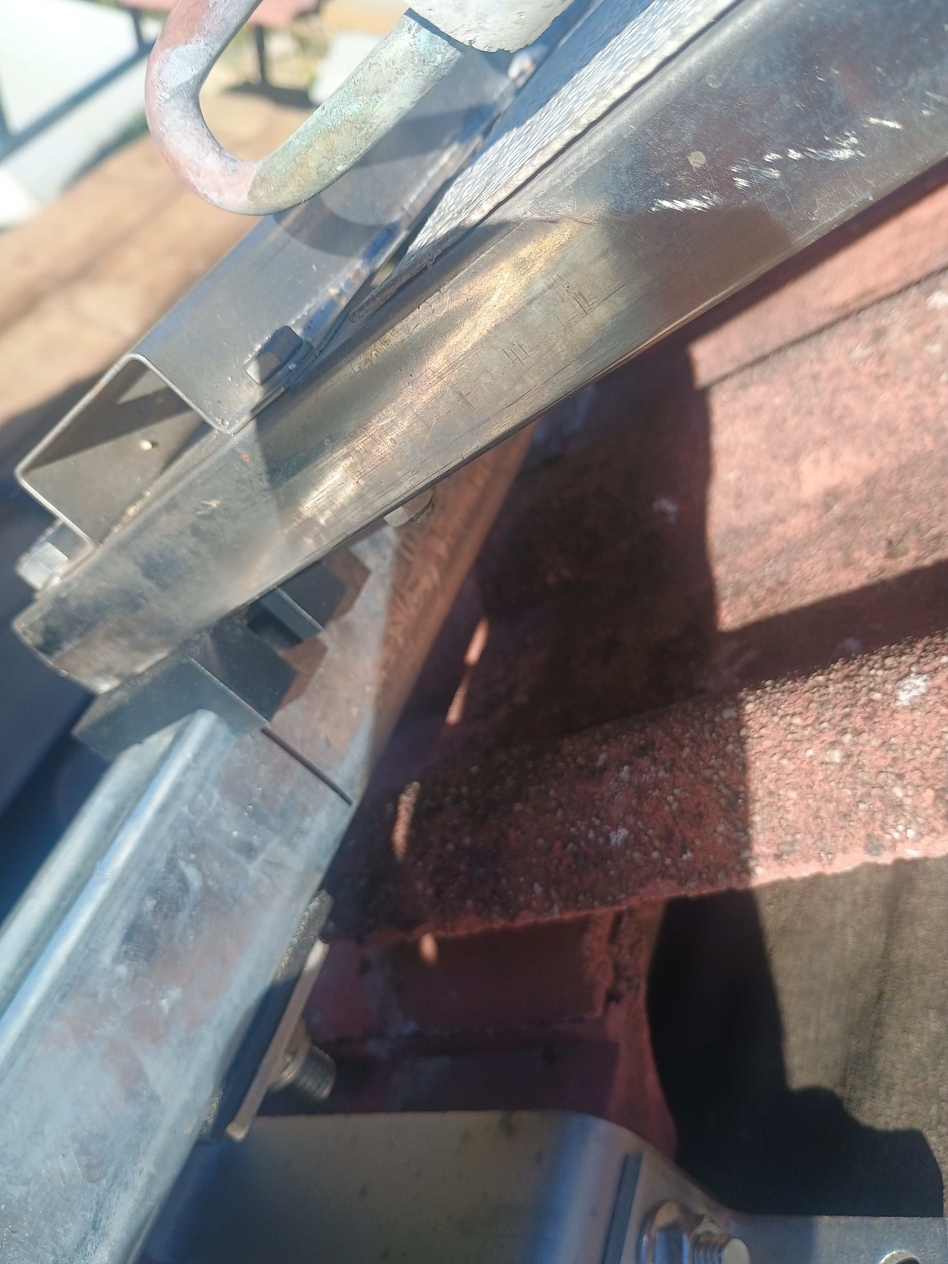

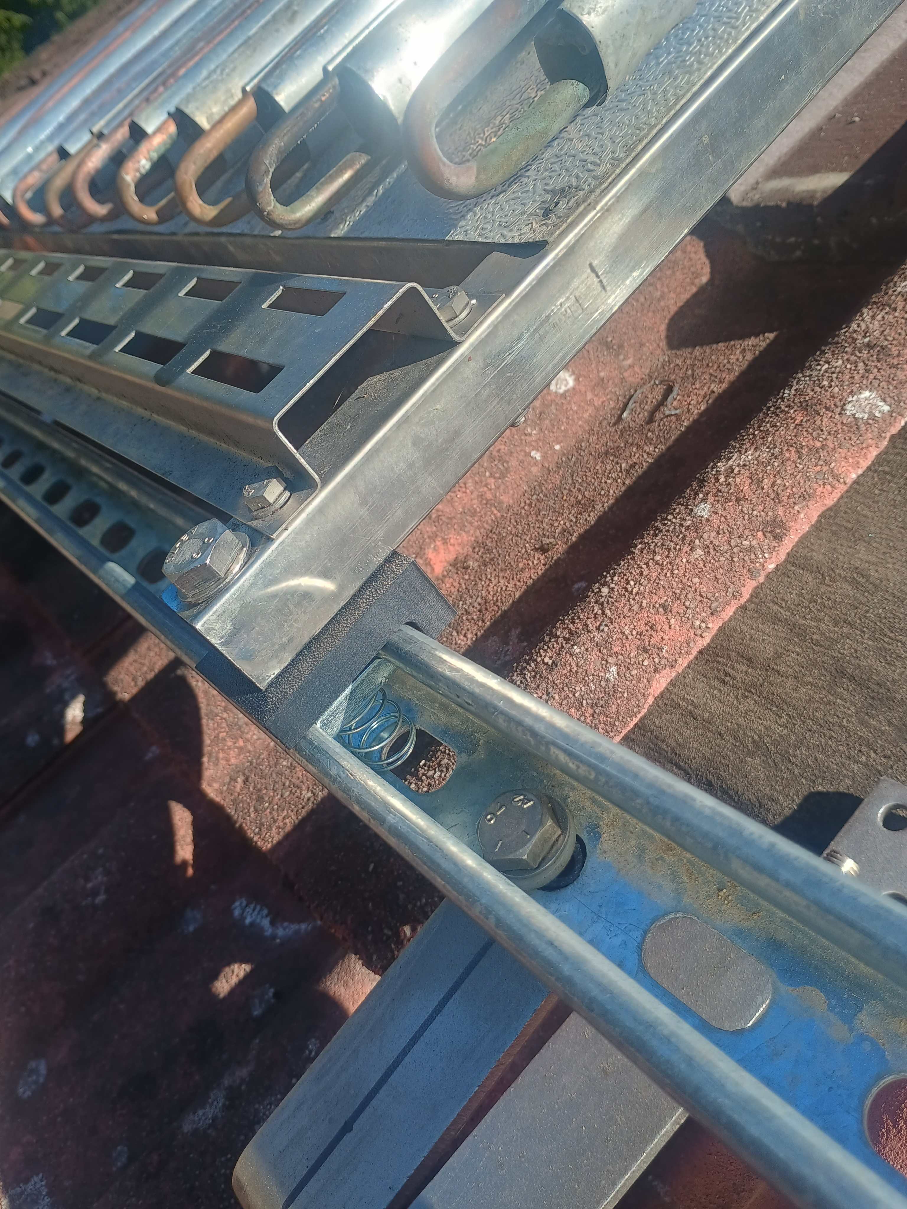

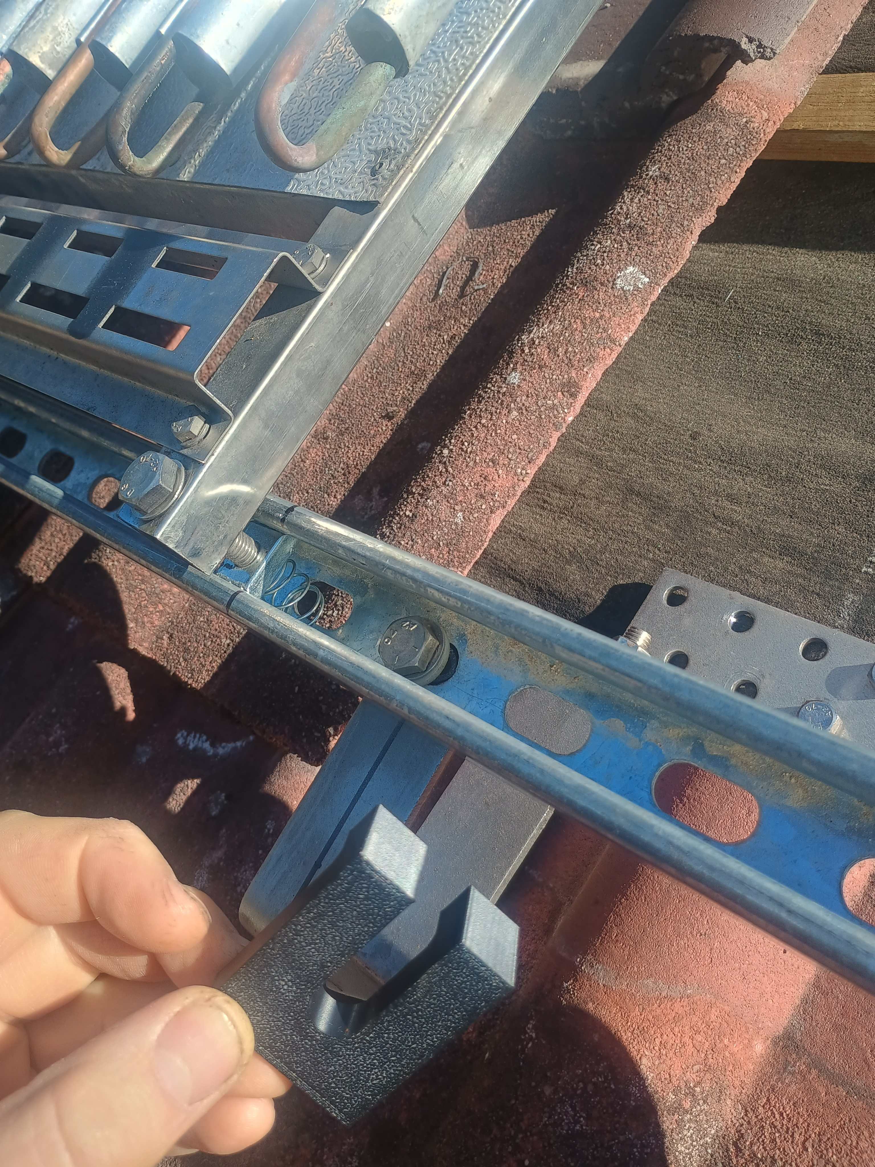

Using unistrut instead of proper channel so had to get creative with some 3D printed spacers:

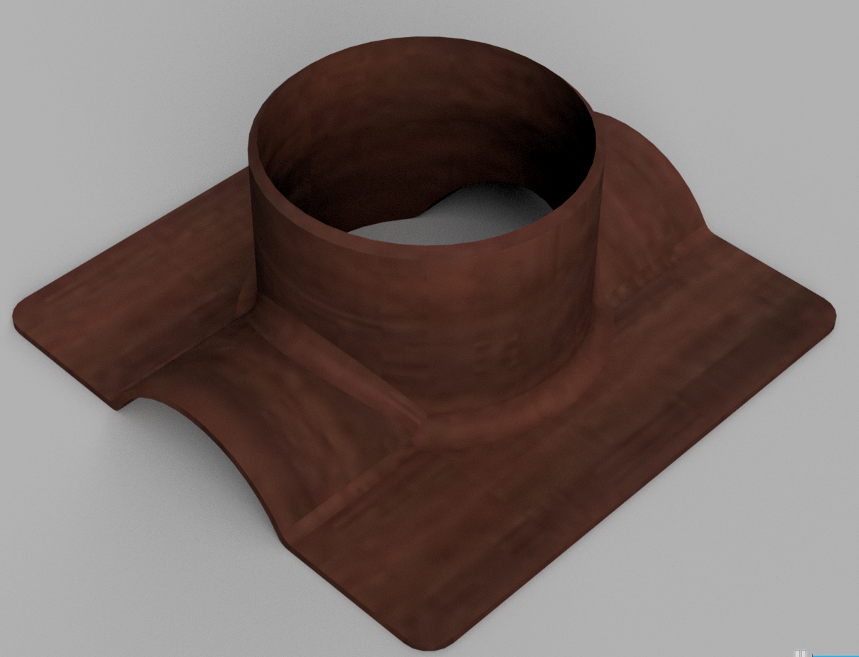

Something like this probably. I'm not BUYING a proper flashing. Going to wet diamond drill the tile and 3D print flashings. All glued down with CT1.

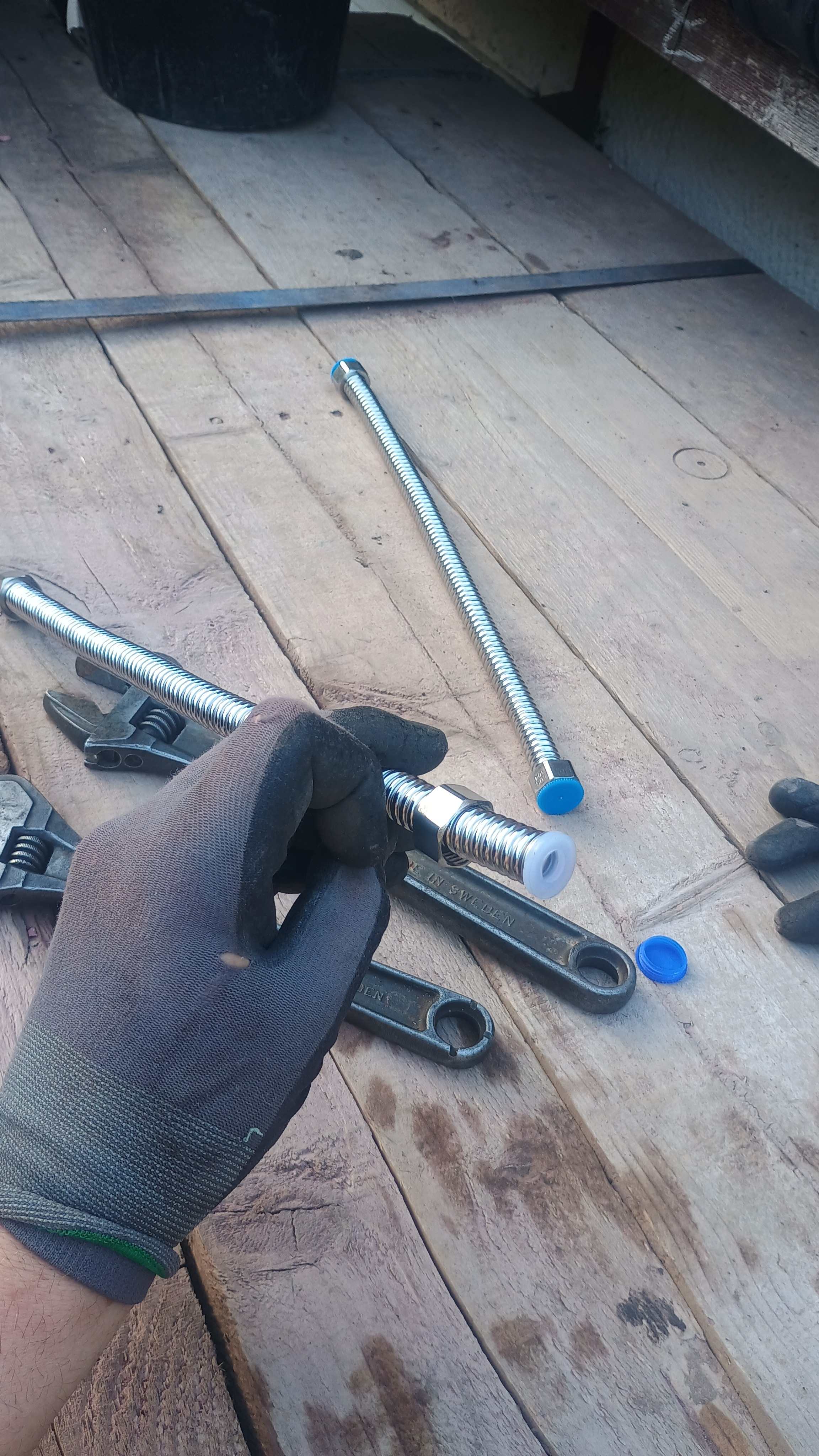

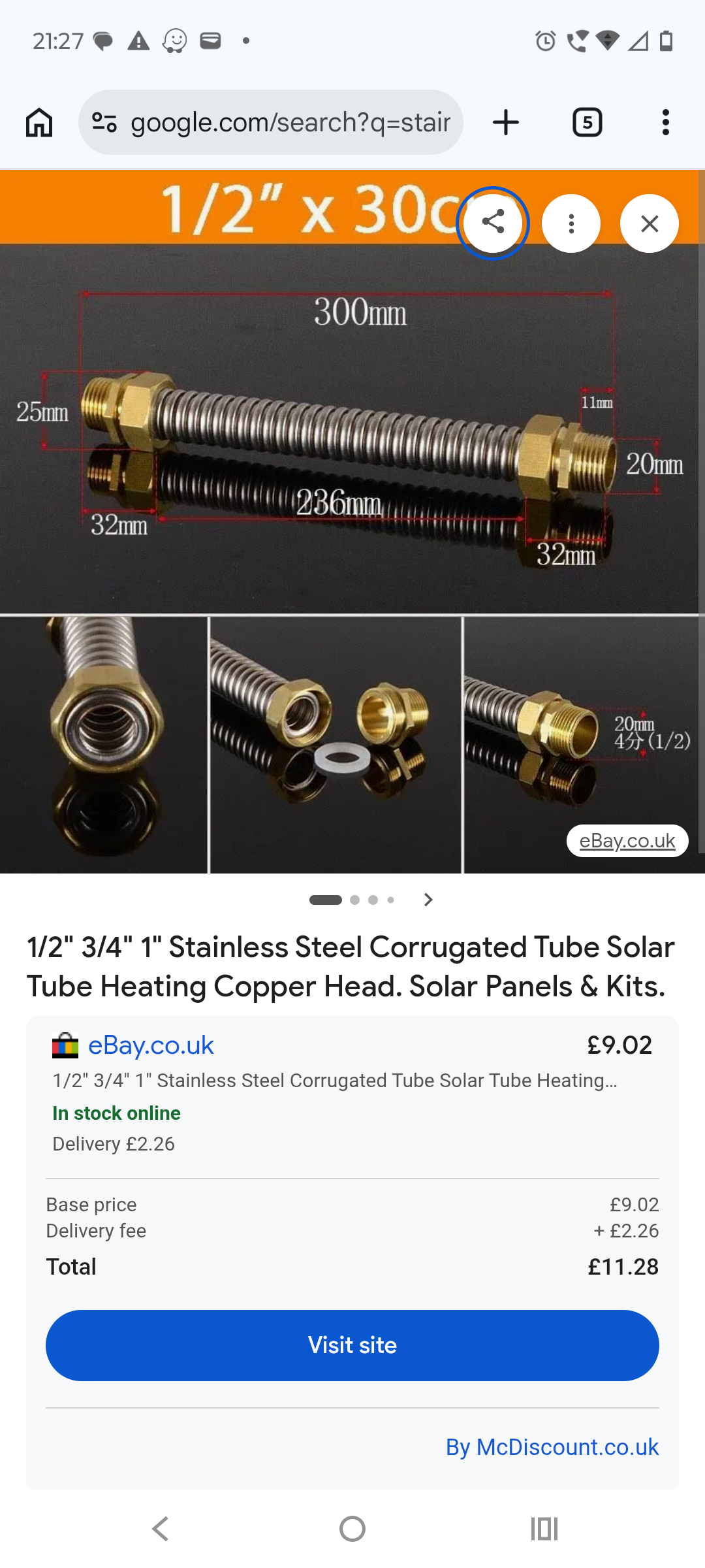

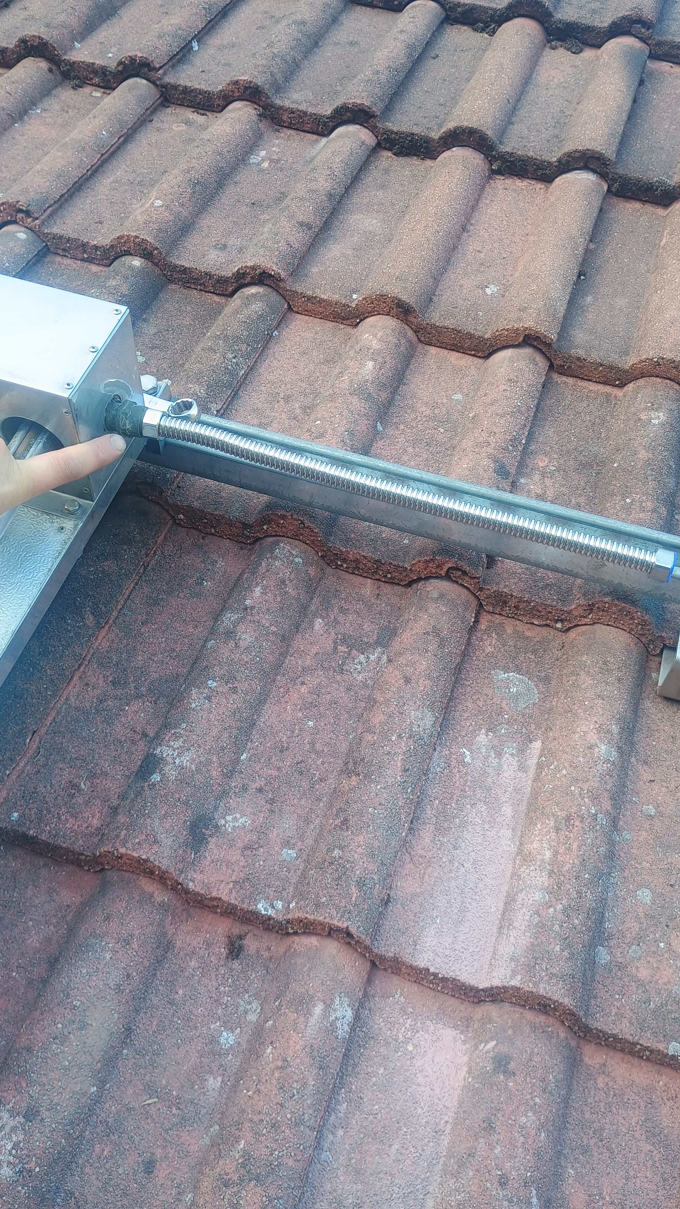

Would these corrugated stainless pipes do as the interconnects at the top of the panel between panels 1 and 2 then panel 2 and 3?
https://ebay.us/m/hHy3Fm
Various sizes. I presume I just equally space my panels on the rail and pick the right length /end fitting pipe?
Then the pipes through the roof at each end of the array, same stuff or copper?
A lad I'm talking to on another forum reckons he's used copper throughout, his system has been up and running 12 years with no issues.
If you use copper, use 10mm, it means there is less heated water in the hot pipe, so the heat gets to the coil in the tank quicker. we did this in a previous house and afaik, it's still running after 15 years...  😄
Just make sure all the joints are compression ones.
I think those stainless, corrugated, pipes are to allow for expansion and movement.
Make the system a drain back one and those problems go away, but gives you other problems.

Render of a 3D printed tile flashing. It'll get CT1'd to the tile. A 110mm elbow will sit on top of this:
If you put a 110mm elbow on your roof, I'll come down there and multi-tool it back off.
Just "NO!". It'll be fugly as feck.

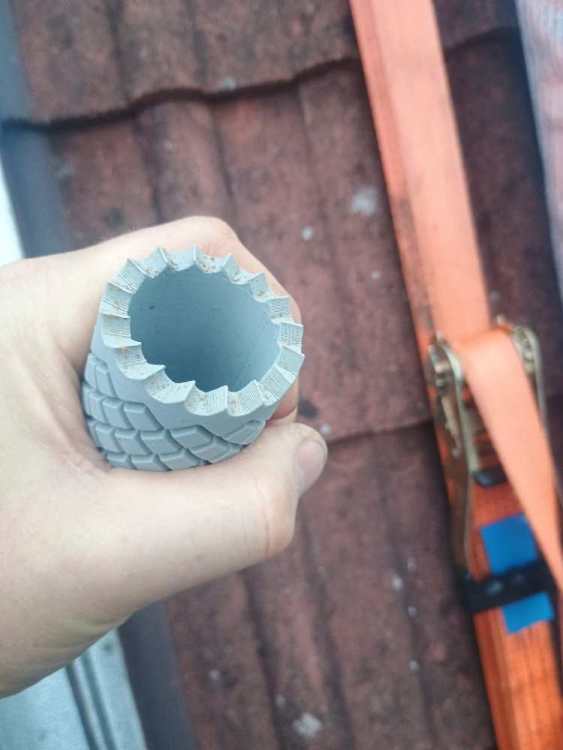

Prototype flashing for the tube entry:
IMG_20260425_010446505_HDR
IMG_20260425_010638766
IMG_20260425_010633123
I must have told my lad 110mm internal diameter 🤭 this is mind just a lightweight prototype print:
IMG_20260426_110836589
That's obviously a 45⁰ bend rather than as 90 but it's just proof of concept. The pipes will run through it within rockwool type insulation.

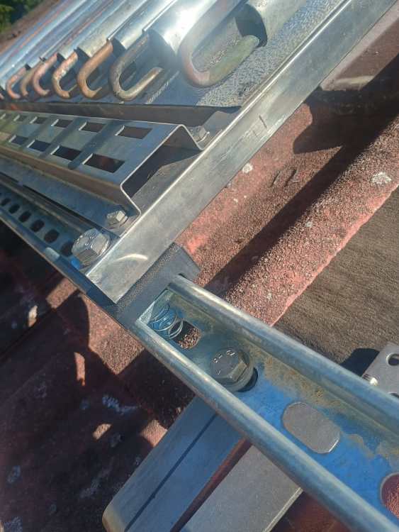

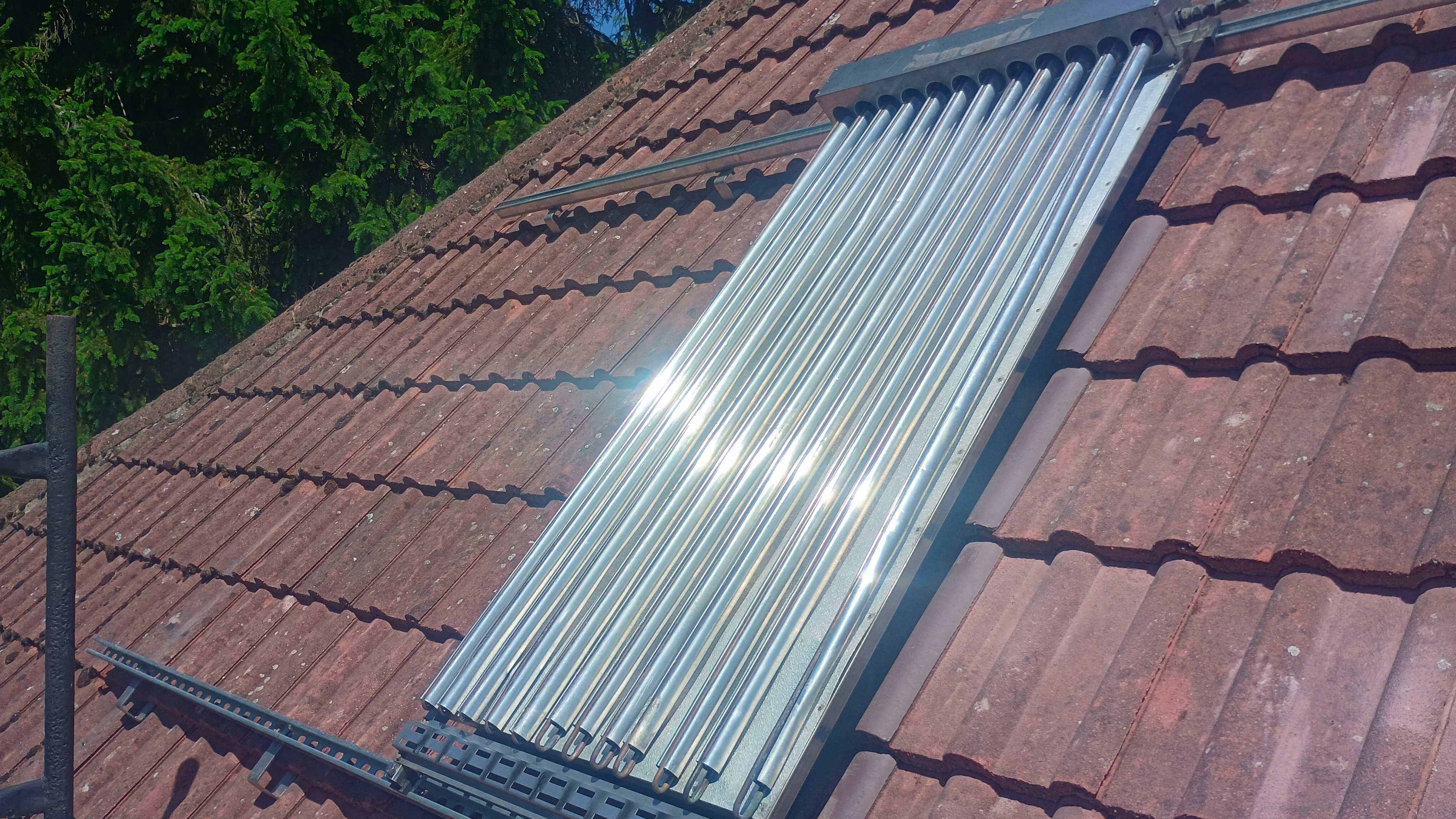

Decided I definitely want to get a proper ladder between the panels and at each end. Meant extending the unistrut by 880 mm.
IMG_20260427_181614214_HDR
IMG_20260427_181609485_HDR
Of course now the end overhang looks a bit silly so I'm debating adding another bracket at each end
If you want a "ladder" so you can climb the roof, just slide every other tile up in a vertical row. Your tiles look exactly the same as ours and sliding them up and out of the way makes a great way to move around.

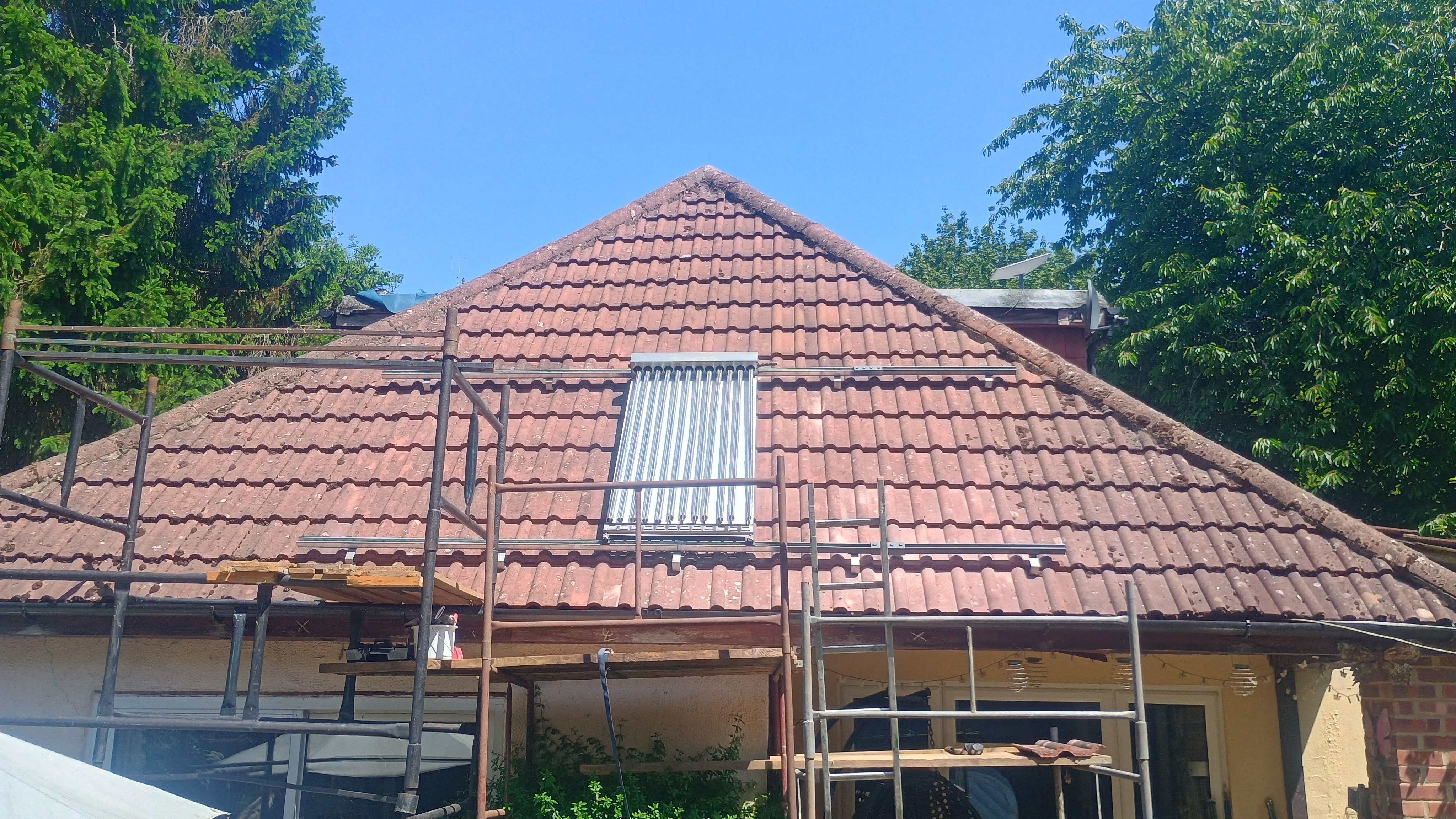

😡  In the cold light of day, in fact a cold dark day which matches my mood, I reckon I'm going to have to shift the brackets to offer better support to the extended rails. It's going to mean I think messing around with some ridge tiles on the hips to get the end brackets in on the top rail. Ah well!
4 brackets as is:
IMG_20260428_074112466
Back to having a centre one and 5 brackets per rail:
IMG_20260428_074112466 (1)
I'm guessing nobody usually does this but I'm intending "shading" the installed 3 panels temporarily when done with a "99%" solar reflective blanket(s). Probably secured with bungee cords. This so the unfilled panels don't overheat. The idea being I can finish the roof side pretty much, have all the tubes up there, fitted and safely out of the way. Then concentrate on inside the loft which is another mission. I'll fill the system later on.

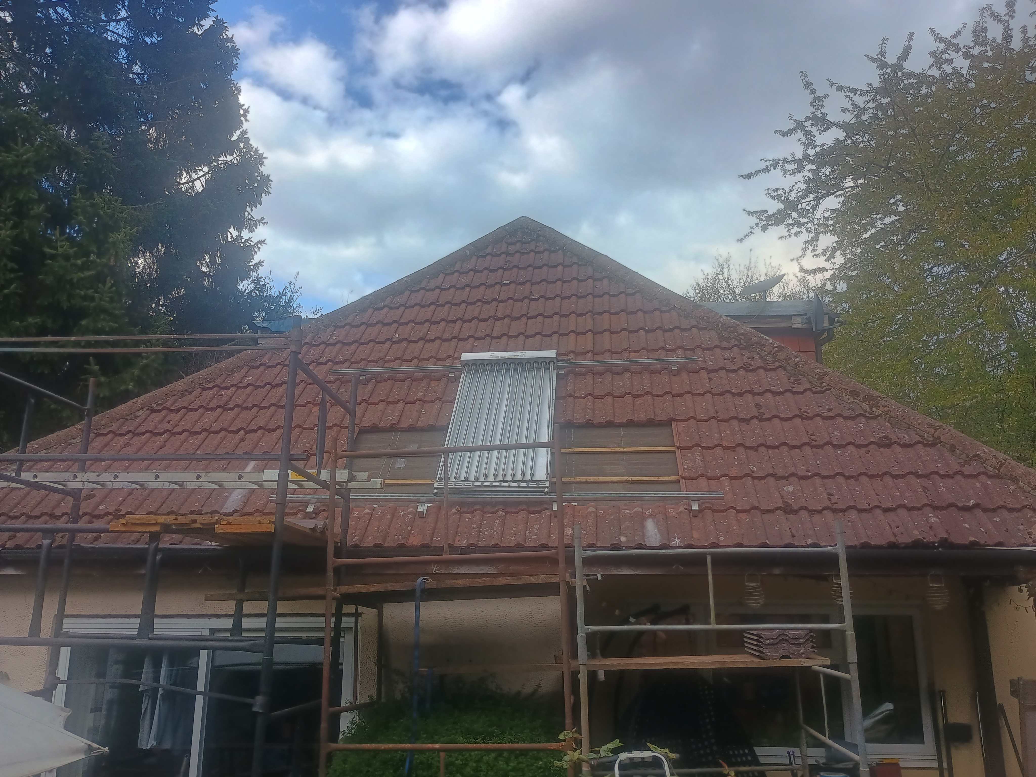

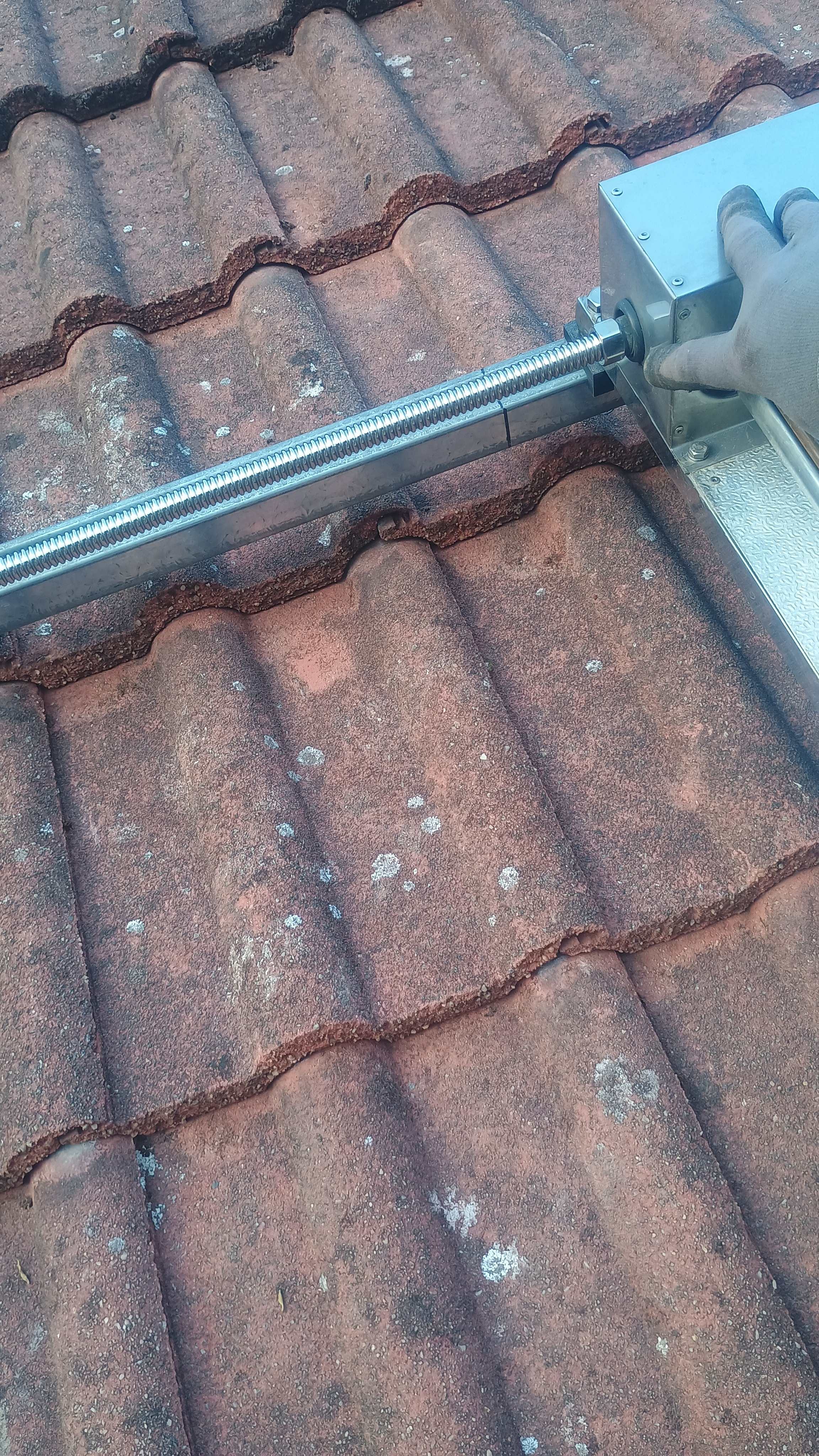

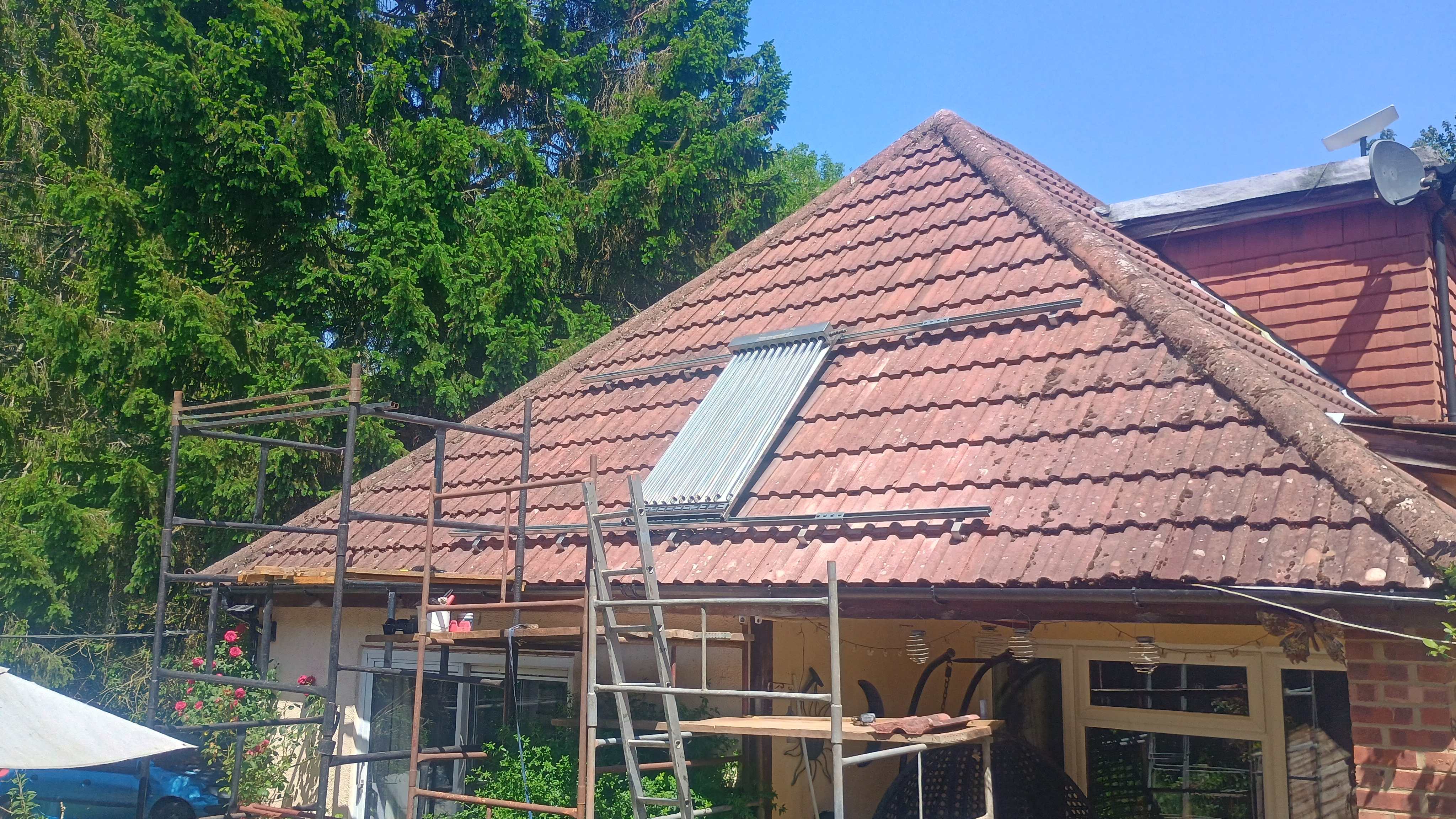

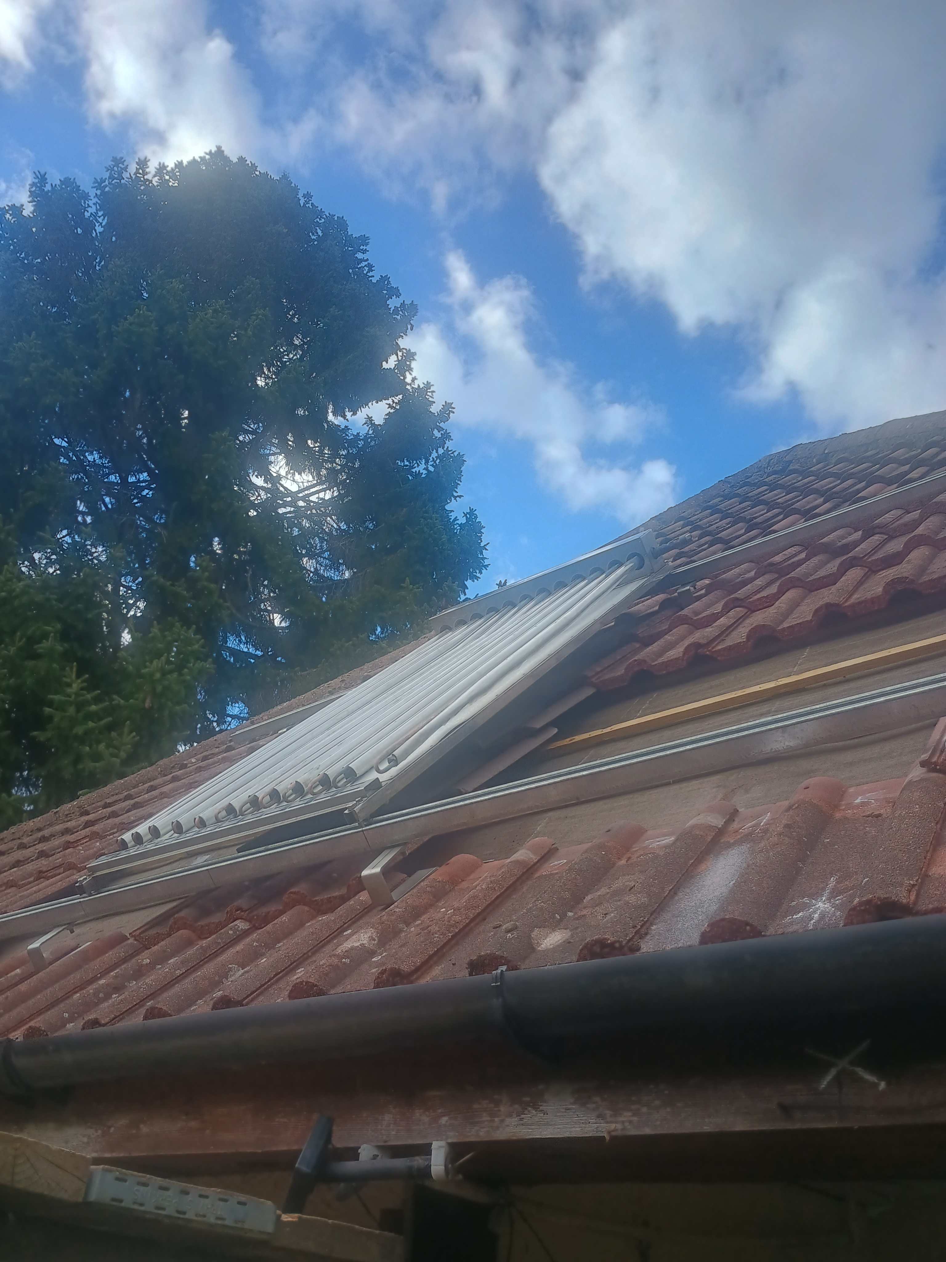

That one installed panel is the one without the evacuated tubes fitted. It was the one where they were all smashed to hell. Still need to get new ones.
So that's both rails fitted, tiles back. Was way too hot to carry on. Even the stainless of the panels were scorching to the touch / bare arm etc!
My sense of symmetry is now not offended too much:

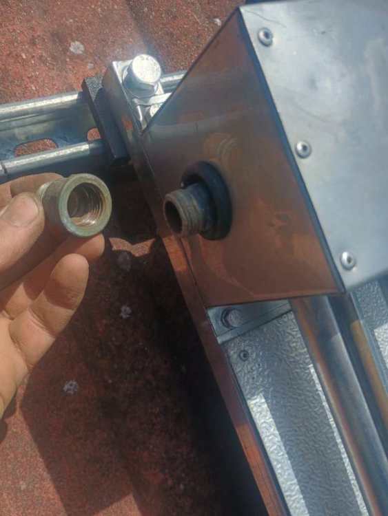

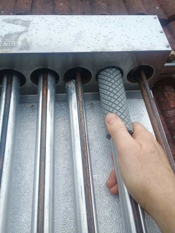

Waiting for my AliExpress solar shade "blankets" before I put the two tubed panels up. As for the pipes to connect the panels together I'm not sure 🤔
I've bought some Chinesium, corrugated solar pipes but don't know if they're man enough. The white "top hat" insert seems to be some sort of silicone rubber maybe?
People elsewhere have suggested just using 15mm copper instead of the corrugated tubes?
