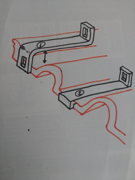

Started looking at getting the 3 thermal panels on the roof at last. I went to get brackets a while back and they had sold out. A couple of photos and questions then.
Just been out and took a tile off:
IMG_20220618_094231911
It's nom 55mm to the peak:
IMG_20220618_094311413
& 25mm to the recess:
IMG_20220618_094326204
This typical bracket drawing shows adjustment from 44 to 54mm. I presume that bit sits down on the tile? In my case it wants to be more like 25mm though.
Do you groove the tile so this bit of the bracket sits flush and doesn't lift the tile?

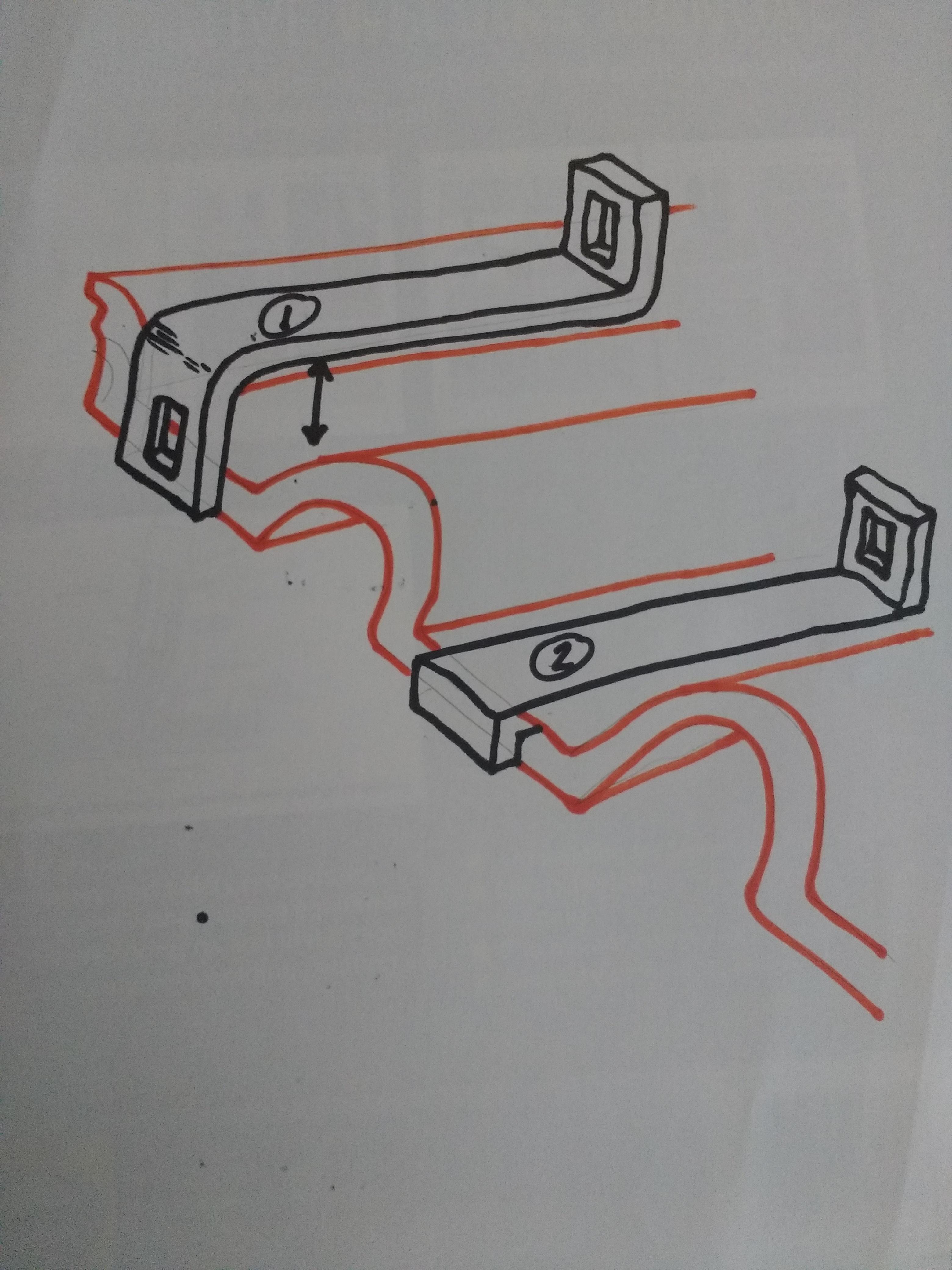

My biggest worry / misunderstanding, is how the bracket section that comes from the the angle (that screws to the joist) goes under the tile above. Surely, unless you grind a groove in one or both tiles it'll keep the tile above "up", then be a route in for weather, insects, even vermin?
1 is how I see it without modding the tiles, 2 being the ideal:
some installers grind the tiles, others don't.
I can't see how the integrity of the tiles interlocking is kept if you don't.
You almost want a concrete "router" bit to do a neat job.
When I did my solar PV at the old house, I notched the tiles that would otherwise have rested on and be lifted up by the bracket.  Easy to do with an angle grinder.
And a thin diamond disc. Renusol do a good installation video on utube for PV mounts but the roof hook detail is the same

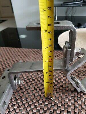

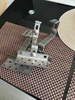

Would 6 brackets be ok to support 2 rails and 3 panels d'you think?
Again local, I can get these brackets and quite a few too, for reasonable £5 each. I'm thinking might give me more cutting and shutting options. Says they're for plain tiles though?
