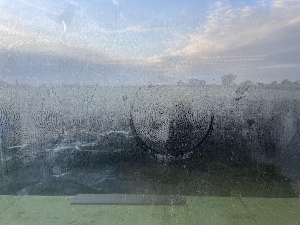

gc100 Posted October 26, 2021 Share Posted October 26, 2021 Hello, On all our big sliders, when we get a morning condensation on the glass outside I see 4 sucker marks on each pane. Any recommendations how to remove these? Cleaning doesn't work. I was thinking glass polish like you get for car windows? Link to comment Share on other sites More sharing options...
dangti6 Posted October 26, 2021 Share Posted October 26, 2021 Tried a cream cleaner and/or IPA? Link to comment Share on other sites More sharing options...
gc100 Posted October 26, 2021 Author Share Posted October 26, 2021 2 minutes ago, dangti6 said: Tried a cream cleaner and/or IPA? No yet. I don't think IPA will work TBH. I think I just need something abrastive like a old school jiff or this stuff perhaps. https://www.amazon.co.uk/Prounol-Cerium-Oxide-Polishing-Solution/dp/B08BLT3BZK/ref=sr_1_2_sspa?crid=1HDOI35SXVW0&dchild=1&keywords=glass+polish&qid=1635245392&sprefix=glass+polish%2Caps%2C160&sr=8-2-spons&psc=1&spLa=ZW5jcnlwdGVkUXVhbGlmaWVyPUExV1pIVUNSMTcyTFgxJmVuY3J5cHRlZElkPUEwNzMwODgyMVIyVlBaQVgyMzJJViZlbmNyeXB0ZWRBZElkPUEwMjc2MTE1MjlZSklVMUhXSUxLNCZ3aWRnZXROYW1lPXNwX2F0ZiZhY3Rpb249Y2xpY2tSZWRpcmVjdCZkb05vdExvZ0NsaWNrPXRydWU= Just wanted to see if anyone knew 100% what works (or not). thanks Link to comment Share on other sites More sharing options...
Onoff Posted October 26, 2021 Share Posted October 26, 2021 Could be worse, could be footprints! ? Multisolve? Leave it to work as per instructions though. Link to comment Share on other sites More sharing options...
markc Posted October 26, 2021 Share Posted October 26, 2021 After putting big panes in with a crane and suckers, or one of our guys grinding near a pane we used white scotchbrite pads to polish any marks out 1 Link to comment Share on other sites More sharing options...
wozza Posted October 26, 2021 Share Posted October 26, 2021 (edited) Before using anything harsh, try Windolene (pink cream stuff) or as you have said a cream type car glass polish. Edited October 26, 2021 by wozza Link to comment Share on other sites More sharing options...
Makeitstop Posted October 26, 2021 Share Posted October 26, 2021 Or Meths. It may be a case of simply degreasing the surface, but as Wozza says above, I'd be inclined to try harsh or abrasive products last. Link to comment Share on other sites More sharing options...

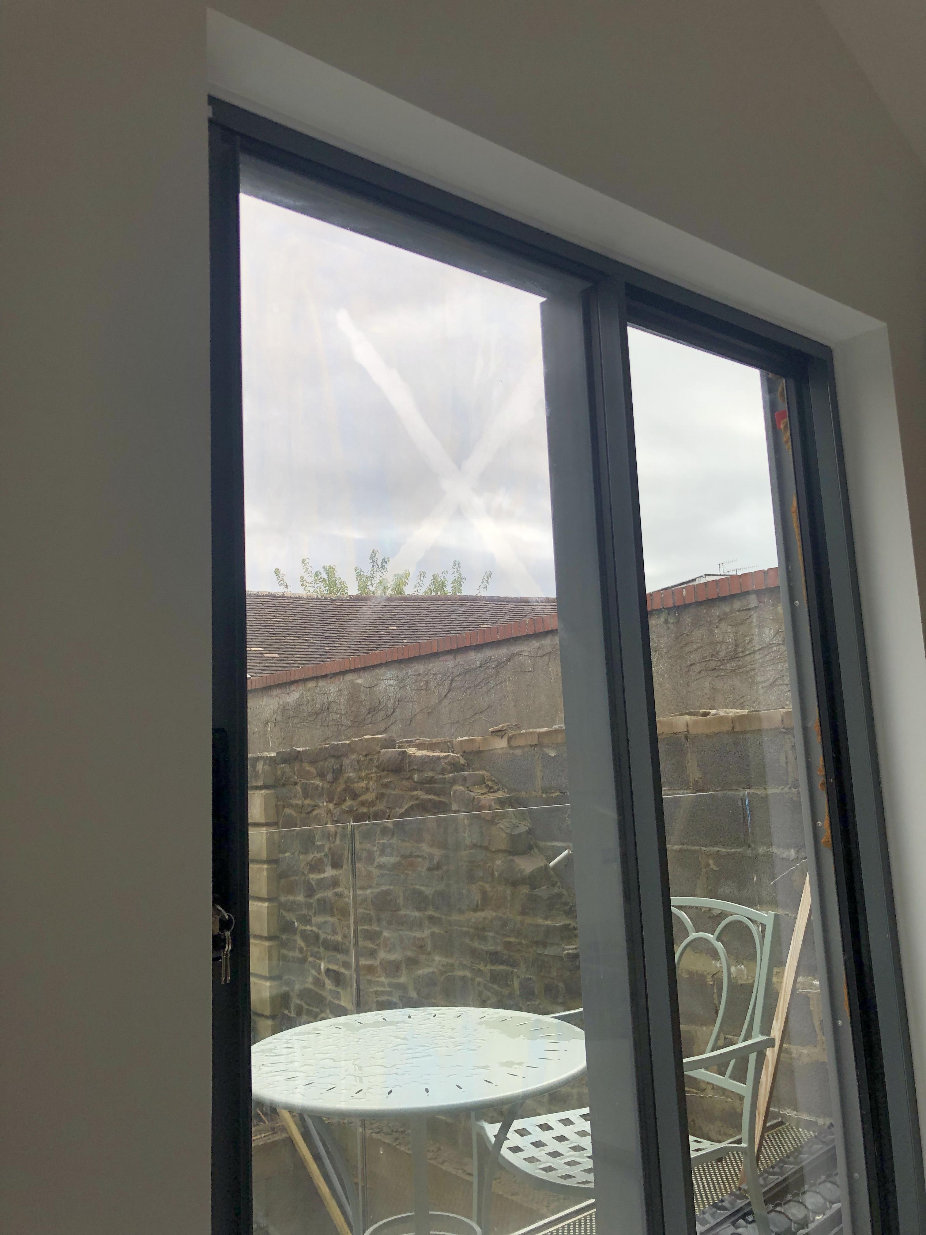

Pocster Posted October 26, 2021 Share Posted October 26, 2021 (edited) 3 hours ago, gc100 said: Hello, On all our big sliders, when we get a morning condensation on the glass outside I see 4 sucker marks on each pane. Any recommendations how to remove these? Cleaning doesn't work. I was thinking glass polish like you get for car windows? Got the same ( and worse ) . Try de greasing ( multi solve ) first . Nothing abrasive though . X marks the spot ? Edited October 26, 2021 by pocster Link to comment Share on other sites More sharing options...
Ferdinand Posted October 26, 2021 Share Posted October 26, 2021 Are these like marks on brushed alu fridges? Perhaps WD40? Or computer screen cleaner? Or baby oil? Or perhaps a razor blade scraper, as used for ceramic hobs? 1 Link to comment Share on other sites More sharing options...

James94 Posted October 26, 2021 Share Posted October 26, 2021 What about acetone? Regards James Link to comment Share on other sites More sharing options...

ProDave Posted October 26, 2021 Share Posted October 26, 2021 5 years since our windows went in and we also still get imprints of where the suckers were when there is outside condensation. Just what do the suckers do to the glass that marks it so it still shows under these conditions? I don't buy it being anything left behind by the rubber of the pads, it is almost as if the vacuum has actually changed the surface of the glass? Link to comment Share on other sites More sharing options...
Ferdinand Posted October 26, 2021 Share Posted October 26, 2021 3 minutes ago, ProDave said: 5 years since our windows went in and we also still get imprints of where the suckers were when there is outside condensation. Just what do the suckers do to the glass that marks it so it still shows under these conditions? I don't buy it being anything left behind by the rubber of the pads, it is almost as if the vacuum has actually changed the surface of the glass? Glass is a liquid, of course... Link to comment Share on other sites More sharing options...
Temp Posted October 26, 2021 Share Posted October 26, 2021 Are those marks caused by damage to the coating on the glass? eg because they put it in the wrong way around the suckers marked the coating? If that's not it I would try methylated spirit or IPA (not the beer). Link to comment Share on other sites More sharing options...

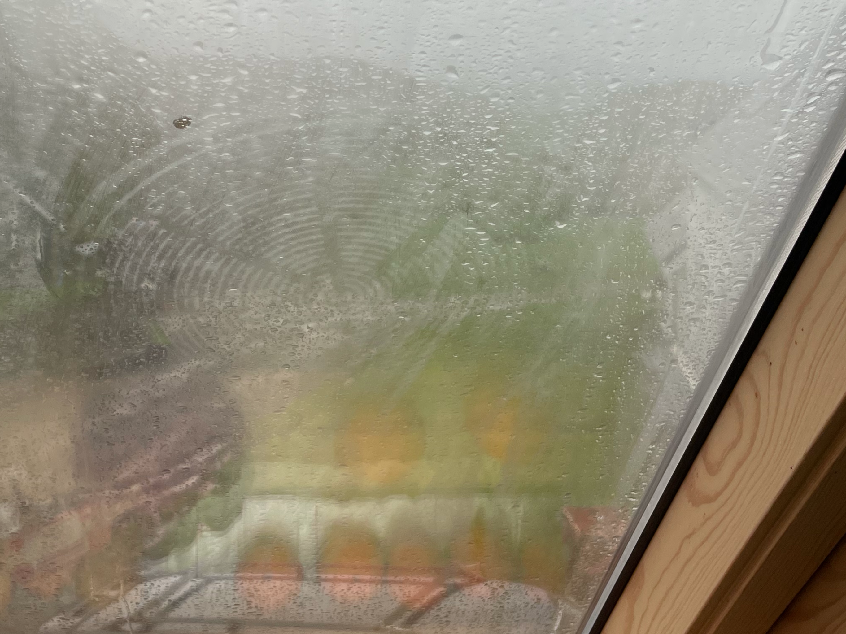

Cpd Posted October 26, 2021 Share Posted October 26, 2021 I had this mysterious mark show up on my velux a few days ago, it’s been in for years but I have never seen this before….. there has been noting put on the window or anything different done. It was gone when the weather got better but still a mystery. Link to comment Share on other sites More sharing options...
Pocster Posted October 26, 2021 Share Posted October 26, 2021 1 hour ago, Cpd said: I had this mysterious mark show up on my velux a few days ago, it’s been in for years but I have never seen this before….. there has been noting put on the window or anything different done. It was gone when the weather got better but still a mystery. I see sucker marks even on my shower glazing !!! . They get everywhere ! Link to comment Share on other sites More sharing options...
gc100 Posted October 26, 2021 Author Share Posted October 26, 2021 (edited) Ok found something https://www.ventana-usa.com/wp-content/uploads/Explaining-Residue-on-Glass.pdf CRL Sparkle and then Cerium Oxide if not as per my Amazon link it seems . I’ll let you know how I get on Edited October 26, 2021 by gc100 Link to comment Share on other sites More sharing options...
ProDave Posted October 26, 2021 Share Posted October 26, 2021 21 minutes ago, gc100 said: Ok found something https://www.ventana-usa.com/wp-content/uploads/Explaining-Residue-on-Glass.pdf CRL Sparkle and then Cerium Oxide if not as per my Amazon link it seems . I’ll let you know how I get on Interesting article. The suction cup marks may not even be as a result of installing the windows in our houses, they might even pre date that and be from handling the glass in the factory. 1 Link to comment Share on other sites More sharing options...
craig Posted October 26, 2021 Share Posted October 26, 2021 Try Illbruck AW413 - it’s what I use. 1 Link to comment Share on other sites More sharing options...
MJNewton Posted October 26, 2021 Share Posted October 26, 2021 (edited) I'd always give a Magic Eraser I try - never ceases to amaze me how effective it is on a whole variety of surfaces. Handy things to have around so nothing lost if it doesn't work. I just pull a small chunk off and it ends up lasting me years despite having a young daughter who draws on walls and furniture from time to time. Edited October 26, 2021 by MJNewton 1 Link to comment Share on other sites More sharing options...
SuperJohnG Posted October 26, 2021 Share Posted October 26, 2021 1 hour ago, ProDave said: Interesting article. The suction cup marks may not even be as a result of installing the windows in our houses, they might even pre date that and be from handling the glass in the factory. I have them on my Fakro windows...none installed with suckered so all must be from Factory. Can see two distinctive suckered in each. I will probably try a clay bar at some point or some detailing stuff I use for my car...or we'll used to before I had kiss and decided to build a house. Link to comment Share on other sites More sharing options...
